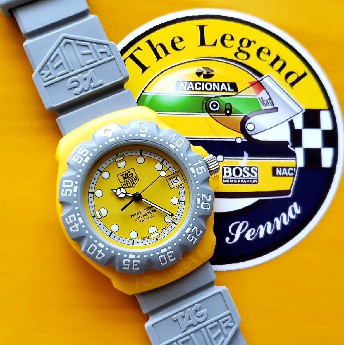

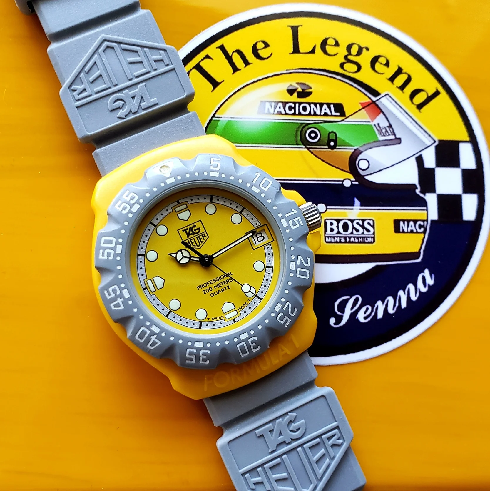

Thanks. I think I'm just overly critical because it's my own work.

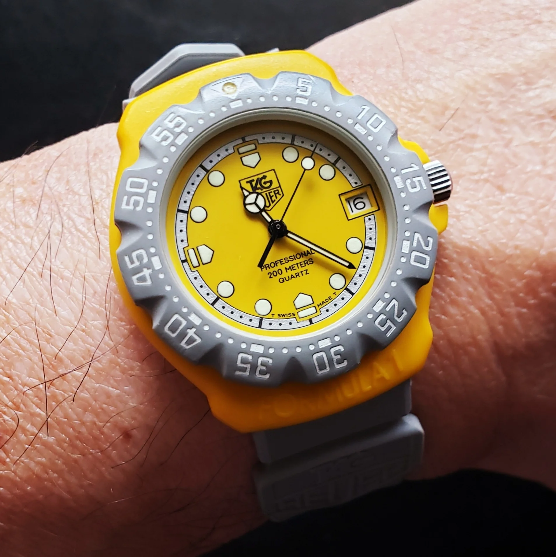

It's probably related to the wheel train as you say, since the section of the dial where it can be slightly off will change over time. At best it hits maybe 70% of the dots dead center, at worse around 55%.
I just checked all my other quartz watches, which I never scrutinized as heavily before this project. Only a few are nearly perfect in regard to hitting all second's marks dead center 100%. I'd classify my work as the next tier below, as good or better than most of my other quartz pieces. So, I'm at peace now after doing this comparison. 😮‍💨

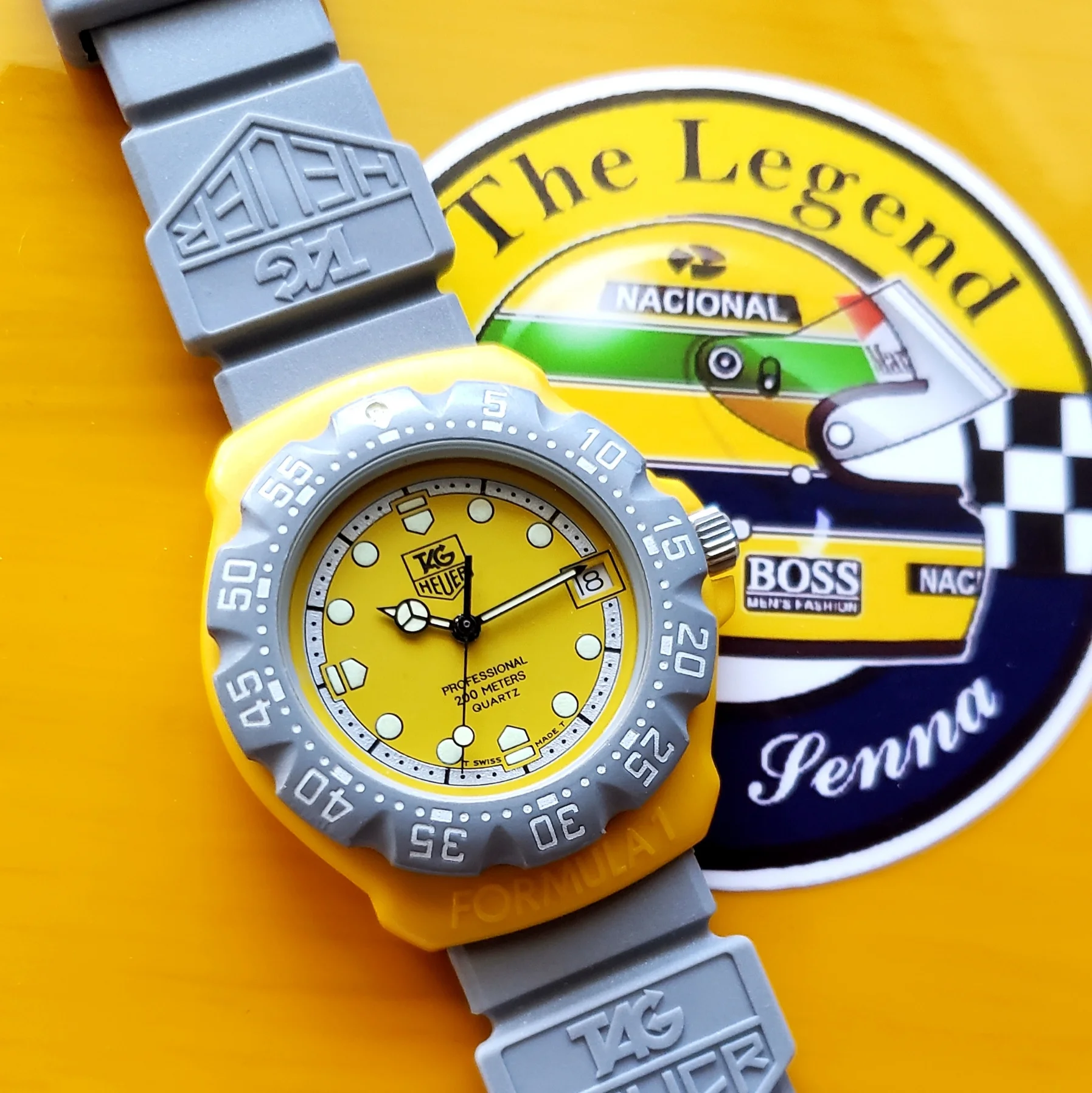

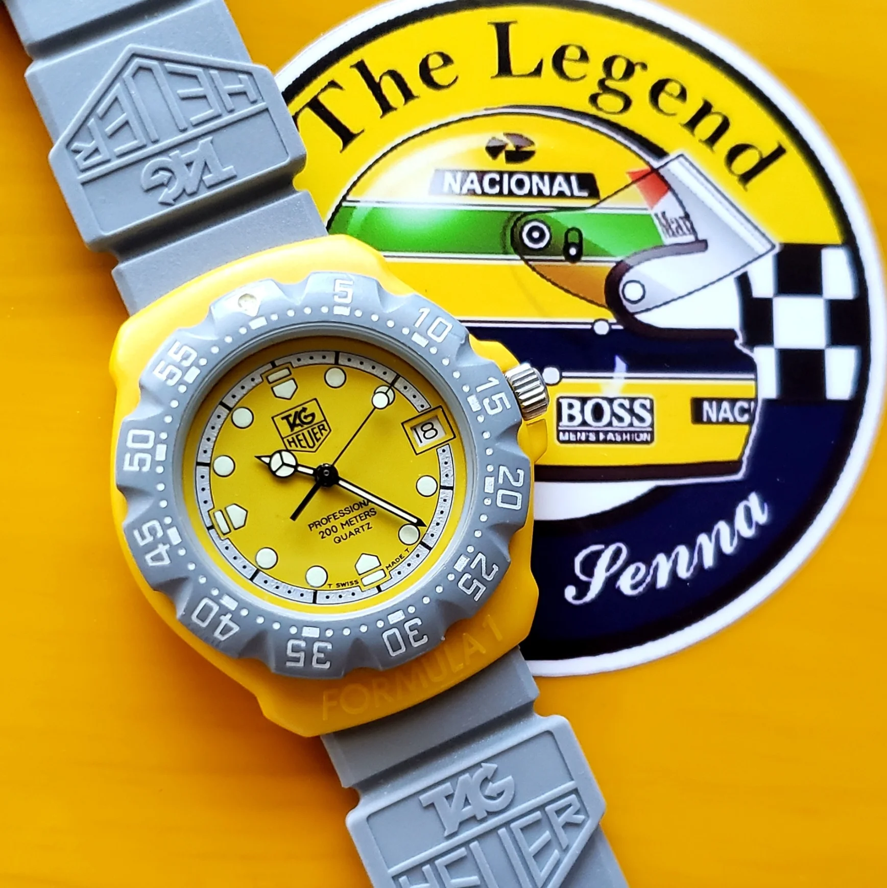

Some shots of my adjusted second hand at various positions. Not perfect, but good enough for me. 😀

Yeah, I know that feeling. Sometimes perfection just isn't achievable.
What you have done there is very acceptable and maybe better than it was before?
Considering it's the first time you've done this it's actually very impressive.
There are a lot of jobbing repairers working on quartz watches who wouldn't bother going to anything like these lengths, stick the second hand on and it lands where it lands!

Angle of view is of course everything, but from my screen it looks like ya nailed it, well done! 👍

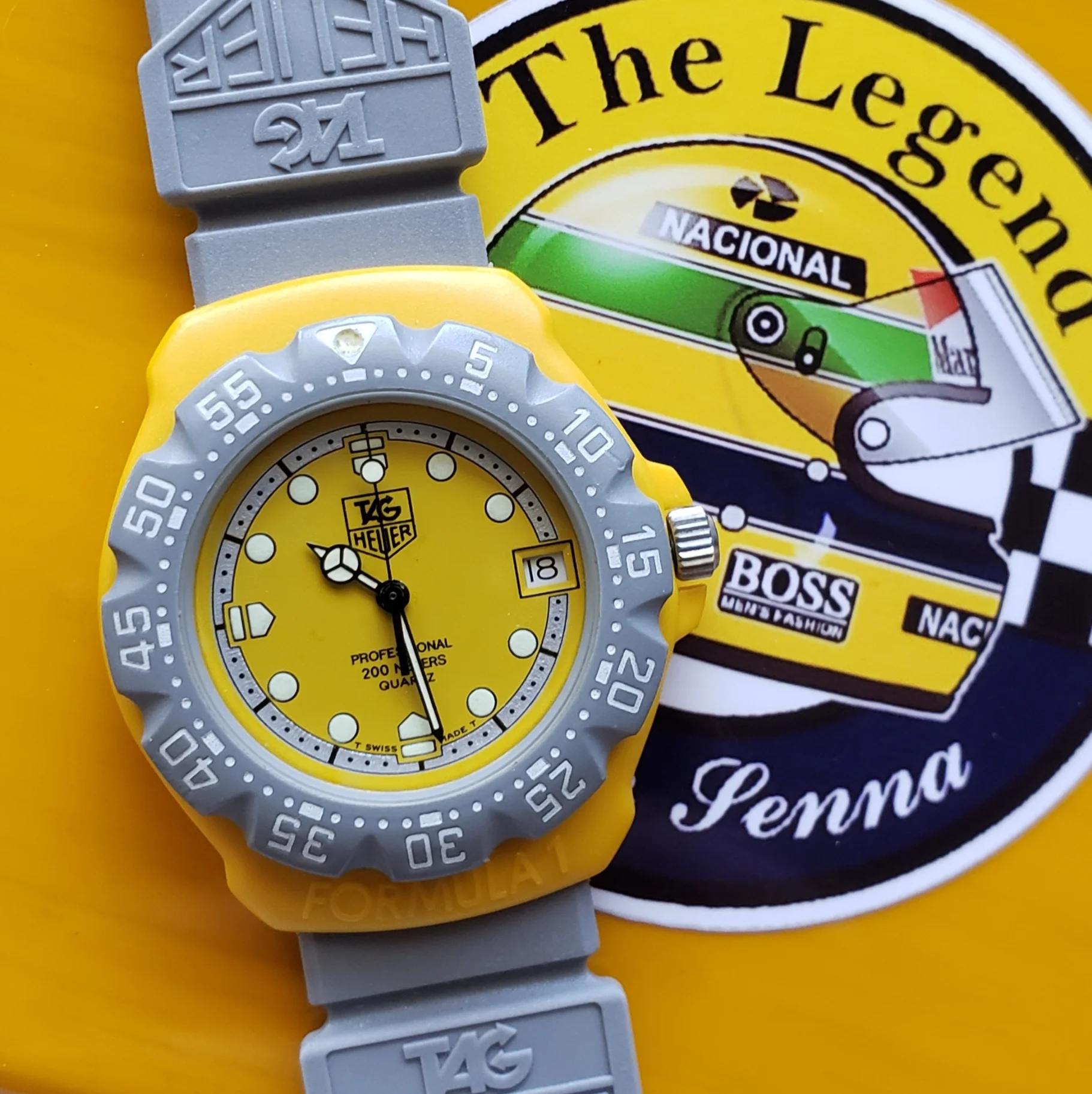

Thank you! Since I had difficulty just getting it to sit on the post during my first attempt, I lazily left it where it landed. It seemed close enough at the time, but it really wasn't.
Thanks! I tried to take these pics like how my eyes sees them when it's basically centered. But like I said, it's not perfect and can be slightly off center on certain dots.
However, compared to my first attempt below, it's much better now. Even when slightly off center, the hand is still pretty close to the dot, whereas before it wasn't.
it's been a great learning experience in more ways than one. Not only for watchmaking, but I also learned something about Import Duty under the new US Tariffs, as I bought the movement from overseas.

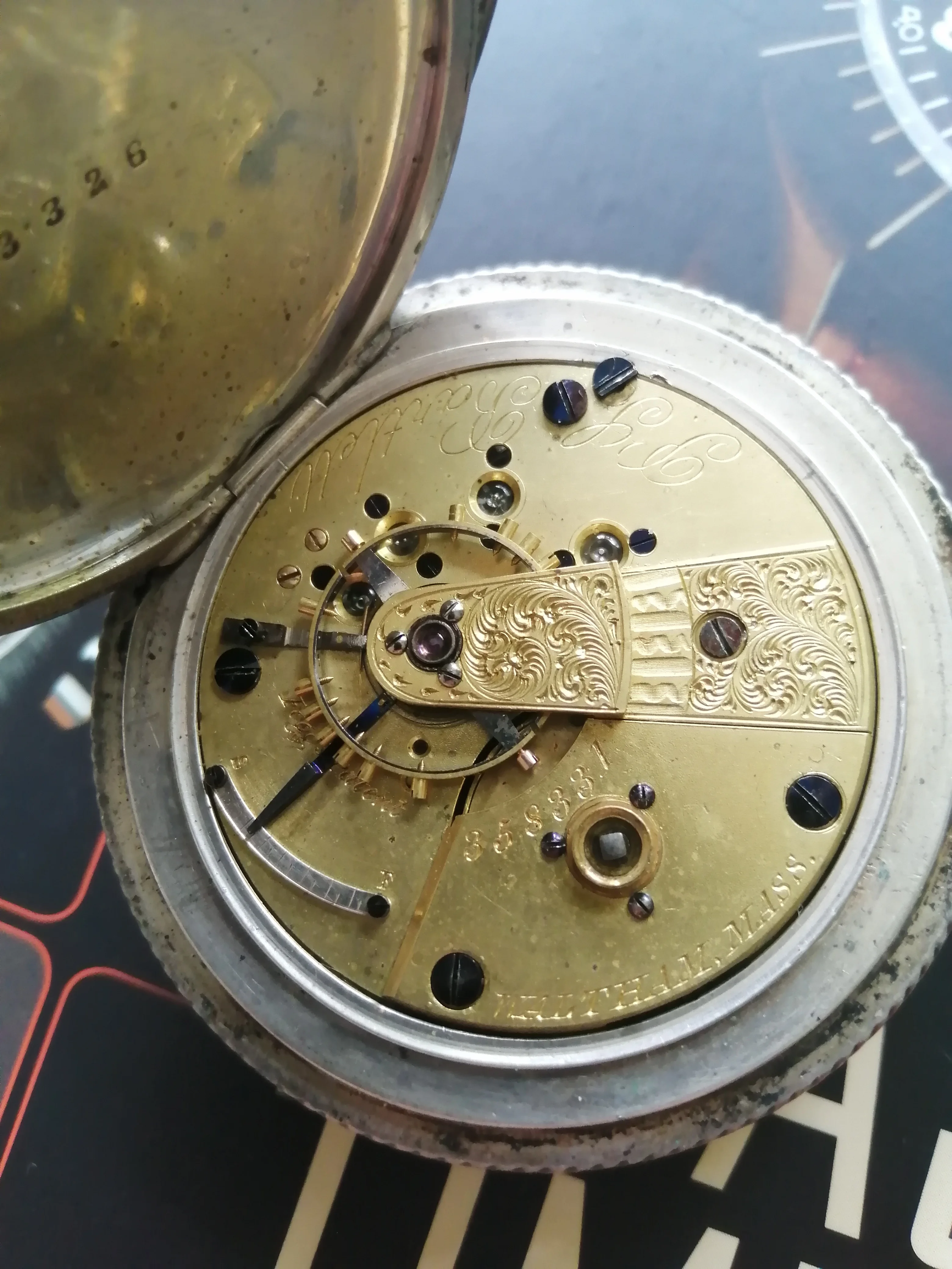

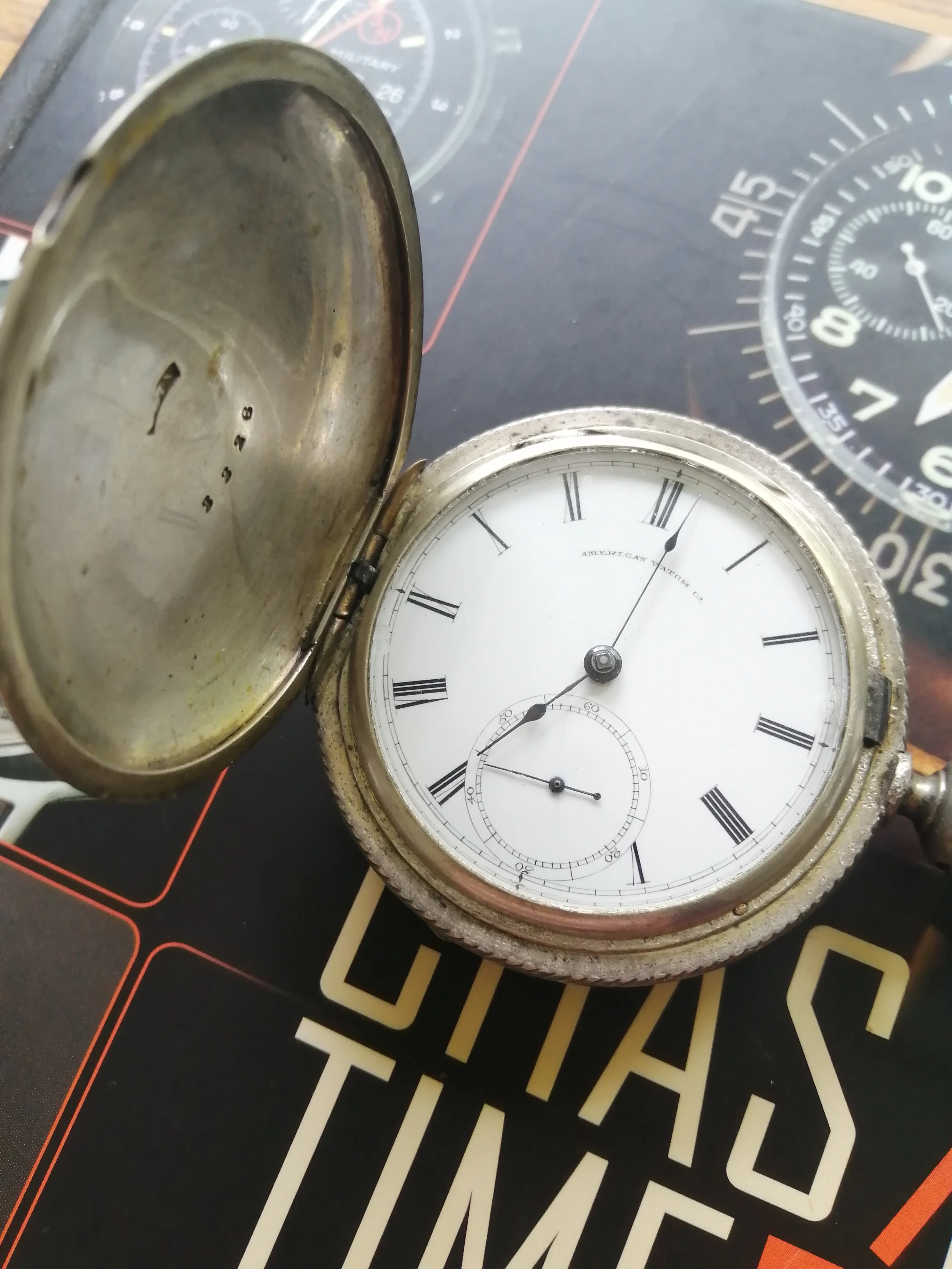

This is something from my collection, I have quite a lot of US pocket watches.
This is an 1857 grade American Watch Co (Waltham). Low serial number dates it to 1868 and its still in its 4 ounce silver hunter case.
Lots of things on these that we no longer see on modern movements, undersprung balance, adjustable banking pins, pinned dial feet and pinned hairspring. Adjustable timing screws on the balance wheel, you can increase or decrease the mass by turning the screws.
I was a bit nervous of it but actually it was lovely to work on.
This watch was already 8 years old when the the Battle of Little Bighorn took place and keeps time within 10 seconds a day, mind blowing really!

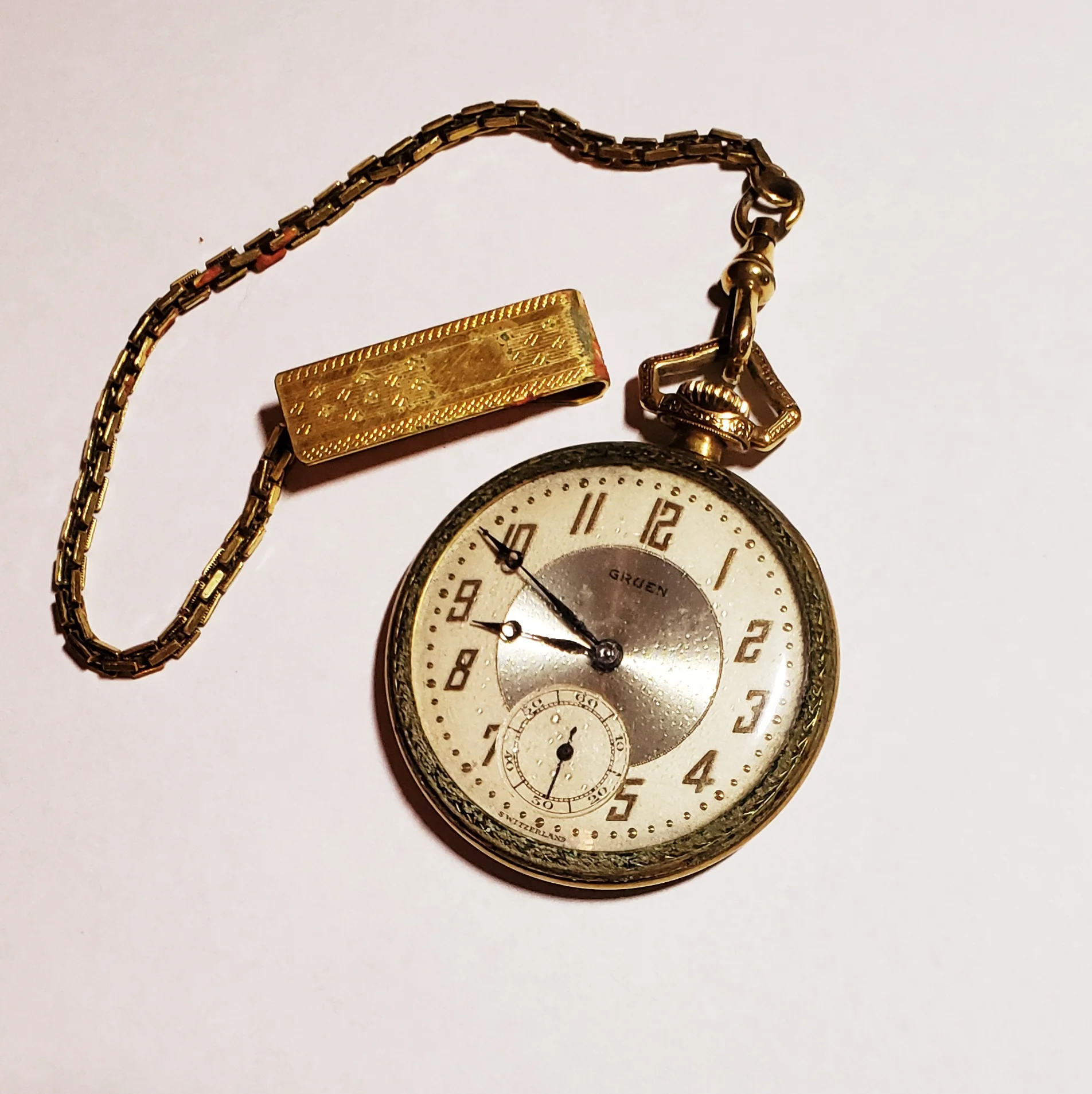

Another watch that has been on my to do list is this antique Gruen pocket watch. I inherited the watch from my grandfather. Have no idea how old it is, and it's never worked in the time I've had it.
That's absolutely the way to do it,build up slowly so you don't lose confidence by taking on something more than than you chew at an early stage.
Nice to know I gave you the push to do the Formula 1.
There was quite a bit of jeopardy involved there because the watch has meaning to you. Sometimes that's a good thing, sharpens your focus !
I said at the beginning that I thought you'd be good at this, I haven't changed my view 👍
Your Gruen is 1920 - 1930 I would say, classic dial style for that period. Nice watch, looks in good cosmetic shape👍

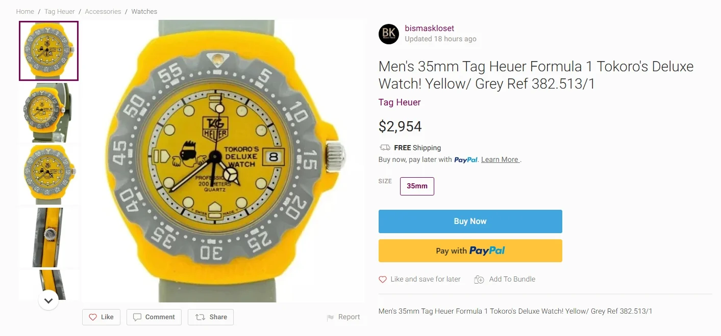

A bargain compared to the crazy asking price of this one! 🤪

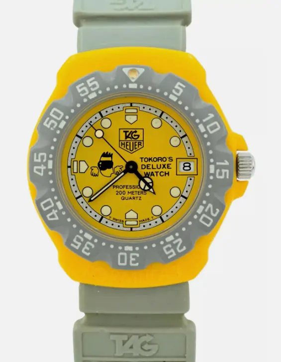

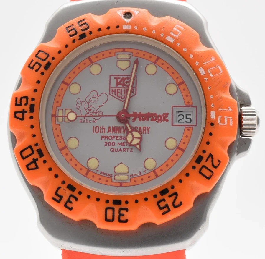

BTW Rob (@Aquagraph), what amazes me about the asking prices of these Tokoro Edition F1 watches is that it's a relatively obscure collab. I guess it's just the rarity of the watch (or the awesome color combo).
I'd bet most potential buyers don't even know the origin of the Tokoro edition, unless they're from Japan or familiar with Japanese culture. The collaboration was done with Japanese comedian/tv personality George Tokoro, who is also a car enthusiast. He's rather famous in Japan, but probably not known to the rest of the world.
I've seen other Tokoro collabs with cars, e.g. Hot Wheels diecasts and Fujimi plastic model kits. I've read he also did a watch collab with Seiko.

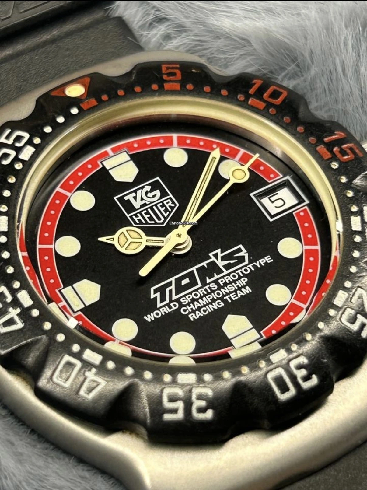

This one might also be Japanese related, TOM'S Racing World Sports Prototype Championship
Racing Team. Originally listed at US$2,300 it’s now on ‘sale’ for $1,900.
That is one I wouldn't mind owning, but not for what people are selling them at these days. TOM's is actually quite famous for those who follow JDM motorsport or played the Grand Turismo video games. They race and tune mainly Toyotas.
