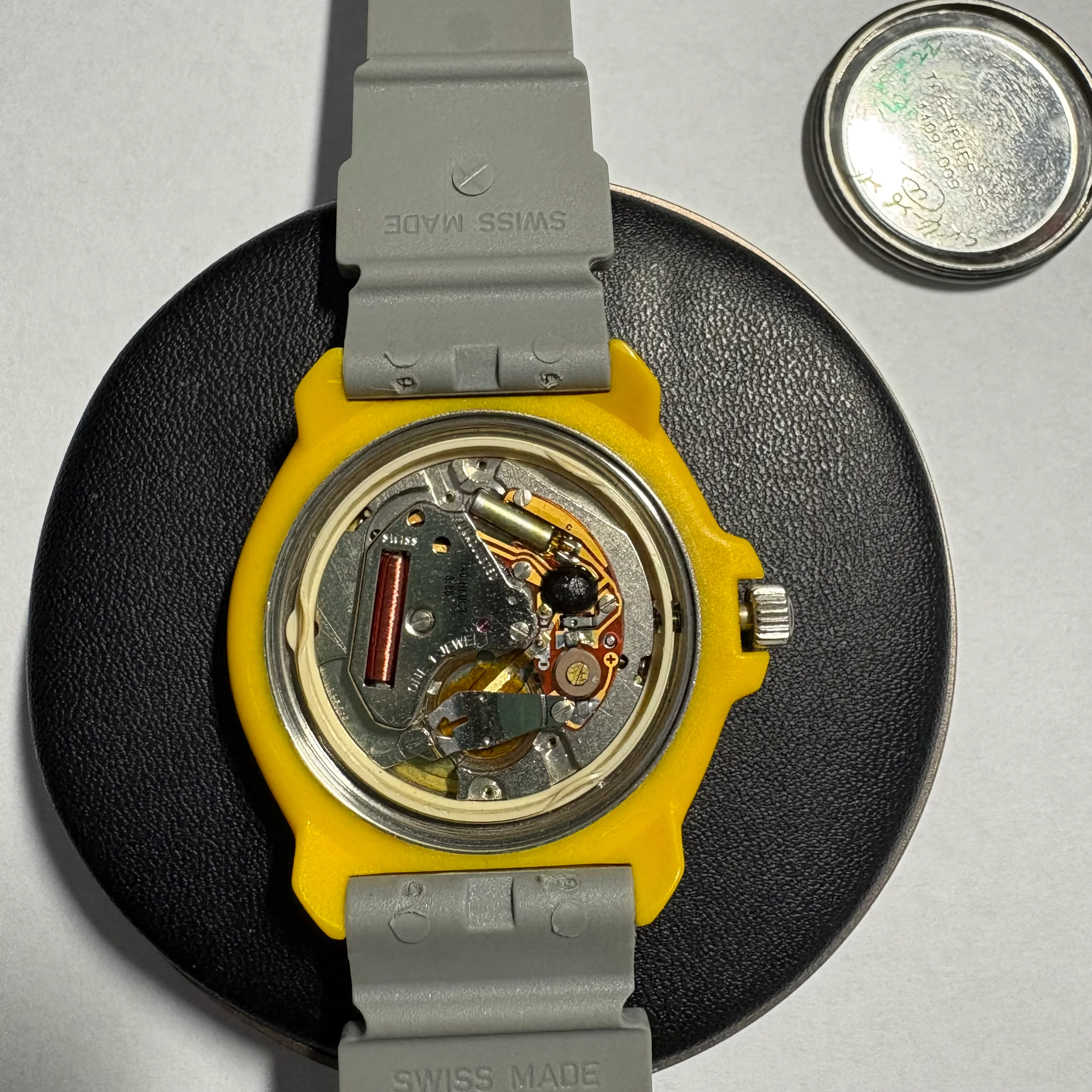

1. Original movement ('86 first year) opened up, ready for replacement.

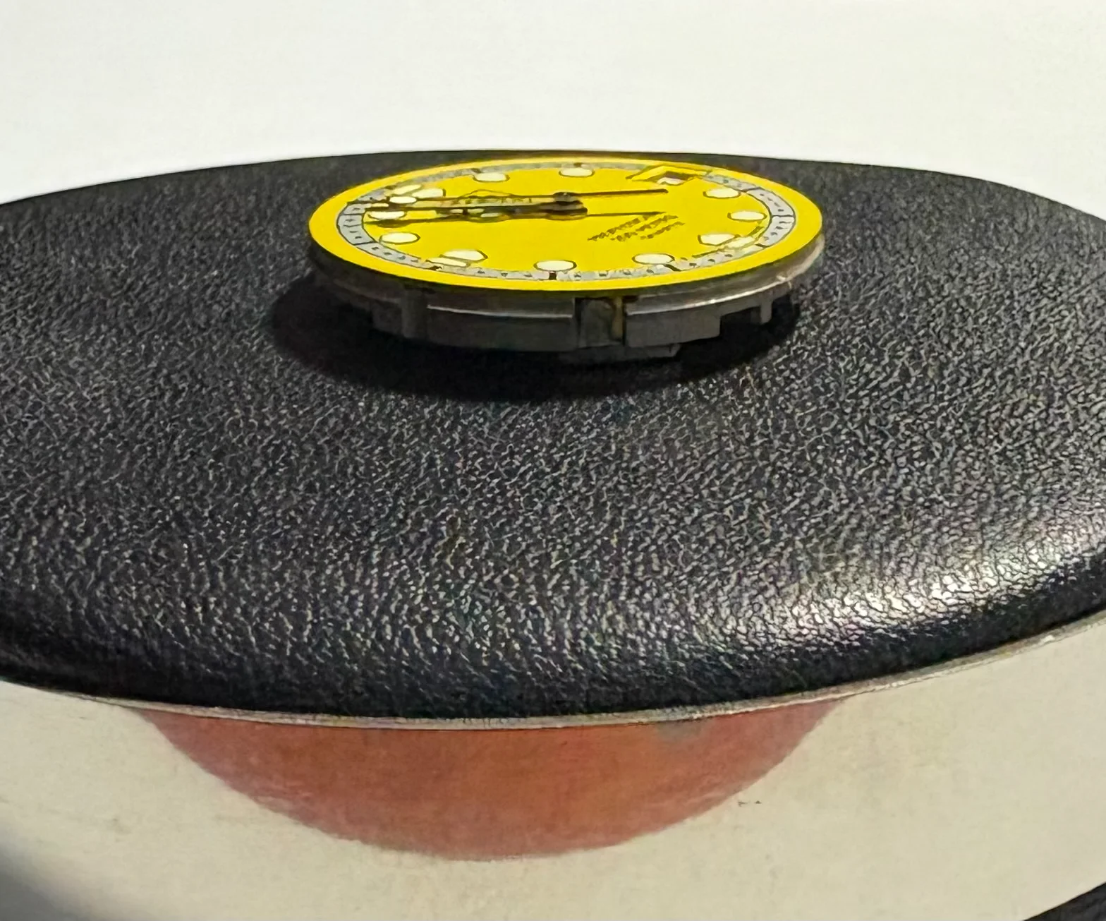

2. Old movement is out. Photograph of the hand's placement for my own reference, prior to hands removal.

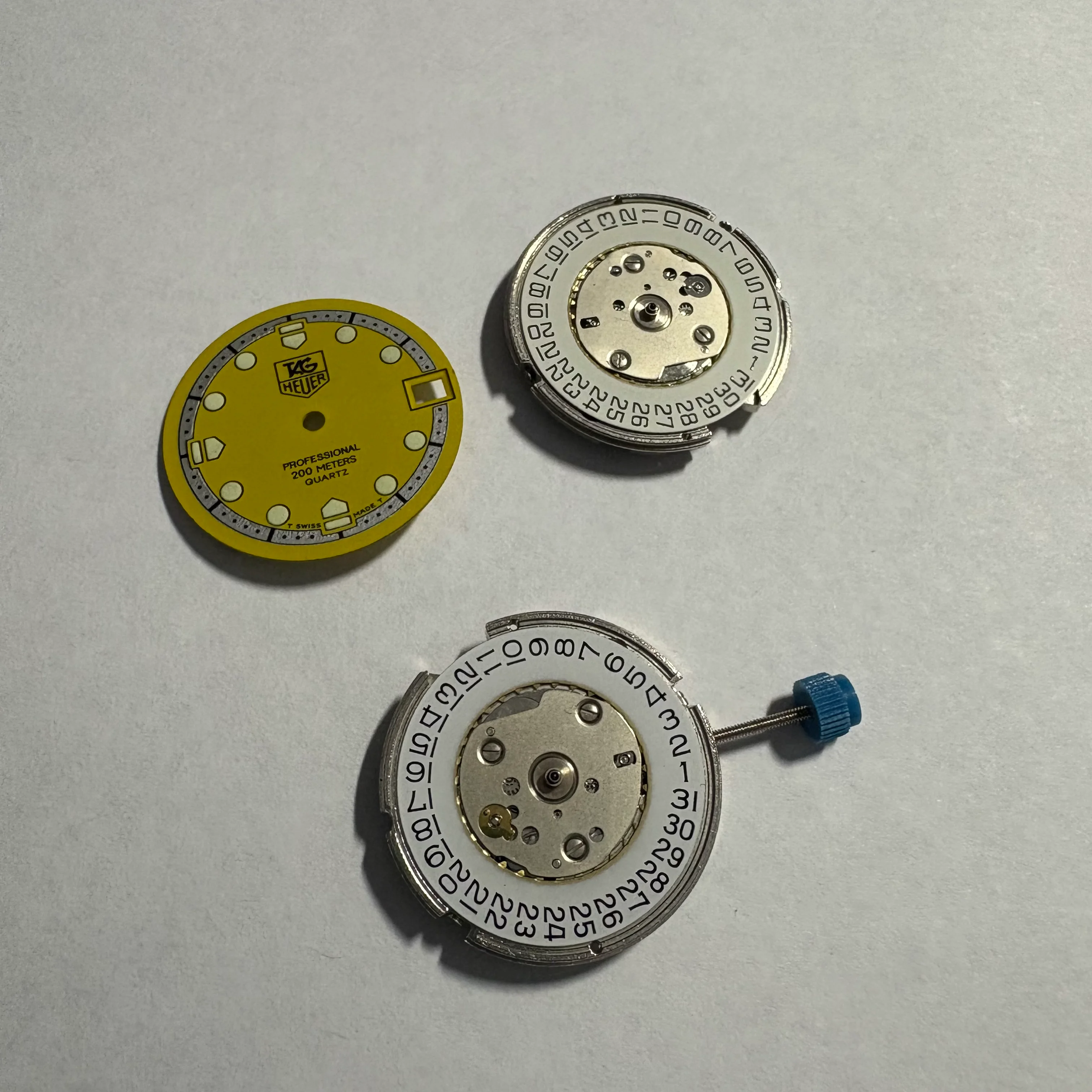

3. Dial plate is off, easy peasy (again thanks to @Thehighwayman's explanation of how the feet are secured). New 965.313 movement is ready for install.

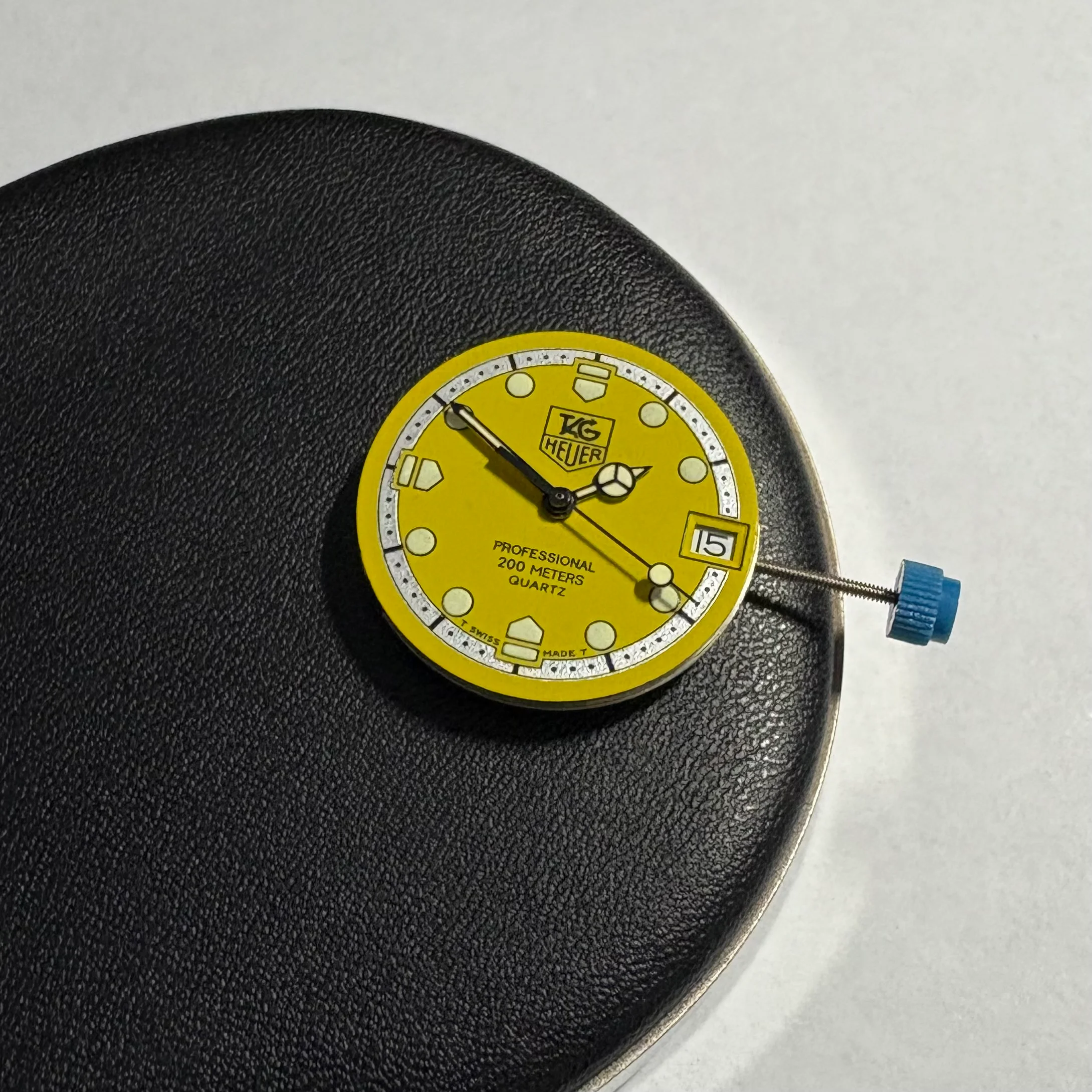

4. Dial and hands are now installed on the new movement. Attaching the seconds hand was definitely the hardest part. Getting it to sit on the post was like threading a needle! The hour and minute hands were simple in comparison.

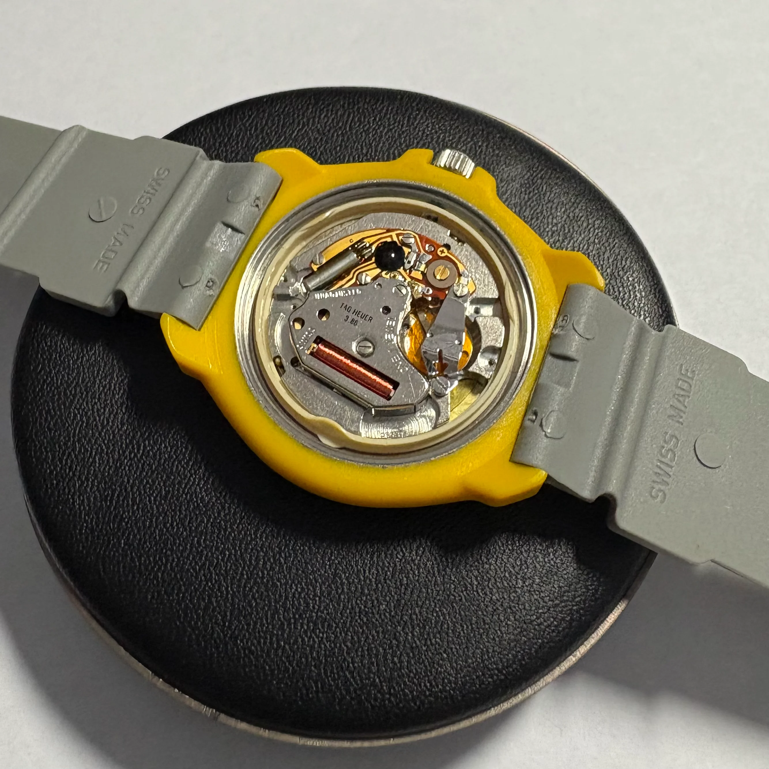

5. New movement is safely back in the case. Swapping the coil cover with the TAG Heuer date stamp preserves the original look, albeit not the original movement anymore (sadly).

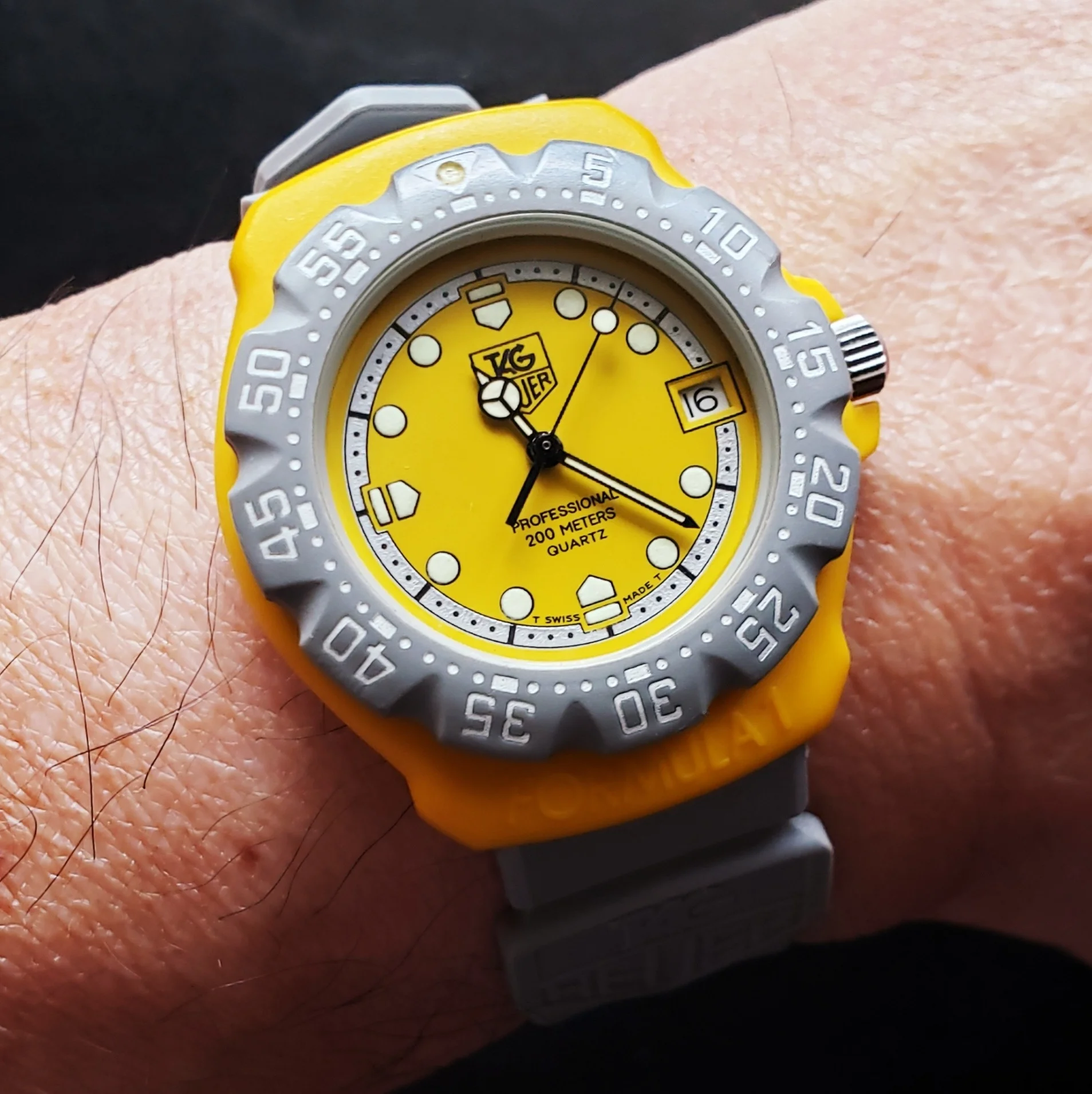

6. Good to go!!!
6. Good to go!!!

Second hands, I hold the very tip with tweezers and then go in, just resting it on the pinion before seating it. Easier to see the pinion and locate it compared to holding the hand near the centre.
