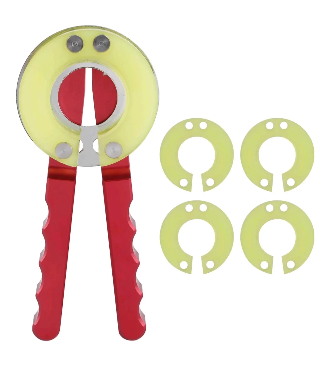

Tool wise, there are various types of bezel removers. All are pretty effective.
There is the plier type like this.

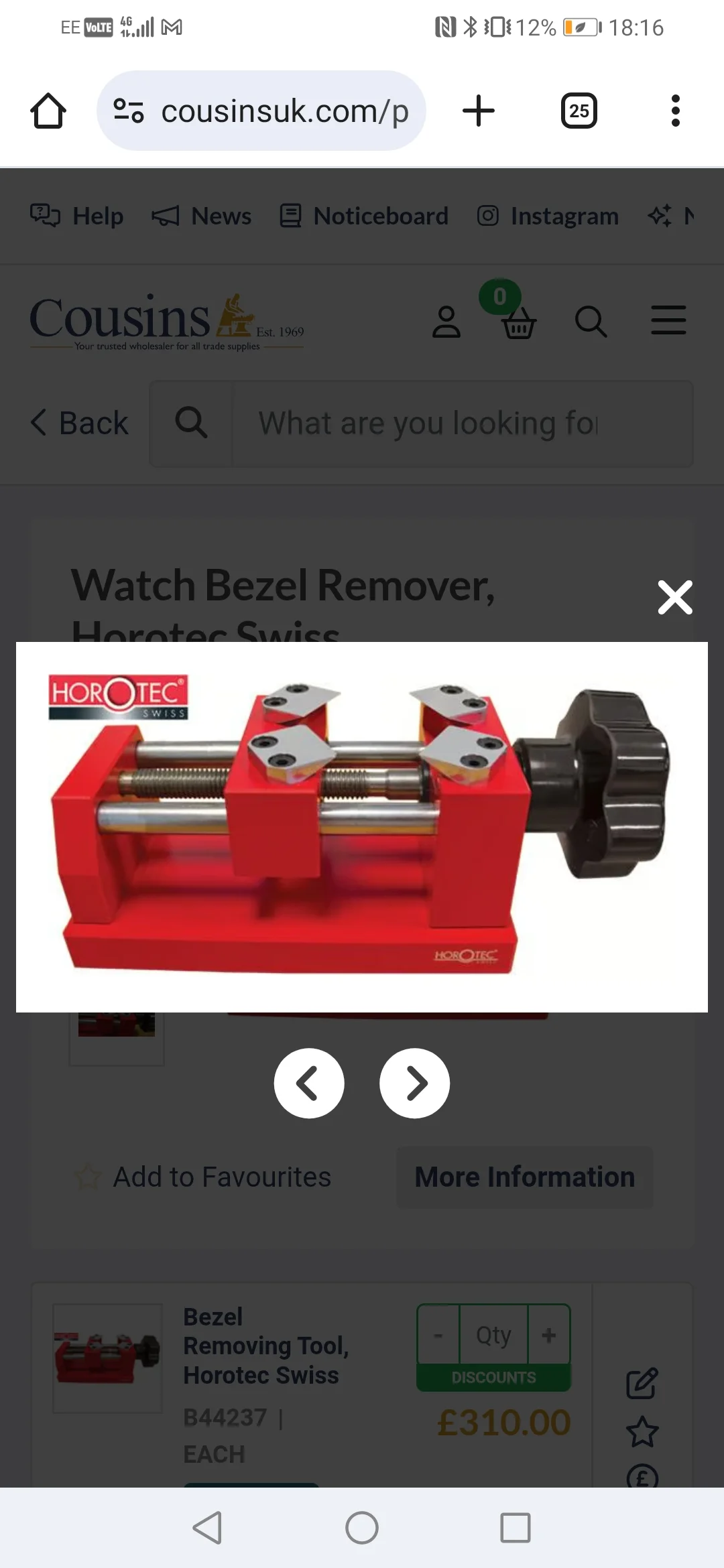

Or the Horotec style like this.
Works on the principle of getting under the bezel and applying equal lifting pressure to pop them off.
My preference is for the Horotec type, they aren't vastly expensive.
