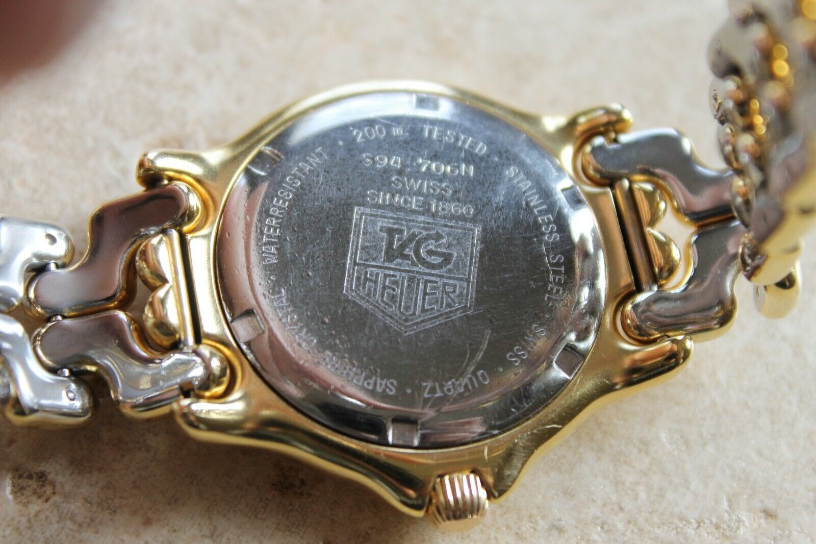

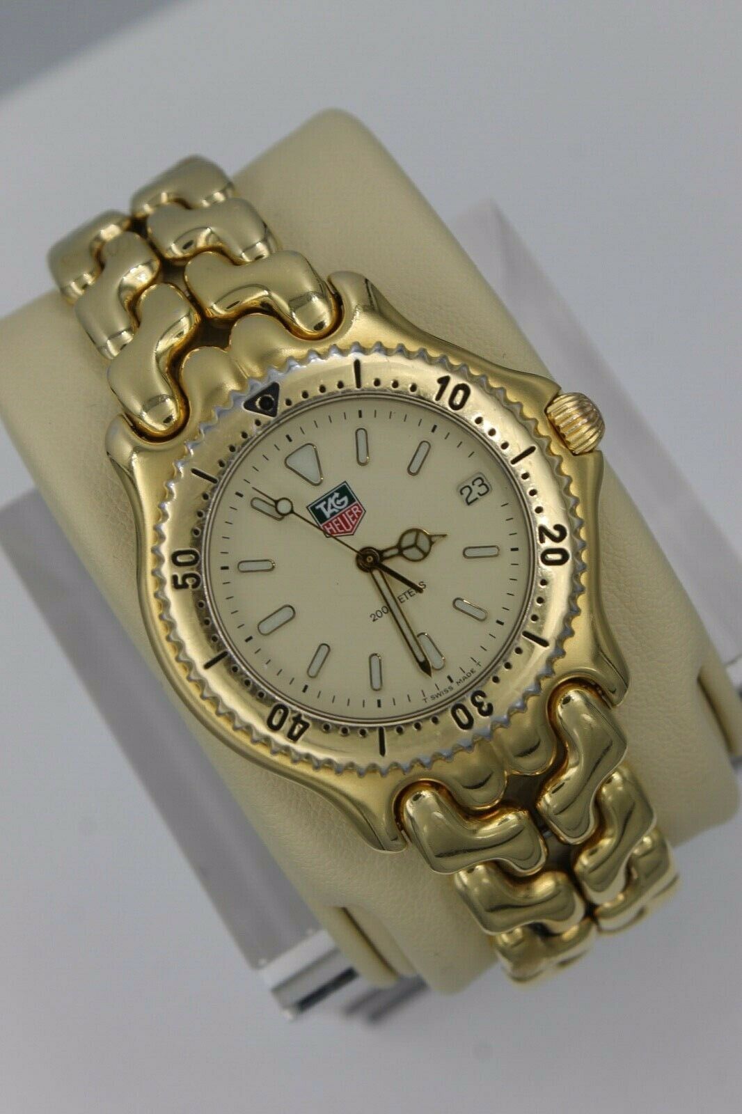

Would anyone know when TH S94.706 WG1130.BP0466 was made?
Thanks,
henrylr

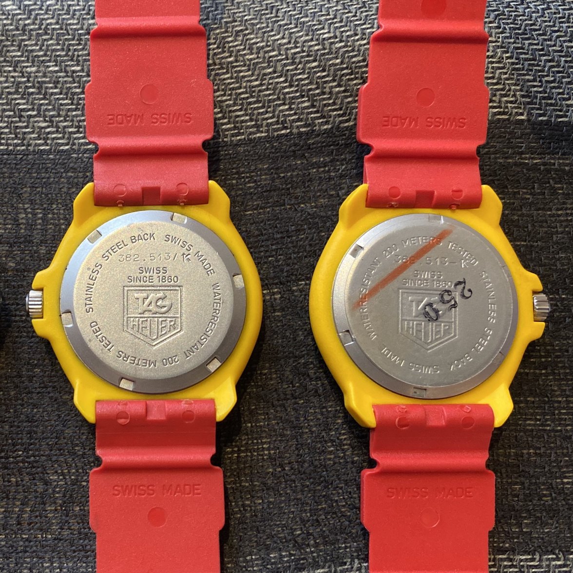

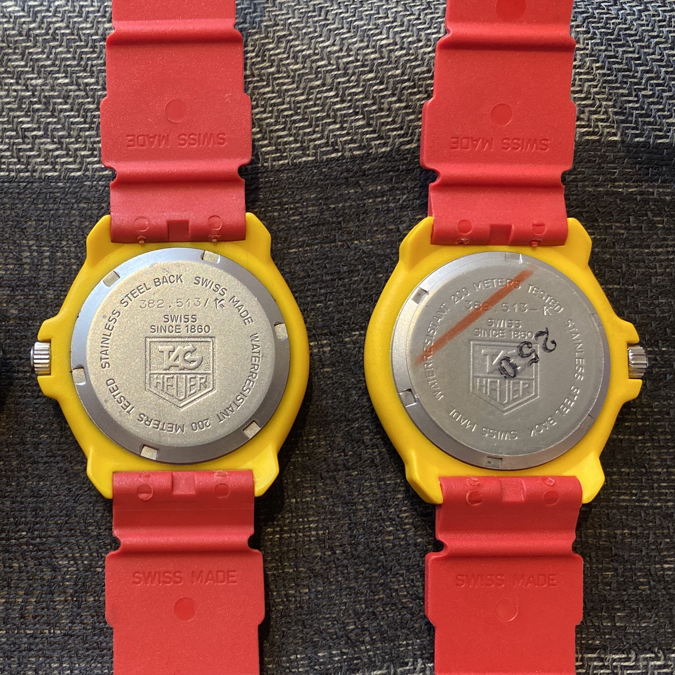

I found something interesting, so I would like to ask @Aquagraph a question because you are Reference number master.
The Katayama Ukyo model seems to have some variations.
The photo is proof, but there were the 382.513/K version and the 382.513-K version on the back cover. In the 382.513/K version, there is a mark of adding K to/1.

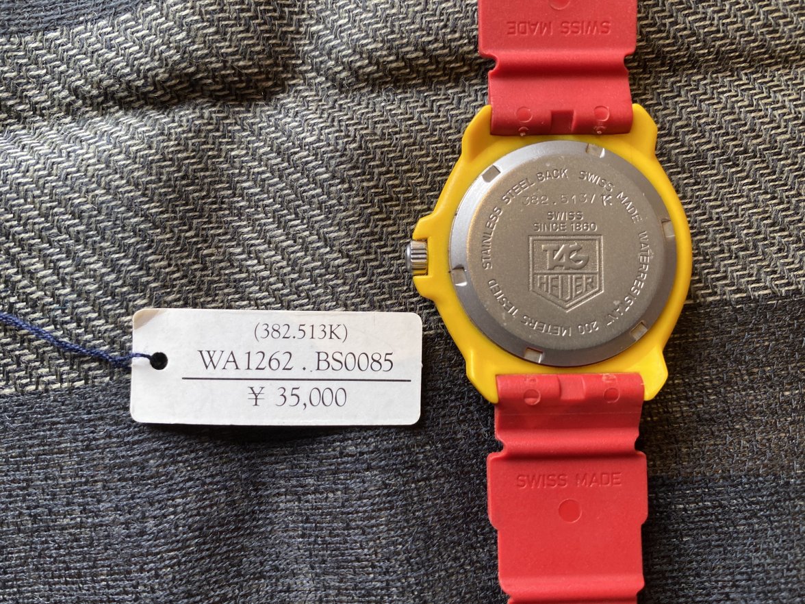

I also found the original price tag. There was a description of WA 1262.BS0085 other than 382.513K here. I hope it will be the source of your blog's revision.
23,591
34,127
Interesting! So here we have confirmation of the new code for the U/K model.... so it needs adding to this list!
Are these your two F1's Snowy? (as we know you are hoarding them)...
It seems odd that they would bother to give a new part number for a model that was a limited edition and was never likely to have a WA number on the backplate...
Still, clearly that's what it is - thanks for the info Snowy, I will amend the History of the F1 Era One (again)!
458
2,221
I am very happy to see the updated article👍
As you guessed, WA1262 was not swung on the watch as the actual part number. The Katayama Ukyo model was released in 1992, and it coincided with the renewal of the model number, so I think only the price tag was renewed.

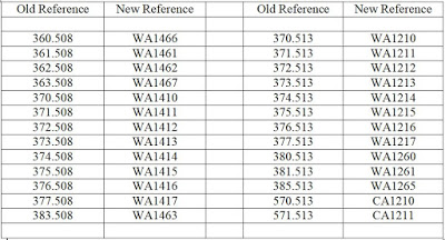

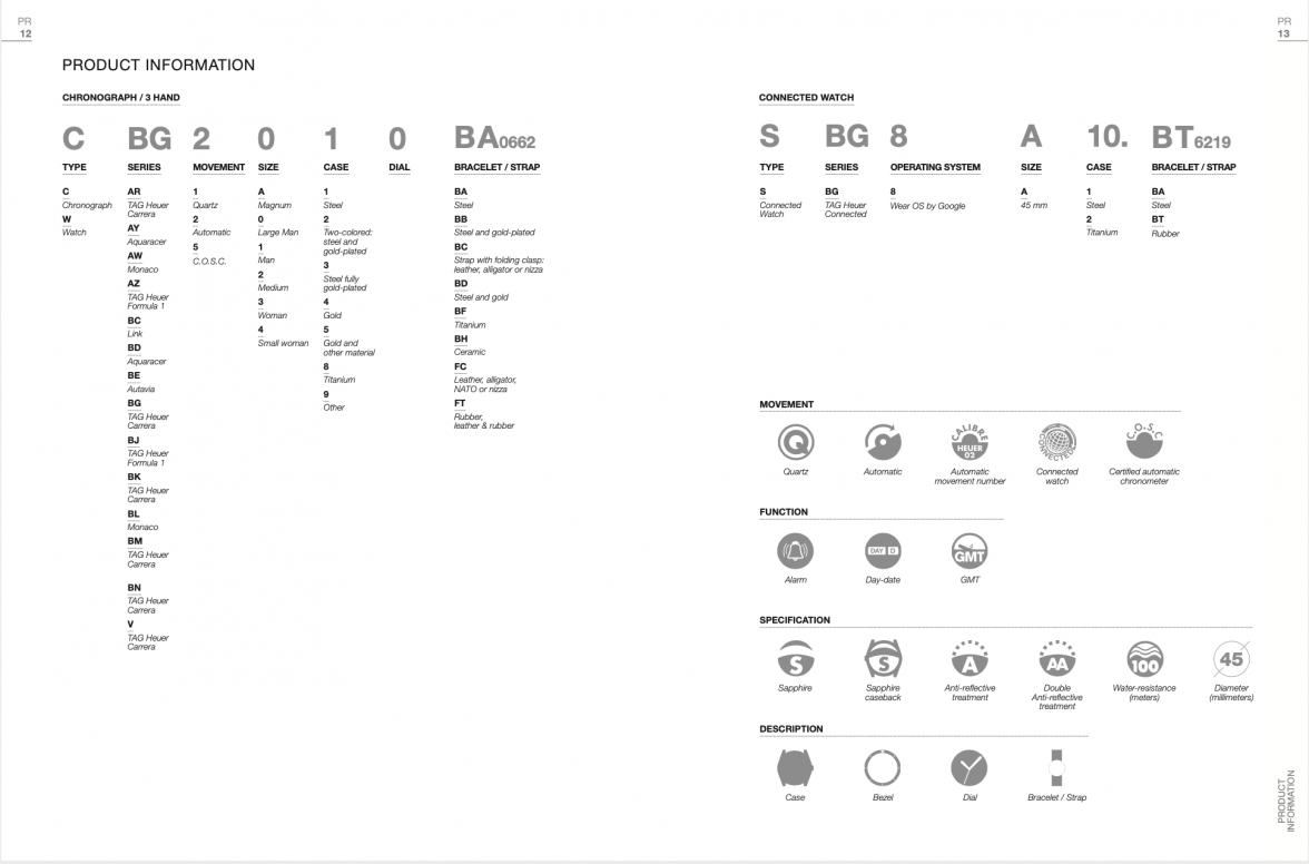

Does anyone have a newer/more comprehensive version of the codes? This one is from the 2018/2019 TH Trade Catalogue:
7,124
15,117
This is from 2020
