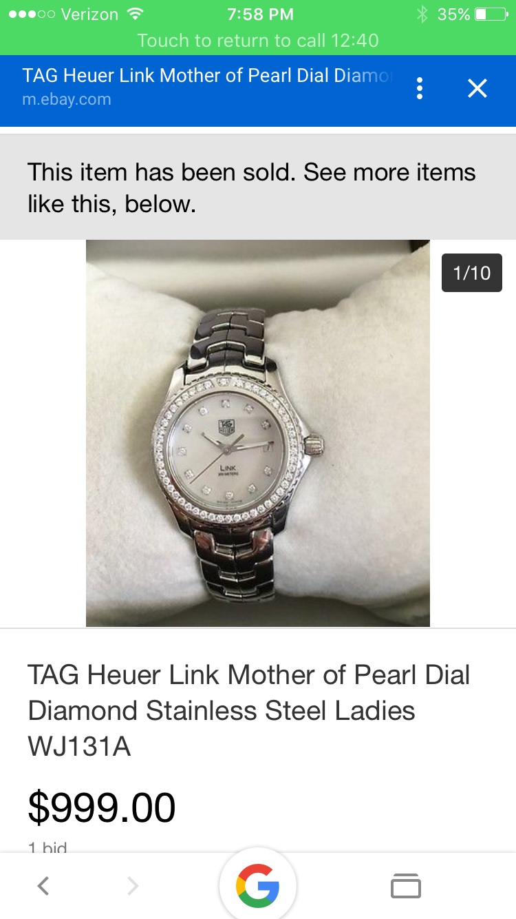

Do a Google Image search for 'tag heuer wj131a' and you'll see plenty of pictures that look like your watch.
6
Yes it brings up my watch (It brings up other watches as well)
But I did find another sold watch on ebay and it is identical to mine and has the same model #.

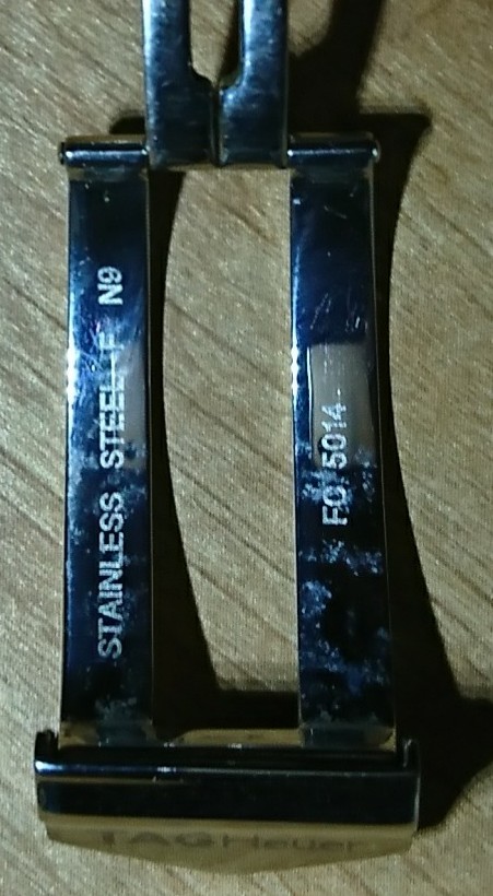

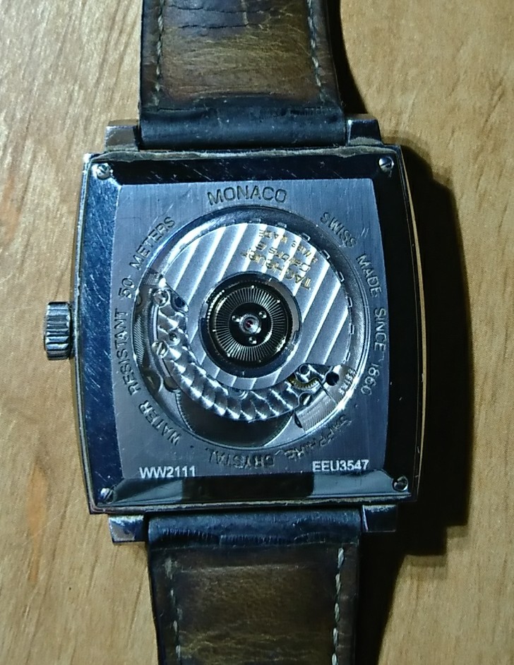

Hi - new to the forum and TAG ownership although have long admired them. Recently I purchased a lovely Monaco calibre 6 Ww2111 that needs a little TLC, nothing major just some polishing and the strap is a little tatty. I want to replace it, and bring the watch back to its original specs and former glory. Usually I see the ww2111 Touted with the fc6204 suffix on the net, although this does not appear anywhere on my watch. From the info in this thread, and others, this would be a Monaco calibre 6 leather /alligator strap.( as appears to be fitted) . But unsure as to the exact meaning of "204 ", although I know the watch was availble with blue or black, alligator or leather straps. Where it gets a bit strange is that on my watches clasp it has FC5014 stamped, along with F N9, according to the table above this is a calibre 5 alligator strap. Does this mean that the strap and clasp have incorrectly been replaced at some time? Does this affect the resale value?
The table above does not seem to have many calibre 6 straps. . Was the same buckle used between models?
Any help greatly appreciated, as I've about exhausted my ability to uncover further information.
3,262
2,344
6204 doesn't really mean anything. It is the unique code for the leather strap fitted to your watch. You will never see this code on the back of the watch. F = folding clasp and C = Leather/Alligator/Croc.
On the clasp FC5014 means it is a TAG Heuer branded, stainless steel clasp that fits a 2mm thick strap.
HTH.

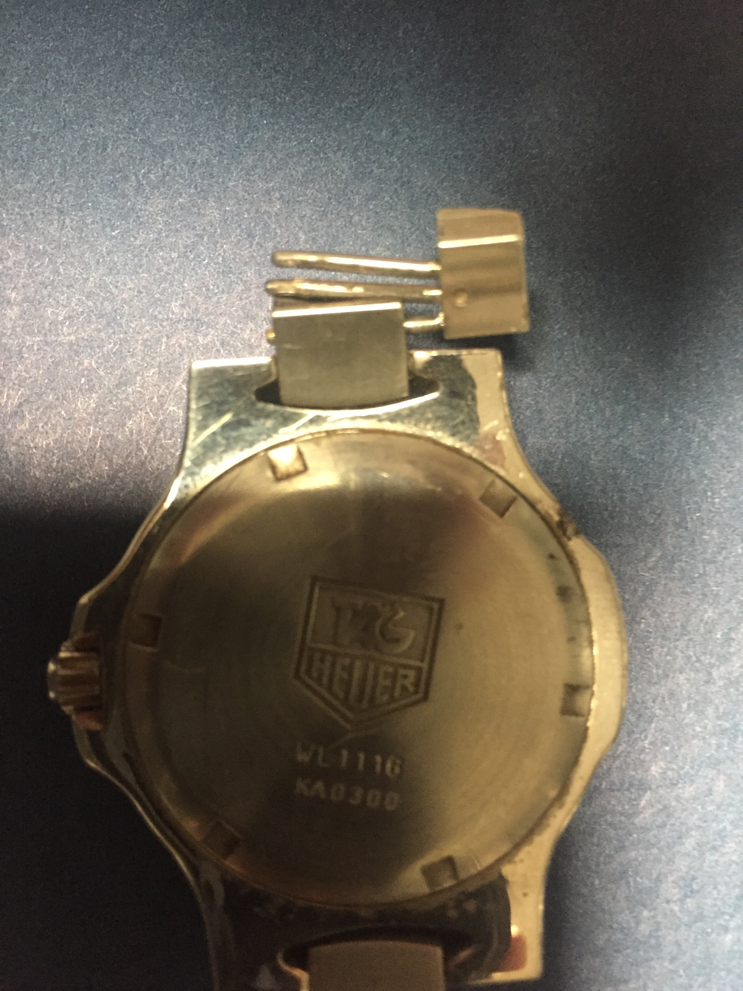

I have a tag with a model WL1118 and a serial of KA0300. I am trying to identify in order to replace the band as it has a broken clasp

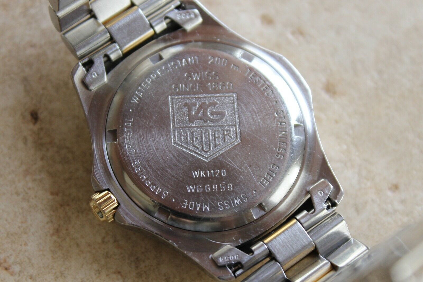

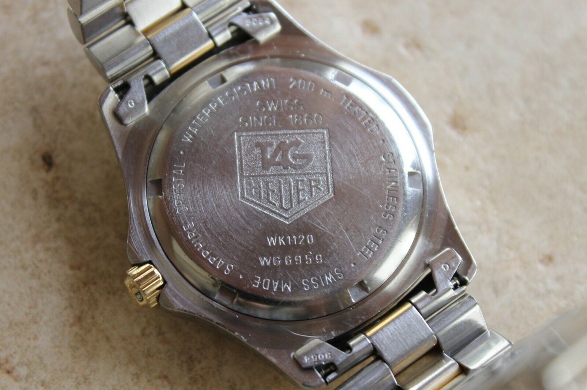

Hi all,
I'm considering buying a 2000 series quartz and the number on the back is WK1120. Does anyone know when it might have been made and what caliber movement it has? It also has WG6959 below the model number. Please see pics.
Thanks,
henrylr
309
693
Made 1996-99. Don't know about the movement.
