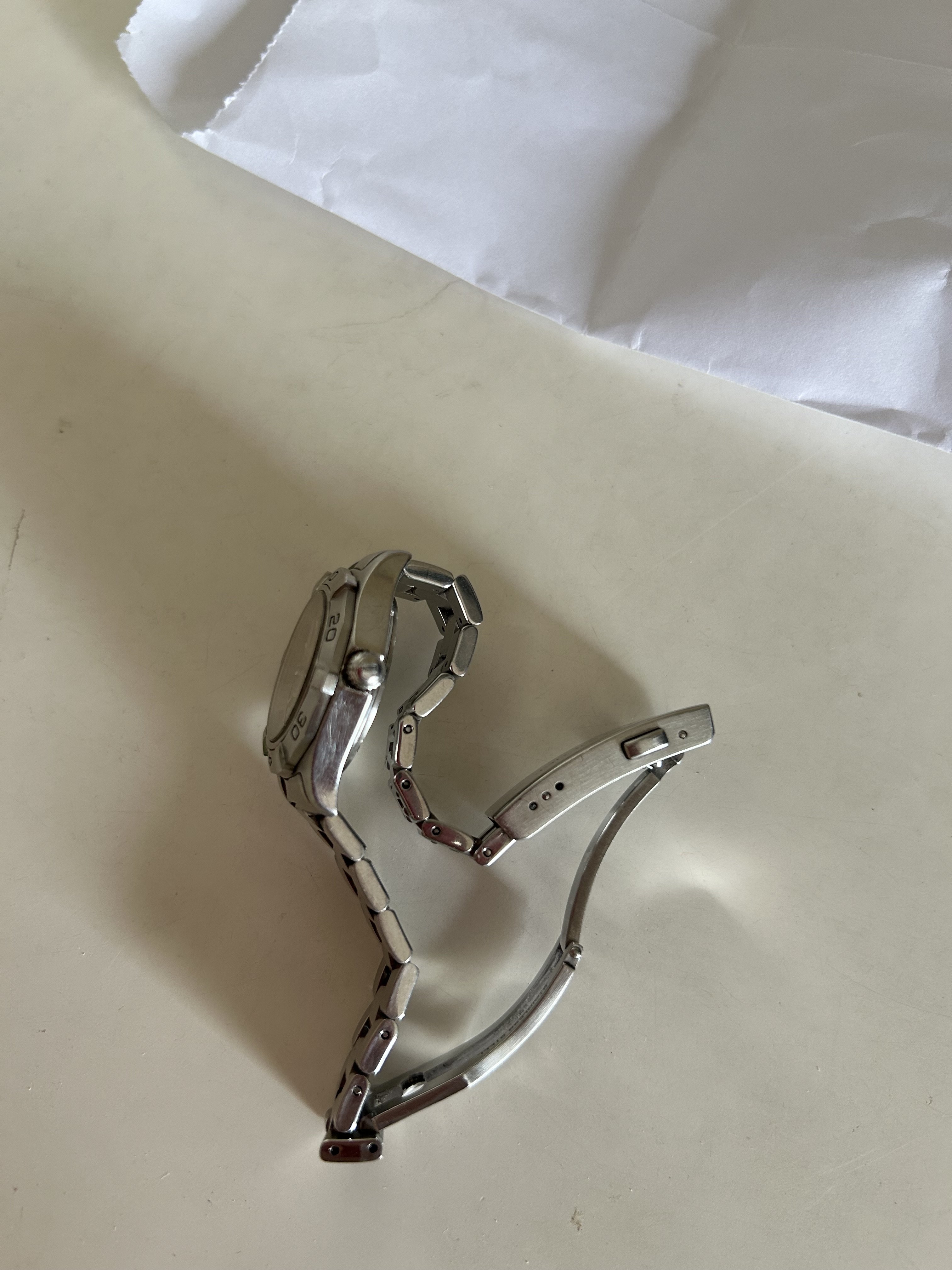

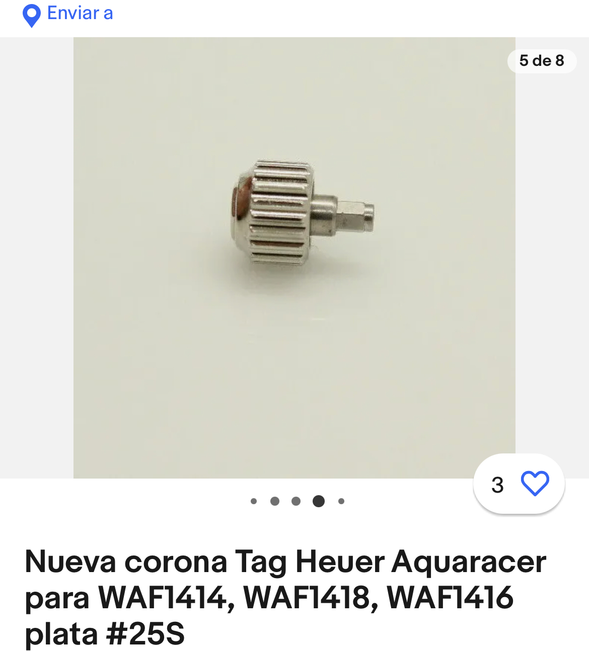

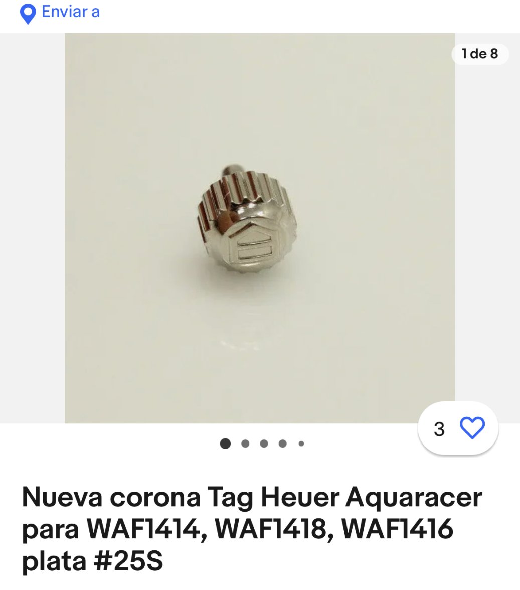

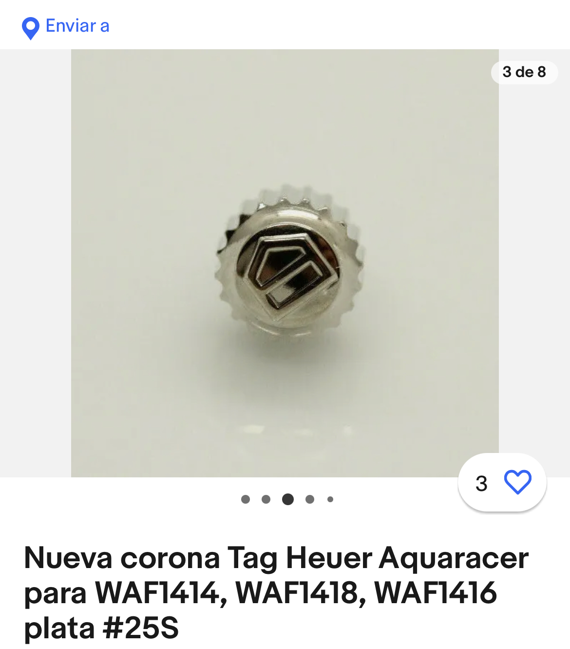

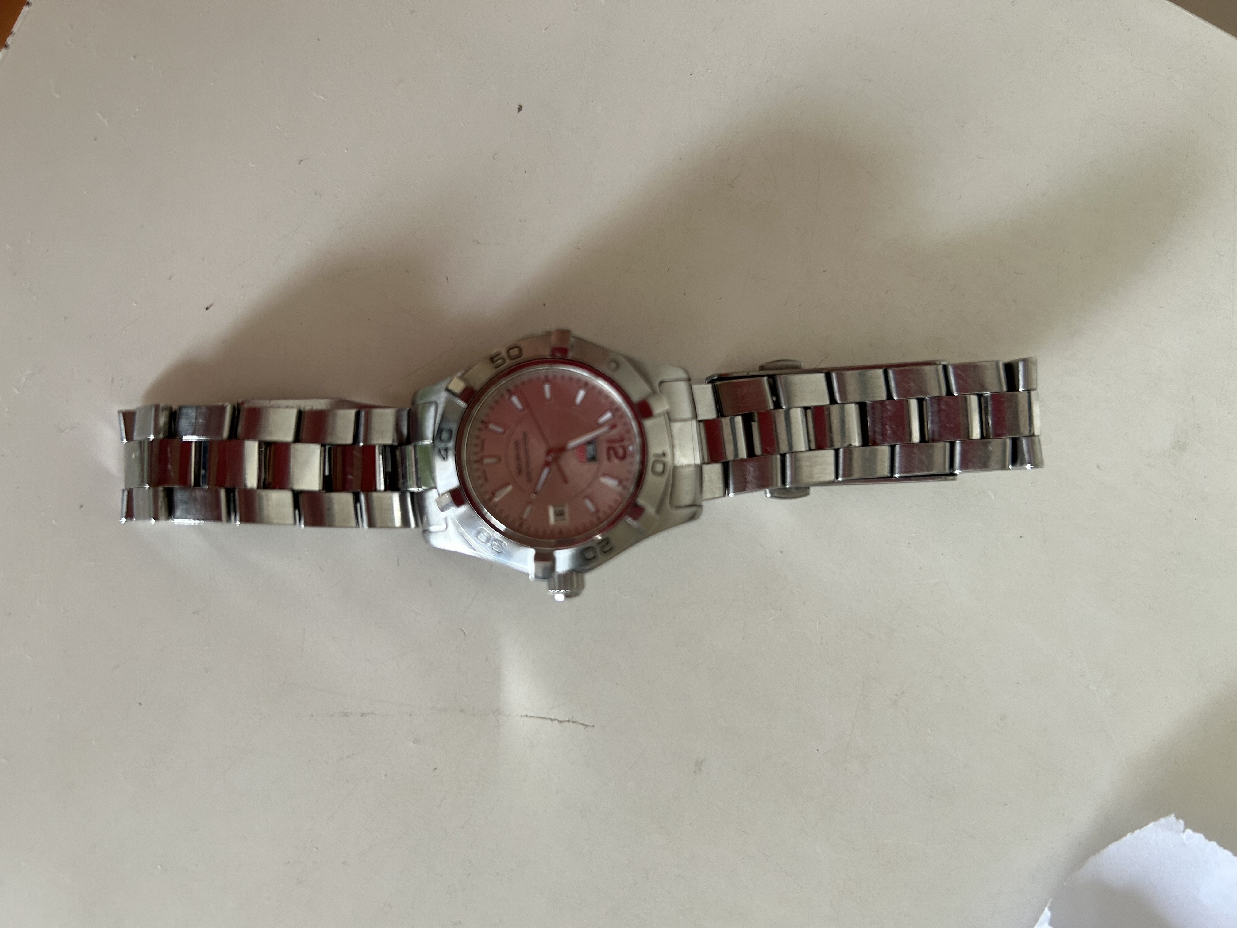

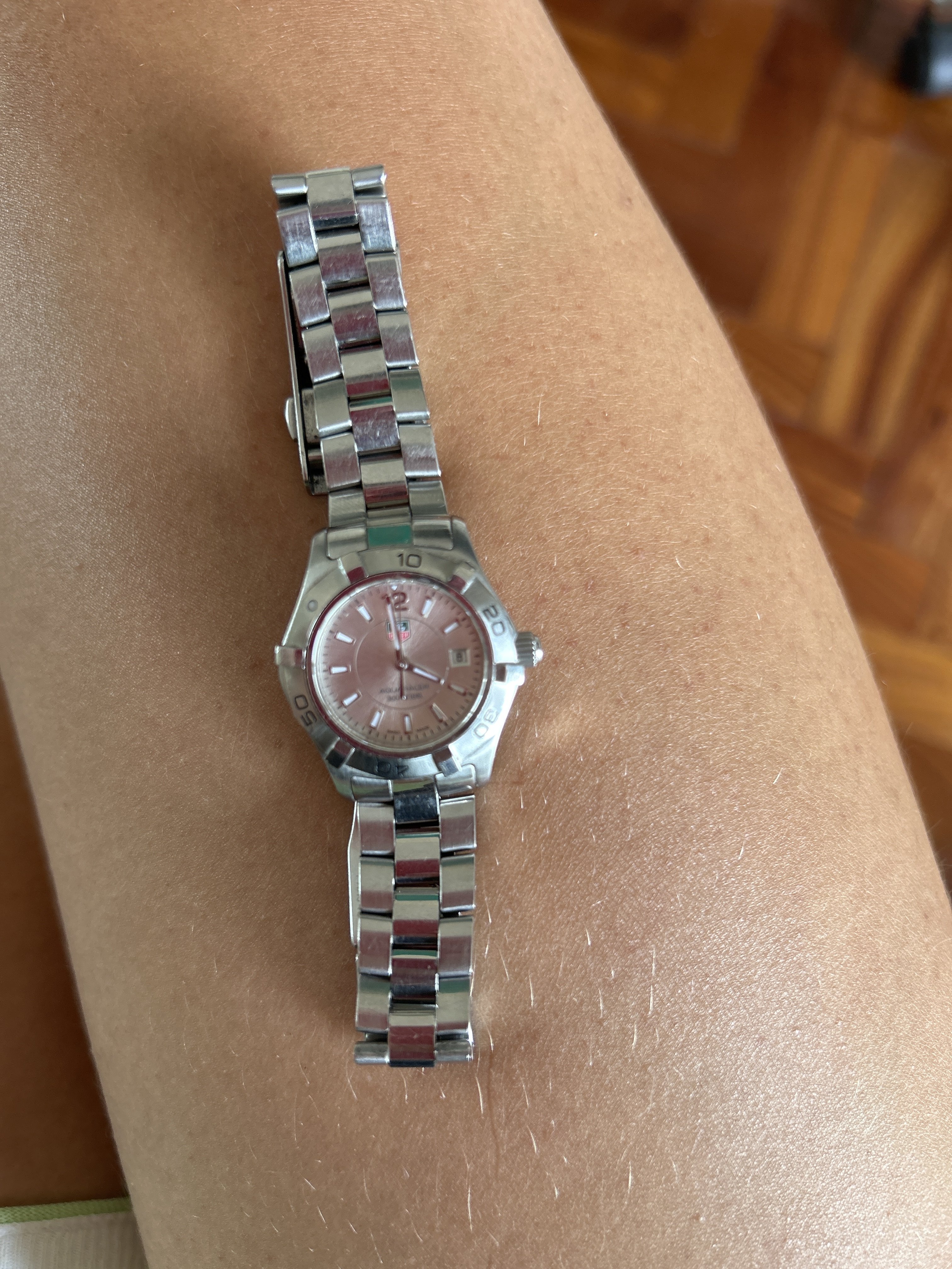

Hello!
I’m looking for a crown replacement for my Tag Hauer Aquarracer and I found one (original from Tag Hauer) on ebay that is for WAF1414, WAF1416 and WAF1418.
Mine is WAF1412. Does anyone know if it will work too? I’d really appreciate any type of help.
Thanks in advance!
768
1,009
Hello!
Thanks in advance!
Are you just replacing the crown, or the crown and the stem?
Can you provide pictures of your existing watch, and the replacement you have found?
7
I think it’s just the crown, though I should double check with my “watch technician” (idk if that’s how they are called)
I’ll provide pictures
768
1,009
It appears to be correct, but yes: you should double check with whoever is doing the work on it, just to be sure.
The difference between WAF1412, WAF1414, WAF1416 and WAF1418 should just be the dial design. Occasionally, there are other variations - including slight differences in crowns.
7
Hmm so maybe it could be the case that they did slight differences in the crown and there’s a slight possibility that it might not work?
768
1,009
There is a possibility, yes - it's a very small chance however. I'm not personally familiar with the model, but having looked at a lot of WAF121x variations online the only differences on the crown I've seen are due to aftermarket polishing.
If you show the listing for the crown to your watchmaker, they'll be able to make an informed decision - based on having your watch in their hands!
