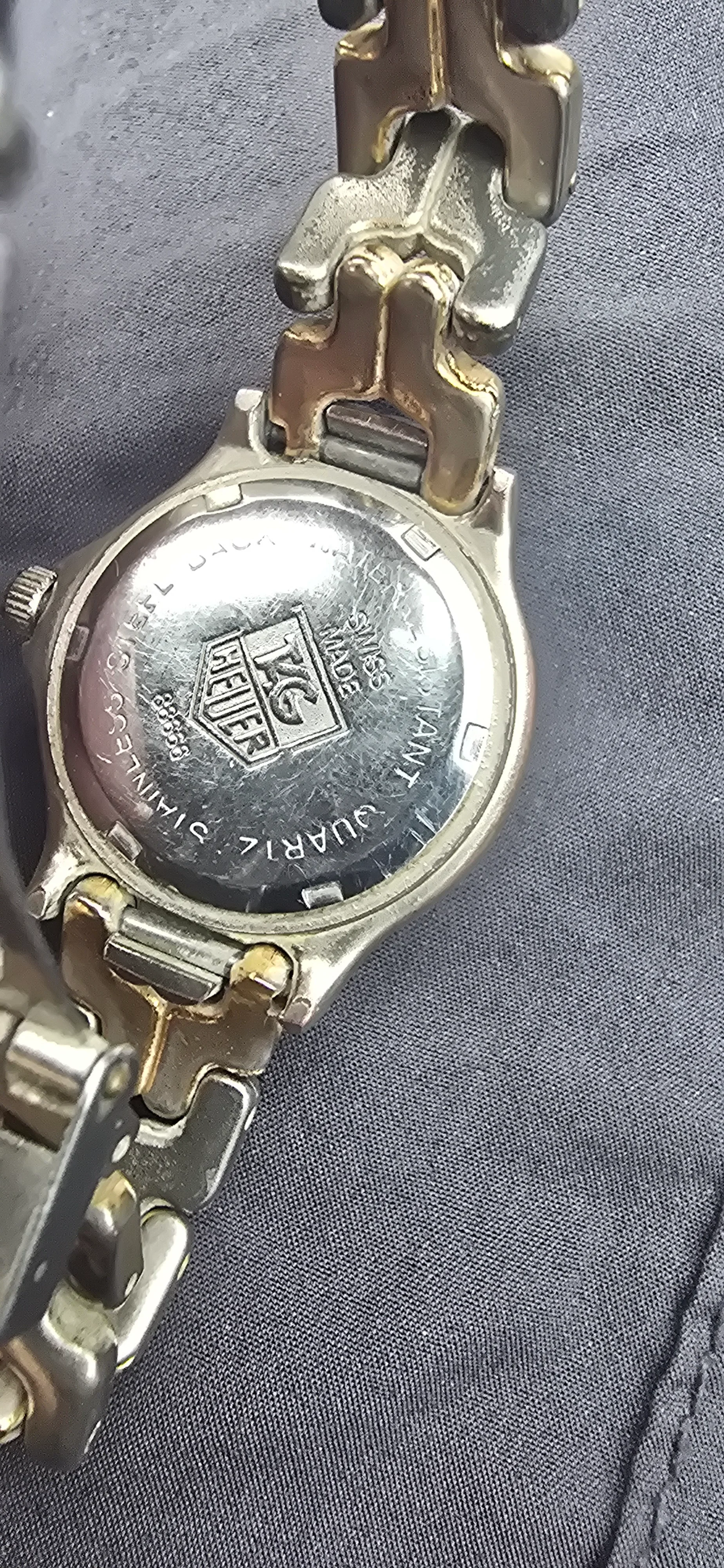

Hi, I’m hoping someone here can help me identify/place a value on this watch. There are two codes on the back, the bottom one appears to be S95206K. There is also a vertical code to the right, it appears to be A52649.
Any help would be greatly appreciated, thank you!
Lizi
9,418
19,283
Yes, it's over 30 years old. The S95 designates it as a S/EL (Sports Elegance) model, the 206 means a gray dial. The vertical number starting with an A is the serial number.

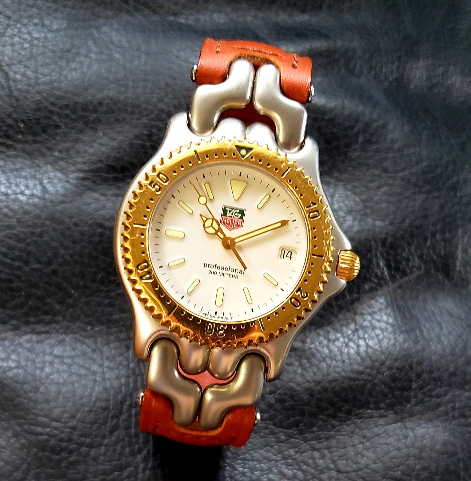

I also own a S95, mine is a S95.806K, white dial. Bought it new back in '90 or '91. Here's mine:

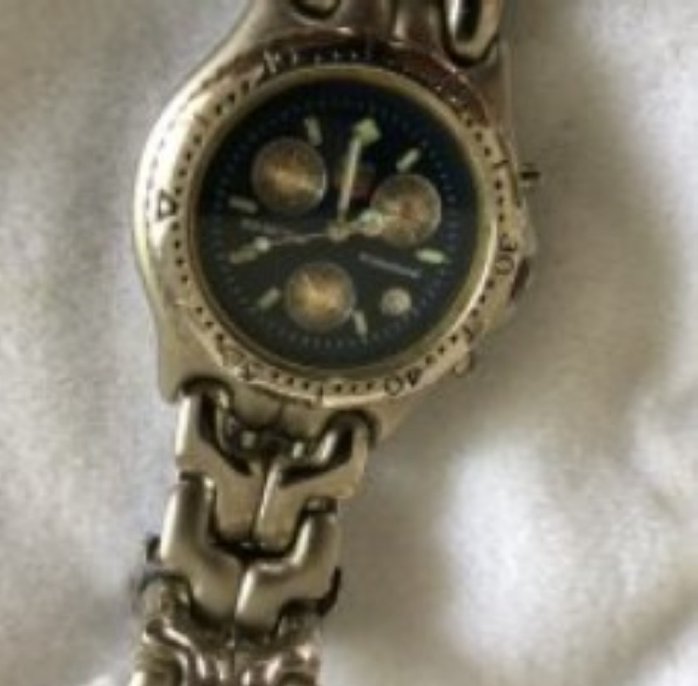

Hi Lizi
If your watch is the one pictured in your avatar then I'm afraid it's a fake.
Wow really?! What makes it a fake? Yes it is the watch in the avatar. How disappointing, I’m curious to know what makes it a fake. Thanks so much for your input.

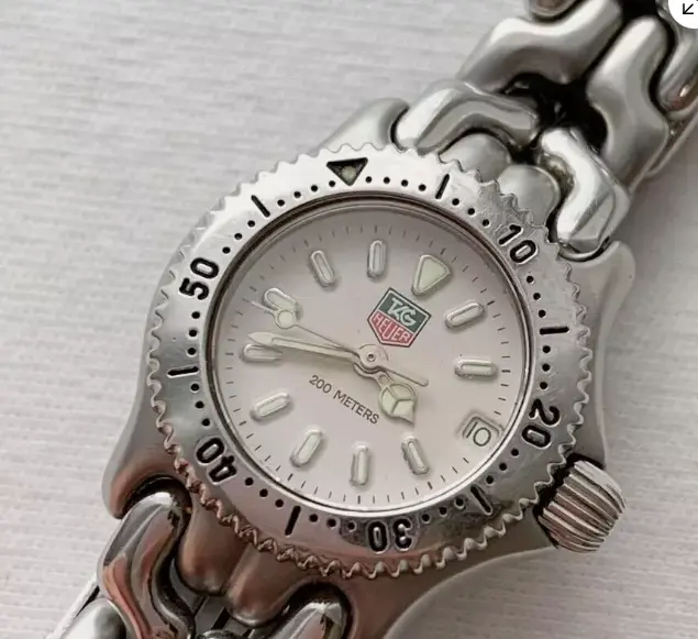

This is what a S95.206K should look like.
And also yours has the classic 'not quite right' fake SEL case shape.
The TAG Heuer logo is too big as are the subdials.
Sorry to be the bearer of bad news.

Oh…. And it looks so detailed, even the back of the watch face!
Thank you so very much, at least I know now. And thank you also for the link. I really appreciate your time 😀

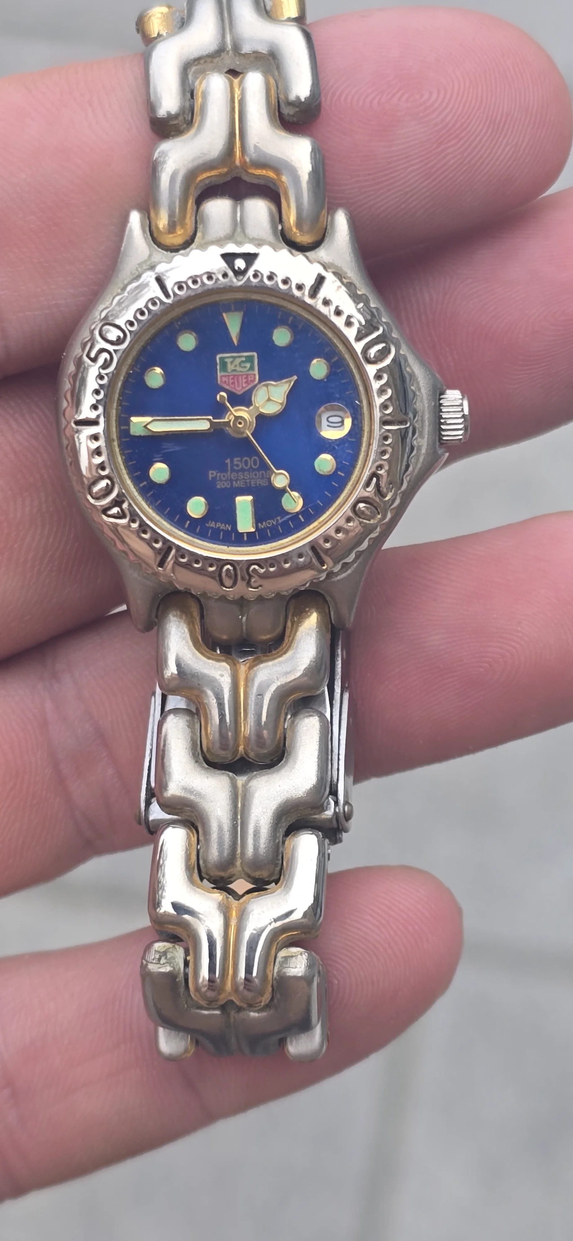

I came across this in a box of old things I purchased at a boot sale. However I don't know if it's real. Could someone help out.
3
Hi
Sorry your watch is fake.
Thanks very much. Could you please tell me what tells you that it's fake?
23,581
34,111
Sure, it's not a good fake so it's not like a small detail or anything. The general quality of the watch is poor, you just have to compare it to a photo of a real ladies S/EL. But also one of the obvious points is that the bracelet should be made of two separate parts (left and right) whereas yours the links are solid.The crown is also the wrong shape. The dial is wrong and I don't think there was a blue ladies S/EL, certainly not that tone of blue - possibly a darker one.
3
Awesome, thanks for your help. 👍
