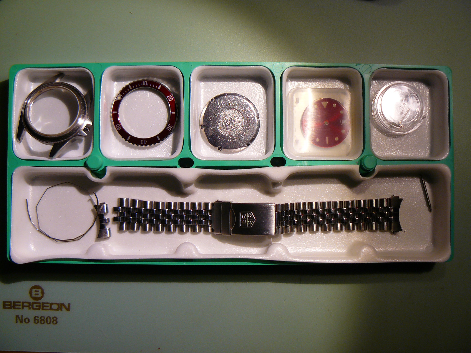

Here's a nice one I am working on, 980.913N, for my own collection of course, red dial and bezel!

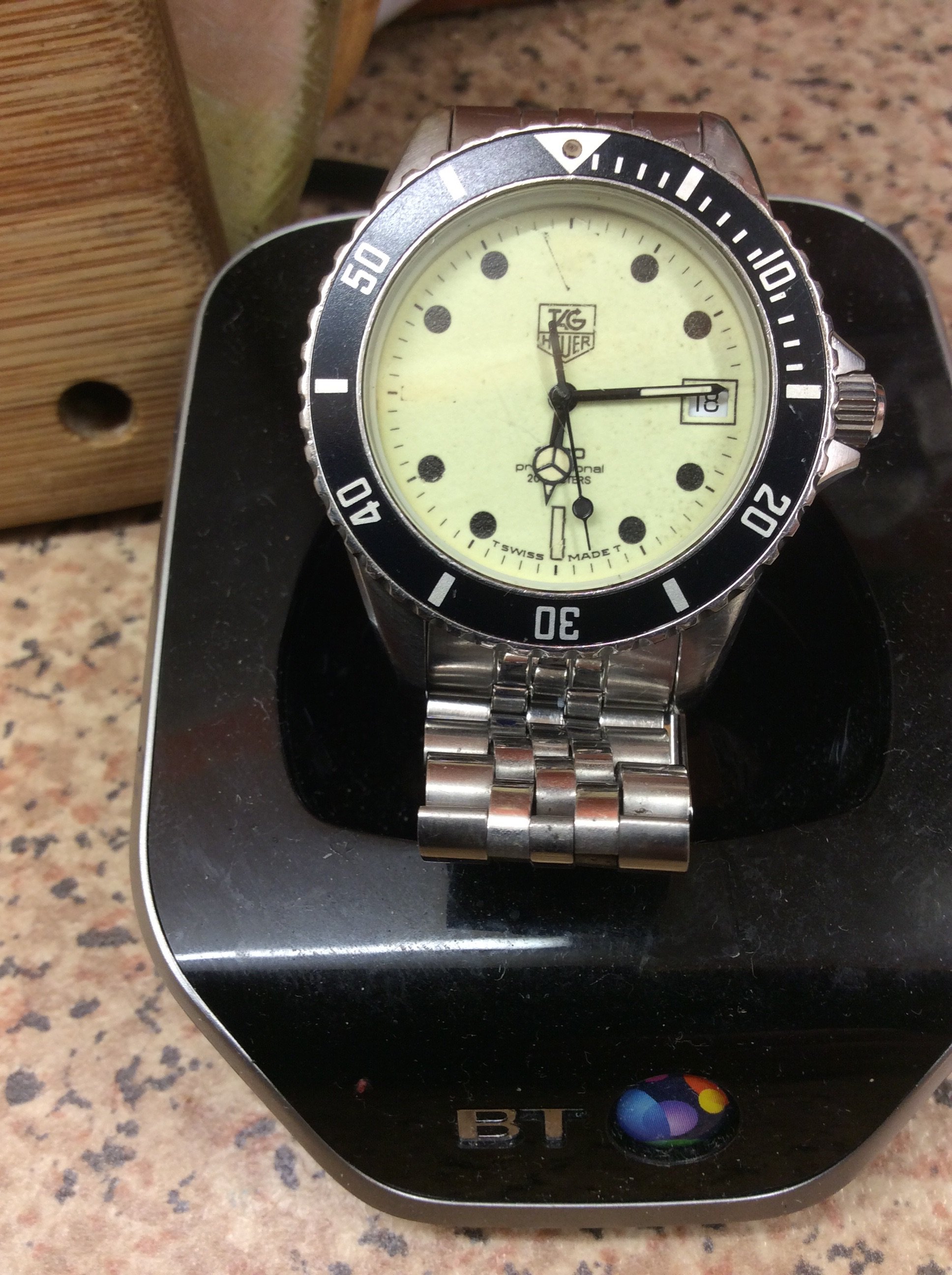

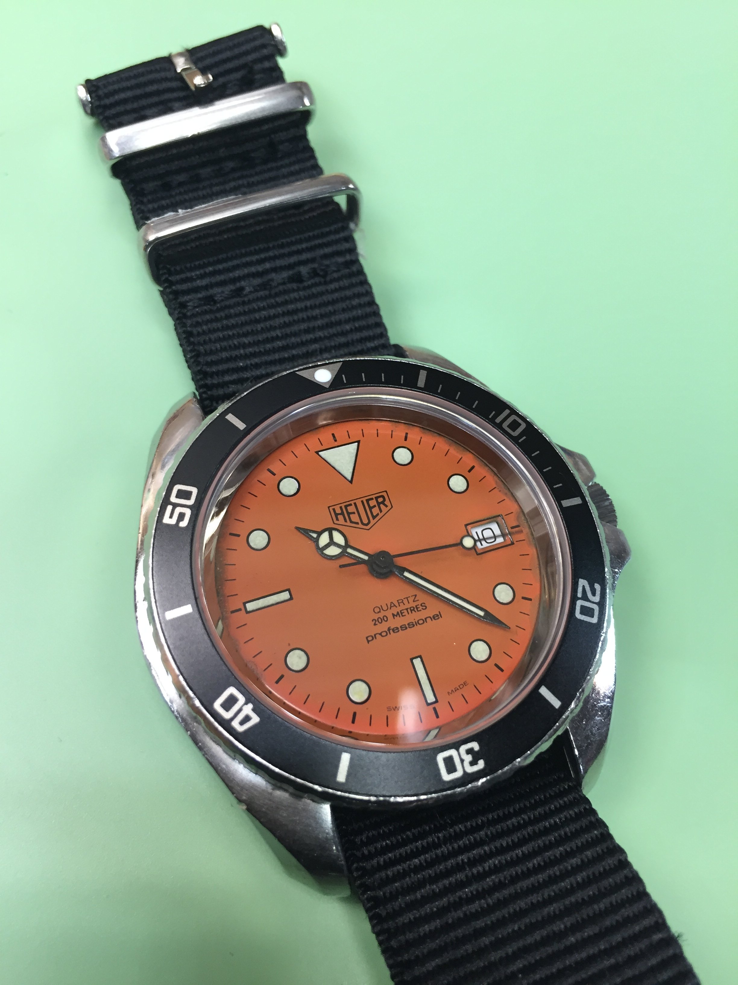

some photos if anyone is interested:
with the flash the scratches on the bezel really stand out.
more here :

Help, as I've posted in another thread my watch needs a couple of face markers, God only knows where they went over the years, I had hoped that they would appear from inside the old mechanism when removed but no. Cheers folks.
176
175
My guess would be that one of the hands has been grinding them down slowly over the years.
These are no applied indices, just paint and lume plots. You could paint the markers back and add lume to complete it. BUT that will be very hard to get a good result by hand.
