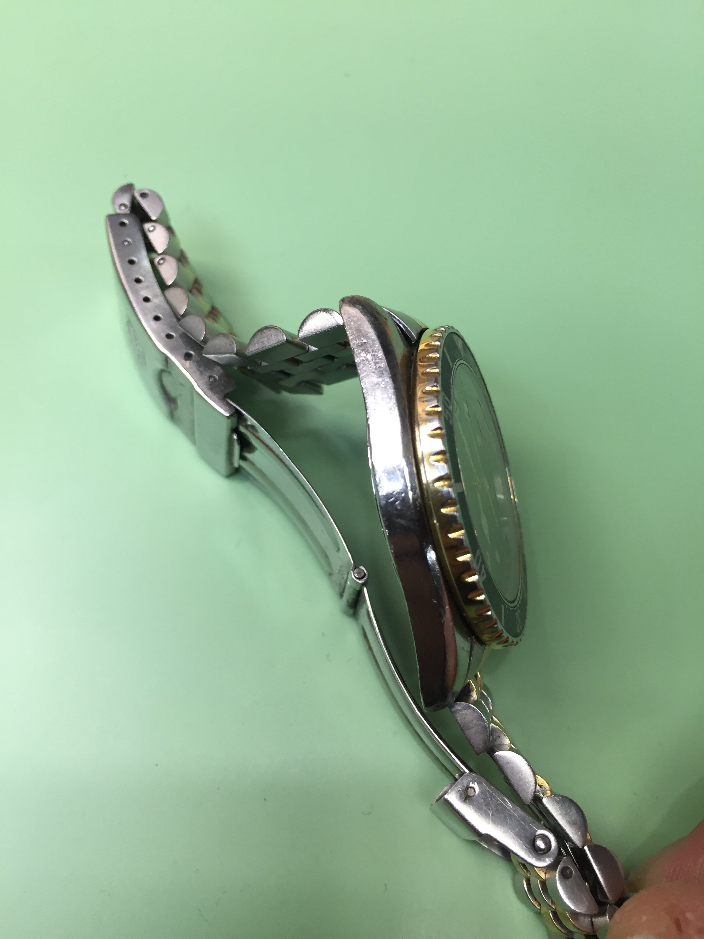

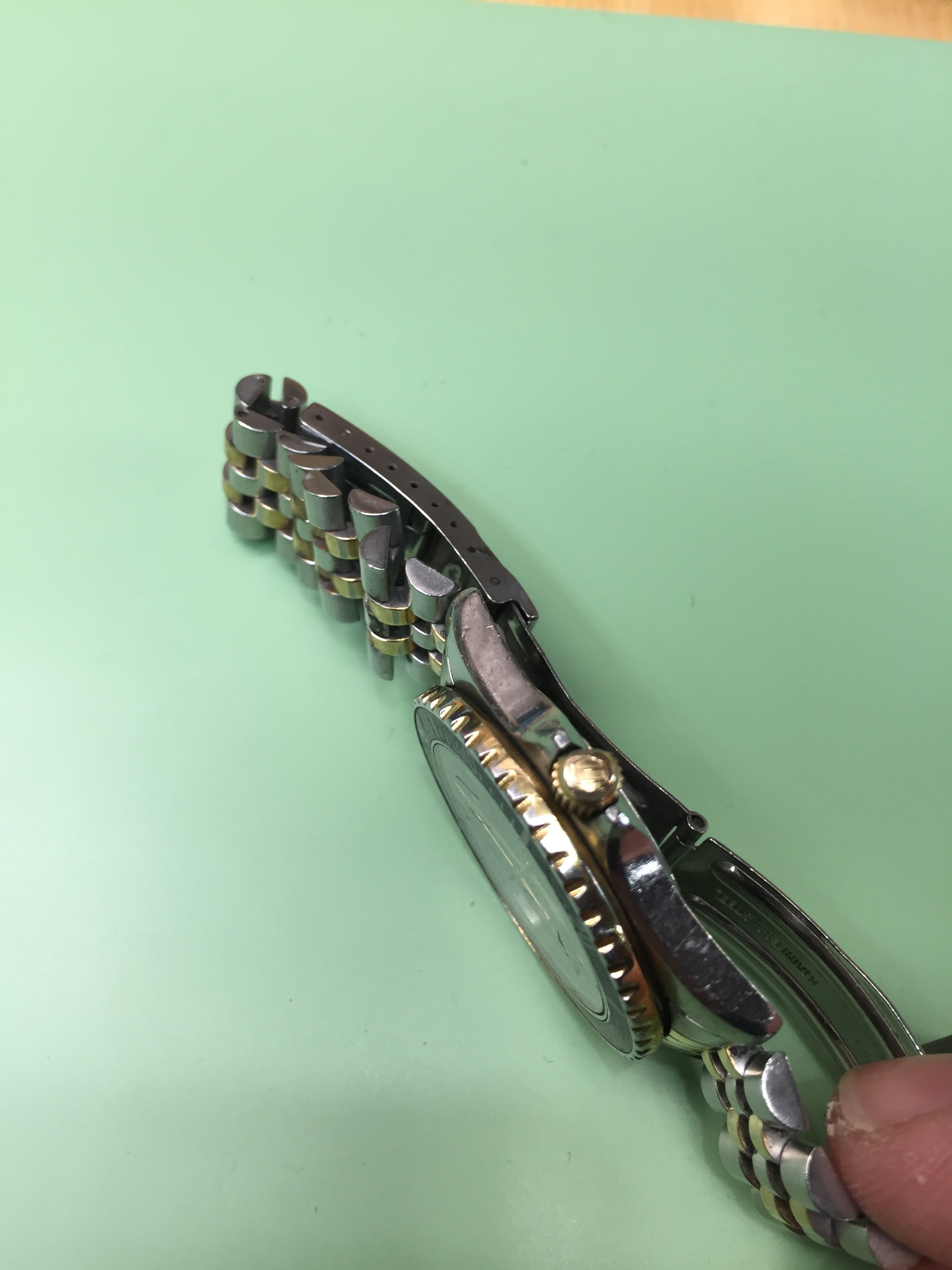

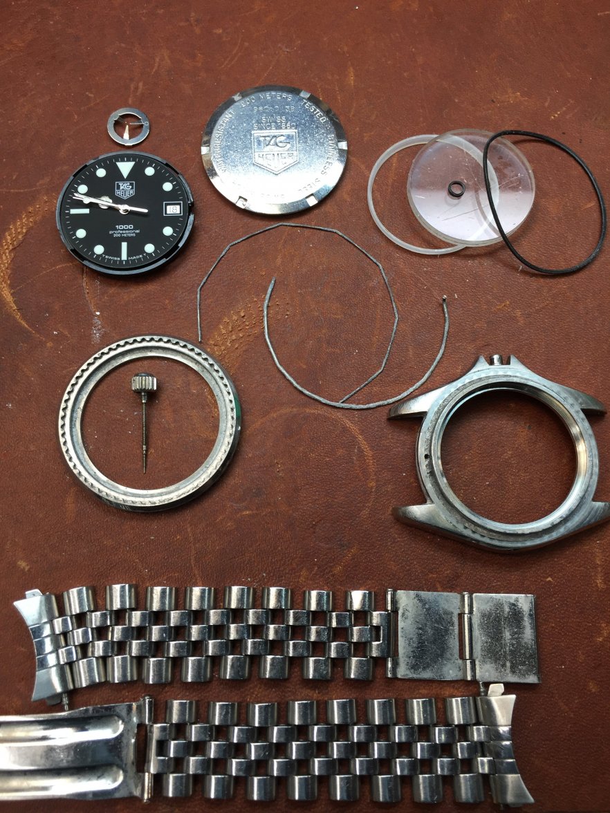

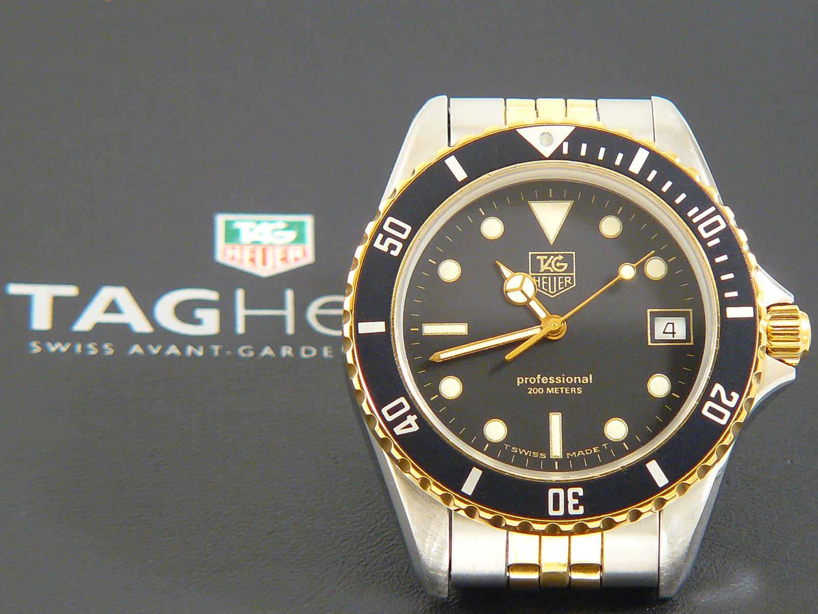

Full-size two-tone (980.020) in for a complete overhaul. Stay tuned for the after pics...

Very interested to see the afterpics, here is some of my customer work I did recently, one 980.020 and one 984.013 (orig. Wolf of Wallstreet watch)

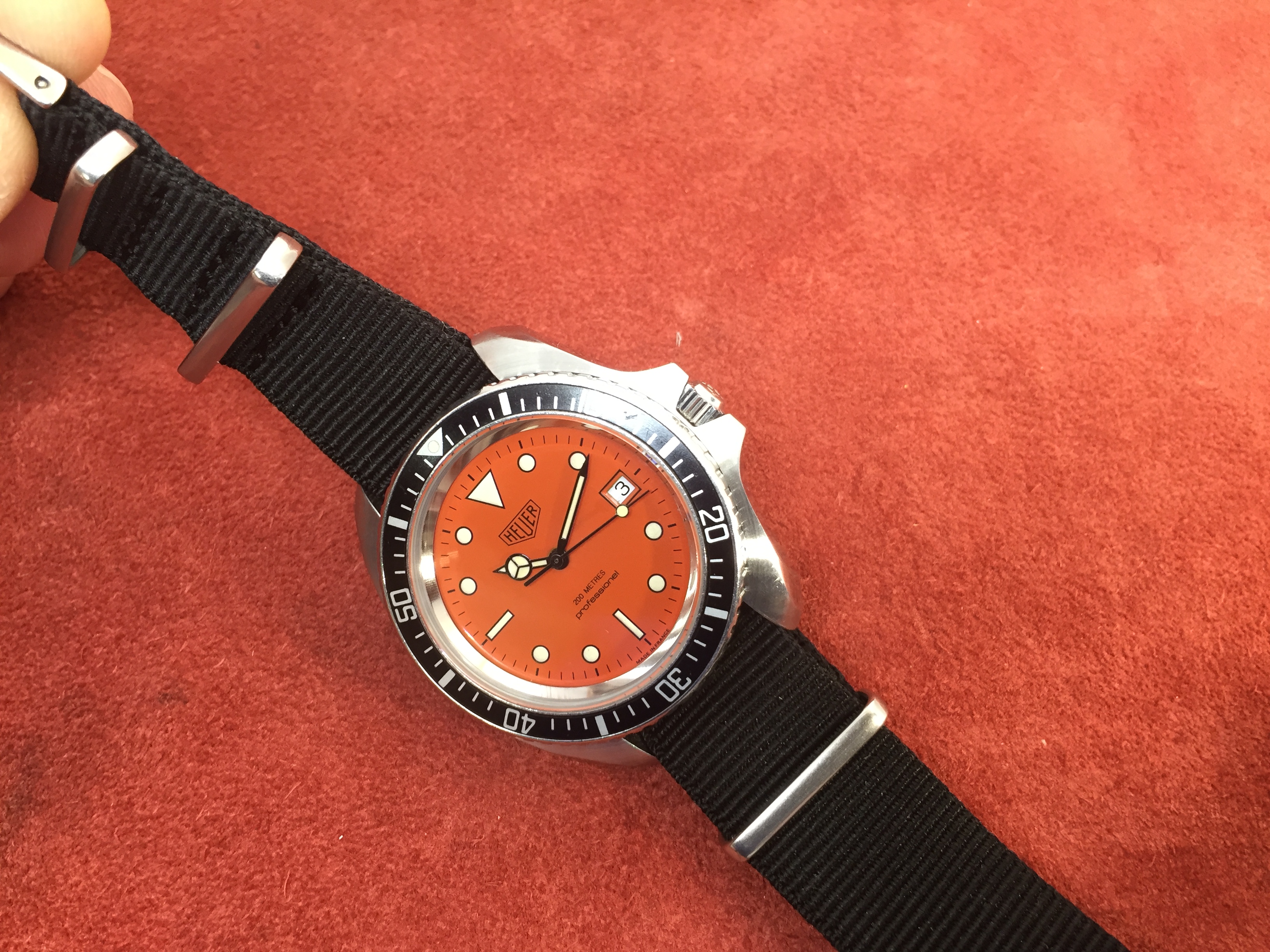

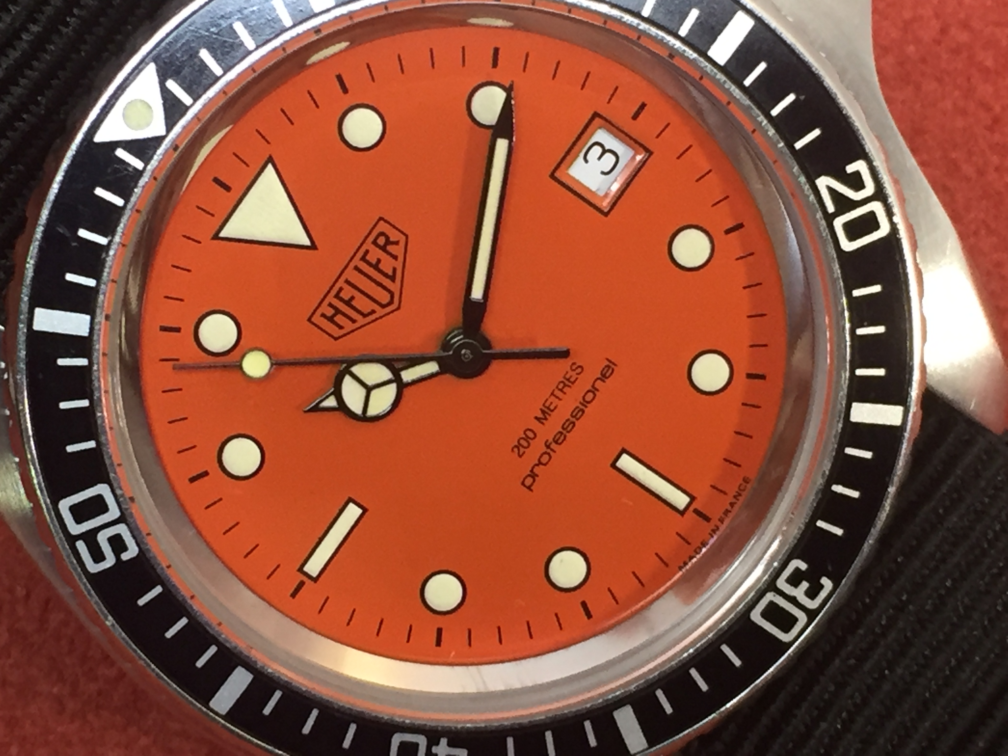

Finished this one today. In for service and some custom work for one of our good customers.

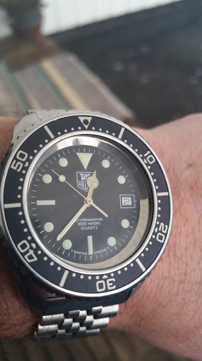

980.007 Jumbo Heuer project

Interesting print "Made in France".

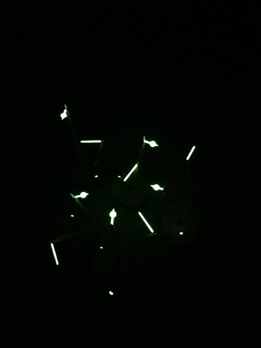

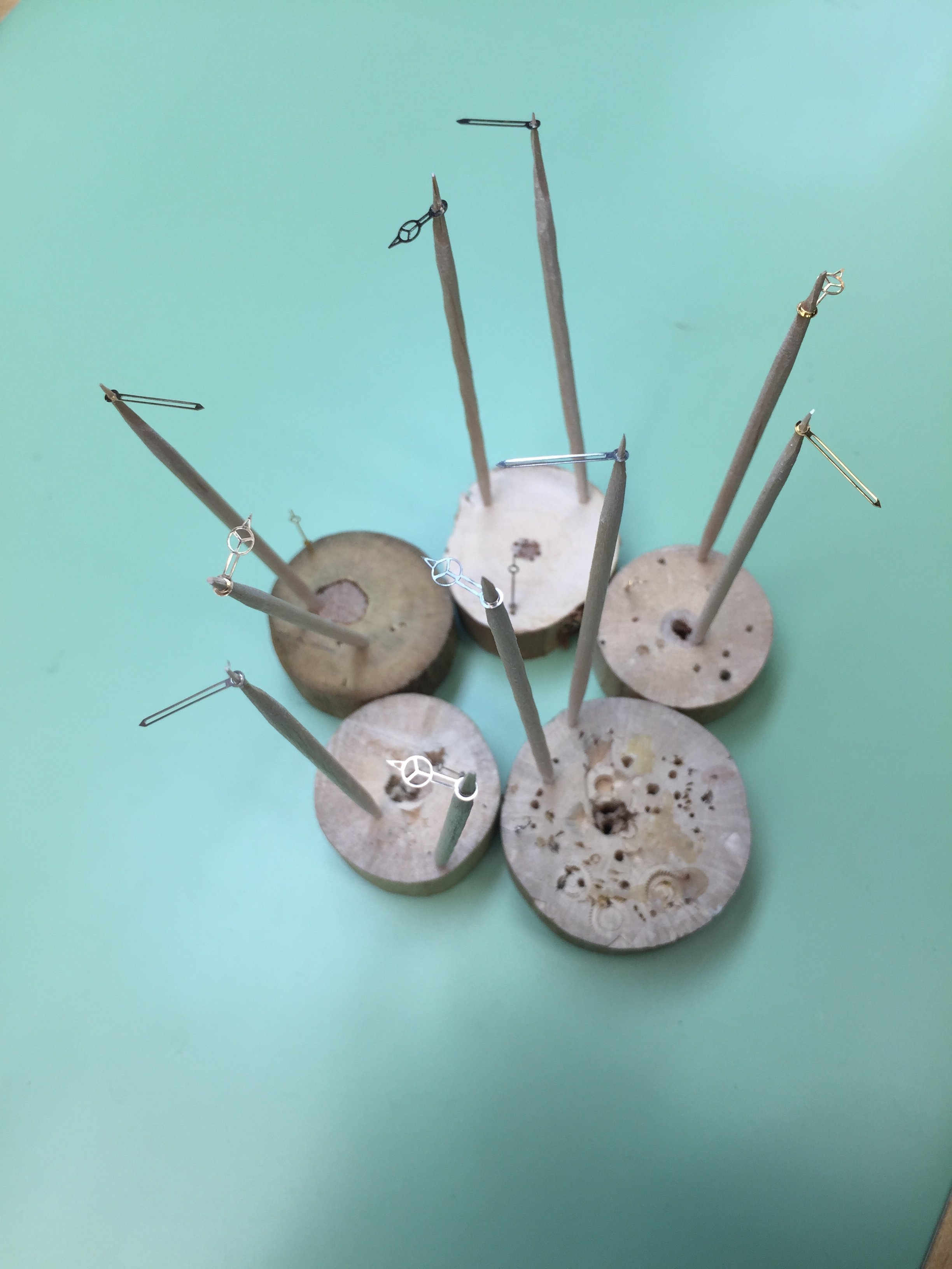

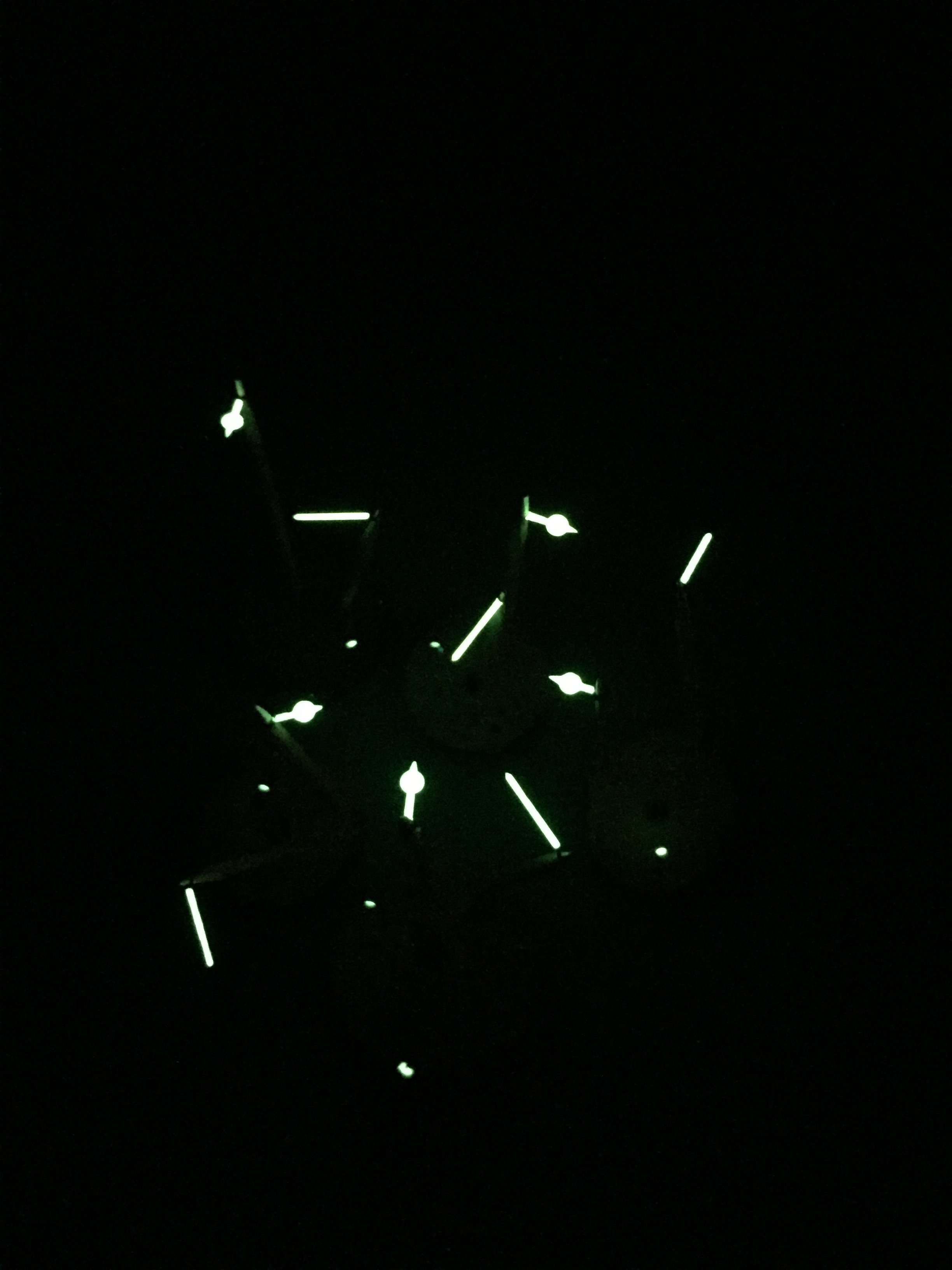

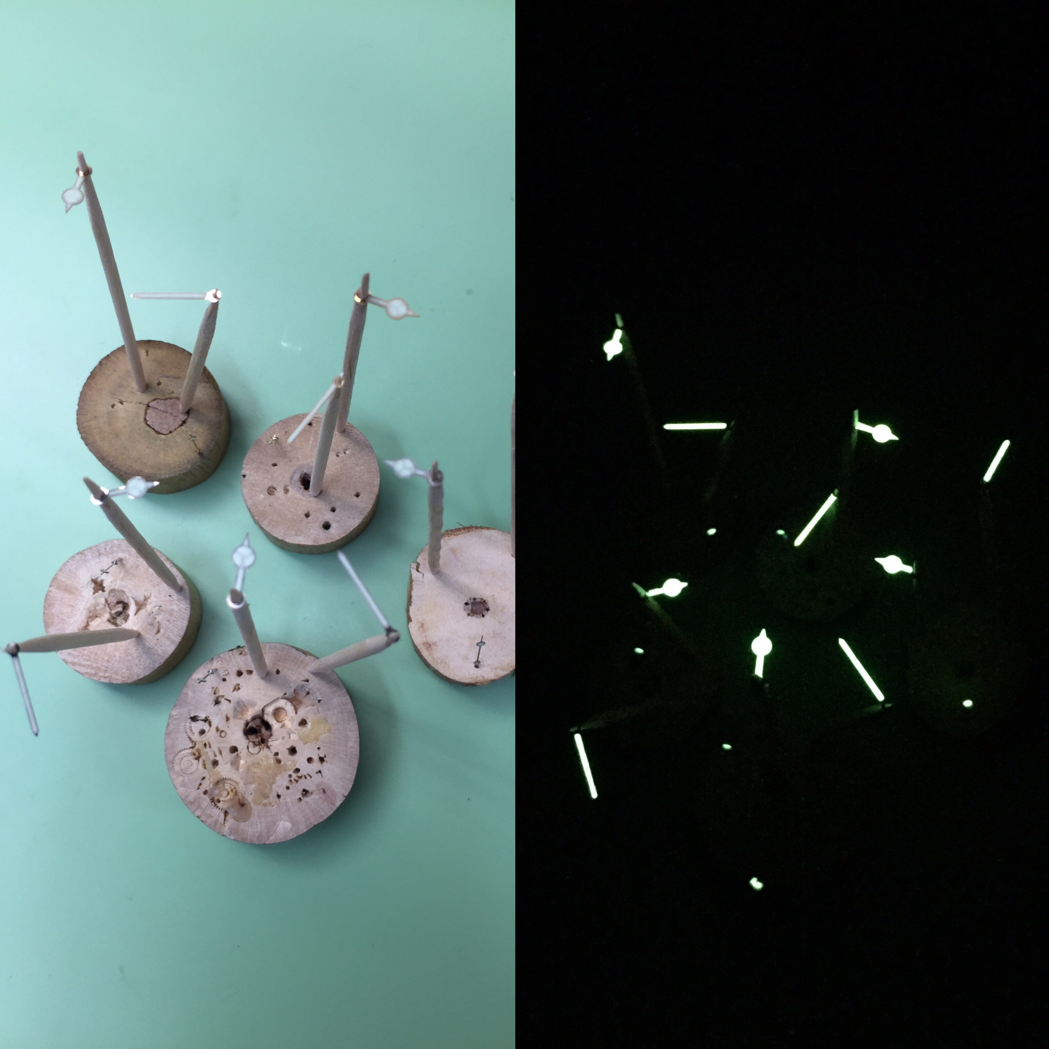

Got to do something I've been putting off for a while....hand restoration...lots of them. It takes a long time to strip, clean, polish, and lume.

Yes, this project needed a dial and the one was sourced by the owner.
The first of the Heuer jumbos were made my G. Monnin in France. This occurred for a few years until production moved to Switzerland. After the move the Swiss Made replaced the Made in France.

Interesting; keep up the good work!

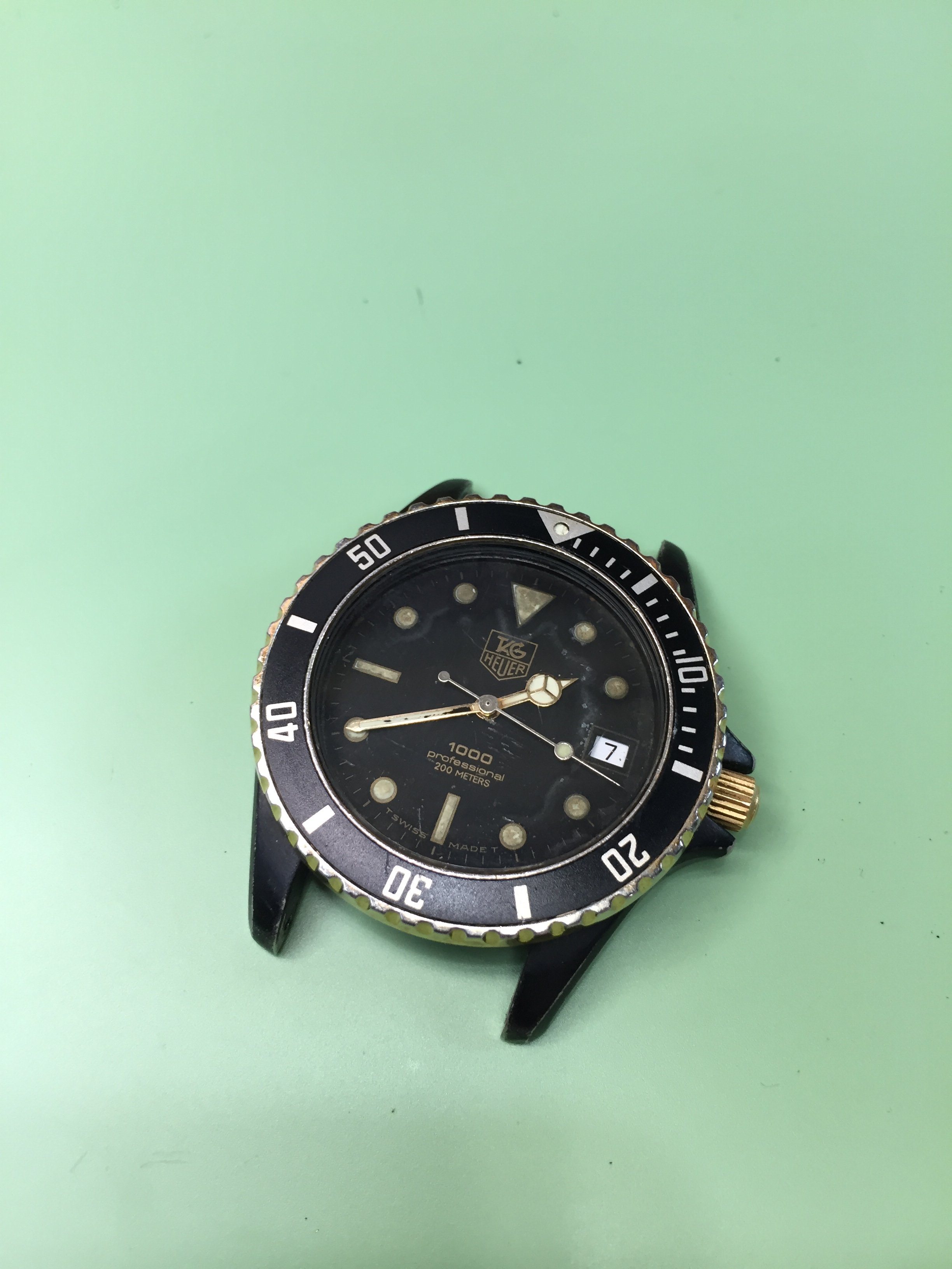

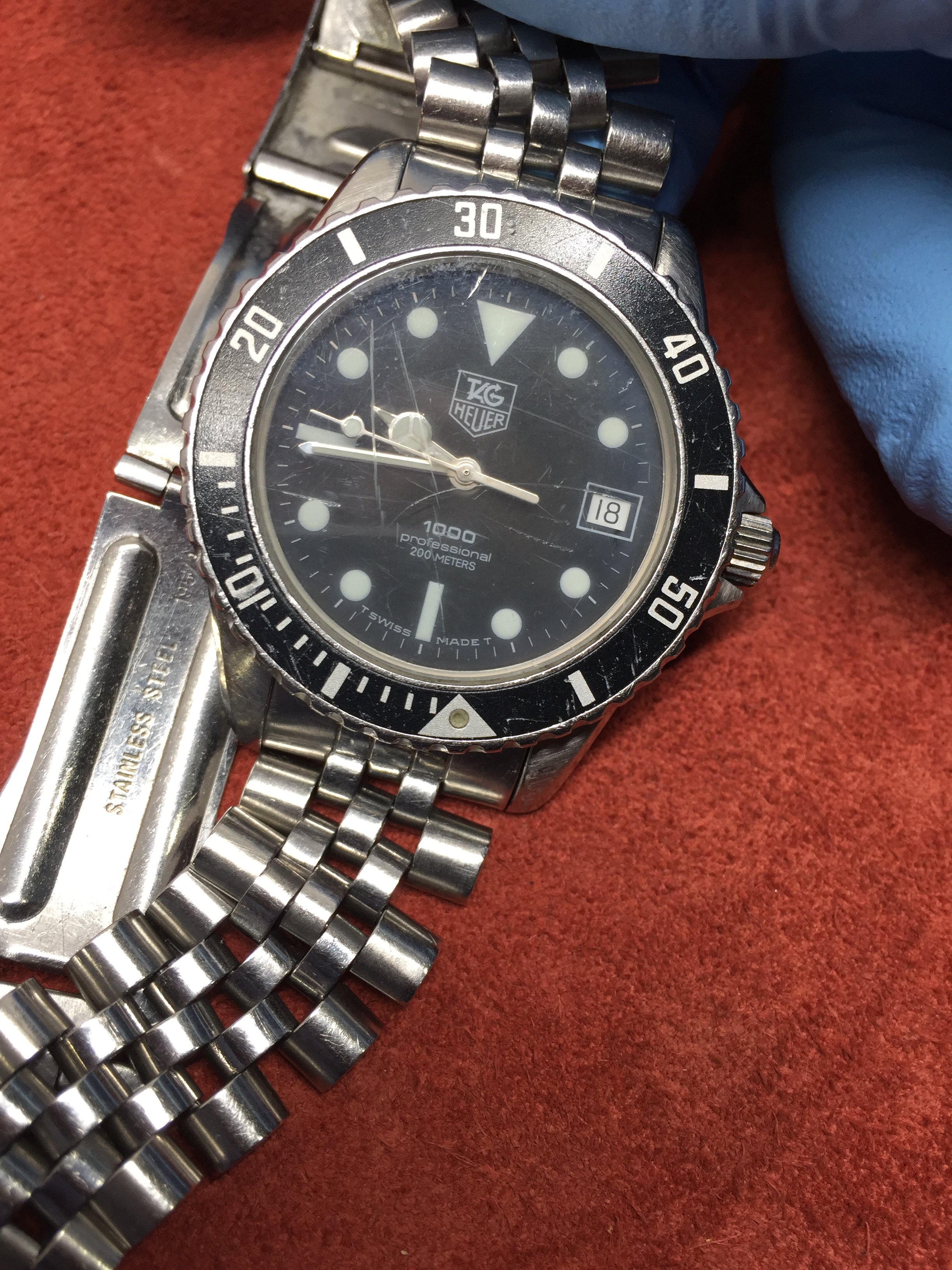

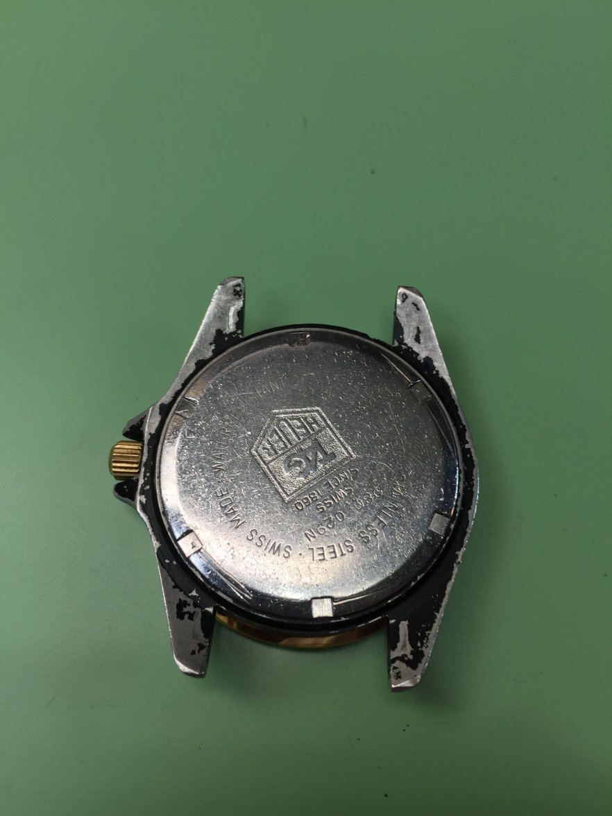

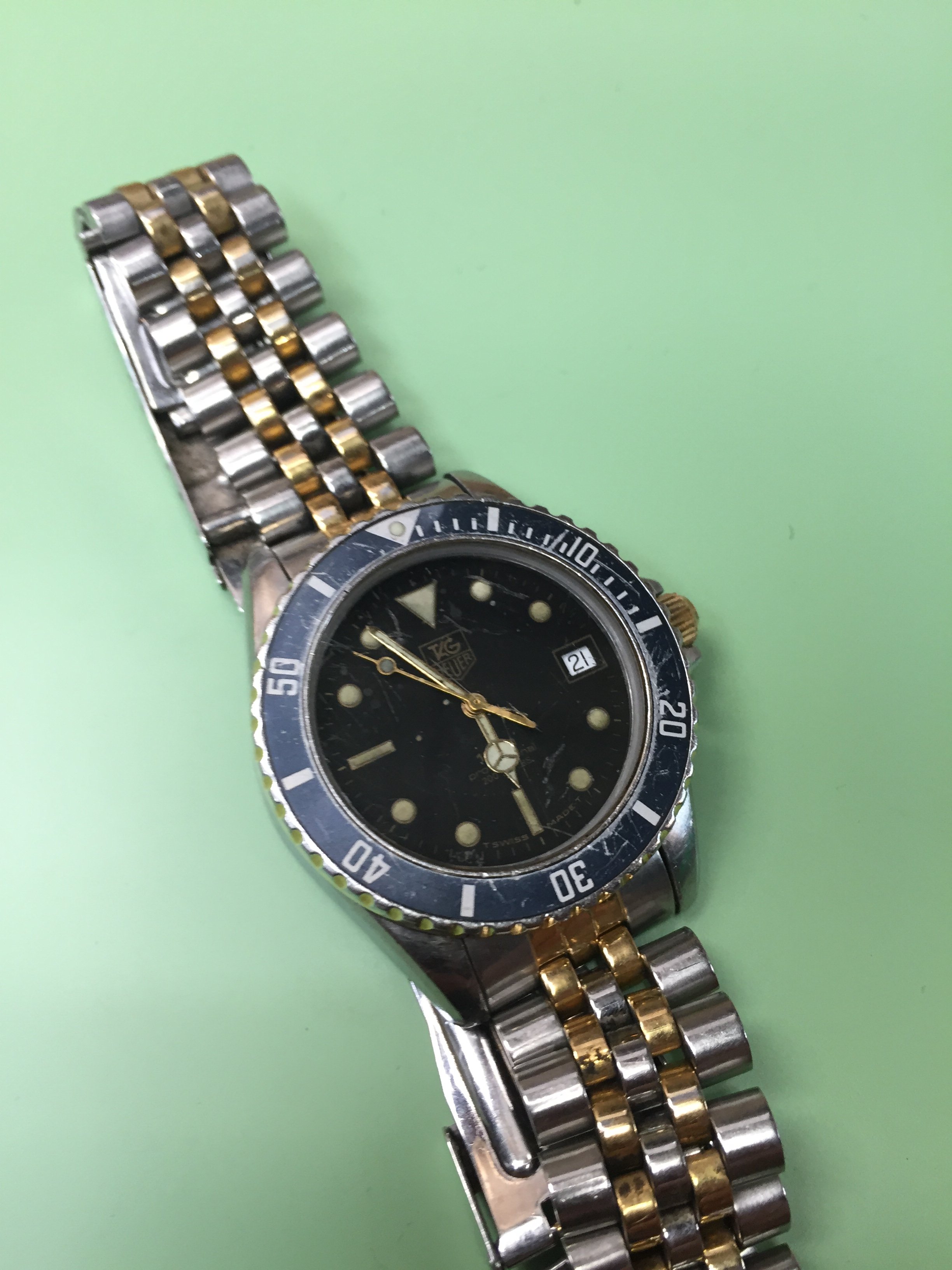

Oh that was a nice one compared to the next one. Check this one out, fresh in today for a full restoration (well.. resto-mod shall we say). It is a 980.029 that has seen better days for sure. It needs a laundry list full of parts and service but it will be overhauled in the style of a two-tone 980.020 (gold and stainless). The pvd will be removed and the case will be polished and brushed after that.
It has a badly stained dial, incorrect seconds hand, worn minute hand, bad movement, crispy hardened gaskets, worn case & crystal, etc. This should be quite the transformation. I will attribute most of the damage to the crown on this. It is smaller than it should've been (not the problem though). It was the crown gasket that failed and led to destruction of the internals.

Looking forward to the "after" pictures.

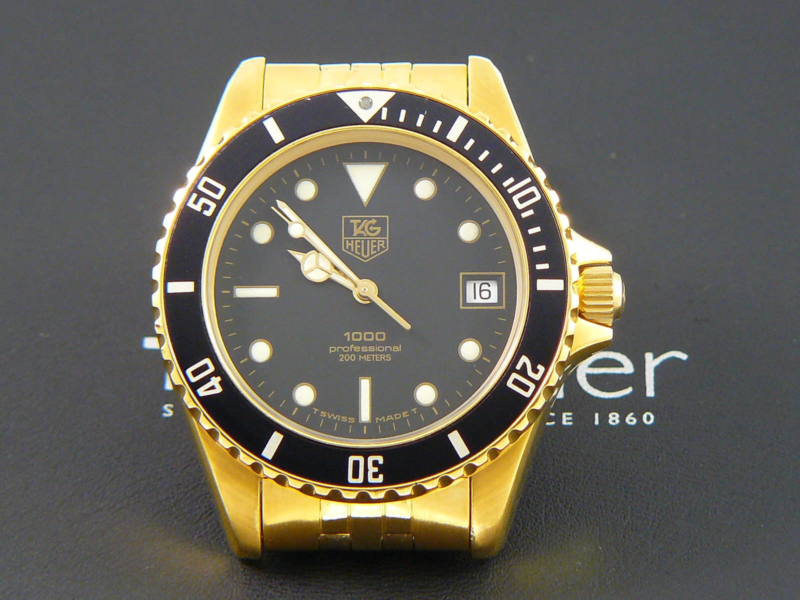

There's some really impressive work there. Are you able to repair pvd coatings and gold plating? I'm trying to decide which 1000 I should buy 馃榾 how reliable are the movements after all this time?

Movements are good, unless they have had water-damage. Parts are still available, although for the older movements it is getting harder to get them and you have to search for new old stock. As for the gold plating: no problem, but the pvd coating is a pain in the butt. It can be done but stripping off the old pvd, polishing it up to a new one and then put on a new pvd coating is very time consuming.
If you want to go for a nice original pvd-coated one, just get the best watch you can find available.
90% of the 1000's are killed by that as I have found out over the years, as the rubber o-gasket turns into some goo, like chewing gum.

I agree to all that was said above. I stock all movements for all executions of the 1000s so that is generally not an issue. If NOS or serviced they are pretty reliable, especially the last execution of which movements are still available new at very reasonable prices.
I will not be coating this again, like he said, too expensive (+$800 per watch). It will be stainless and gold like the two-tone 980.020 models.
