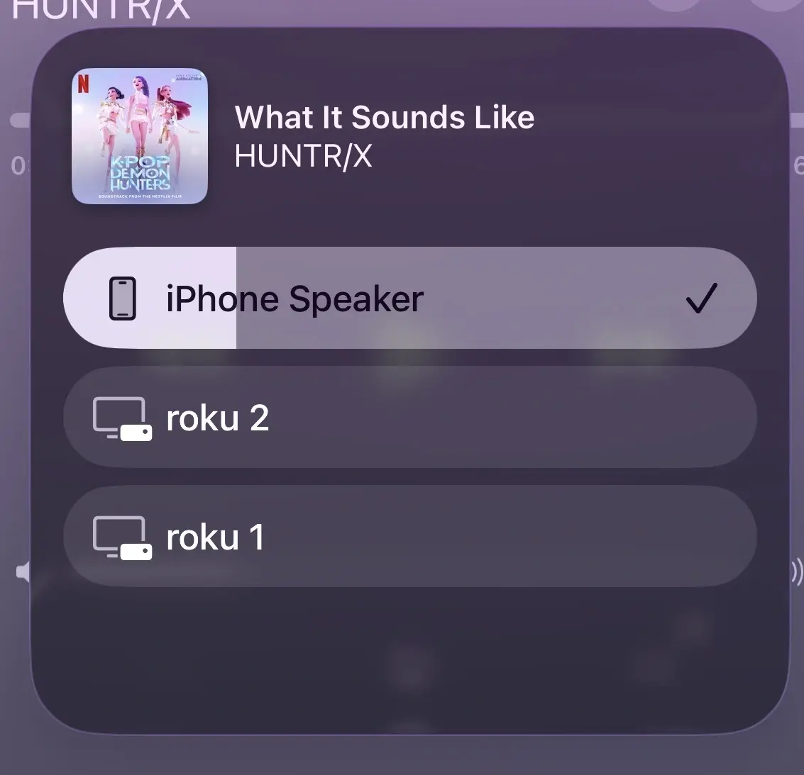

Yes, watch connected to iPhone Music player to control the tracks playing on the phone (fwd/back/colume). But the iPhone cannot connect to the watch speaker. How/where are you picking the watch speaker as the audio output? I can only output phone audio to my phone speaker and other connected speakers, but not the watch.
3
I went through the process to connect normally, but it didn't. I am assuming that because it was connected to the Meta glasses, it acted as a phone speaker, but then transitioned to the watch, thinking it was the phone? Have no idea. A fluke, I am sure.
