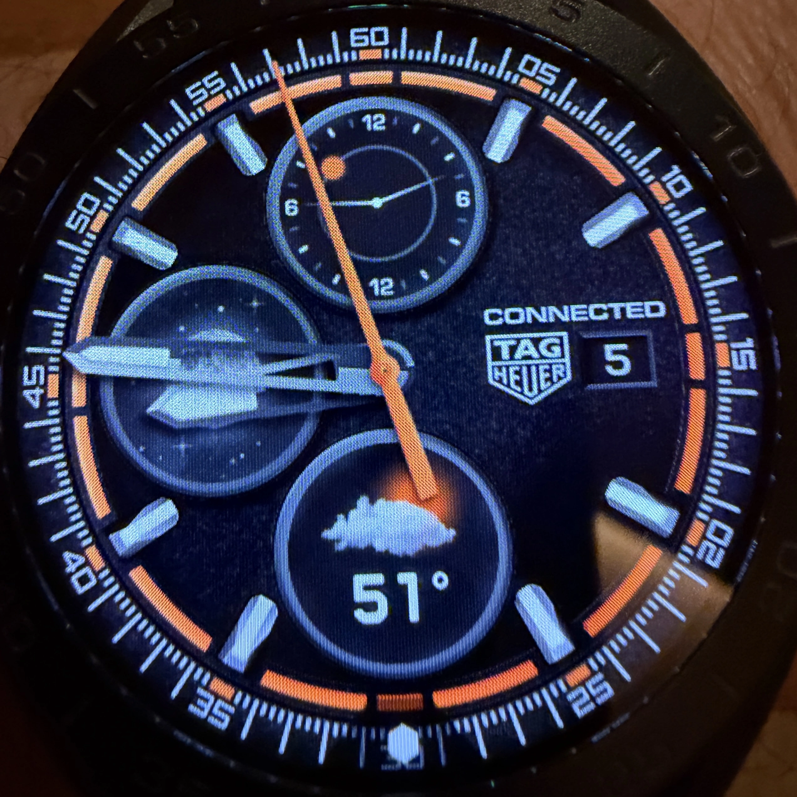

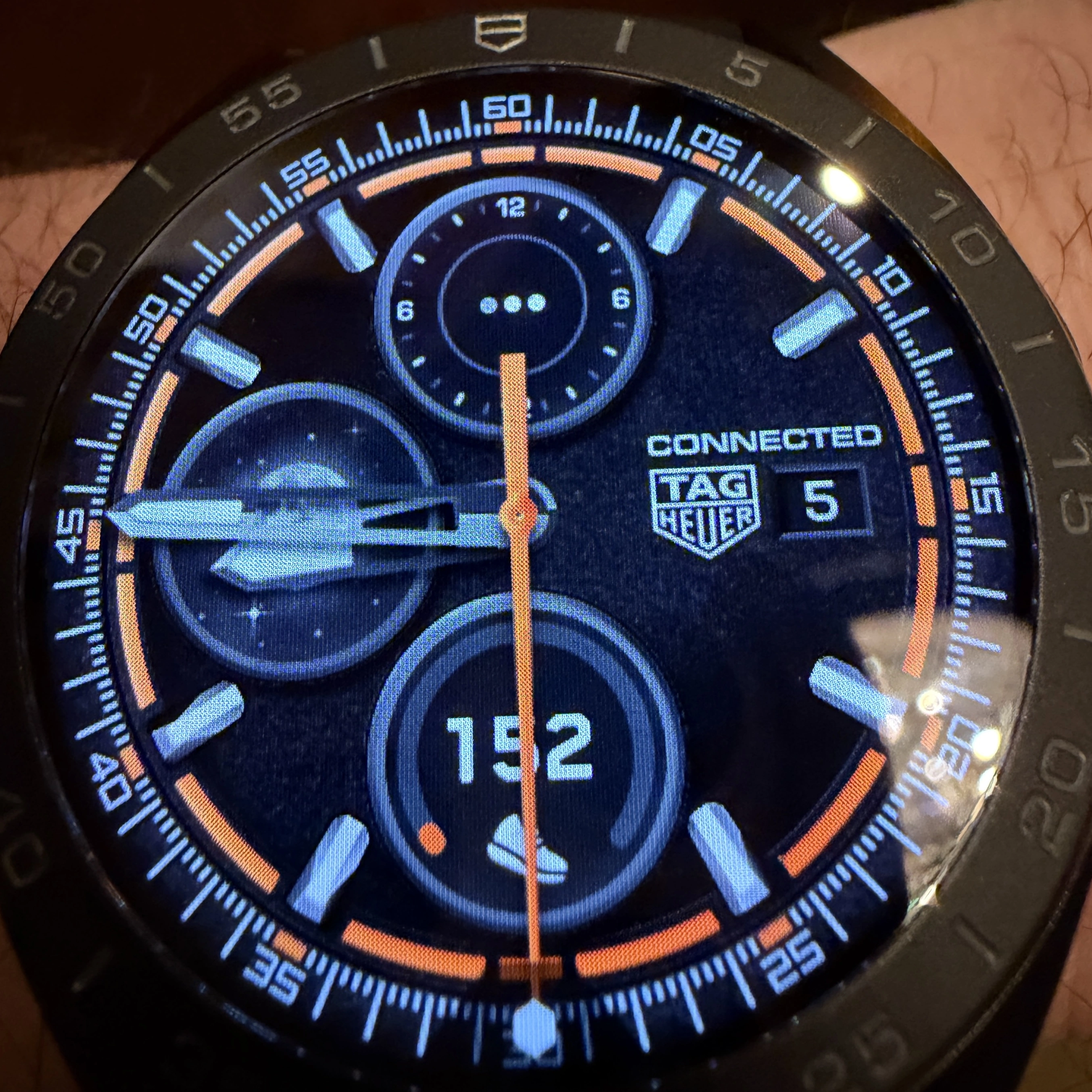

Bug, sunrise/sunset complication just sits loading forever (…), unless the weather complication is displayed. I swapped out step complication, for current weather, and sunrise/sunset appears. Put step back in, sunrise/sunset goes back to (…). WTF Tag?!?
The irony is, they show this face in the Connected App, showing sunrise/sunset with no weather complication.. that combination just doesn’t work.
UPDATE: today sunrise/sunset complication works (without requiring the weather widget). Maybe they fixed something on backend, maybe was a service outage yesterday (unlikely). But anyways, today it’s not dependent on weather complication being visible. 🤷‍♂️
UPDATE 2: added a different face, issue resurfaced. Sunset/rise working on one face, but not the other. 🤷‍♂️🤷‍♂️
