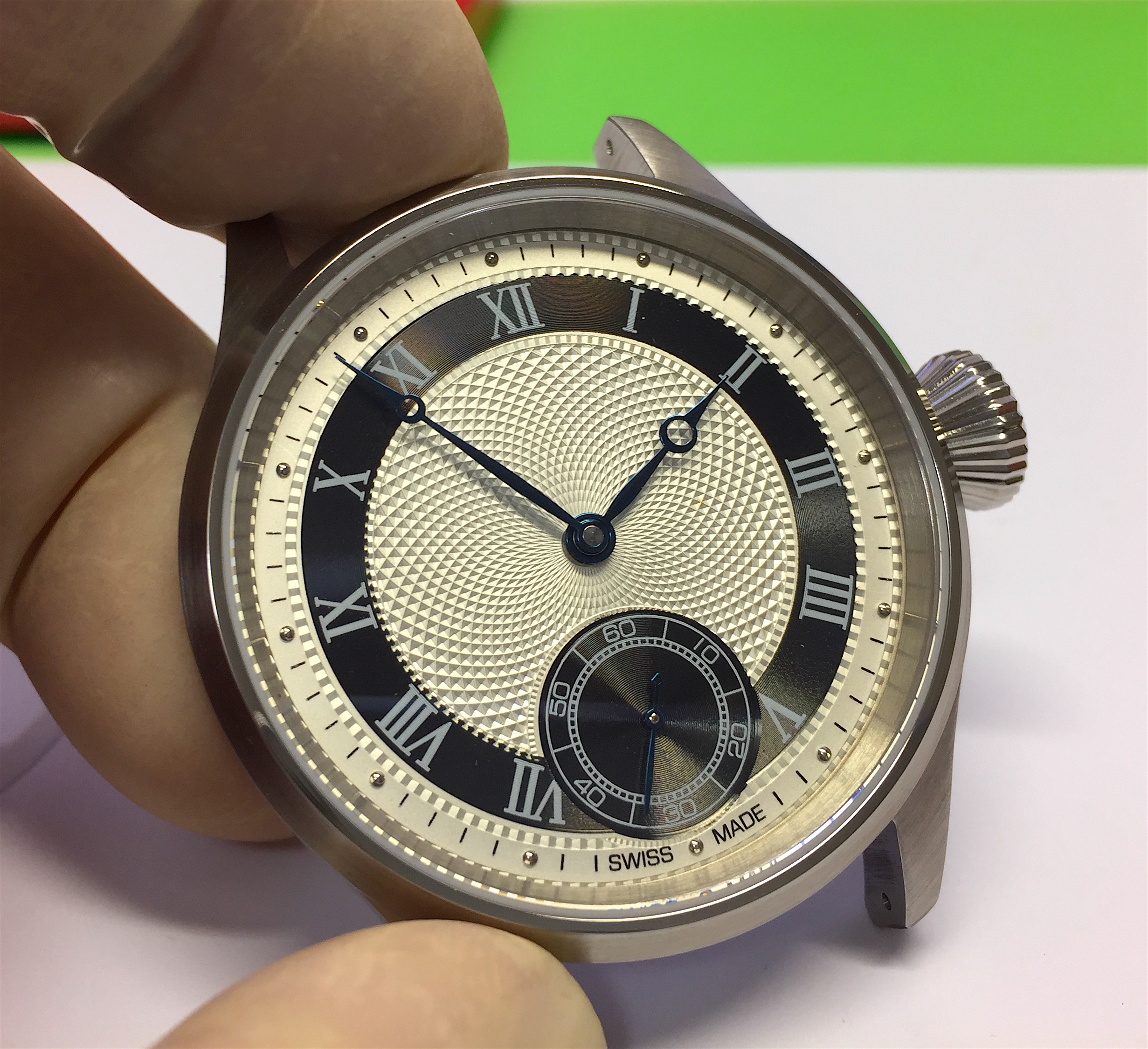

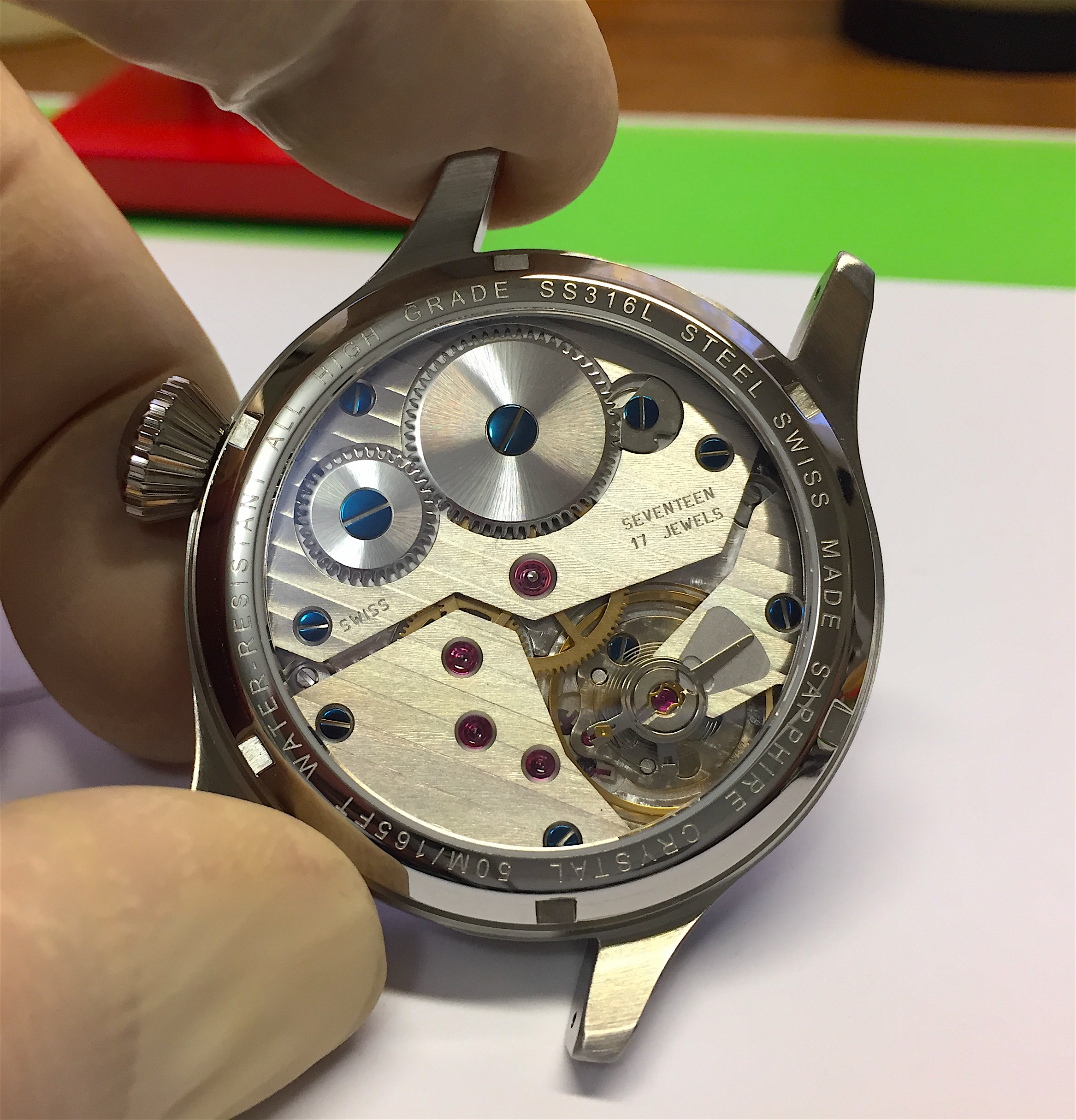

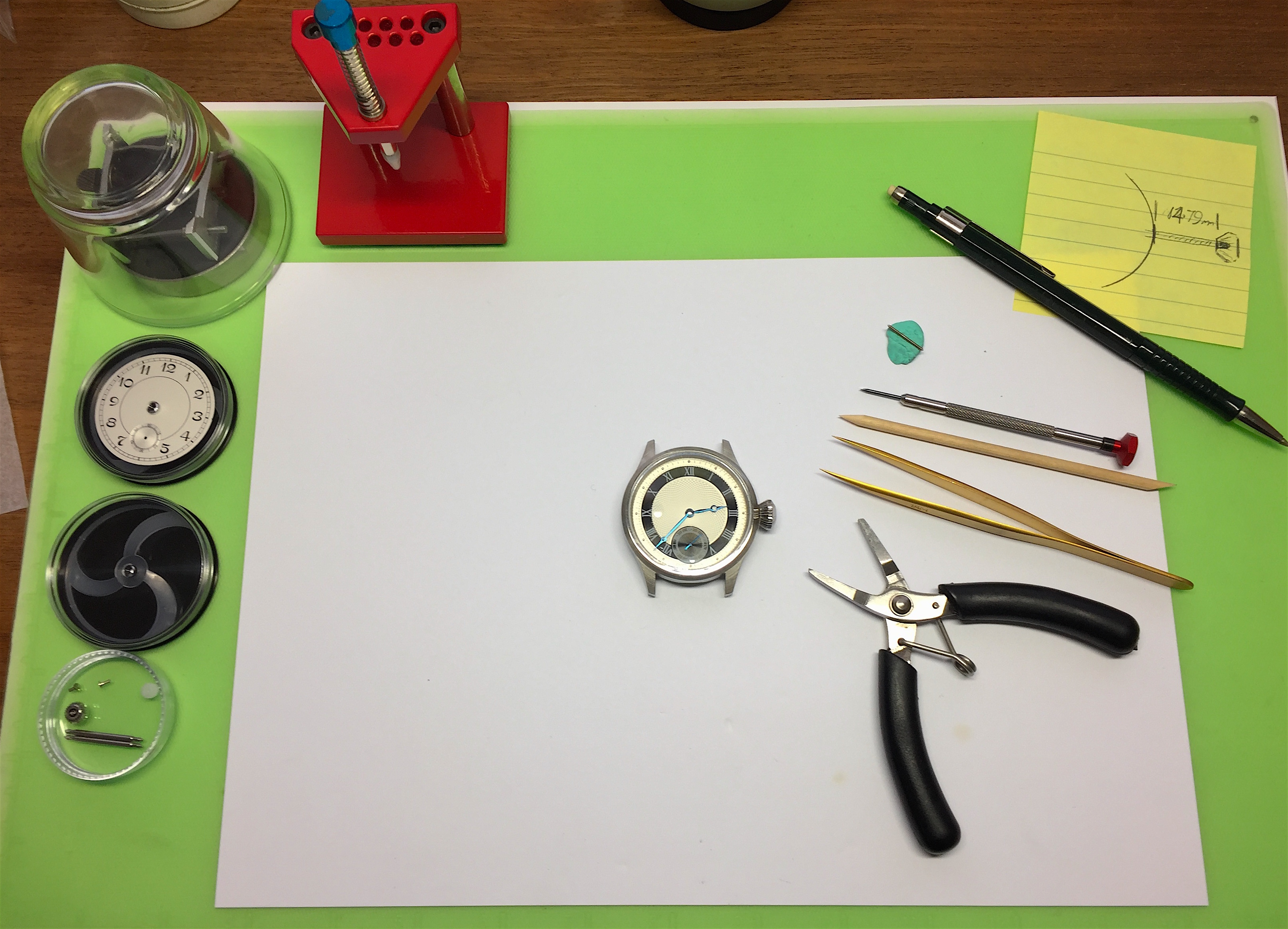

Just finished assembling an ETA Unitas 6498 with a guilloche dial, blued steel "Breguet" hands and a plain case with a turnip crown.
The most nerve wracking part was trimming the stem to length. After careful measurement (three times) with my vernier I chucked the stem in a No14 collet on my lathe. Set the lathe tool up at the right distance and then with the lathe at low speed, used a dremel cut-off wheel to cut the stem. All cleaned up and test fitted it was spot on first time, no rimming needed.
Dial side
Movement side
Now I just have to find a nice 22mm strap for it.

I'll take one with a flieger dial...
Congrats nice choice of dial for the class, and for completing the class! Love the turnip/onion crowns!

Not part of @Mad Dog's group, Cincinnati is too far away.
I ordered all of the parts from France/Switzerland and built it myself.
ATM it's running +8s per day dial up at 52º, beat error 0 ms. I'll find the correct lift angle and check it to see if it needs any adjustment.

Never had a watchmaking course, would have liked to though.
I figured I'd need to do something interesting when I retired so I started with a Seiko 7S26 and a guide by Nick Hacko.
Books and internet articles were part of my self education.
I found some watch forums (WUS etc) but most of the information there was either silly or dangerous, but I noticed some good advice, researched the poster and basically ended up here.
So, my expertise has been greatly enhanced by the guidance provided here by @Archer, @ChrisN, @Stewart H and many others. If it wasn't for them I would have nowhere near the confidence to do what I do now.

Everyone gets stem cutting wrong at some point. It's a score reduction in the BHI exams if you use two stems so, "measure twice, cut once" but you're on top of that anyway. I built a "sterile" 6498 some time ago but am not showing it next to yours as I was a cheapskate when buying dial and hands. They can be very accurate though. Lift angle is 44 degrees but that will just affect the displayed amplitude.
Enjoy it.👍
