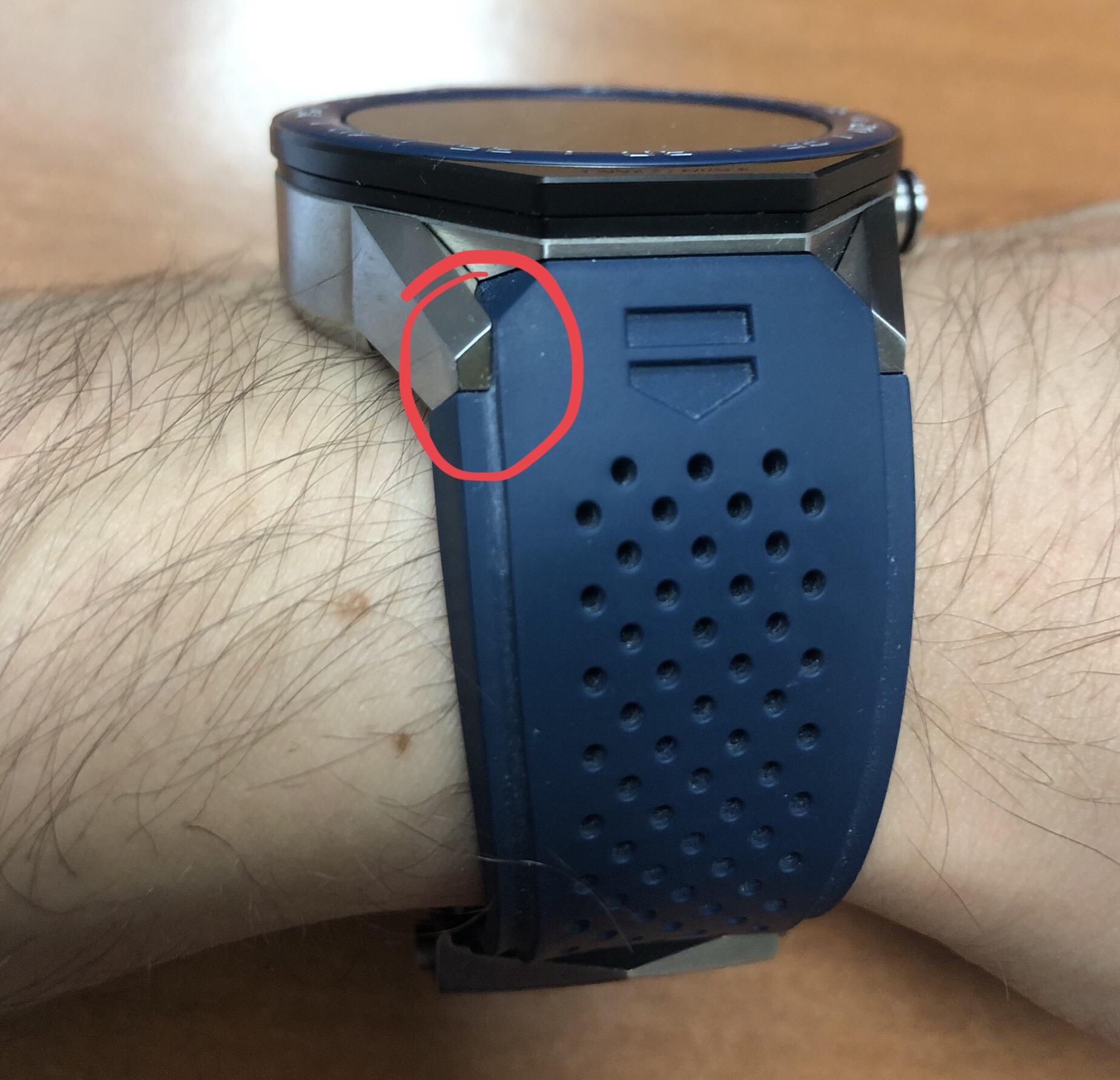

Today I have scratched a glossy surface of one lug (you can see what I mean on the screen). Does anyone know could it be polished back to the original glossy condition?
I think scratch remover is not good in this case))

The scratch remover tools (fiberglass pencils) are great for brushed surfaces, but not for mirror finished surfaces... I would take it to the watchmaker to polish it

Yes, Albert, I understand this. I hope watchmaker will able to polish it back to the mirror finished surface. I just don’t understand this was an addition glossy layer or it is just titanium itself but well polished) if it is a glossy layer may be watch maker won’t able to return it back to the initial condition...

After double checking again the lugs, I’m 99% sure it’s not an added layer but the same titanium well polished, so the watch maker should be able to return it back to the initial mirror finish 👍
