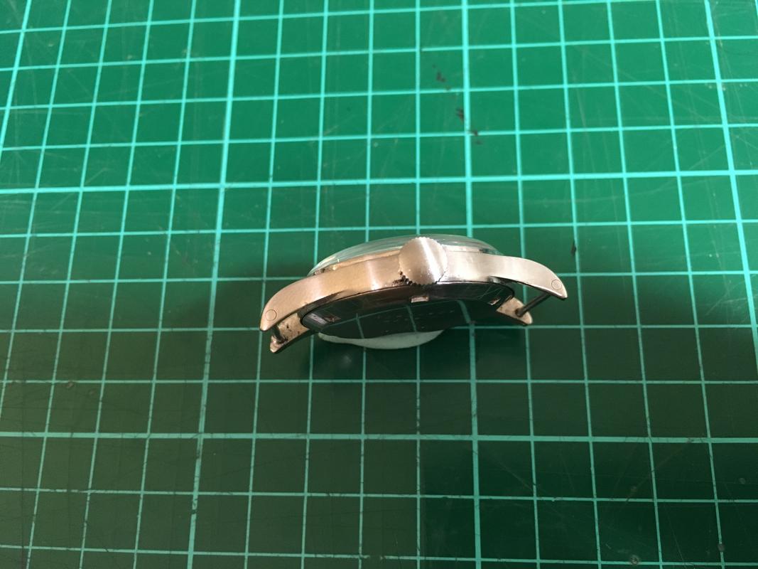

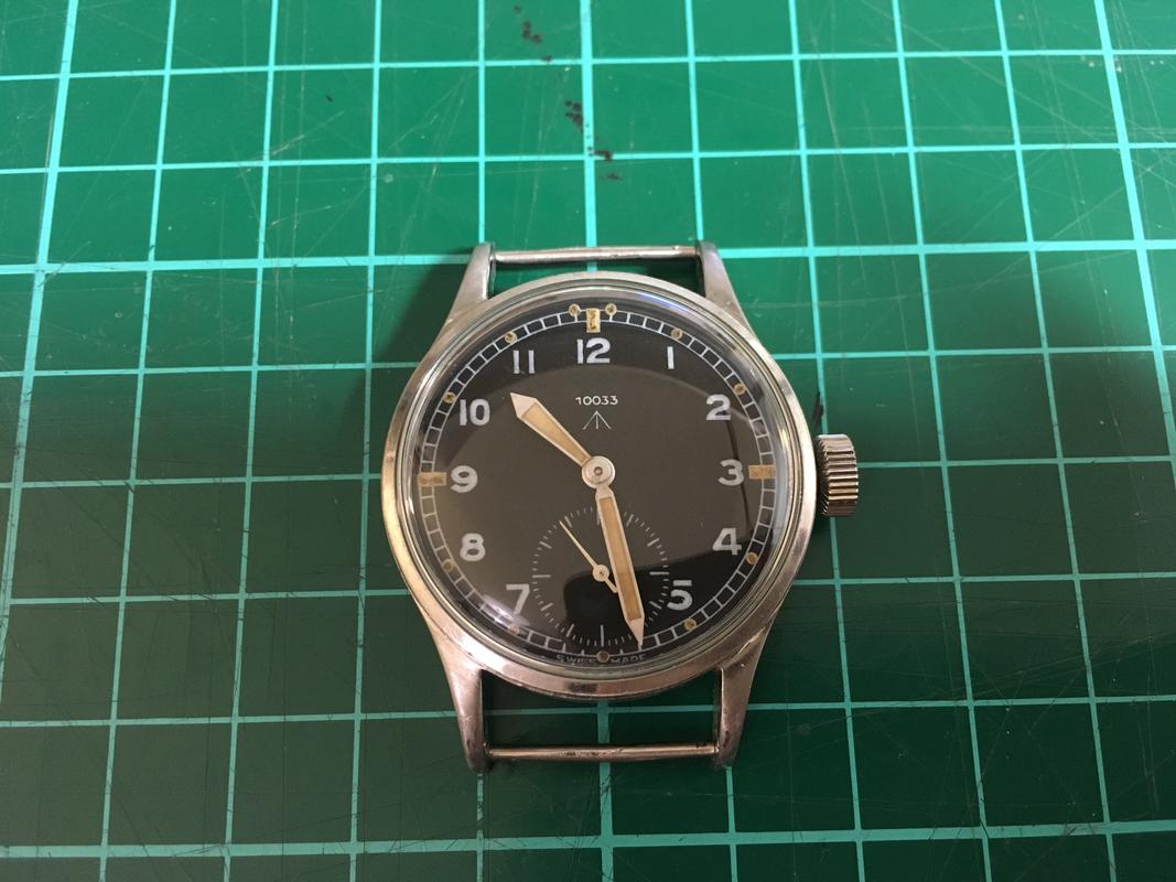

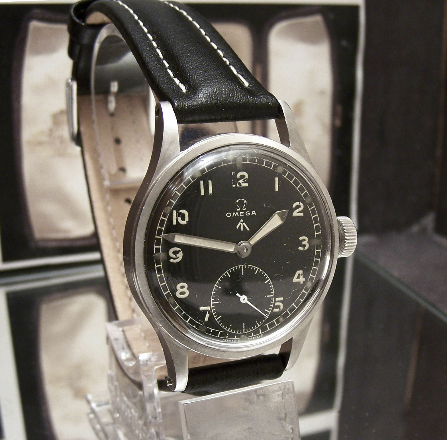

I've been lurking around here and leaning more and more, and I want to add a watch to my (meager) collection that will hold it's value or better. The dirty dozen Omega seems to fit the bill on several key things: Omega heritage, military heritage, low supply, high demand, looks real good... I'd appreciate thoughts on that idea, and on the seller's pics below of what looks like a very nice piece listed online for $2500. This might not be the one, but I'd like to know as much as I can when the real thing comes along. Thanks!
3,817
16,152

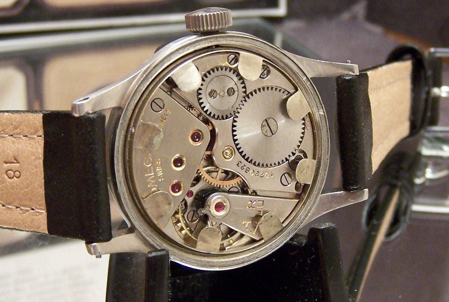

Relumed hands
Missing regulator

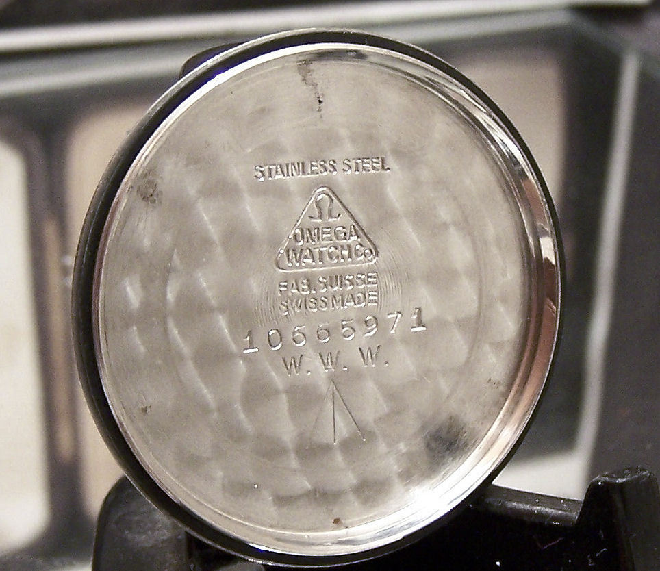

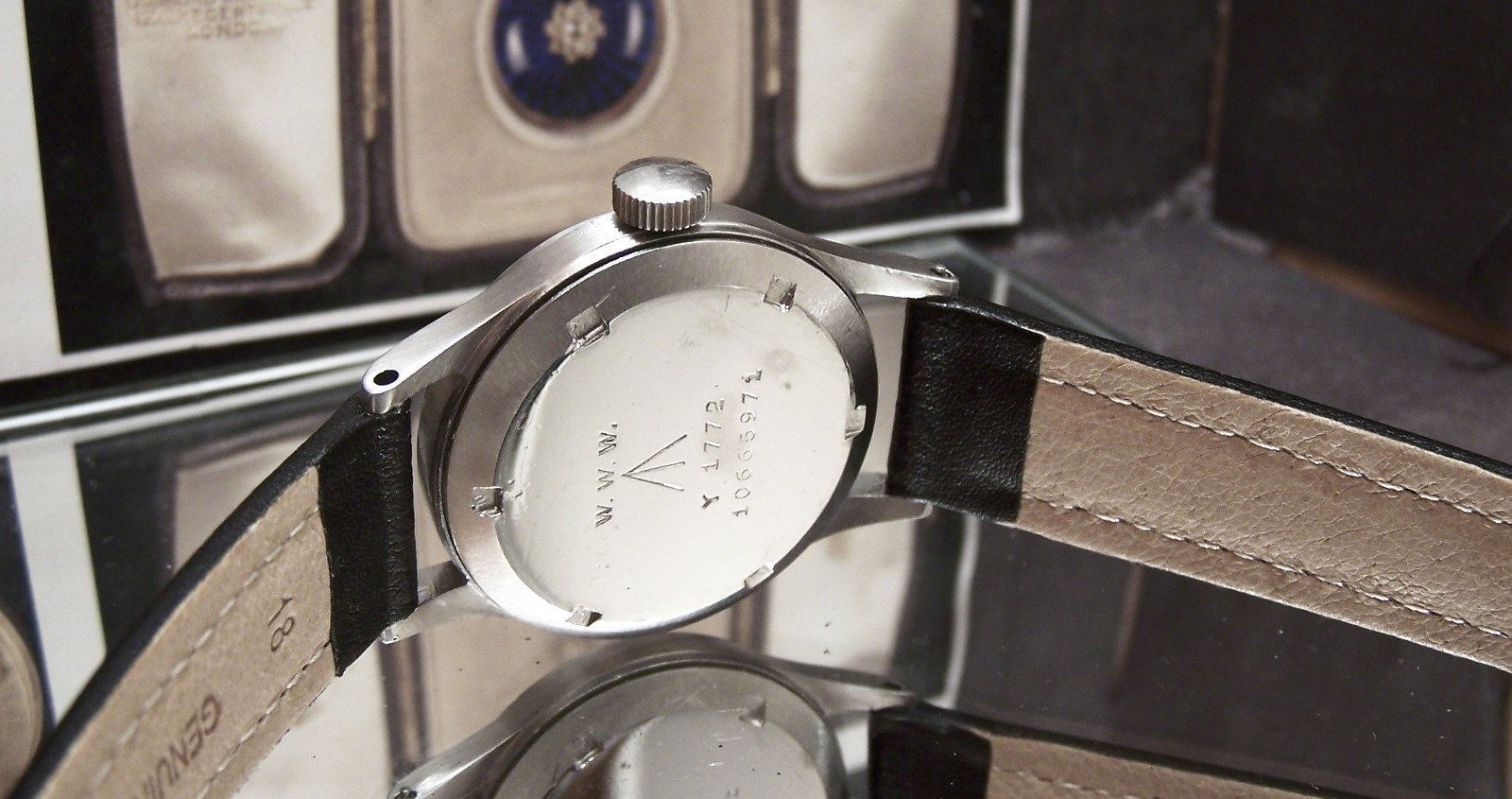

1944 serial number
No movement retaining screws but then I am not sure they're needed with that fitting ring

My early education continues... Sadly I had to look up 'regulator' and yes, that's a pretty glaring omission.
Thanks, Fritz.
16,307
44,981
Wow- good eye!! I wouldn’t have seen the missing regularly unless it was pointed out.

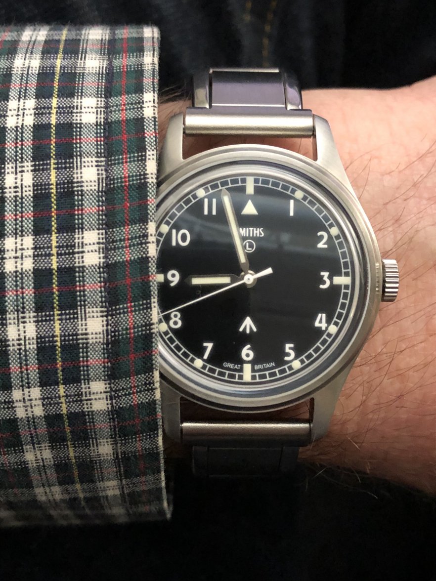

Love the Dirty Dozen. I have the Smiths reissue by Ernie Platts, although it’s not the real thing, it is a joy to wear, and one of the most instantly readable watches I own. I would love to own one of the real ones when I become a real boy one day
Thanks, Fritz.
Also, it has had its fixed bars removed and spring bars installed (poorly).
Yeah it’s a mess. You can get really nice examples for less than $2000 with not too much effort.

I'm also wondering if it's correct for the lugs to stick out like that.
I saw something there. It looks like they're actually poking through the lugs.
Thanks for the price guideline.

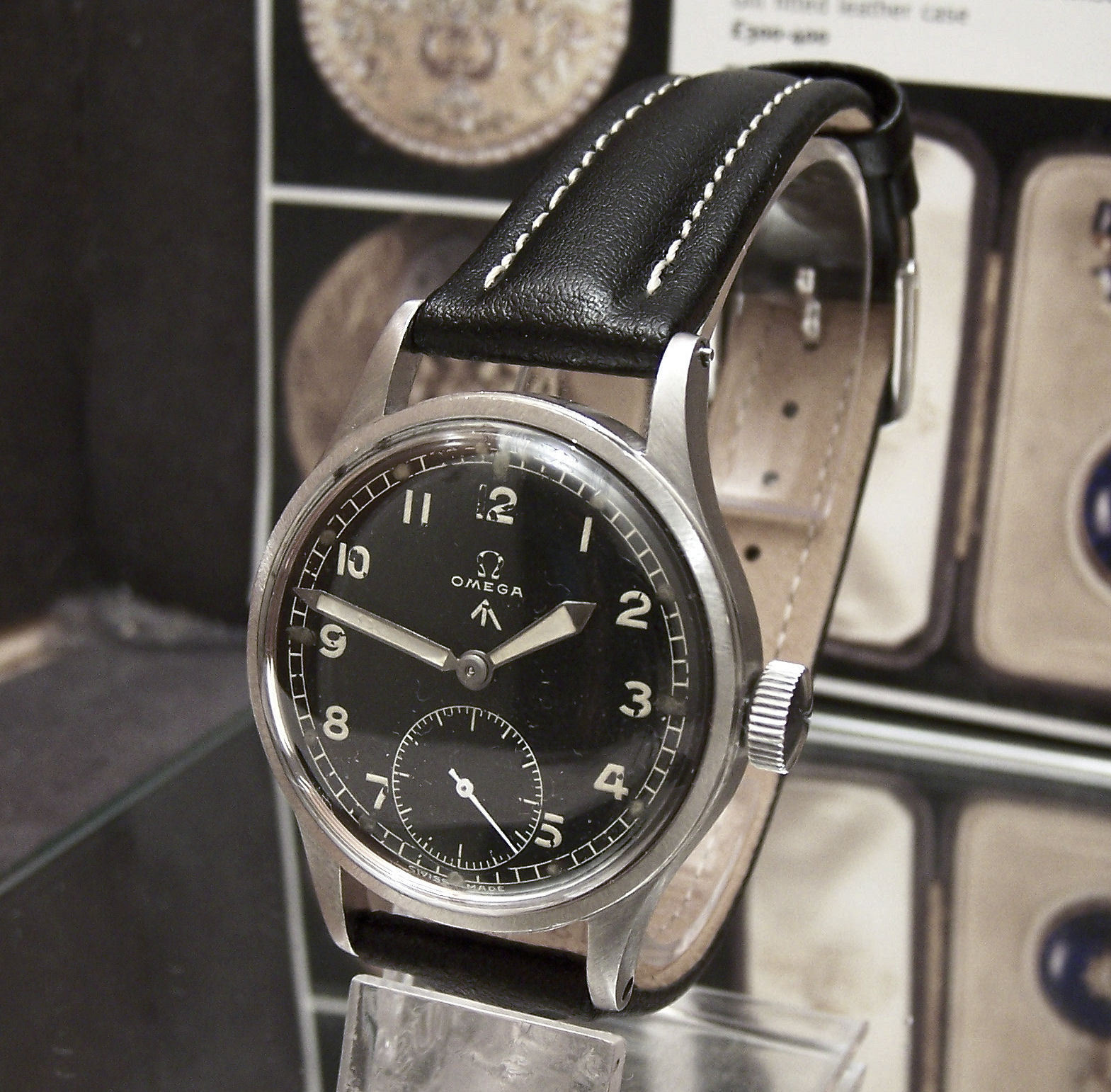

This nice MOD dial sold on MWR for under $1600 just a week ago. You can see what the fixed bars should look like.
2,212
28,811
This is now mine ... somewhere in transit overseas 😀
That’s a great catch... I think there was a queue chasing that one 👍
For the OP it’s not just MWR that has great examples of these from time to time, the Omega WWW was produced in high volume (at least relative to other watches in the dirty dozen) and if you keep an eye on eBay you’ll likely find a nice one within a month.

Beautiful watches, Ludi. Can someone explain the dial to me?

The regulator is present. It has the same coating as the bridge, so is hard to see. Look for the tip crossing the A-R line.
7,630
21,886
Good catch- however it is at the very least grossly overpriced IMHO, considering the horrid white hand relumed and the damage on the numerals.
On another note, Smiths watches are nice but not part of the Dirty Dozen.
It's the ultra rare camo regulator! That will teach me not to check these things out on the crappy little I pad.
Oops, my bad- just MOD.
