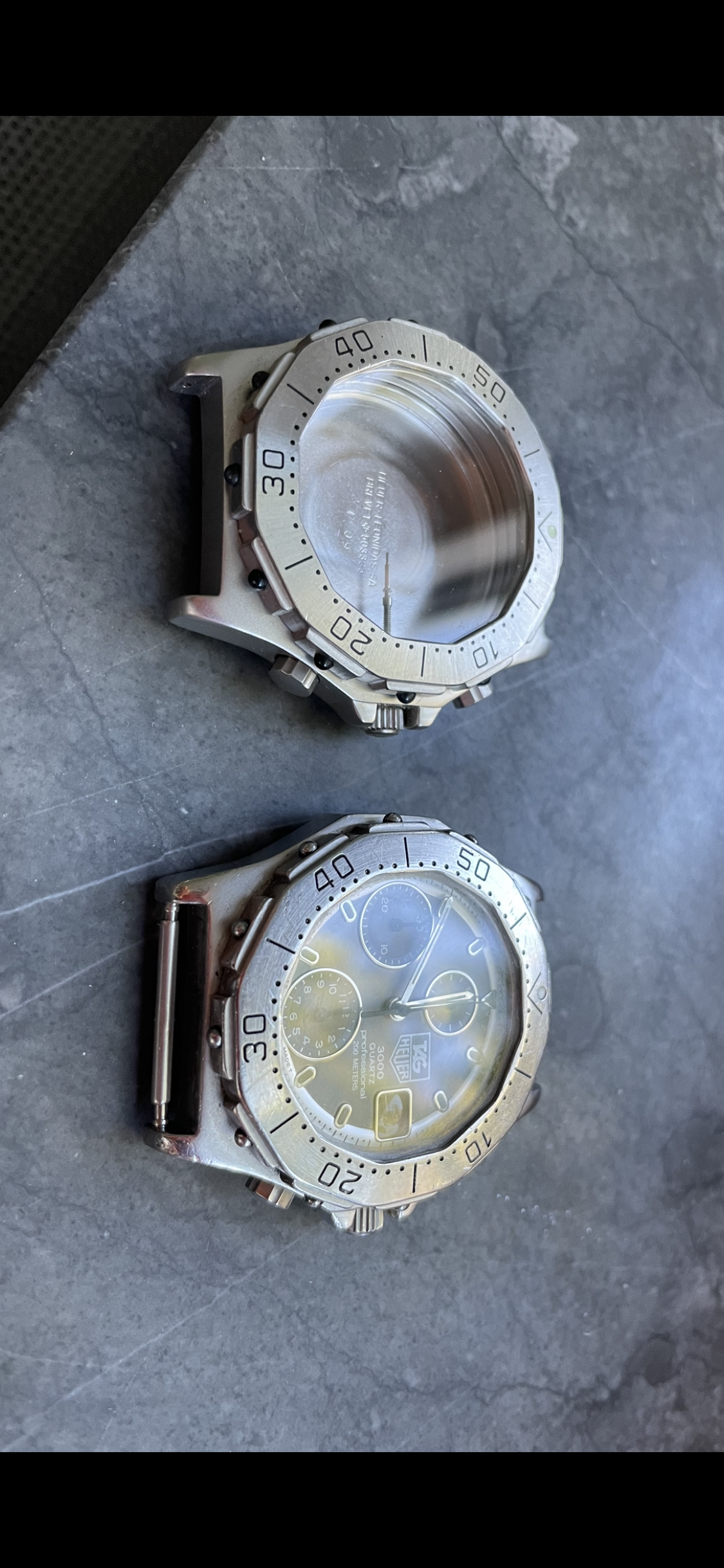

Hello everyone. I apologize in advance for my English.
I need to change the caliber of my Tag Heuer ref. 232.206 as it doesn't work. I only need to change the ETA caliber (the chronograph caliber works). I read here on the forum that the equivalent of the ESA caliber 555.232 is the ETA 955.232. Searching on ebay I found this listing: https://www.ebay.it/itm/NOS-ETA-Mov...ografo-Modulo-Quarzo-Cal-955-232/184093673188
But I have a doubt: the data disc seems too small, right?

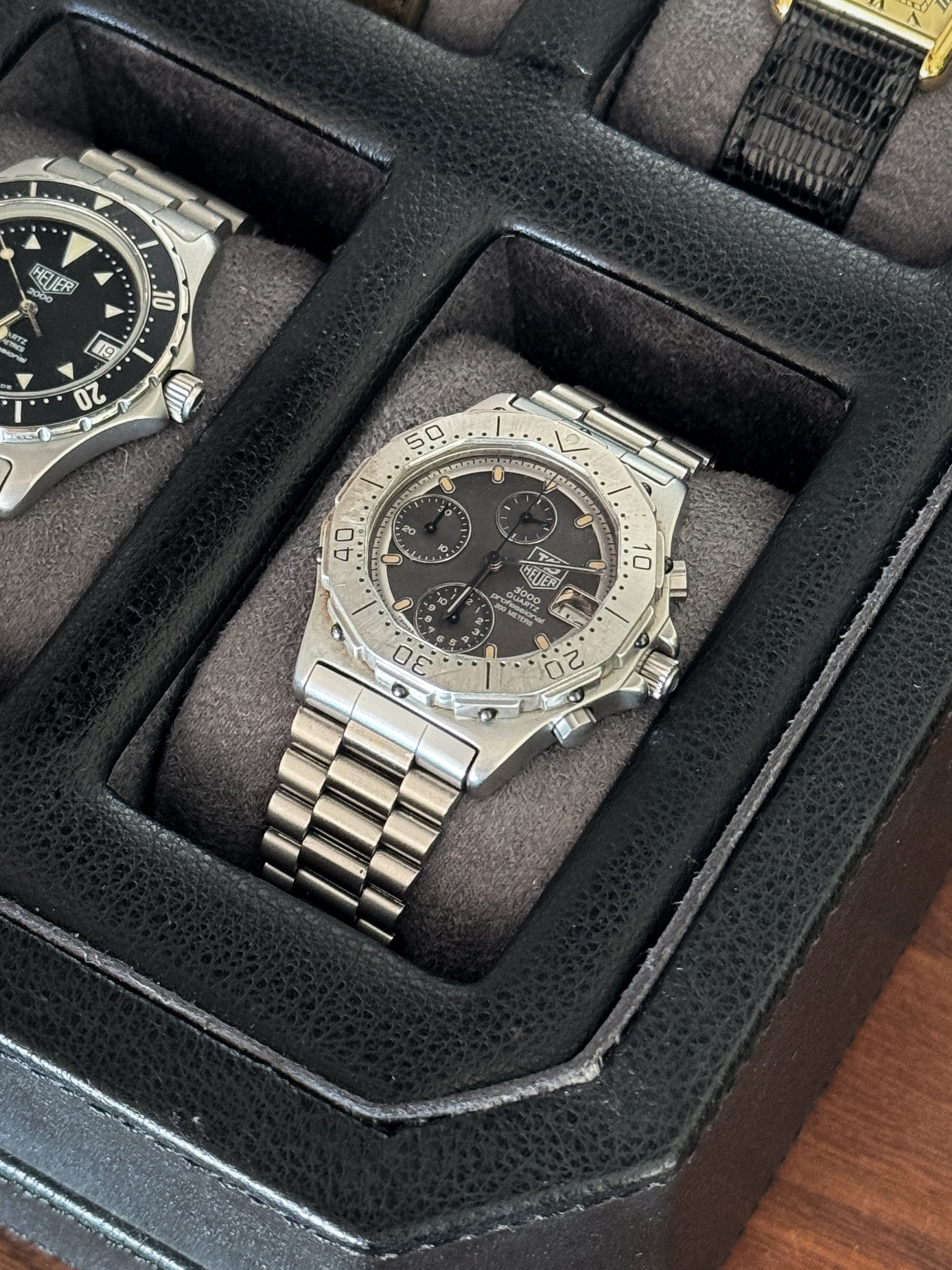

I have 2x 2000 and 2x 3000 with this movement. 1 of them is malfunctioning. Chrono button does not function. I'm going to my watchmaker soon. He has experience with these timepieces. To my knowledge, there may be parts can still be found. I will keep you informed.

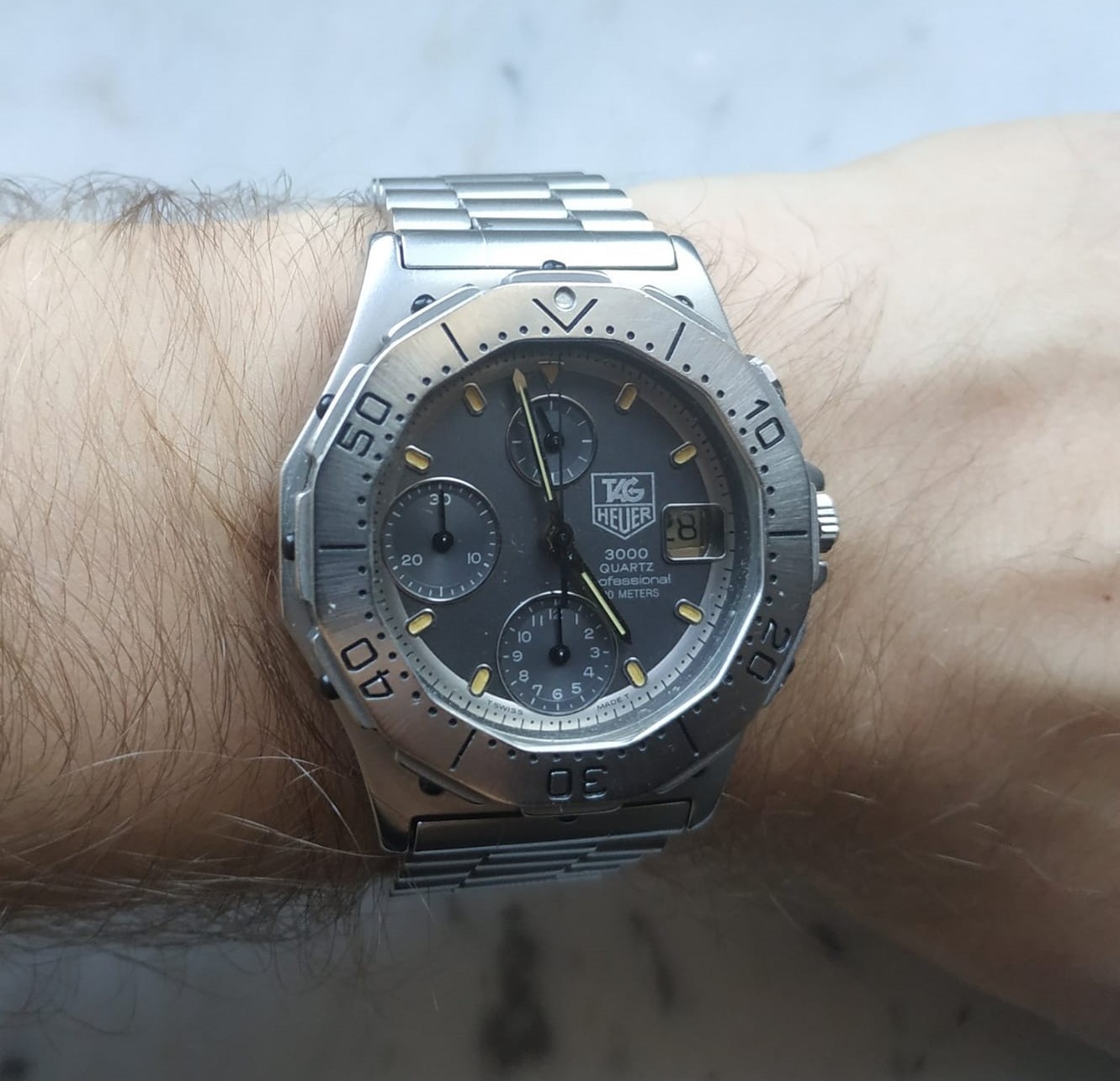

My time doesn’t set reliably. It feels like the teeth aren’t catching all the way when turning the crown. Once I do get the time set it loses time immediately.
The seconds subdial, chrono, date wheel all appear to be working however. I’m hoping it’s a relatively easy fix as I hear it’s nearly impossible to find parts like the circuit as they were specific to this watch.
I’ve heard a good solution is to source a functioning 2000 or 3000 chrono (both use the dd2000 movement) as a donor watch. I’ve just sent mine to a watchmaker yesterday, will update what I hear from him.
I considered returning to the seller (who claimed the watch was “100%” functioning) but I’ve been chasing “the die hard watch” for a while and these don’t come up often!

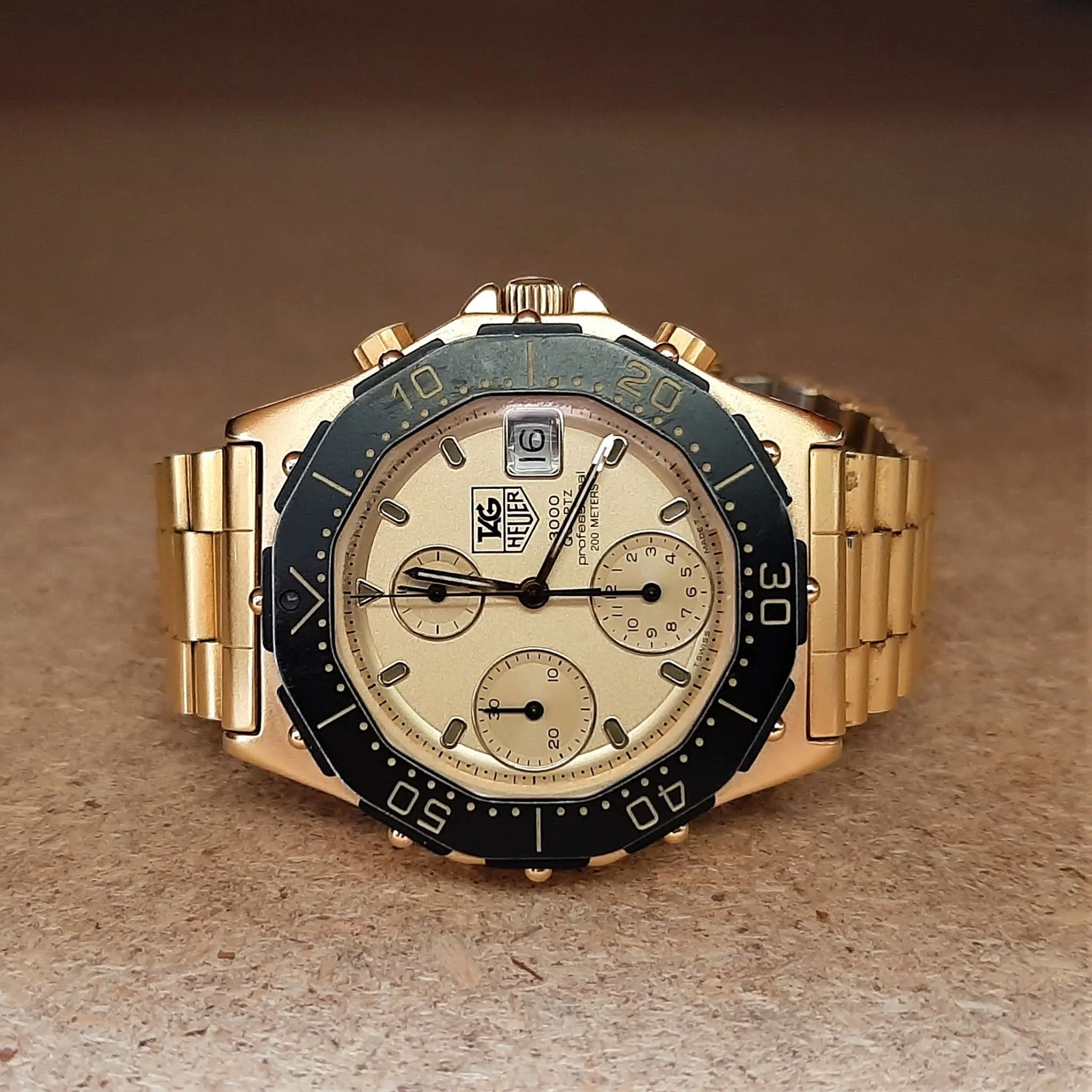

This is why I sold my gold one that needed servicing... shame , it was a funky looking thing.
23,582
34,111
That was the opposite though, the time worked fine but the chronograph would stutter and stop and also slow the main hands down when it was in operation. Sounded like a pain in the bum to fix and probably expensive so I bailed.

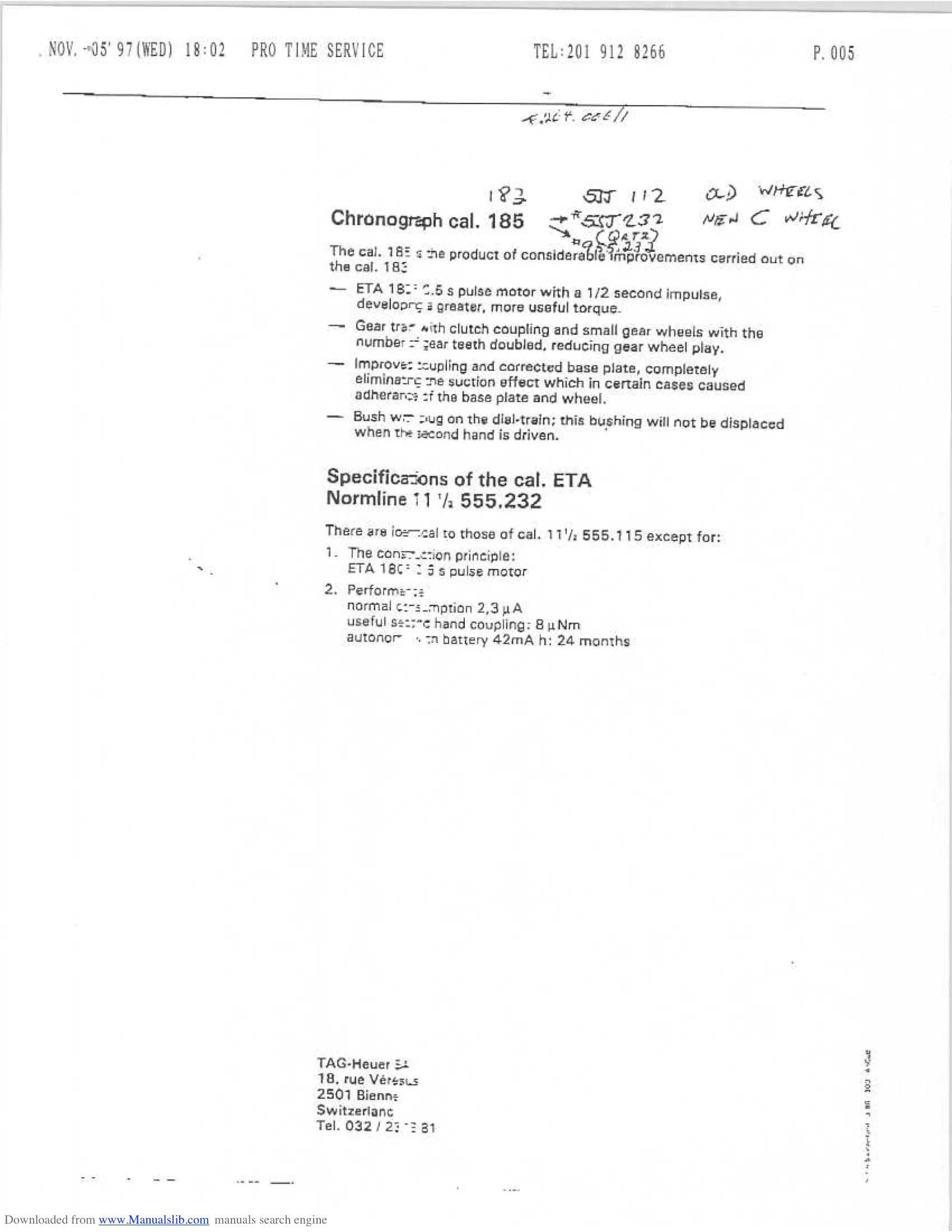

@rudiculous
Bit more on this theory.
Below is an ETA tech document detailing the differences between the cal 183 and 185.
This shows the changes made to "convert" the standard one second tick 555.112 into the twice per second 555.232. It specifically says a new "half second impulse motor".
This says to me they didnt use the regular one second motor and gear it down through the train but used a stepping motor moving in half second increments. Therefore changing over the stepping motor components (coil/circuit, rotor and stator) to those from a 555.112 or equivalent should effectively return a cal 185 movement to an operational cal 183 with once per second tick.
It looks like they didn't change all the wheel teeth, those that were changed were for reasons of reducing backlash not for gearing.
I reckon it would work.
