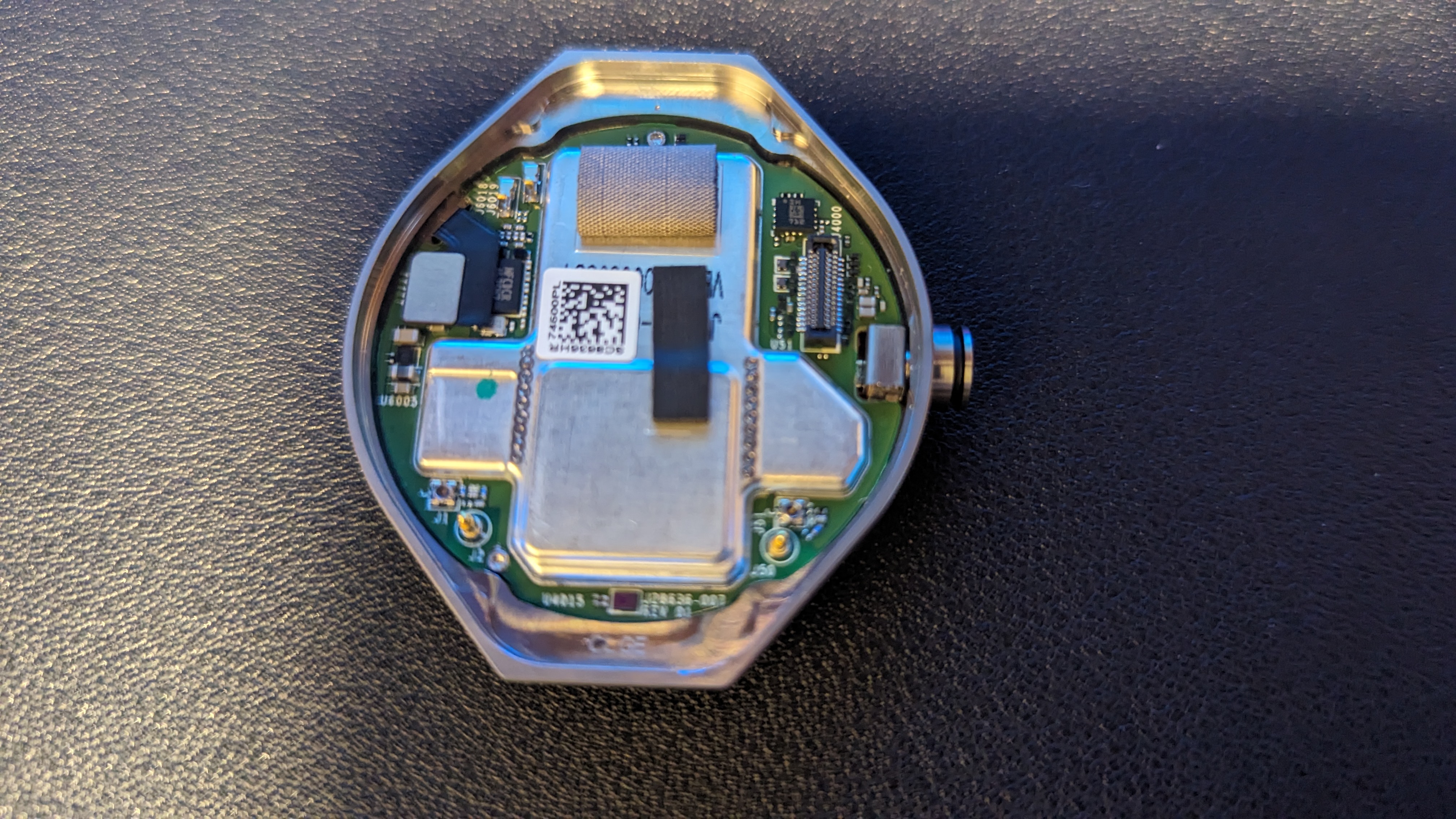

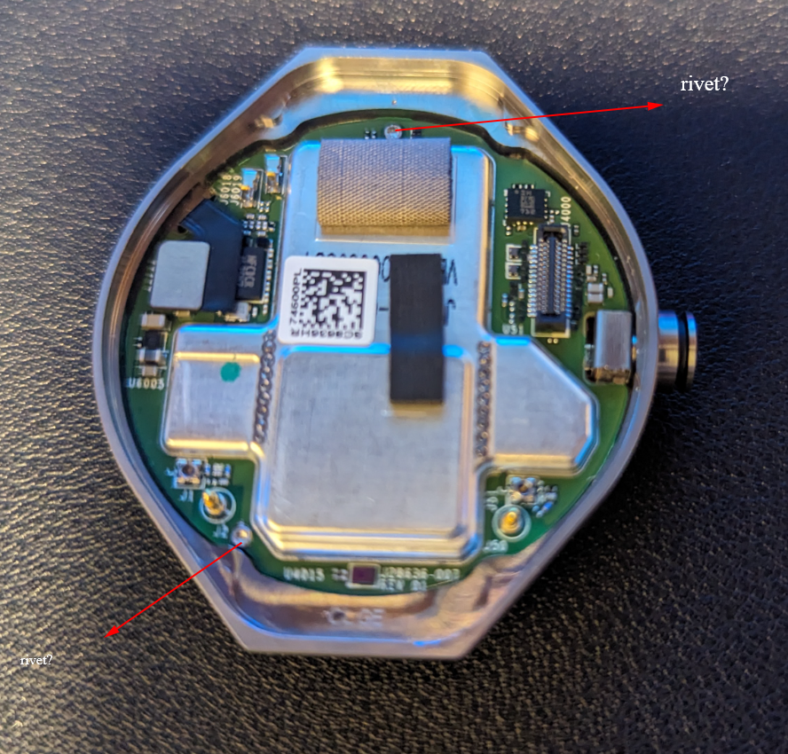

I read the whole 3 pages and decided to open my E2 41mm
All went good until the final steps.
My E2 does not have screws holding the mainboard to the case.
See the attached photo, i guess it is glued... Maybe riveted, i see like 2 rivets.
If someone can confirm if it is glued, i may try a hot gun to soften the glue.
Thanks

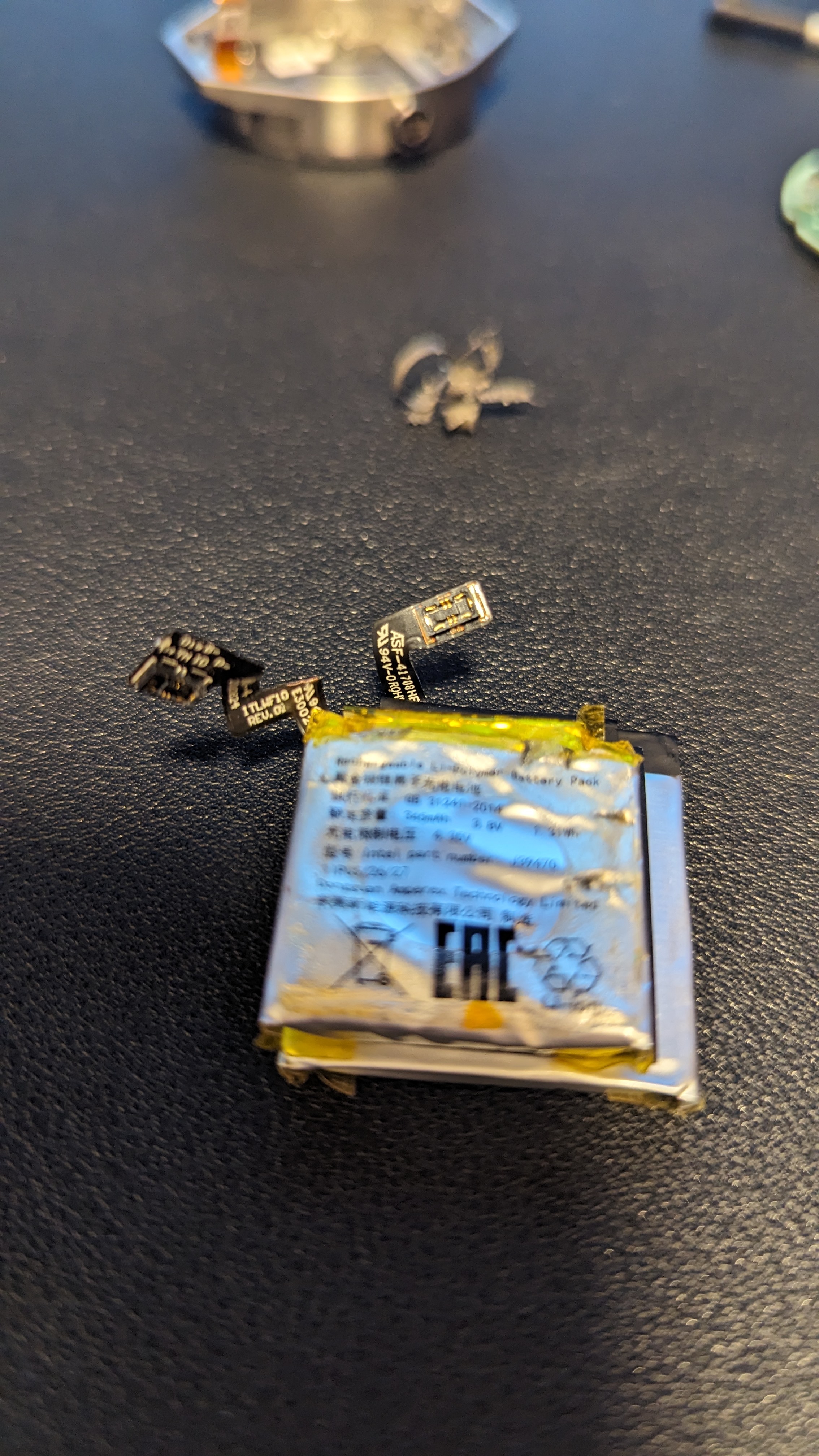

Finaly did it.
The two rivets are in reality two screws. TH marred the heads.
It also has two sided tape underneat.
This is the original battery i found in there...
257
246
Finaly did it.

As you will see.
The original battery is different from the one talked about on this thread.
Size is different
Number is different
Connector is too short

As you will see.
Size is different
Number is different

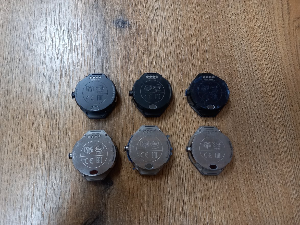

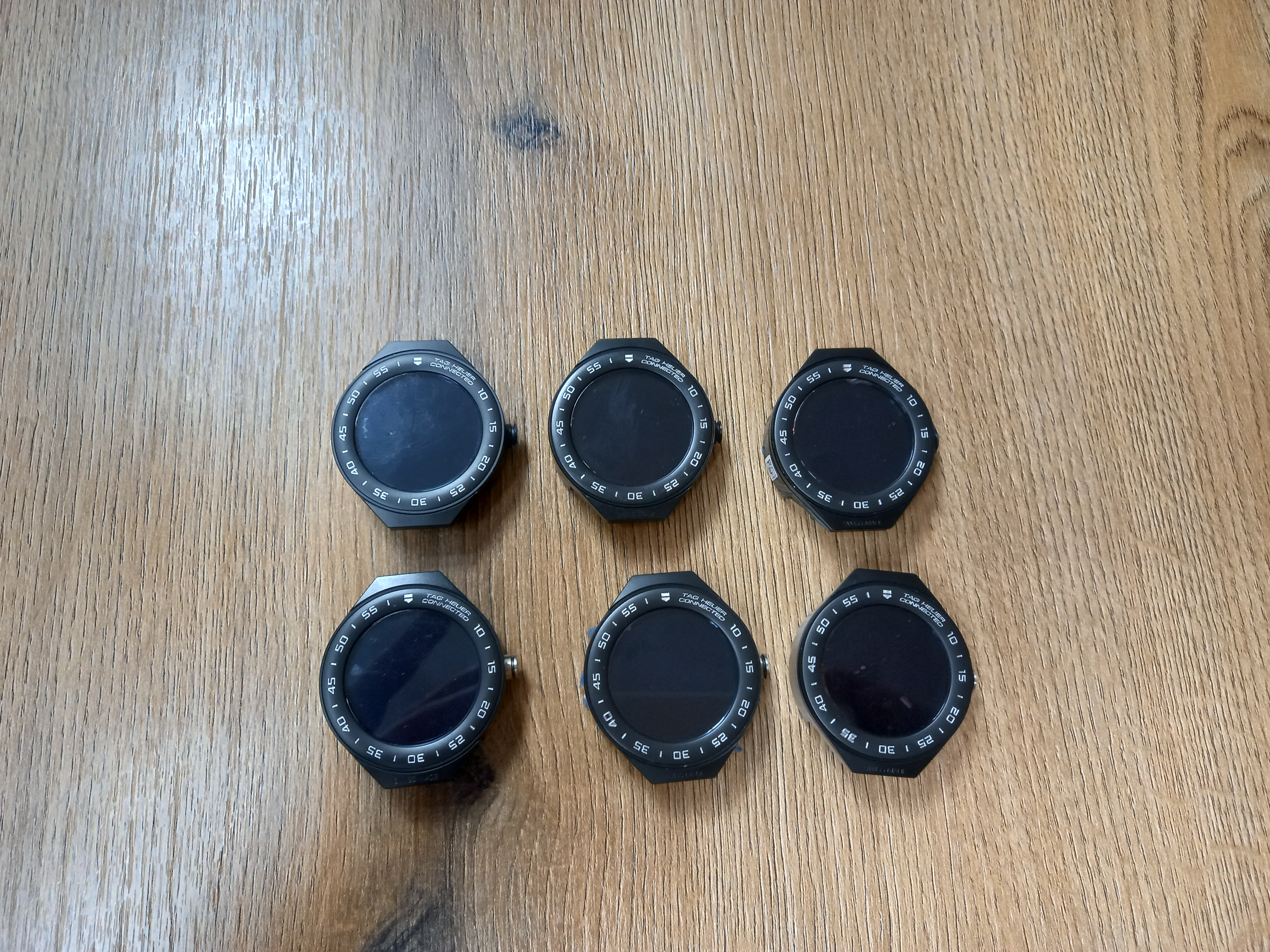

I am not really sure if I am ready to play around and open the watches up. I have 6 pieces of E2 41 sitting around, all with bad batteries, 2 showing while on charger 100%, other 4 work whie on charger for 5 minutes then they shut down.
There are heaps of batteries that might fit, but its hard to say without knowing the size in mm,

No the battery you show is for the e2 45mm. Connectors are different and the size. I have 45 mm modules and a few 41mm modules. The 41mm are terrible, they all fail like this, however it’s very rare for the 45 mm to have this problem.im not sure why ? Battery smaller and doesn’t hold charge well ? I’ve no ideal, but the 41mm will be extinct soon due to this problem and no replacement batteries. Luckily I have a 41mm calibre 5 module so I can carry on using the straps.

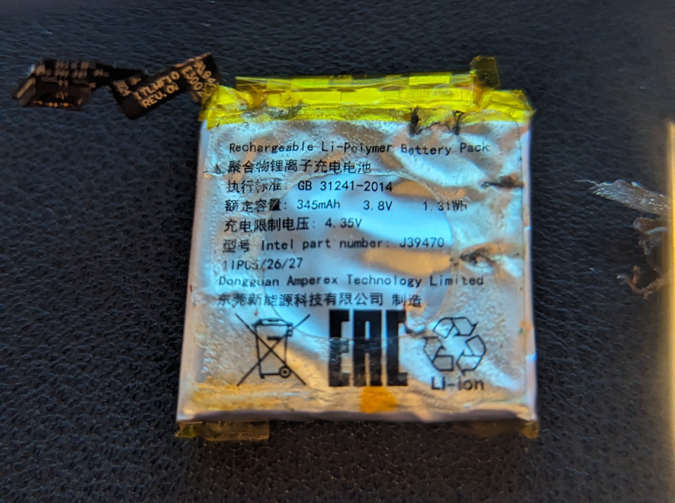

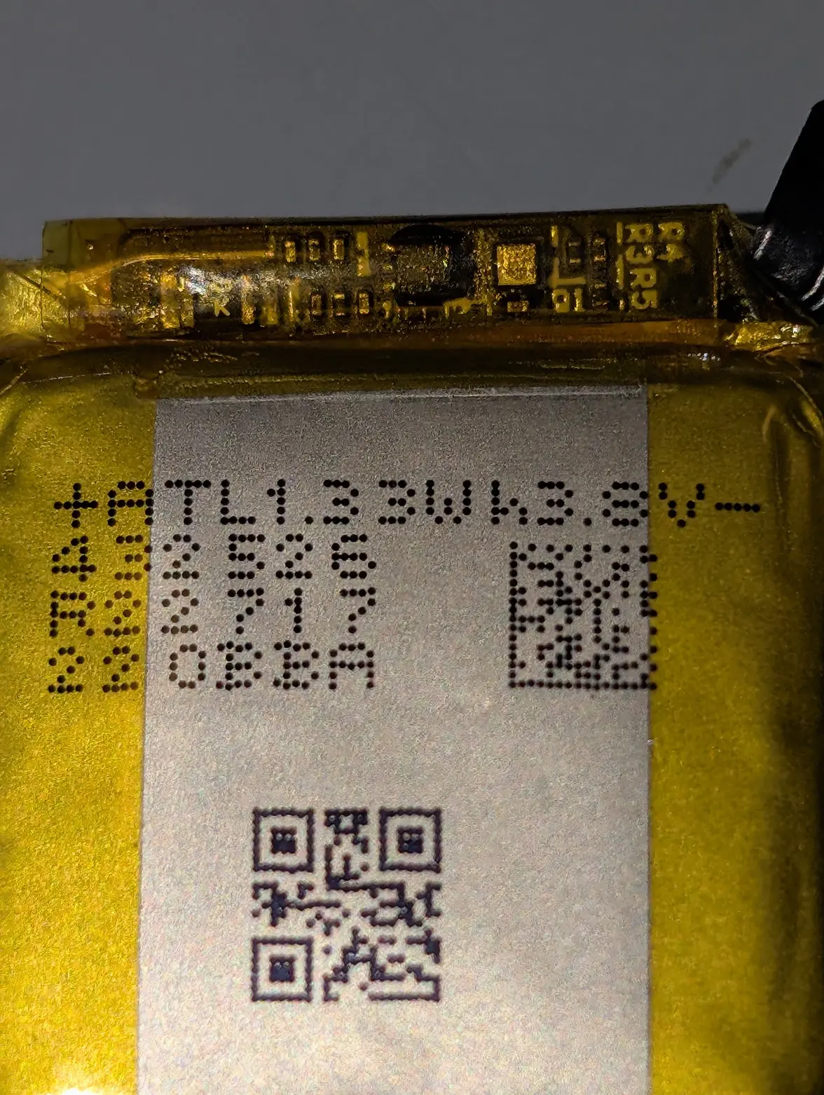

Ok had time over summer to do some more research and pull my E2 41mm apart as its totally died now.
Thought add this as background for futher exploration.
The rear side of the battery has the following on it as show in the photo
the 432526 are the dimensions in mm, so 4.3h*25w*26l
(also has the code 1IPC5/25/26 on the front, very similar to the E3 watch which is 1ICP5/25/26 ,
however looks like the E3 has a higher voltage battery)
the E2 45 battery dimensions are 4.3h * 28w * 30l (hence it wont fit as its 3mm too wide and 4mm too long)
I've gone searching for battery that are the correct size and found a few possibilities, will be ordering some to see what they are like
https://vi.aliexpress.com/item/1005....0.0.610a38daommWYX&mp=1&gatewayAdapt=glo2vnm
(Note this is slightly thicker at 5mm, but I think it will fit)
Hi David,
any luck with your exchange?
I noticed on some other forum a guy has stated that E2 45 mm battery would fit 41 mm as well. But reading this threat it looks like it won't.
Has anybody had any success replacing the battery for E2 41mm?
