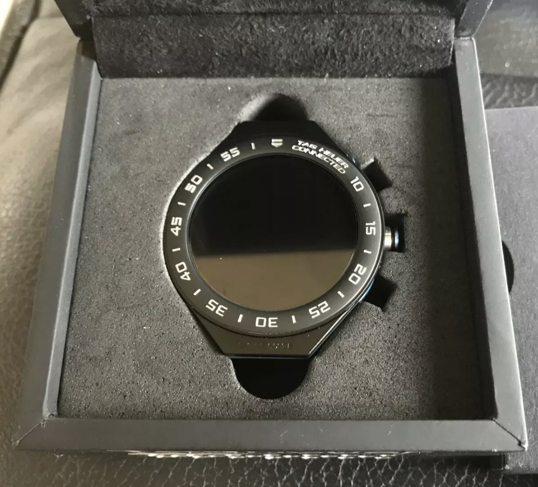

If we talk about the Connected Modular, another solution (in addition to the mechanical modules) to this future battery problem is buying a spare smartwatch module and keep it as a replacement. Price for just the head is obviously lower than for the complete watch, because we use same lugs, straps, and buckles from the original watch with the dead battery.
I have found one, brand new, still with the protective stickers, and I will keep it stored (it’s recommended to store it with the battery charged up to 80%) to secure that I will be able to enjoy my Modular 45 collection during many years, and not only with the mechanical modules. If someday the battery of my current Connected Modular 45 stops working, I will have this other smart module ready and with a fresh battery to replace it.
It’s not easy to find it new, but you can find a spare module with few use and better price. There are some for sale at ebay (at around €400-€500 depending on the condition), and also in our Marketplace forum:

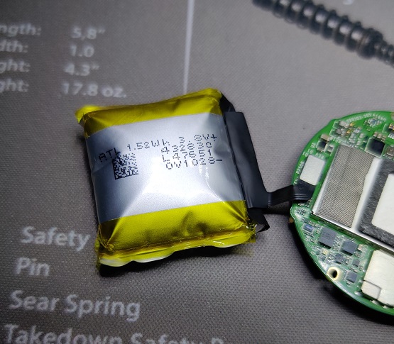

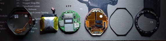

My oldest Gen2 started showing the signs of a swollen battery, very hot and only charging to ~15-20%. It disassembled pretty easily and I confirmed a swollen battery. Given it's age and the abuse from my daily use not really surprised. I have a couple of replacements on order and we'll see how replacing it goes.
Replacement

Wow that has really swollen. Did it start to open the case by itself due to the expansion ?
Please could you tell me the process you used to open the case, I’m quite close to wanting to do this process myself and don’t want to mess it up.

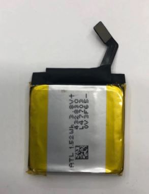

It disassembled pretty easily and I confirmed a swollen battery. I have a couple of replacements on order and we'll see how replacing it goes.
Replacement
Very interesting! 👍
Could you please post pictures of the disassembled Gen2, instructions on how to change the battery, and also where to order a new replacement battery (and price)? That would be very useful for all Gen2 owners 😀
Thanks @VRman ! 👍

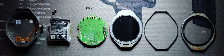

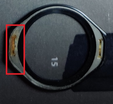

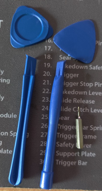

Here is a a couple of pics of all components, Right to Left. I used a plastic pry tool, 0.9mm hex bit and a small flat head. Bezel/antenna did not require to much force. From the underside I could see time and outside elements had started to break down the adhesive. This will surely not be the same for every watch. Heat from a heat gun may be required to loosen that adhesive.

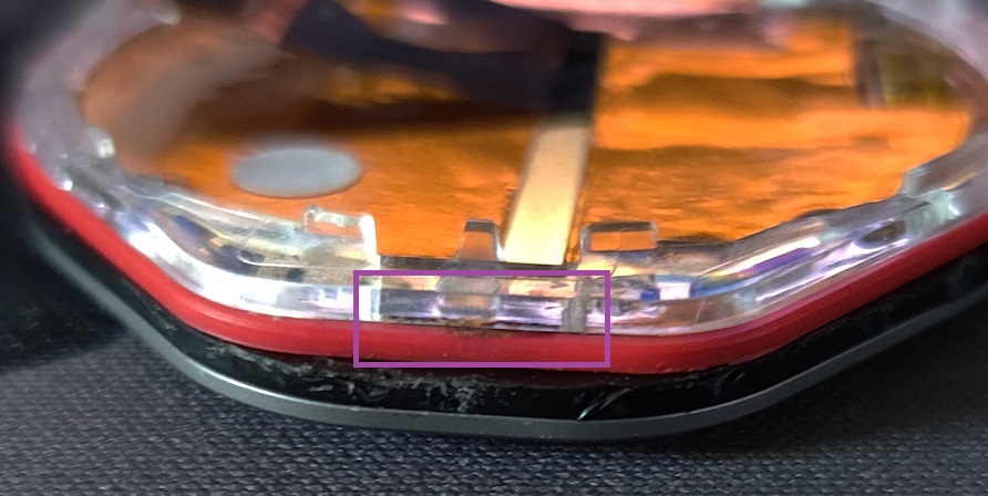

Using the plastic pry tool and taking my time avoiding any major damage to the orange o-ring and plastic sealing gasket that keeps the LCD module tight in the titanium body. This area requires extra attention to minimize any damage. This was the most difficult area and will require some sealant on reassembly. I also kept the LCD module intact and did not disassemble it any further.

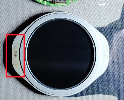

You can see that the watch started to get some moisture working its way in. This watch has daily exposure from a coastal environment, salt water/air so I am not surprised.
When I reassemble I'll use some marine adhesive and sealant in addition to whatever I use for the Bezel/antenna.
Battery sources:
https://www.aliexpress.com/item/4000989935440.html?spm=a2g0s.9042311.0.0.632e4c4dX1BF2m
https://www.ebay.com/itm/284101941835

Great , thank you. It seems like you did a very clean job in removing it all. Well done on that.
Am I right in thinking that the glue only holds black bezel onto the screen module, ? What holds the screen module to the titanium back casing ? Thx
is the glue only on the top and bottom of the bezel ? Thx
