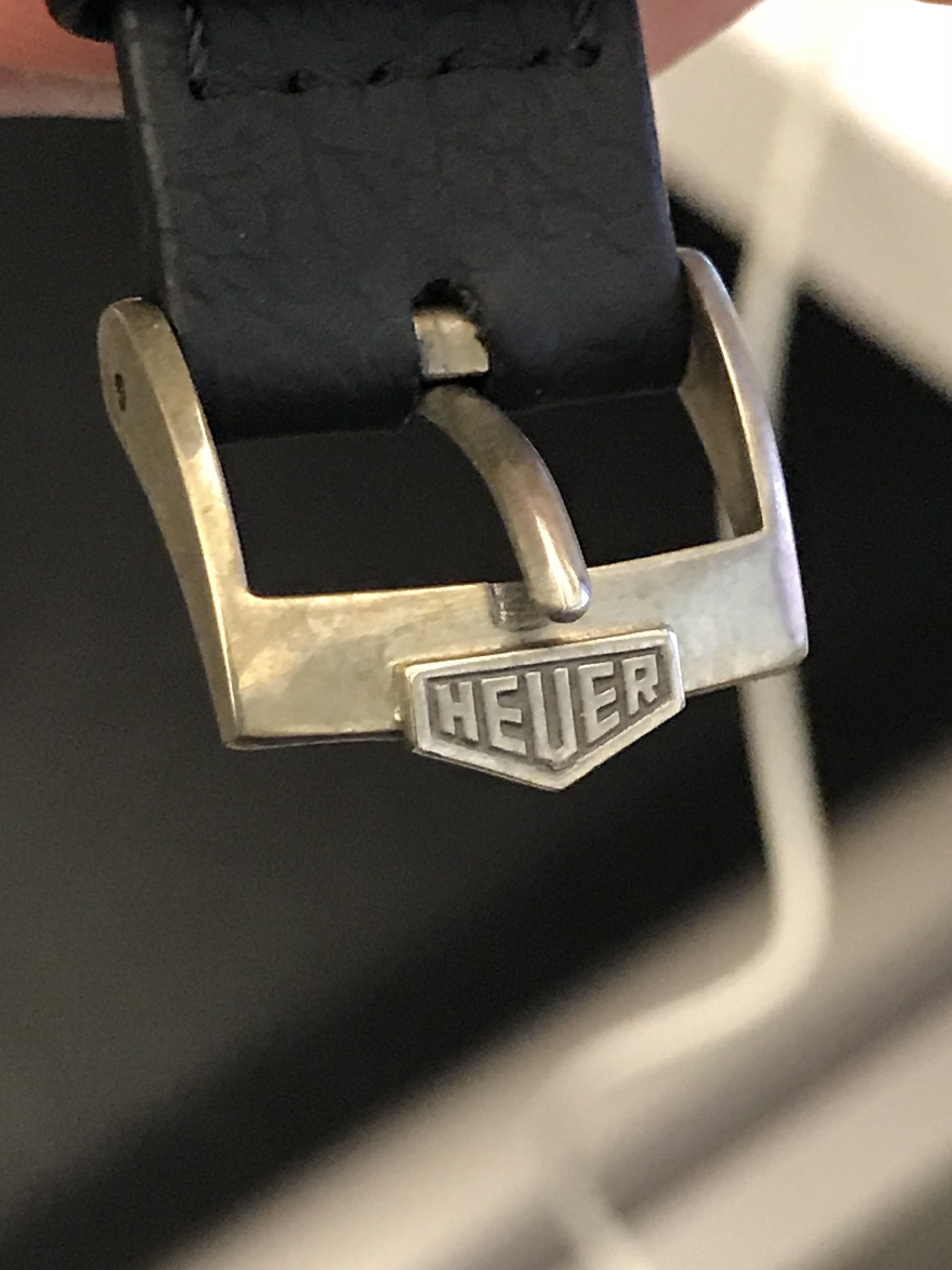

Hi,
how about that buckle, does some of you guys can say if its authentic?
Hard to say. The key to original buckles is that the Heuer shield is a separate part welded on. Modern reproductions are made all as one piece. I have one repo but is clearly is a repo, no attempt to put the markings on the back. Looks fine on a watch.

Hi,
Thanks for looking, appreciate your input! 😀

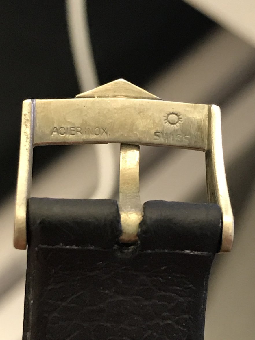

I don't love it, it looks a lot "fresher" than others I've seen. Luckily, I just so happen to be wearing my Carrera today, on which I have a sun buckle - here are a couple photos for comparison:
As @MRC correctly points out, you can clearly see the soldering bead on the shield. Also, every single sun buckle I've seen has a darker Heuer logo, maybe it's tarnish. And lastly, the "SWISS" mark is not centered below the sun as it should be.
In summation, I don't like this one - unless it's priced like a repro B buckle (about US $50, vs about US $500 for a genuine sun buckle)
Great input, thanks at @abrod520 and @MRC !

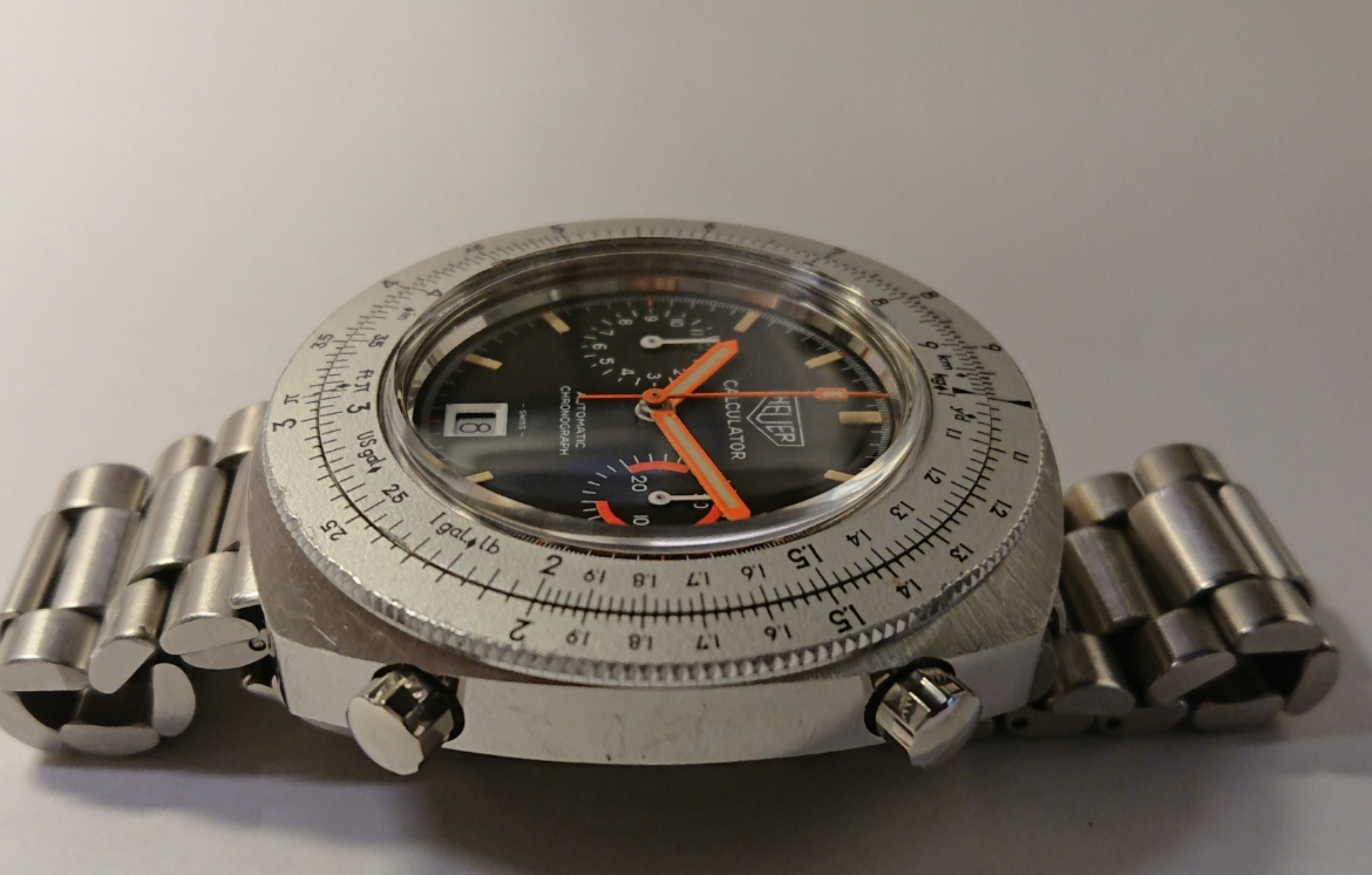

Hi There, have an opportunity to purchase a watch I have been after for a long time. I have done my checking, comparing with photos from On the Dash versions and think she is OK. Anyone here think different?
643
765
Looks fine to me.
To be honest the Calculator is not a watch I’d expect to be Franken or faked just because it’s such an abnormality due to size and the case style.
