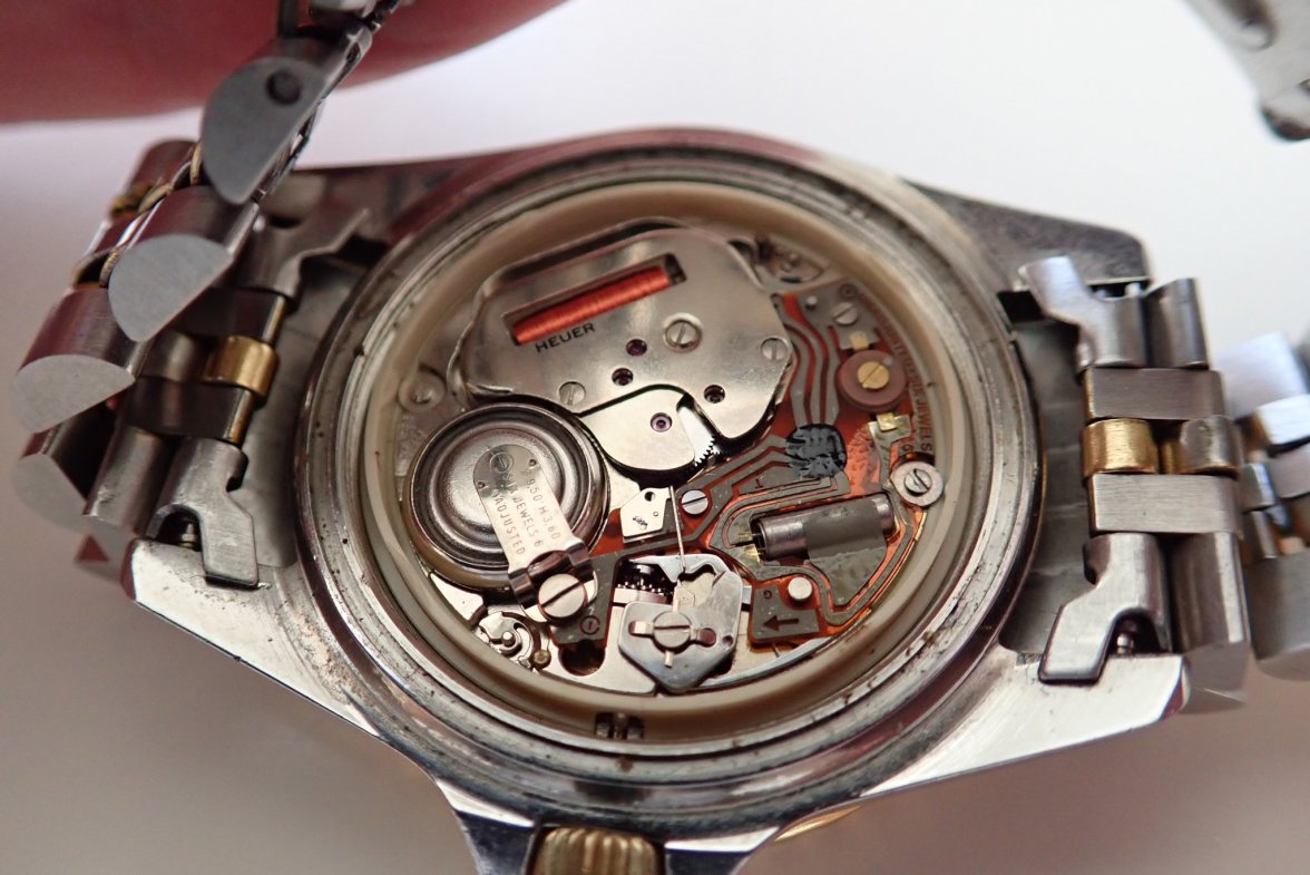

Is this movement legit for a Heuer 1000, 980.020L? (The gasket is not there I know)
@1965ek yes it is genuine.
On the L variants the switch was made from an earlier ESA 536.121 movement to the ESA 963.114, and I believe changed the case slightly as the two movements were different thicknesses. I think yours is thinner than the earlier one, making fitting a replacement automatic movement not so easy compared to the earlier non-L models. I don’t recall all the details as never looked to replace one of these.
If you look above and left of the battery (in the highlighted area in your picture) you will find the movement model number to confirm it is an ESA 963.114.

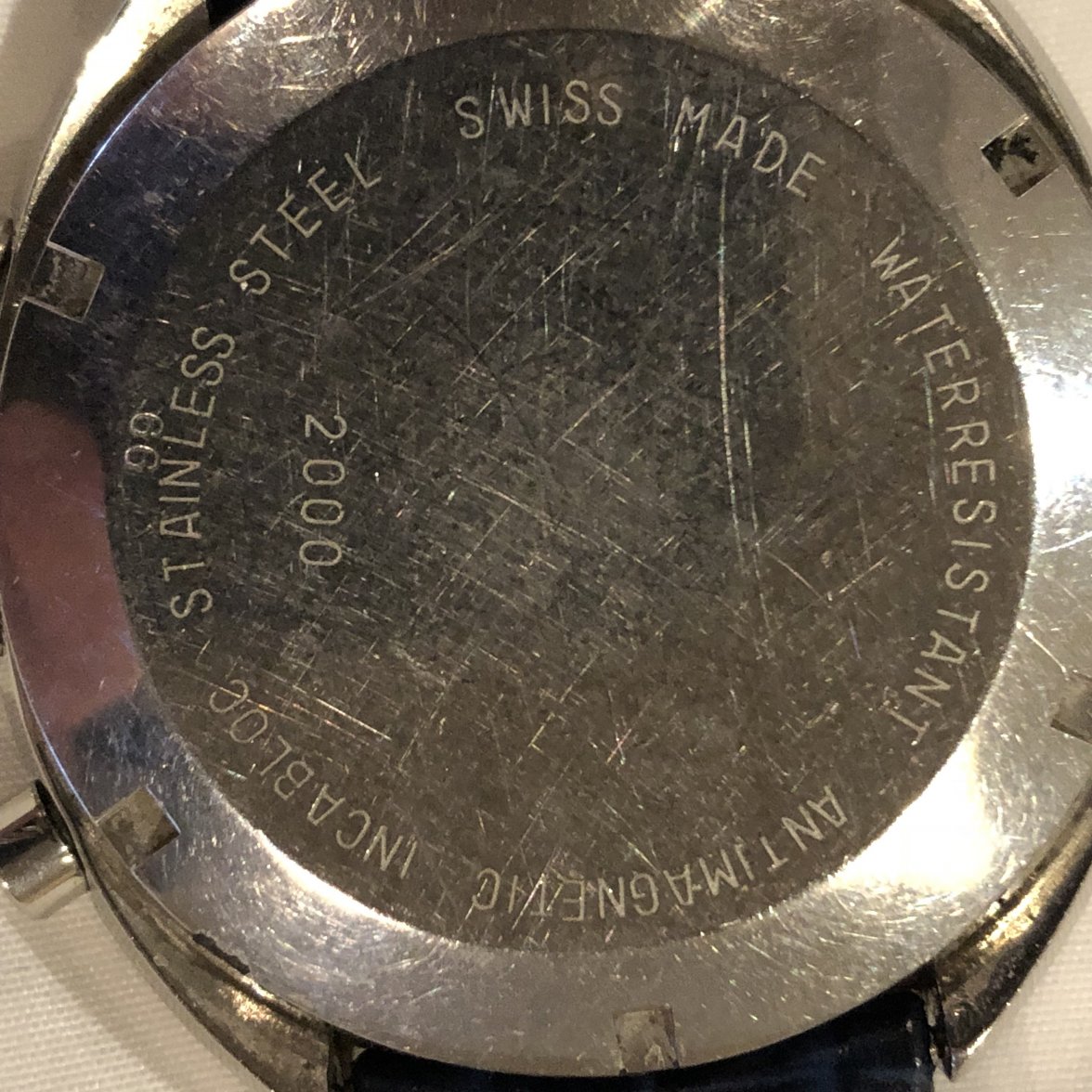

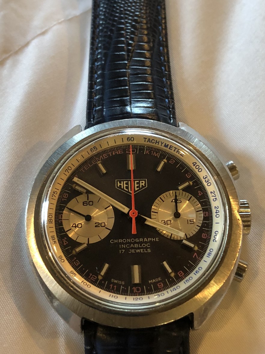

I received this back in the 70’s. My parents were traveling in Germany. It’s been sitting in a drawer for years. Thanks for any insight.
7,124
15,117
Good question! This is one of several 1970s Heuers that are questionable. See the debate here:
https://forums.calibre11.com/threads/unknown-model-or.19199/
However, if you got the watch in the 1970s, then that is a very, very interesting piece of information, as the truth is that there would have been very few/ no replicas back then. Are there any model numbers on the back?

Thank you for the reply. The number on the back is 2000. There is also what looks like the number 99How do you conclusively validate if it’s authentic? If it were authentic, would you be able to estimate its value?
