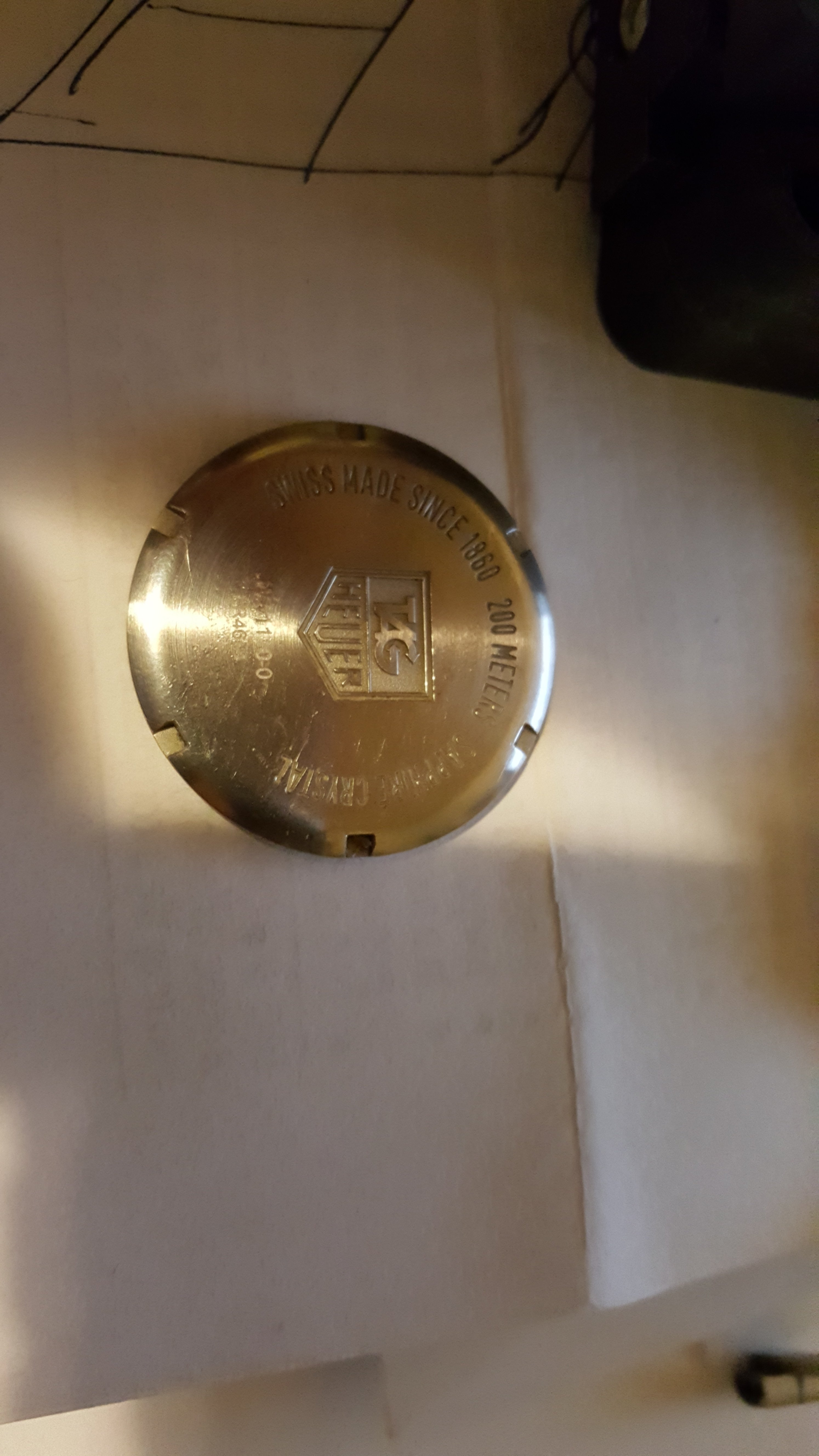

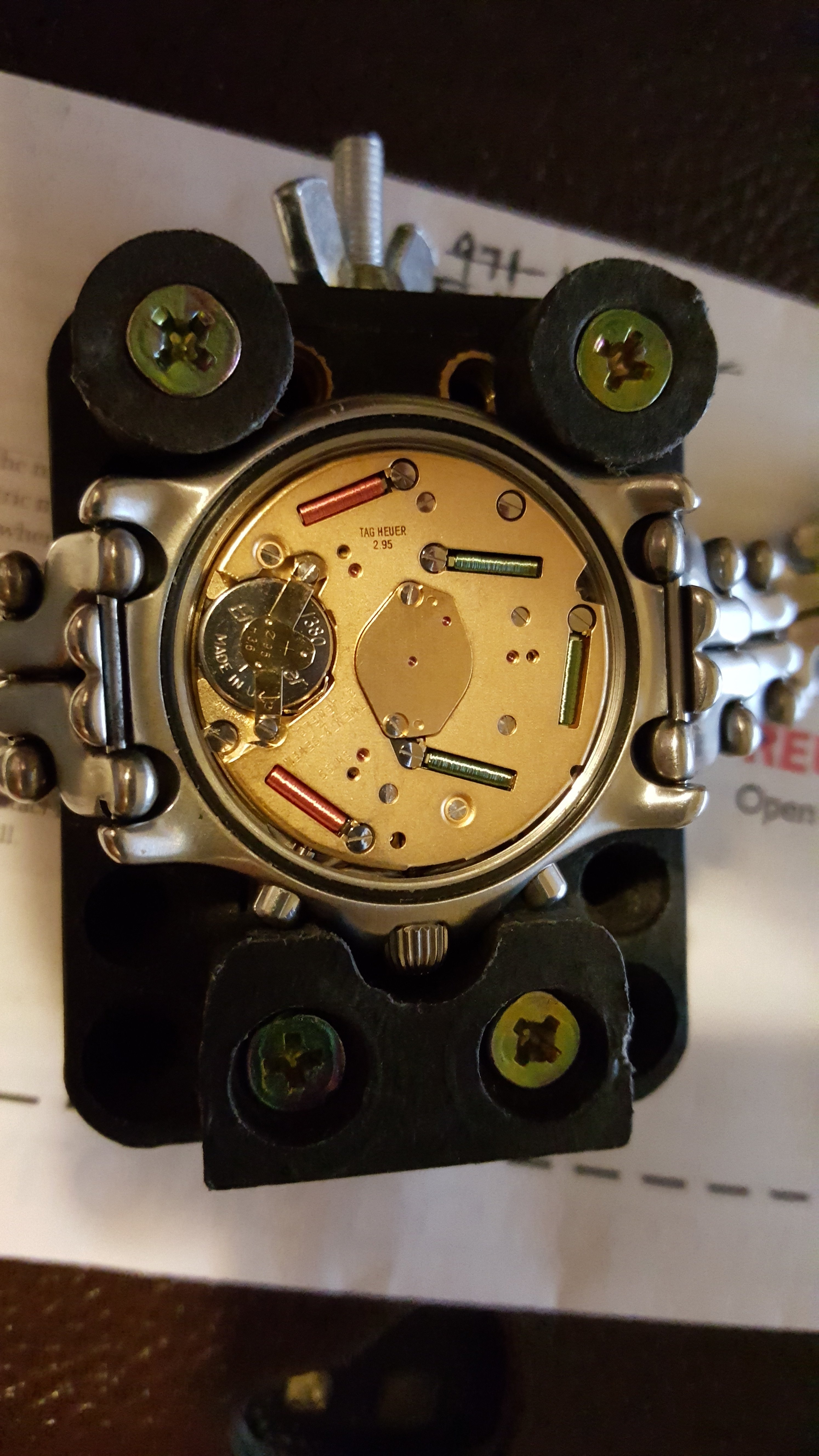

20160210_181149_zpsahikvrfy.jpg 20160210_184406_zpsg8nl1cvp.jpg I just purchased a watch. It is a model wt1110-ba0550 link. It feels solid and came with the tag box and warranty card (not filled out). The card not being filled out makes me a little nervous, so I opened up the back to see the movement. It is not marked with much that I can tell, but is stamped "there jewels". Other than sending it in for an appraisal, is there another easy to verify its authenticity?
375
223
The watch looks authentic to me, the movement could be a replacement, as I would expect an ETA 955.112 in it, not this later model F06.111, but is a minor thing, you only have no End Of Life function on it when the battery is almost dead. Any serial number on the caseback-plate?

This is what my sel chronograph movement looks like. I assumed the movement in the link should have been stamped the same. Unless my sel is a fake.

Serial number on the caseback plate looks good too, I wouldn't worry about the missing TAG Heuer description on the movement of the Link, it could be replaced in the past. The movement in the S/EL is an ETA 251.262, totally different as it is a chronograph of course. The TAG Heuer 2.95 description on it means TAG Heuer got it in stock on the second quarter of the year 1995, that's all.

Cool. Well that puts my mind at ease. I picked up the link for $440. I thought it was a great deal. The watch is a bit rough, as can be seen in the photos, but I think with a good cleaning and a polish, it will make a great watch.
