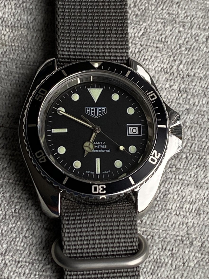

I recently (2 weeks ago) had my 844/5 serviced by an independent repair workshop in south london, including a new glass (not sure if it was proper sapphire crystal), and a general clean up, but this morning I found moisture on the inner surface of the glass.
Would this be simple condensation? I haven't opened the crown since I picked up the watch 2 weeks ago and it wasn't 'that' cold this morning. (Condensation might be moisture held in the air within the watch body condensing onto the glass if the glass was cold).
I wear the watch almost permanently and although I haven't been for a swim yet, I do washing up, wash my hands etc without removing the watch.
I've never (that I can remember) seen moisture inside the glass before (owned the watch from new).
I opened the crown and left the watch sitting on a warm radiator for a couple of hours this morning to hopefully expunge the moisture and let it out, but there's still some marks on the glass I can't polish off, which appear to be on the inner surface. Bit annoying given that it's new glass!!
I'm currently thinking to take the watch back to the repair shop and question whether or not he replaced the seal correctly - is that worth it?
I was hoping that the watch would be returned to me in better condition than it was in before - but if it's now not waterproof then, frankly, I will be EXTREMELY unhappy. I DO use the watch as a timepiece when swimming and snorkelling, and certainly in all weathers.

I would definately take it back to the watchmaker about this at least to first hear what he says about it.
833
1,563
Hi, yes it could well be condensation.
2 things-
1-absolutely take it back to the service centre and have them sort it out
2 was it pressure tested as part of the service? You may want to check that before exposing it to water 'properly'.
Good luck!

I doubt very much it was pressure tested. (how is that done? I assume the watch is NOT dunked in a 50ft deep well....)
Hoping to be able to take it back this weekend.

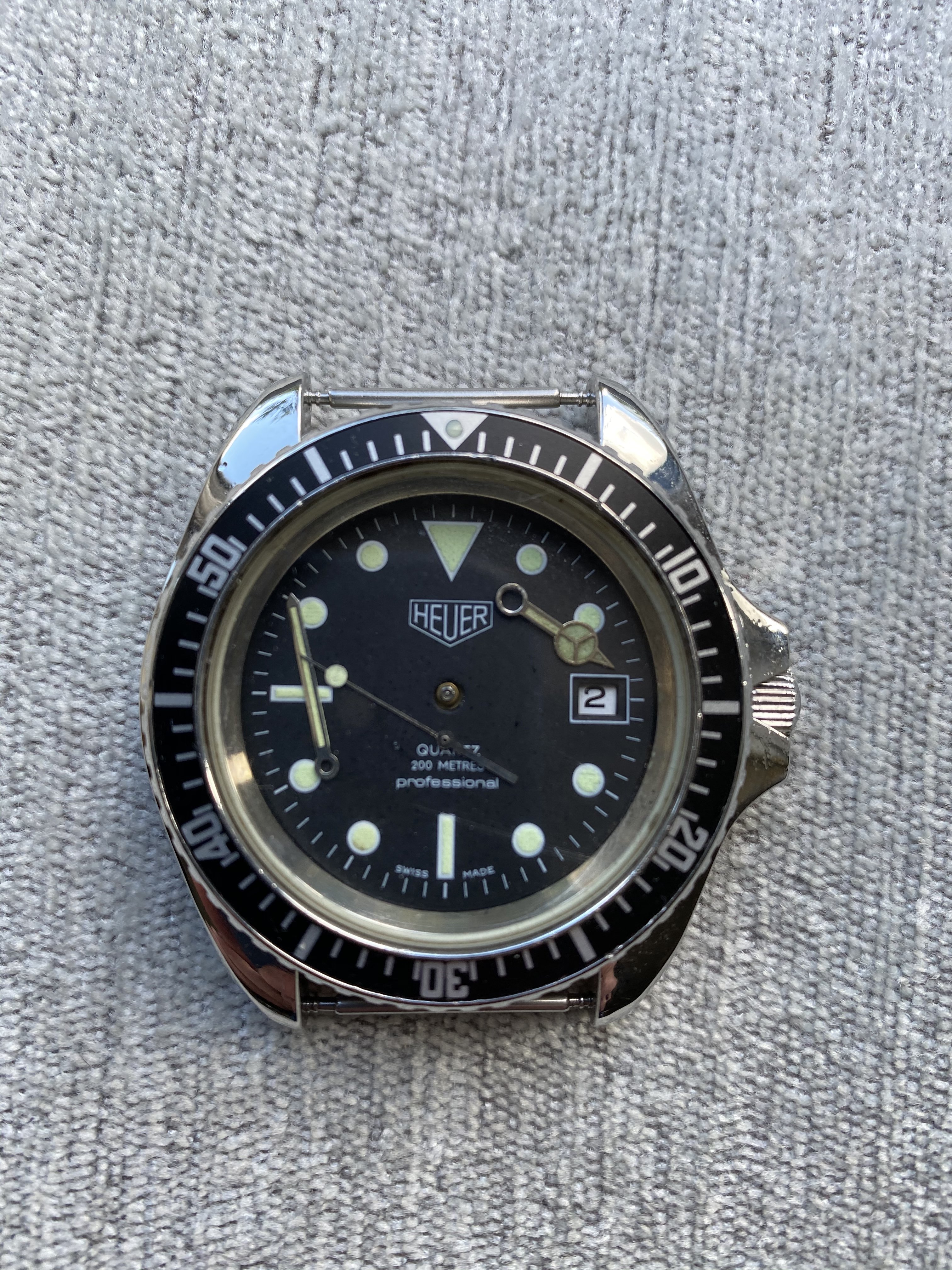

dsc_0862-jpg.880477
hmm - it's back again. 🙁
643
765
dsc_0862-jpg.880477
Yeah that’s no good. Take it back.
Pressure testing is simple to do and most decent workshops it’s an automated bench top device which confirms the seals on the watch to the specified rating.

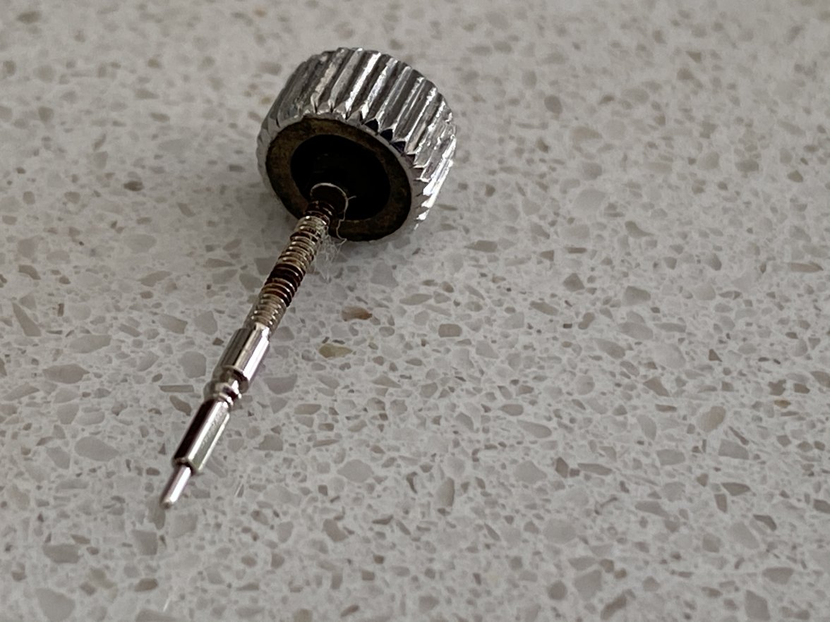

Just an update if anyone is genuinely interested: the watch did go back, it turns out the button wasn't replaced and we suspect the button seal is worn out. So he's currently awaiting a new button of the correct sort, after which he'll fully clean the interior of the case again, reassemble and then pressure test and confirm it's sealed.
If it's still not right, then I'm probably going to ask for at least some of my money back, and either send it to Switzerland again (it's been back twice before over the years), or post it off to another specialist.

Just an update for everyone (if anyone is interested).
We failed to fit the new crown to the watch - because my watch has the 3mm external diameter 'tube' fitted. Apparantly all the current TAG crowns are for a 2.5mm diameter tube.
We also discovered that the internal thread of the 3mm tube is partially worn out (about half of the thread is gone).
The jeweller refitted the original(?) crown with a tiny dab of silicon grease to at least make the watch weatherproof for the time being, and I'm now considering the options:
Fit a replacement 2.5mm TAG tube and crown?
Fit a replacement 3mm (probably non-TAG) tube and crown?
I can only assume that the 3mm tube is the original one because the watch was repaired at least twice by TAG Heuer over the years (each time I was assured it was sent to Switzerland for the work), so I don't know if the tube and crown were replaced on either of those occasions.
Oh - and irritatingly it's now losing about a minute a day.... 🙁
Any suggestions?
