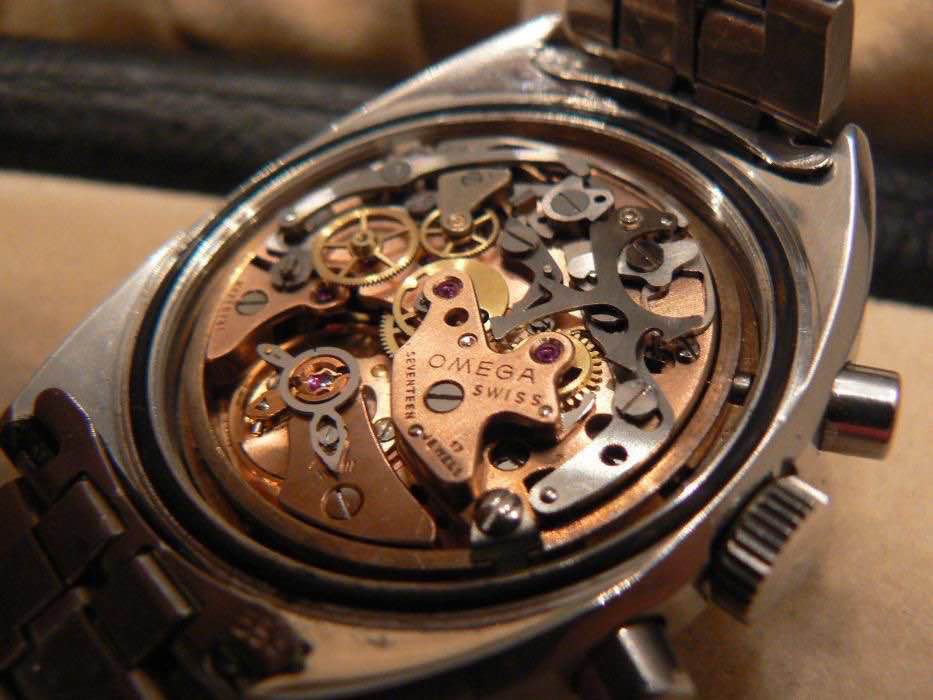

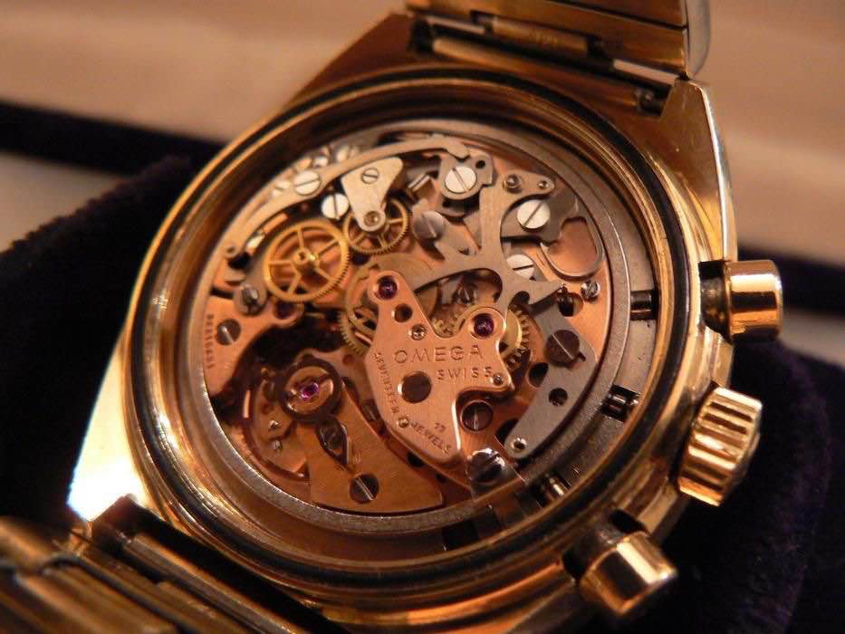

Here are 2 pictures of 2 Omega watches from the 70s. The movements are caliber 861 and they look very similar to the Lemania 1873 with a "Rodium bath" on some parts, except for the "Omega signature". Note the serial numbers on the same spot.

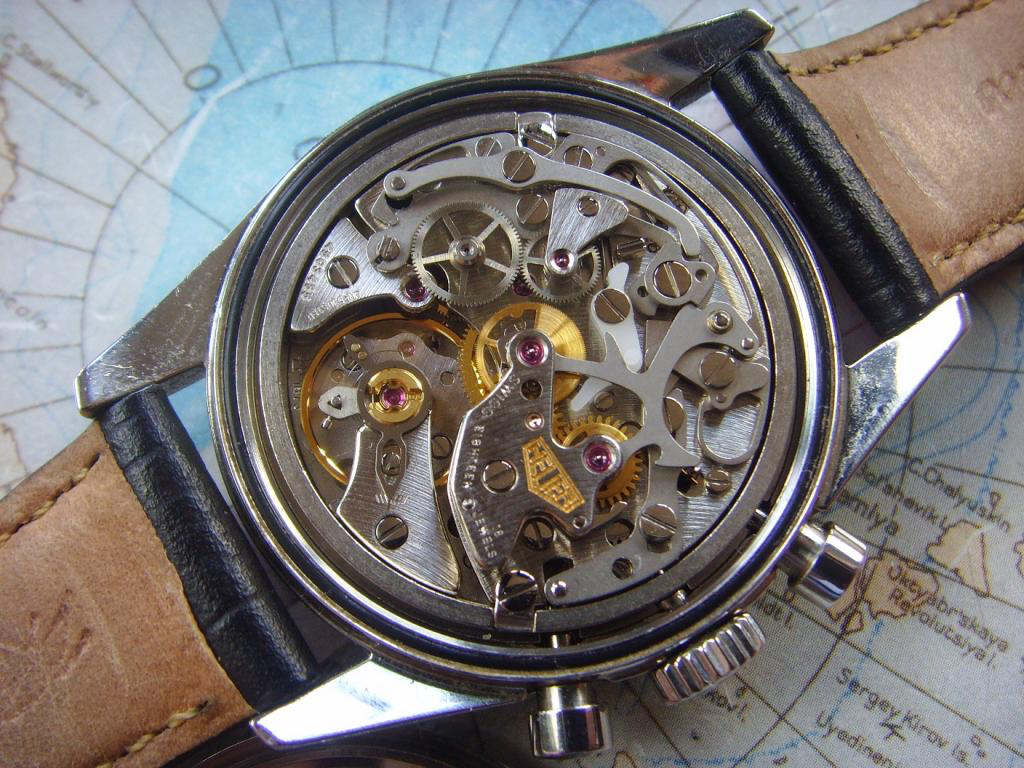

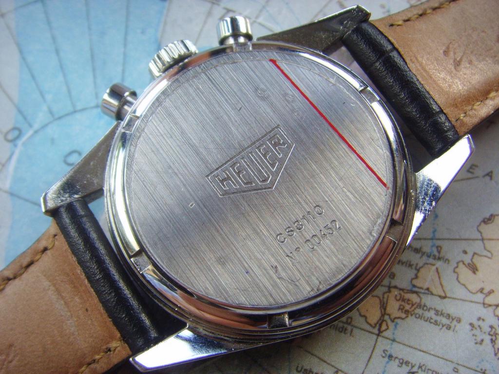

Take a look at this Carrera Re-edition. Reference CS3110 and limited edition number 00452
Here is the movement of the same watch

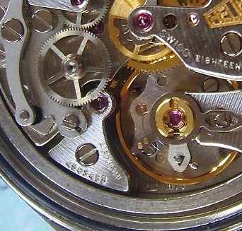

Hard to see the number on the movement, but here it is
It looks like 4805485..maybe I have a digit or two wrong, but it's not 00452.
So, to me looks like that is the serial number of the movement, not the watch

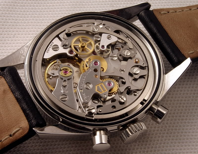

By the way, we know that there are different case backs for earlier/ later versions of the same reference numbers. Take a look at the movement on this watch
Note that the Heuer Shield on the movement has been replaced with a TAG Heuer shield
