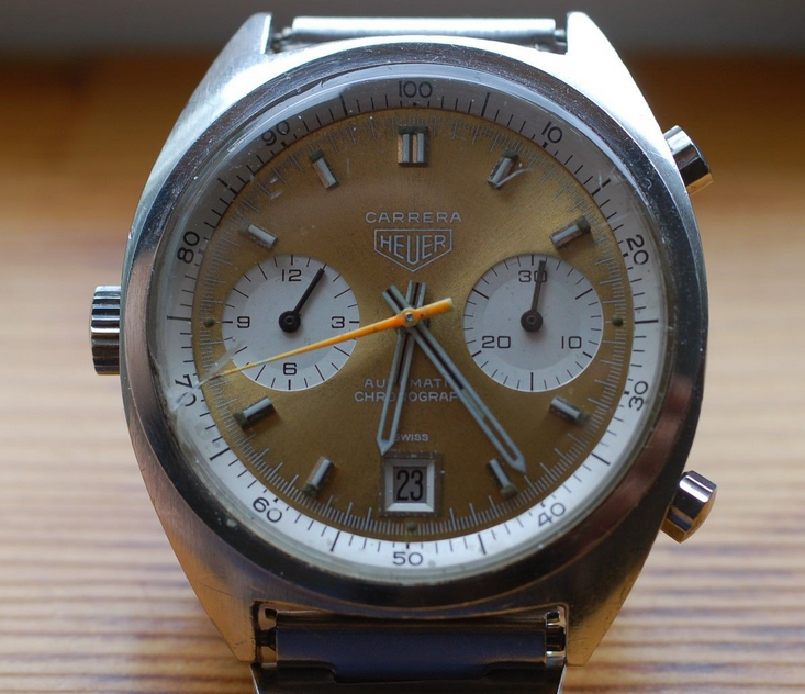

Has anyone ever seen a Montreal like this one before? Apparently signed 110503B but more than a few things differ from that reference.
Looks mismatched but then I haven't seen such hour markers before. Also the white tachy doesn't have 'tachymetre' so no simple mismatch of the white Montreal tachy although the white subdial hands suggest so. Blue subdials, white lume on the hour hands,...
833
1,563
The bezel seems OK-this Montreal bezel design doesn't always have 'Tachtmetre' written, as per this less usual 110.503W-http://www.onthedash.com/Guide/_Chronographs/72.Montreal/f.Ref_110.503W_White/
However the dial concerns me as the font isn't typical for a Montreal nor does the date window have a surround. (although this design can be seen on some other of the later Heuer models) Hands are a bit 'pointy' too.
'Service invoice of Tag Heuer, dated 23 Mai 2017 and a Tag Heuer service Box.' could this be what passes for a TH service dial/hands these days.......?

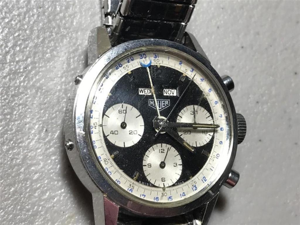

This "Paintless Wonder" Carrera just ended on eBay at $4400 - strong money for a watch that will require some capital expenditure for parts. It's beautiful though, and were it less expensive I'd have gone for it.
Thing is, most of the Heuer paintless wonders seen (Monacos and Silverstones usually) are uneven, and still in the process of losing their paint. This one is completely down to the brass - yet the markings still survive 100% intact (a feature consistent with other paintless wonders). Truly remarkable - I wish I had the resources and connections to buy this one and get it into fighting shape!

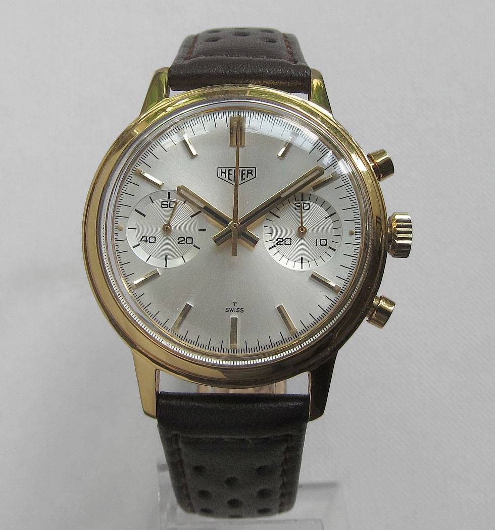

Hi
I've been looking at this 7725S on EBay UK recently. It's gold plated and I like the Carrera vibe but the gold plating looks a bit .. well , yellow?
No service history, gold plated = avoid?

I think the yellowness is probably just down to the lighting. I wonder about those hands though - see http://www.onthedash.com/chronograph/reference-7725-s/
833
1,563
Personally I'd steer clear of this one Mike. Hands are wrong, case is wrong. Reasonable chance the movement is generic and not Heuer signed too; in which case you're paying 拢00s for a Heuer dial. (and a watch that may look kinda nice to some, but sure ain't Heuer!)
Best,
Steve

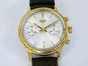

SCAM HEUER CAMARO ON EBAY!
My recently sold Camaro has just appeared on Ebay posted by a scammer. PLEASE DO NOT BID as you will not receive the watch.
https://www.ebay.co.uk/itm/Heuer-Camaro-7743T-silver-dial-Valjoux-7730/124104464764?_trkparms=aid=111001&algo=REC.SEED&ao=1&asc=20160908105057&meid=319d466aa1c946acb80fa9e244524f7e&pid=100675&rk=1&rkt=15&mehot=none&sd=124104464764&itm=124104464764&pmt=0&noa=1&pg=2380057&_trksid=p2380057.c100675.m4236&_trkparms=pageci:f327681a-5d34-11ea-99a5-74dbd180be24|parentrq:9fd14b941700a99b86e0e35effee6278|iid:1
Item number 124104464764
posted by Ebay user hart3455 and using email address [email protected]
It has been reported to Ebay.
Thanks for looking.
Steve
Reported also for you under both fraudulent listing and avoiding ebay fees (contact details in image).
