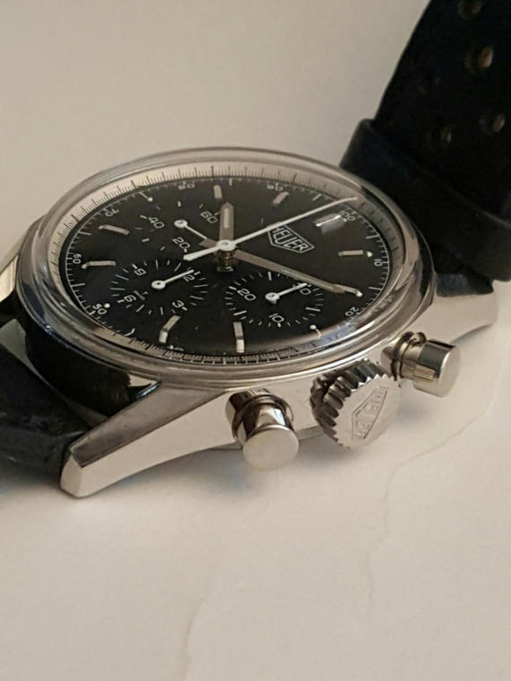

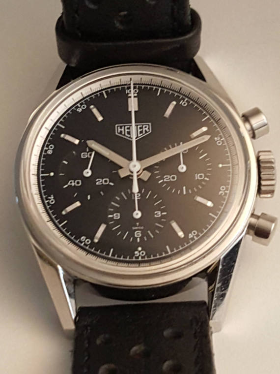

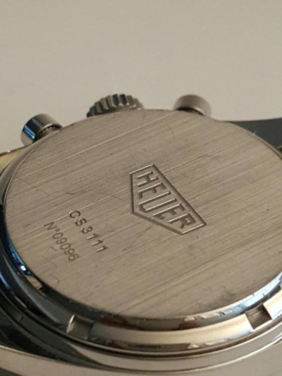

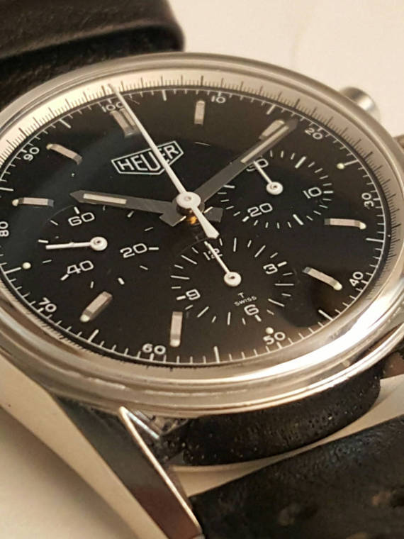

Came across a CS3111 Carrera reissue. I'm pretty confident that it is authentic, but was wondering if anyone could confirm that for me based on the pics below. It's going for about ~$1,900 and the only thing that isn't original is the strap. Good deal?
1,817
1,392
It is, but request better, sharper photos as that lug looks like it had a hard life.
6,142
7,416
It's real for sure. Doubt you'll find any convincing fakes of that model. It's also unusual to find one with the original strap that's still in good condition. But deduct a few $ if it doesn't have the original Heuer buckle.

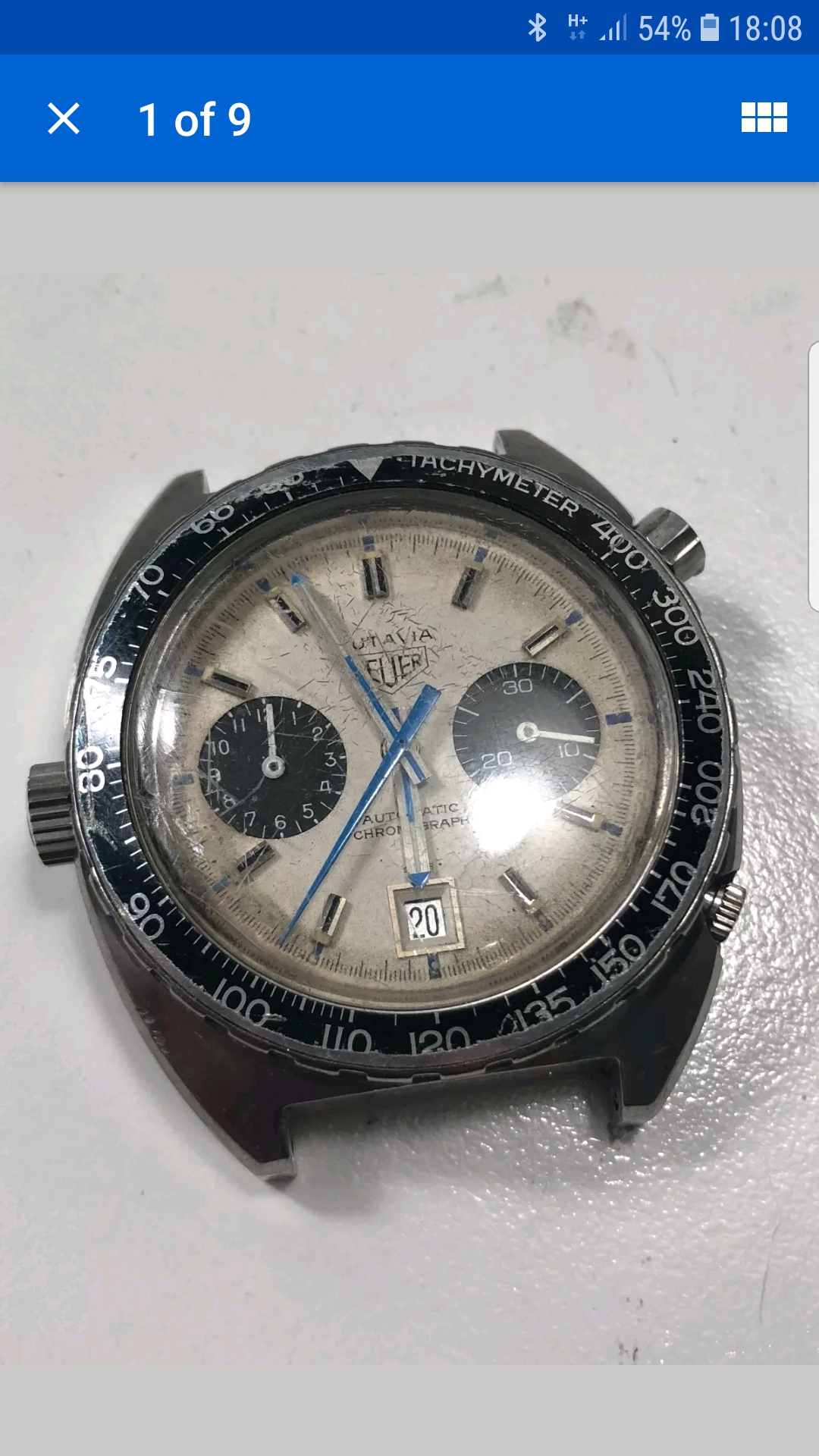

At £4,000 with a day to go... I think that's too much though. Here's why:
-Dented-up case with soft bevels (at this point even a skilled polish would be noticeable)
-One missing pusher and one dented pusher (very very hard to find replacements)
-Chrono not resetting to zero (unfortunately, Chronomatic movements with problems are very difficult and expensive to repair)
And the nail in the coffin, from the seller's own description (emphasis mine):
Please note, glass is heavily scratched and dial is Dirty its not just the glass that is dirty.
Many a deal has been gotten on old watches with beautiful dials under scratched-up crystals, but a dirty dial is very difficult to rectify.
Unfortunately, rehabilitating this watch back to a nice condition will take far too much money and effort to end up being worth it, considering that this is a Mk6 Siffert, which are the least rare versions.

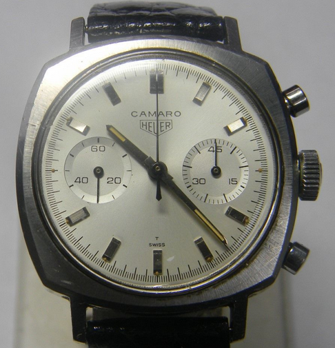

I'm feeling generous today*, so I will leave this gift for you gentlemen.
https://www.ebay.com/itm/222966121996
This is one of the most excellent-condition Camaros I've seen, and while the seller has it listed as a 7743 it most definitely is not...
*will one of you please buy it so I don't have to?

Fair enough. I had no idea how much it would be worth. I didn't think the case looked too bad, though, and the dial - well difficult to say. It doesn't look too "dirty" under there, but are those cracks near the Heuer logo on the dial or the crystal?
That's really nice! You saw it first, though.
Yeah this has been listed a few times now. I reached out in mid-April to ask the serial so I could clarify some points for the seller, to help list it correctly. No reply so apparently not interested. NIce piece of course....but you don't need another 9220 do you Mr abrod ...?
I don't have the budget to buy it, and don't really need another Camaro. But it's amazing, so if nobody else does I will probably make an offer... If you like it, go for it - it's all correct and the dial has beautiful lume
Huh strange, it's never popped up on my radar before it was listed last week. I wonder if the seller just doesn't check their messages?
I definitely do not need another 9220! And 100% cannot afford it. But just look at this one
