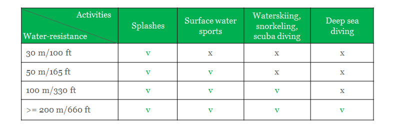

There is a reason that the booklet says "water resistant" and not "water proof"! By the way, here are the oifficial TAG Heuer recommendations when it comes to using your watch in water
Did you know that TAG Heuer recommends checking the seals every 12 months? That's how easy it is for your 500m "water resistant" watch to have an issue with its seal and render the whole watch leaky. It's not just TAG Heuer- Omega also recommend every year.
