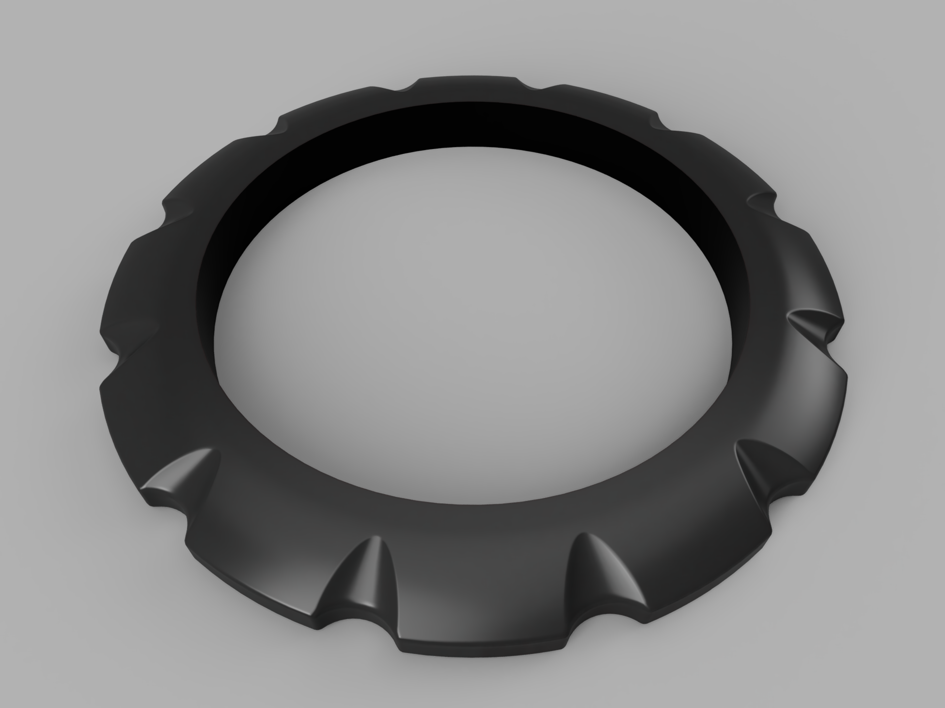

First of all, I hate the fact that new collectors of vintage Formula 1's have to pay an extra for a plastic bezel in new condition.
So i took initiative and modelled the bezel in Fusion 360...
After i will finish it, i will make the model public for everybody to print their own (on a resin printer preferably, for the extra quality)
These are the first versions, and i have a lot of work to do on them...
Hope to get some feedback on this project!

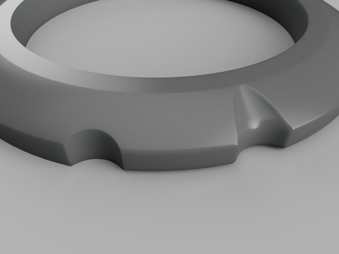

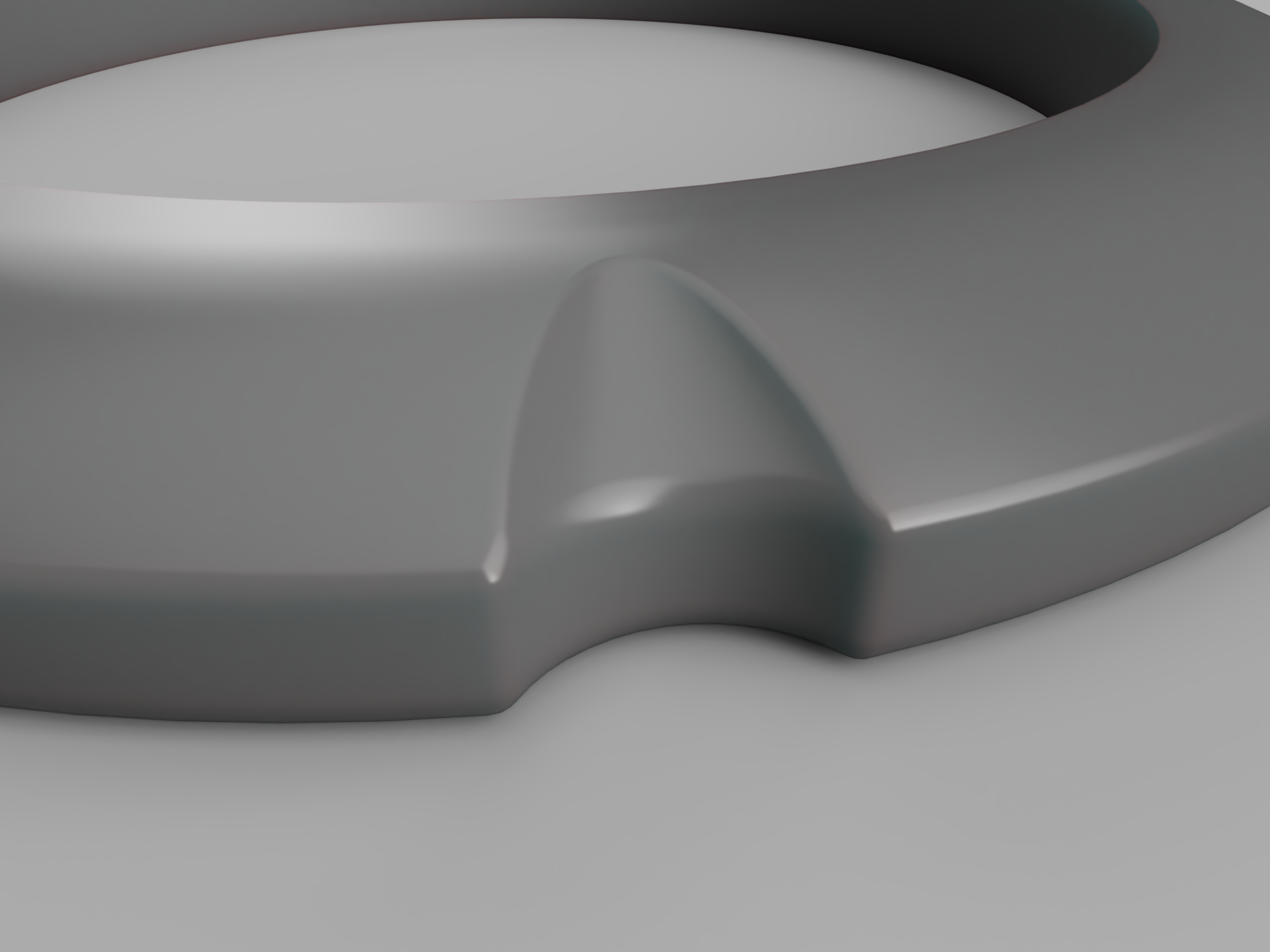

I remade it with the right dimentions
Took me 2 hours for 1 chamfer.
This is before and after!

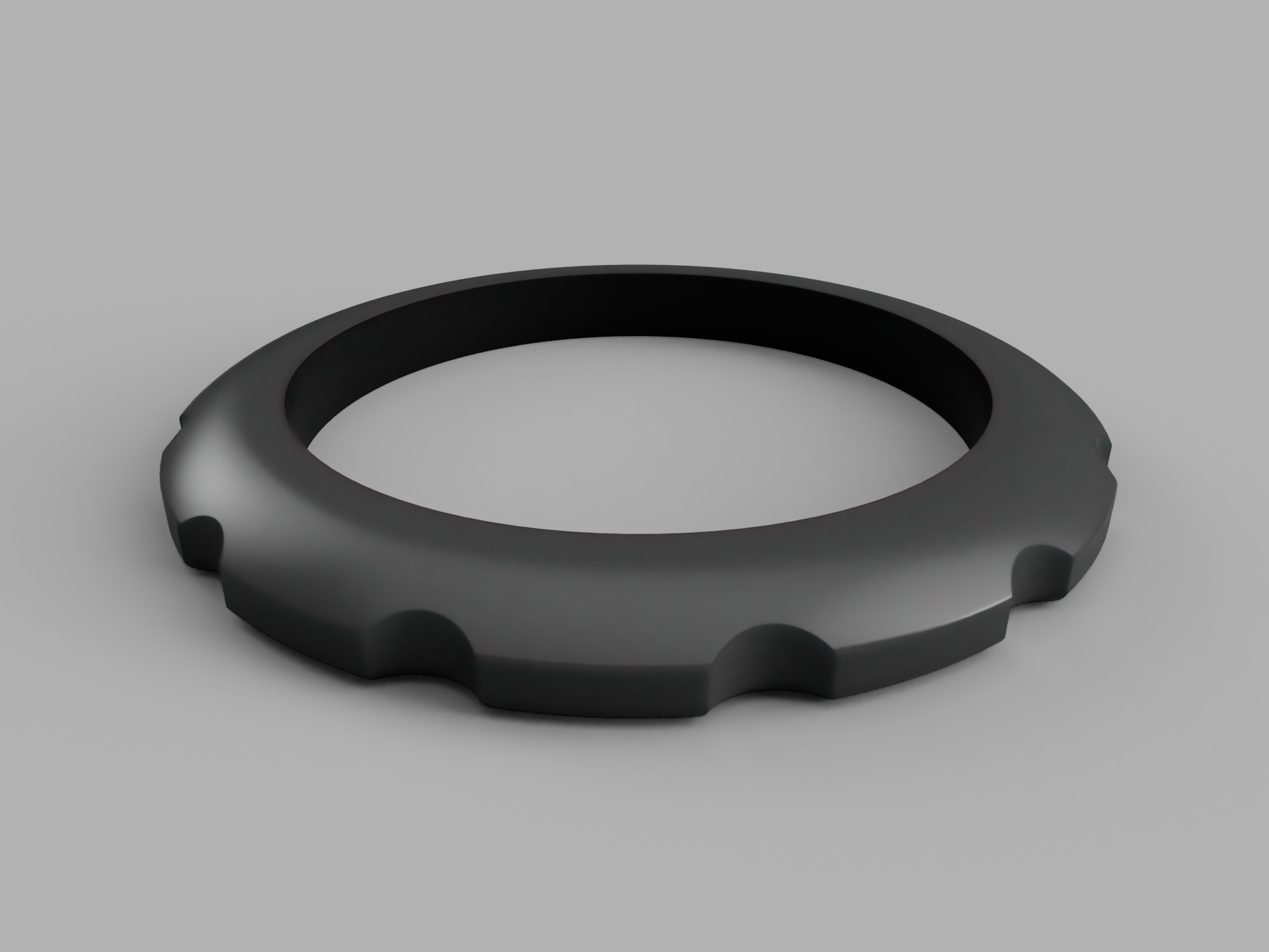

35
53
Some sketches

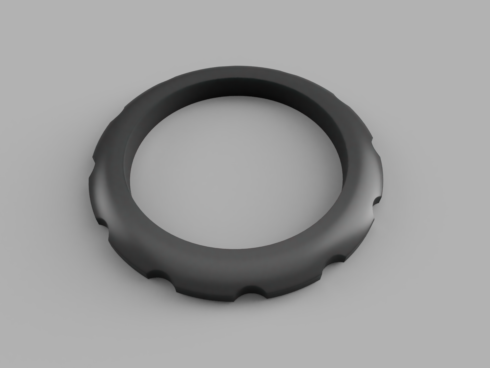

35
53

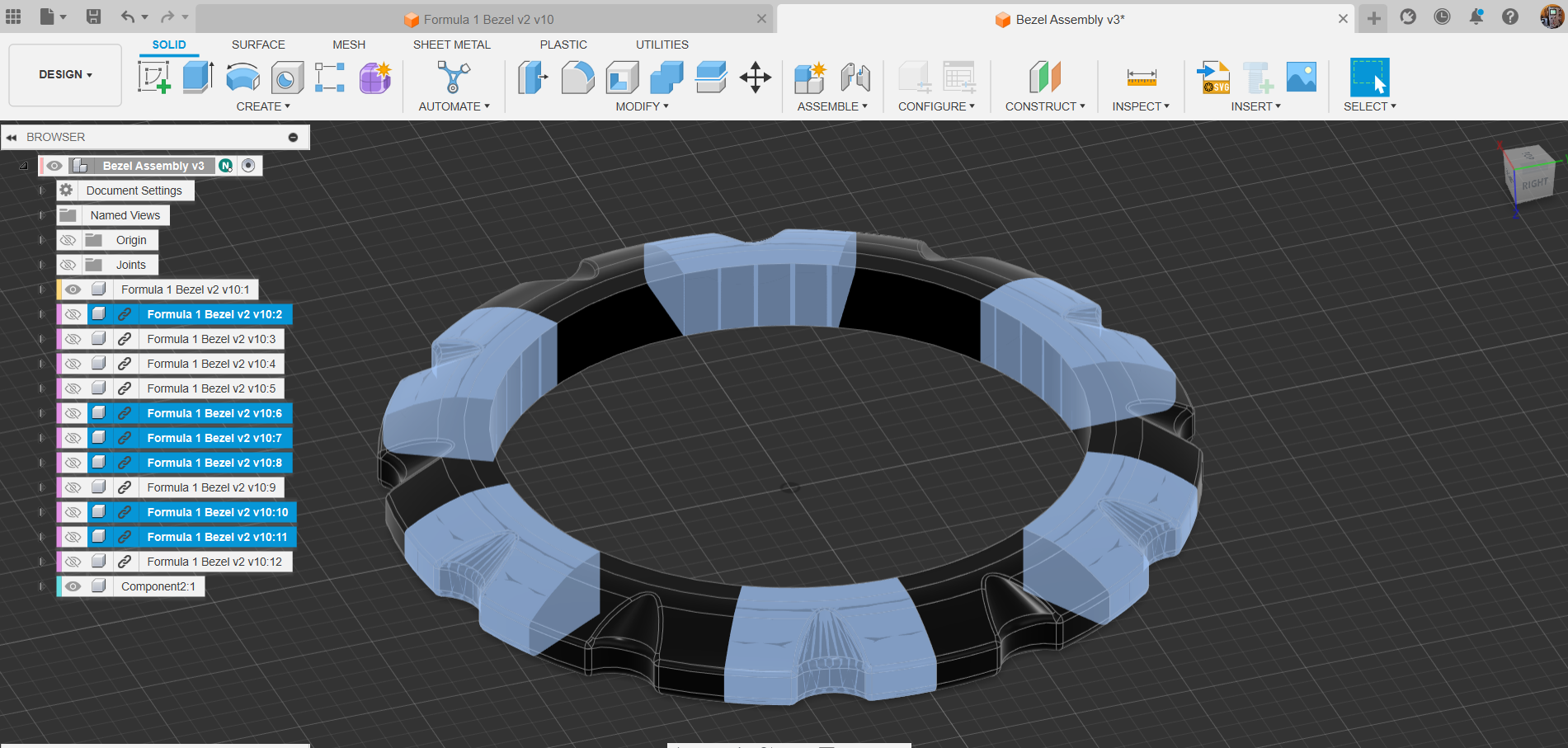

Cheated a bit by combining chunks of the bezel but it turned out pretty good!

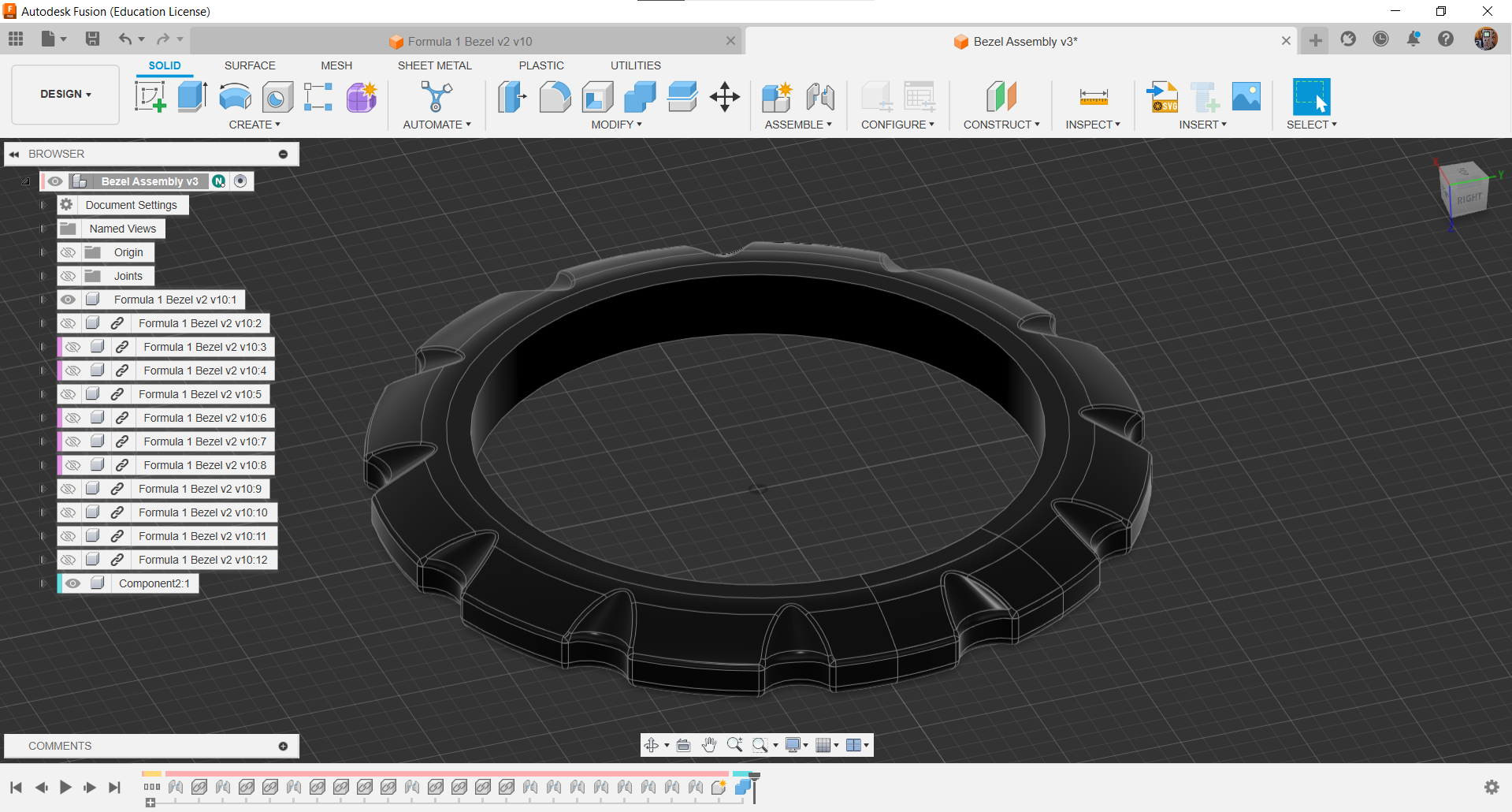

35
53

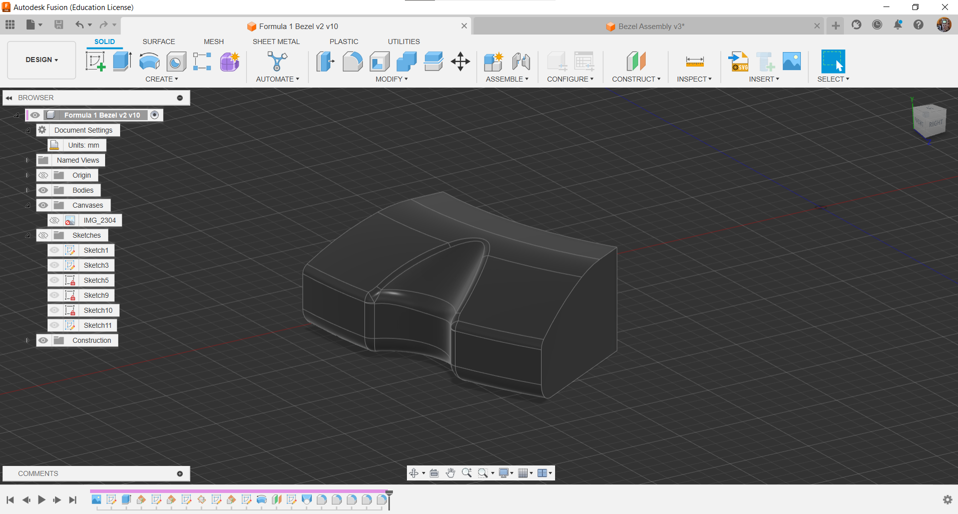

The bezel was made chunk by chunk
Because i'm not making that chamfer 11 more times
This is a piece of the bezel
Basically Lego

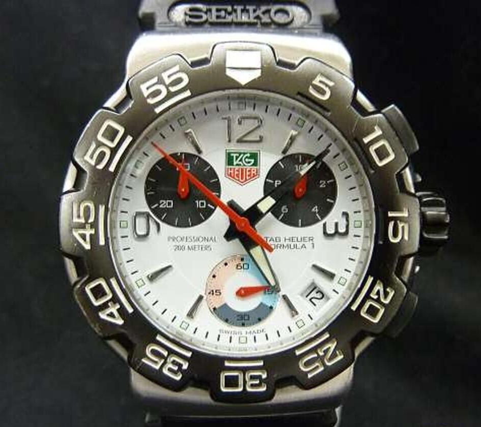

I have the same watch that you used in the photograph. I can help you with the measurements of the bezel.

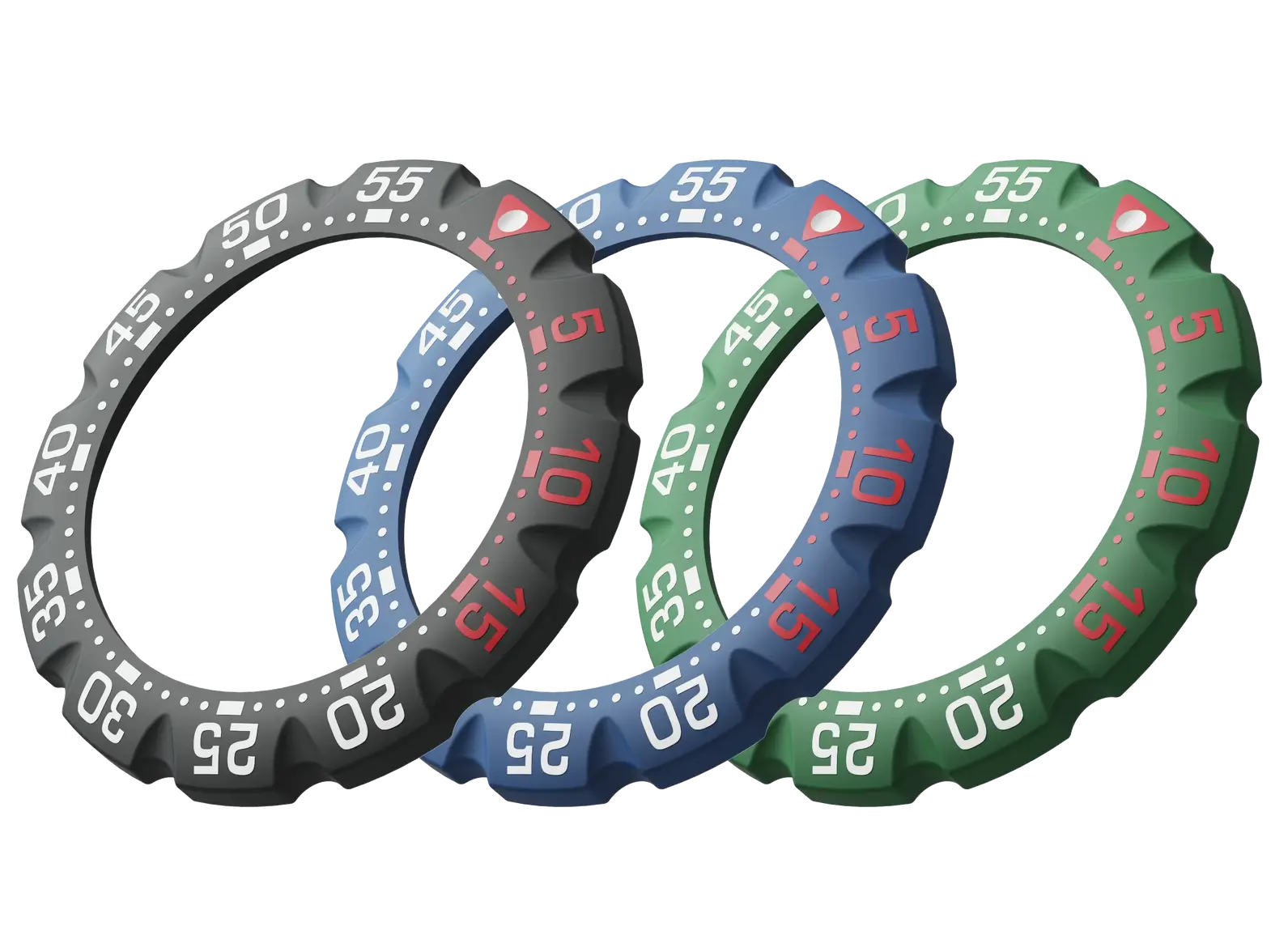

Hey Neagu awesome work! I've just finished modelling and prototype testing for these to serve as a replacement for all those people whose old bezels are worn out and it's getting harder and harder to find replacements. I'm about to put in a bulk order if there is enough interest. For those keen check them out on instagram https://www.instagram.com/tagheuerf1bezels/ or reach out on email [email protected] Can do custom colours too. They will come with a spring which sits inside the watch
