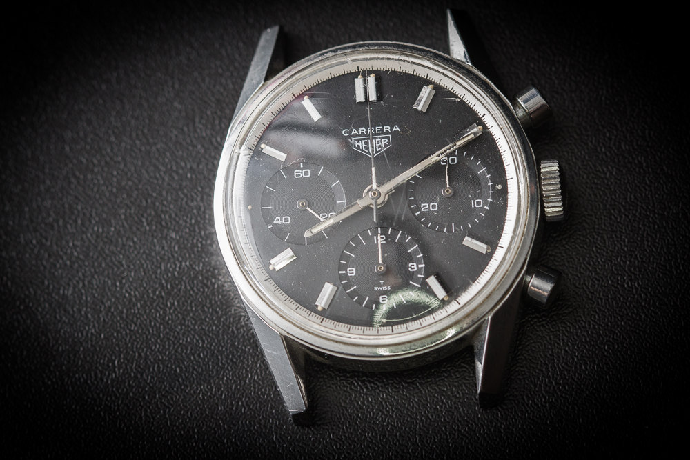

Hi Guys!
I'm Just wondering if anyone could help me out, I’ve had this beauty for about 20 years, but she is pretty battered and bruised... I would love to get her restored to her former glory - but I’m thinking that would cost me more than I could afford!! (any ideas how much)
There is a number on the side 77407 - but is that a batch number rather than a model No?
Done a Quick Google and I think She could be a 2447 N or maybe a Valjoux 72 but im not 100% sure - any help would be awesome!

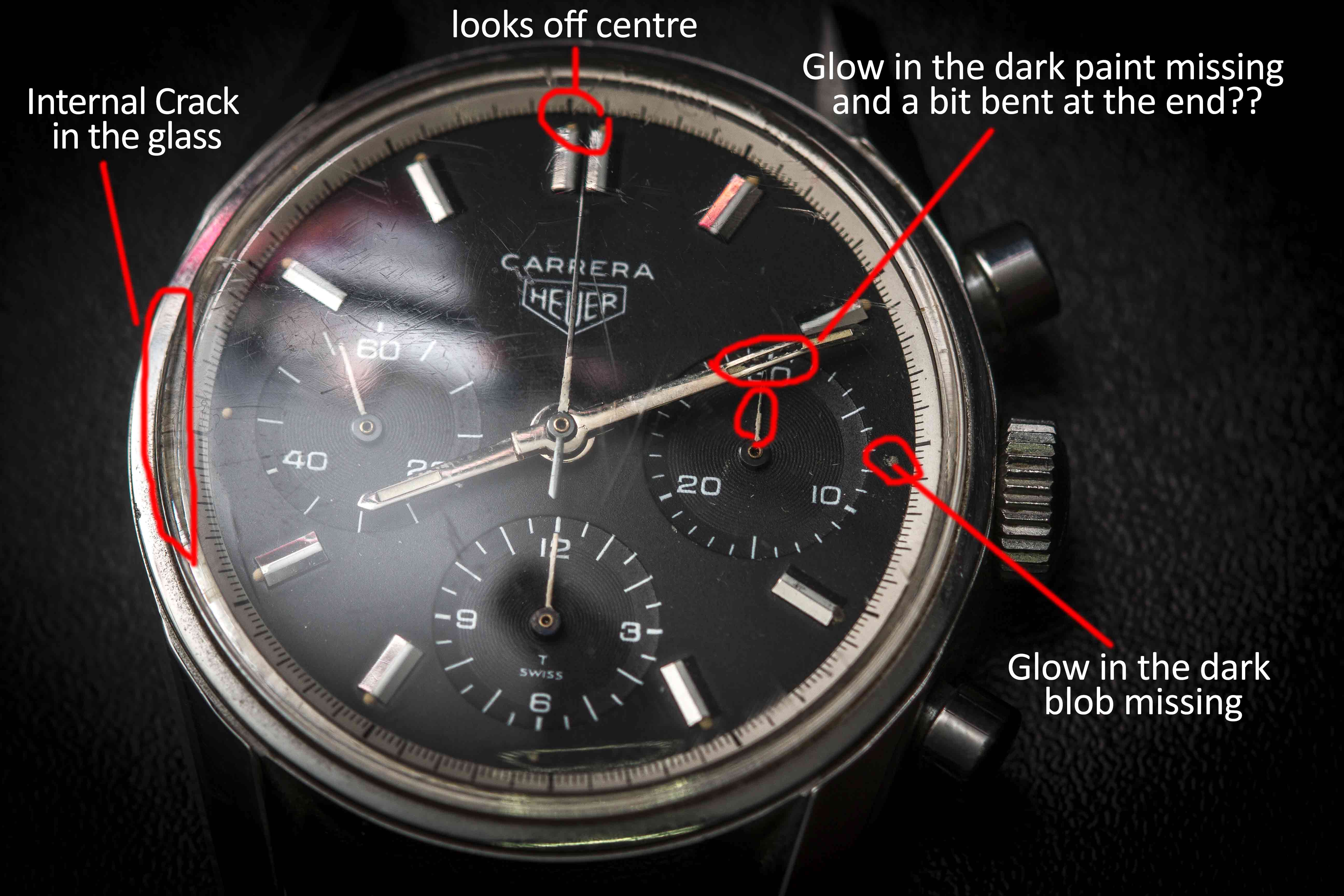

It looks a really nice watch in pretty great shape. Is the crystal cracked or just scratched? If scratched only then I would be recommending a crystal polish and movement service only. If cracked, then it will need to be replaced. However, I would leave the case unpolished (clean only) and keep dial, hands, pushers and crown original if possible - the watch will retain more value like that. I am going to hazard a very rough guess of somewhere between £300 and £500 for the work. Finding a good watchmaker is more important than the price, though. You say you might not be able to afford it, but given the value of the watch I think it would be totally worth it, and you'd have something really special afterwards. What am I saying? You have something really special now!

Thanks so much for a quick response imagwi!
I think the Glass is just really badly scratched, though there looks to be an internal crack on its side - highlighted in the below Pic.
Its pretty grubby inside - quite dusty, but I'm assuming that's all the glow paint that's crumbled away.
In your opinion would you just let that be - or look to try restore that?
The outer dial looks off centre - maybe this watch has been opened up before - of could this of somehow slipped in time?
I'll deffo look into getting it cleaned up with a movement service and a crystal Polish, I really want to get this on my wrist!

Hmm, difficult to tell from the picture about the crystal. If there's any damage that is more than cosmetic, it ought to be replaced. I guess a watchmaker needs to advise on that.
The dust is likely to be the lume (glow in the dark material). You definitely need this all cleaned out as it can affect the movement. I'm not sure I'd bother replacing it, certainly on the dial. The hands, though, well possibly, it's a tough call. If the remaining lume is safe and secure and unlikely to fall out then fine, otherwise I think it has to all come out, in which case it's probably worth reluming them.
Hopefully the chapter ring (outer dial) can be easily fixed.
Remember that cost for this will also be affected by what state the movement is in and what parts are needed for the service. You really need to find a good watchmaker. Perhaps tell us where you are and maybe another forum member can make a recommendation?

Hi Alex, this is a Carrera (as the dial states), model reference 2447 N.
Try looking up Abel Court, who is an expert at restoring vintage Heuers. His prices may be on the high side, but I guarantee you it'd be worth it. You have a very attractive and fairly highly sought-after watch there, though I couldn't tell you the value.
So, here's what to do:
-If you're thinking about selling it, do nothing - put it up on eBay. Unserviced watches do better there, because a buyer then has his or her choice of whether to service, where to service etc.
-If you're thinking about keeping it, service it - and don't worry about monetary value - think about the personal value it's had to you for the 20 years you've owned it; and enjoy wearing a gorgeous, classic chrono!

Actually, what looks to have snapped off is the top of the chronograph central hand- that will need replacement.
These are all relatively minor issues on a watch this age- overall, you've got a real beauty here!

I'd be tempted to just get the lume on the hands stabilised to prevent further losses, but it could also be replaced and colour matched.
A tube of Polywatch on that crystal would work wonders. Even some toothpaste and elbow grease will improve it in the short term.
