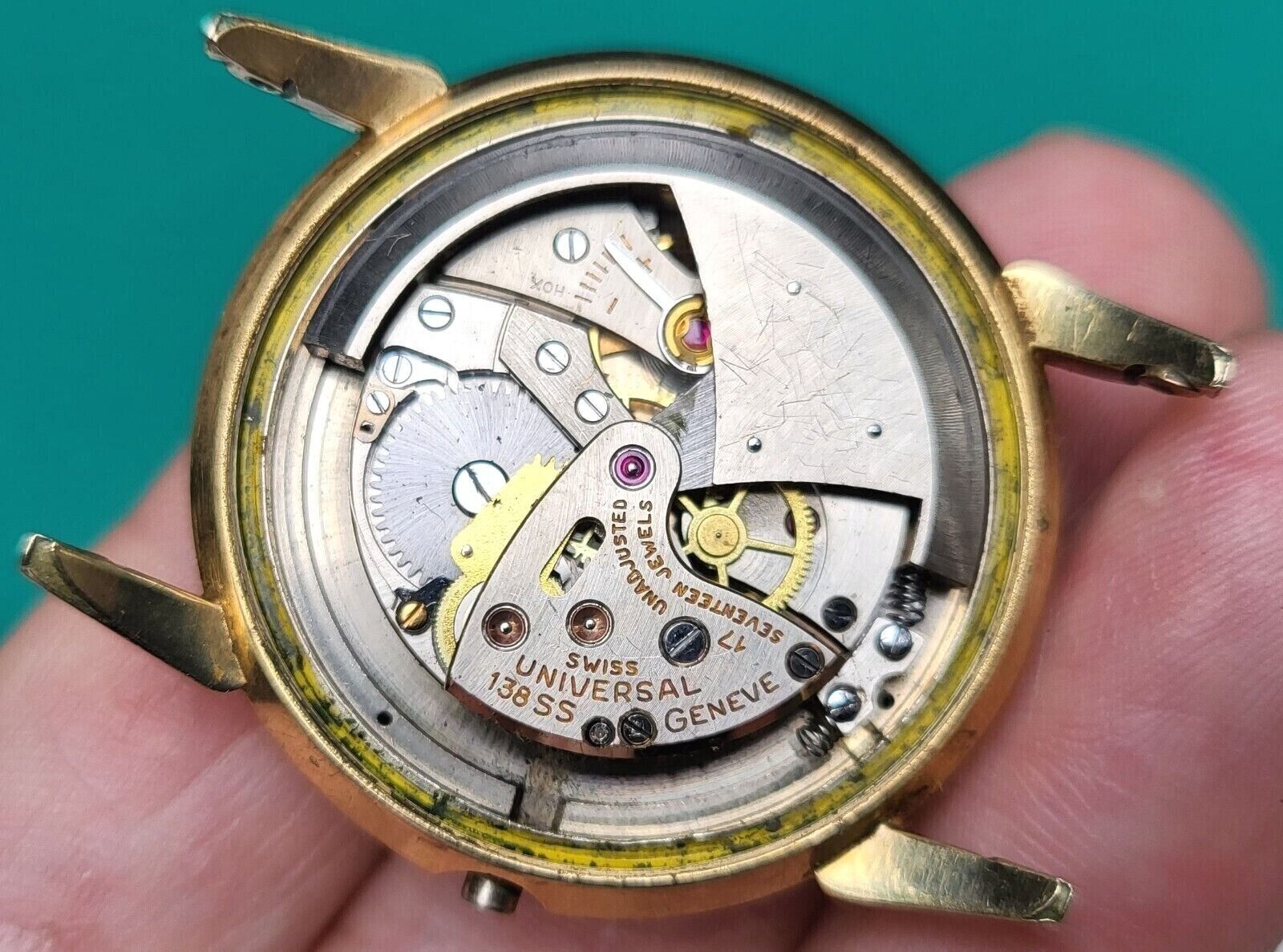

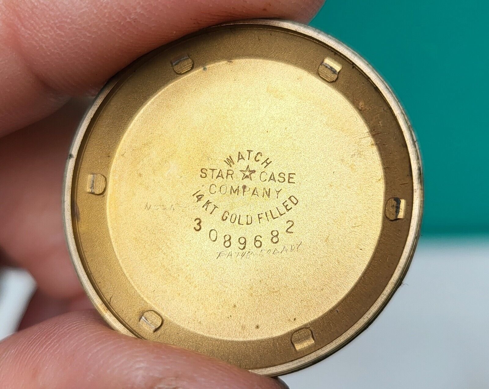

I think the OP might refer to the commonly seen gold filled UGs without reference numbers. Often these come in Star Watch Case Company cases.
Here's a 138SS bumper for example:
https://www.ebay.com/itm/155806150572
I'm not aware of any documentation regarding the serial numbers/case numbers of these watches.

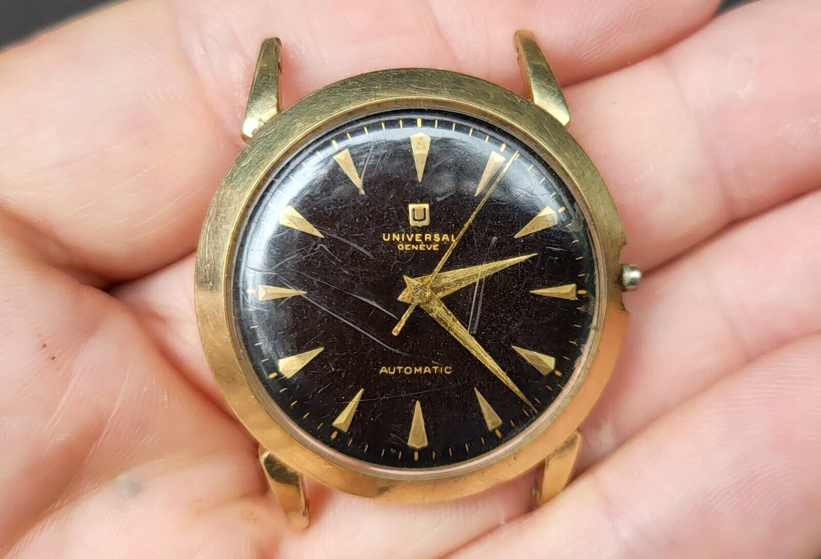

But suppose we assume it was, in the vast majority of all examples I’ve ever seen with a US import code on the mvmt, it’s a completely standard UG case. In fact I can’t think of a single example offhand that was not, except obvious Frankens.
There were some U.S. market only Universal Geneve watches, made with gold-filled or 14K cases. They have the import mark “HOX”.
These are usually not “named” models like the Compax series or Polerouters. Generally, they are lower end or ladies’ models for which the customs savings on the jewels and cases would have been significant in a competitive market against other Swiss and American manufacturers.
Here are a couple of examples from a quick internet search for 14K UG’s:
https://empress.cc/products/50s-universal-geneve-gents-classic-vintage-watch
https://www.ebay.com/itm/334650610323
Unfortunately, there is no way to track serial numbers on these watches. Any numbers on the cases had meaning only to the case makers, all of whom are now defunct.

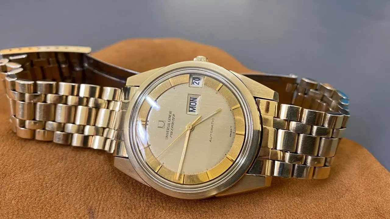

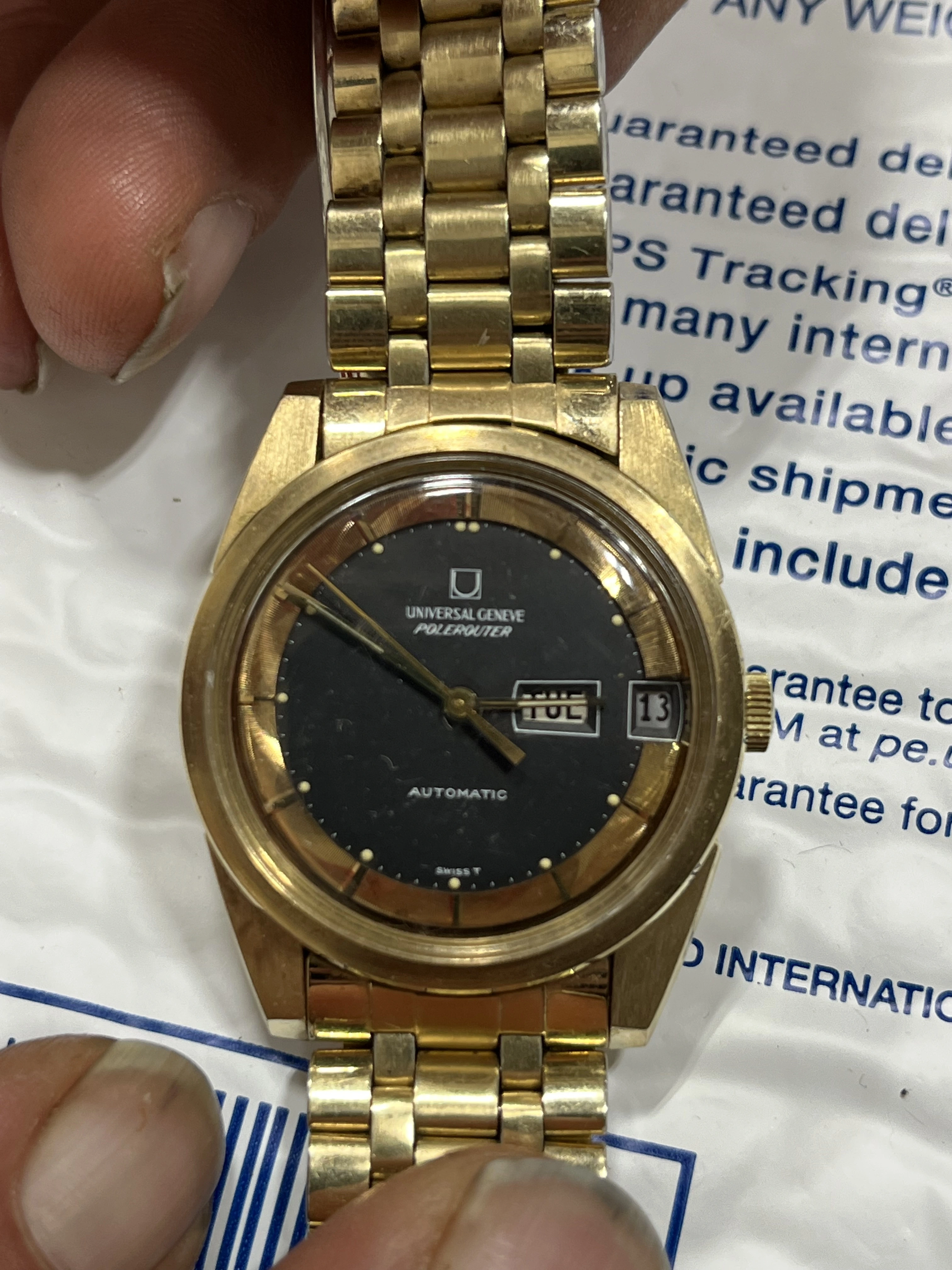

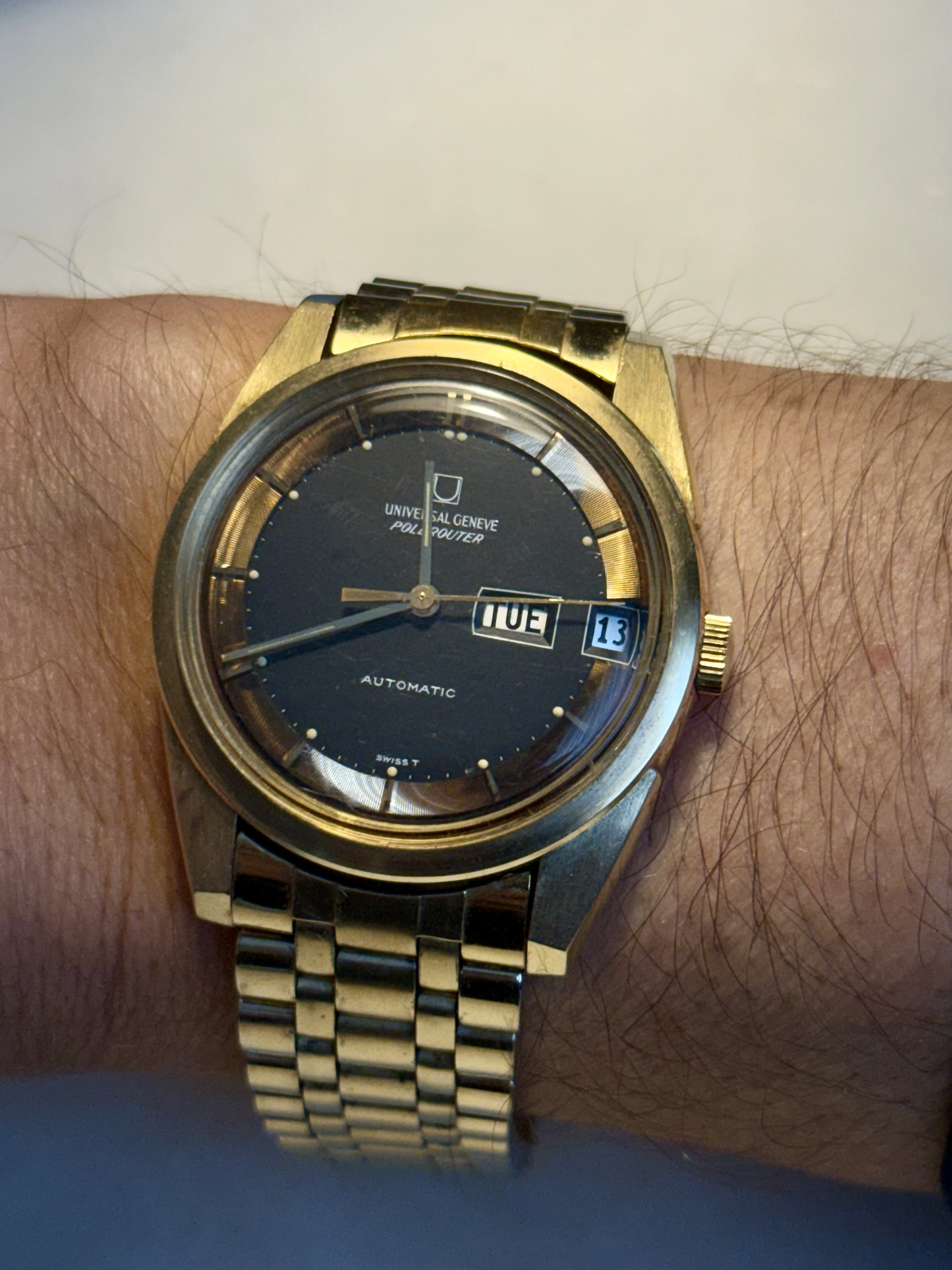

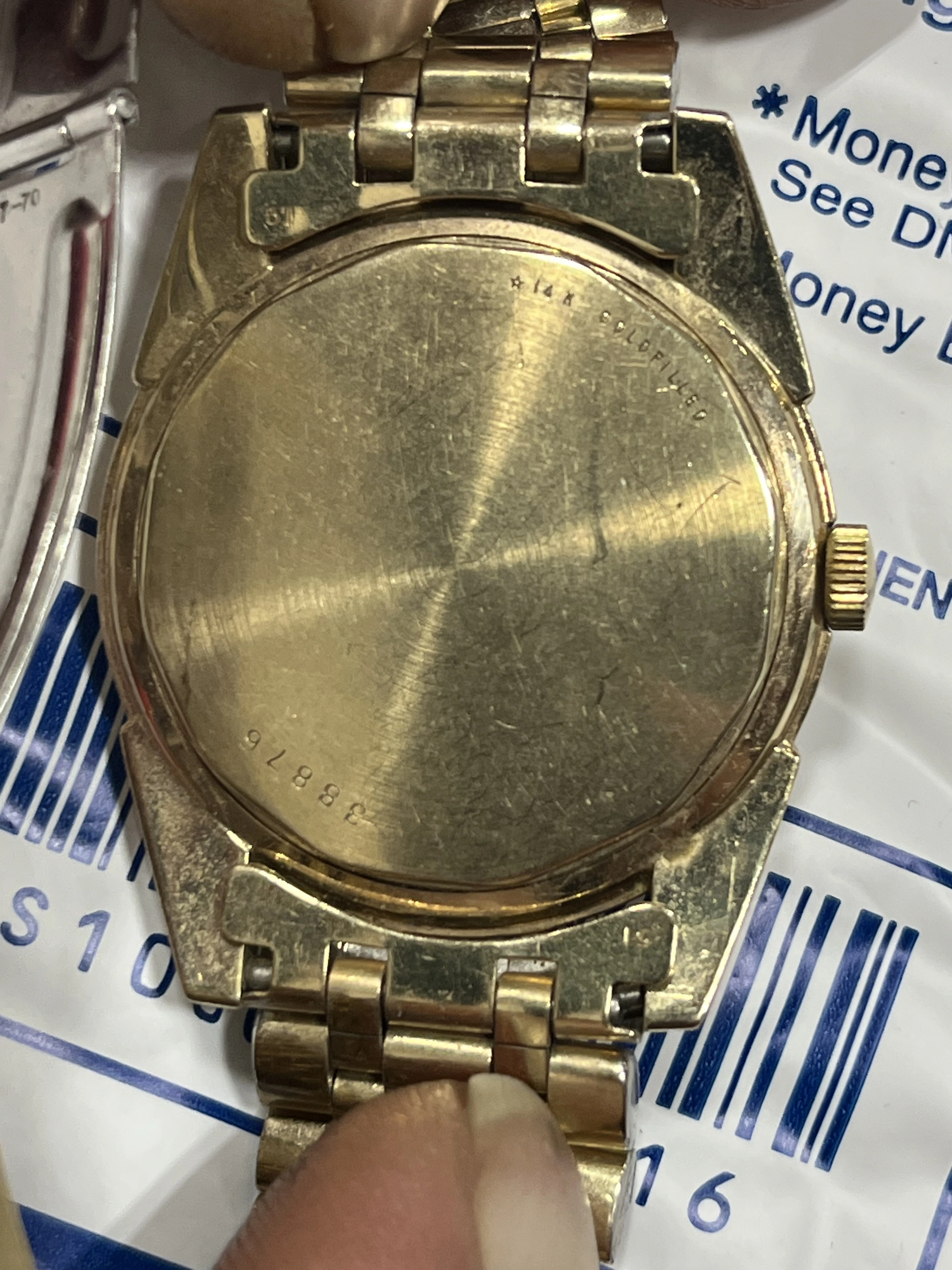

Hi all!
I've recently bought this Polerouter in the US. In the back of the case you can see written "14k Goldfilled" and the numbers "38876". I don't have it in hands yet, I'll follow up here with the case opened photo.
Besides the mystery of the missing reference number, the thing that called my attention was the "day date". I found only a few during my research, the most common as I understood is the "date" model.
What do you think about the watch? Case, dial, bracelet, crown, etc
Have you seen more Day Dates?
Thank you!
