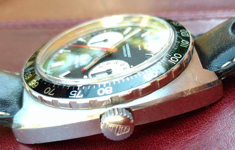

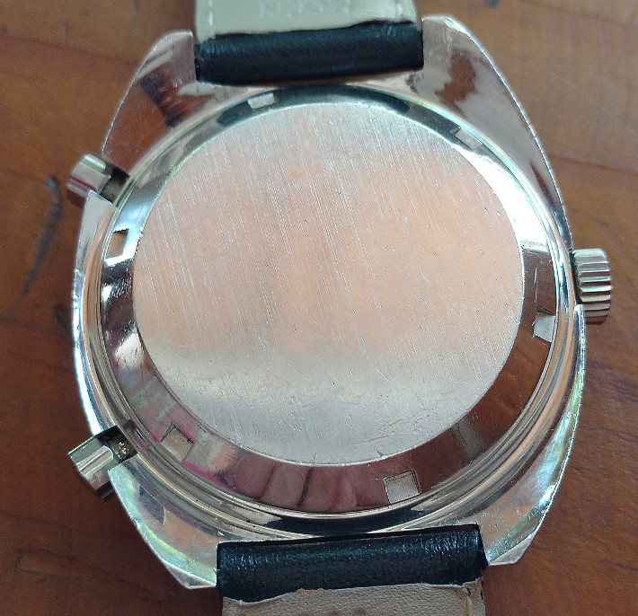

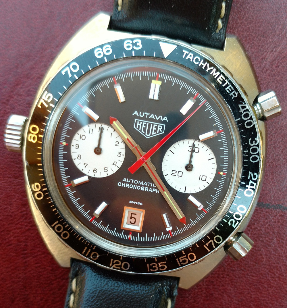

Hi guys- I'm looking at this Viceroy and wanted to get opinions. The case appears to be the shallow Piquerez case with the open front pushers and partially obscured rear, but it looks to have the deep case back from the Schmitz case. Thought's and opinions are appreciated!
833
1,563
Hi TBone! Looks like a Schmitz to me. I don't think there is much difference (if anything) in the depth of the cases themselves. The pusher cut outs and case backs are the tells, which you've already mentioned. 😀
Good luck if you go for it!
