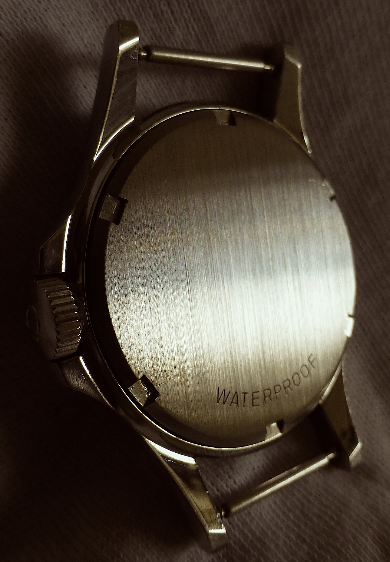

The back is brushed if you did not find out yet.

Thanks Florian, I shall make it my weekend project to get it back to better condition.

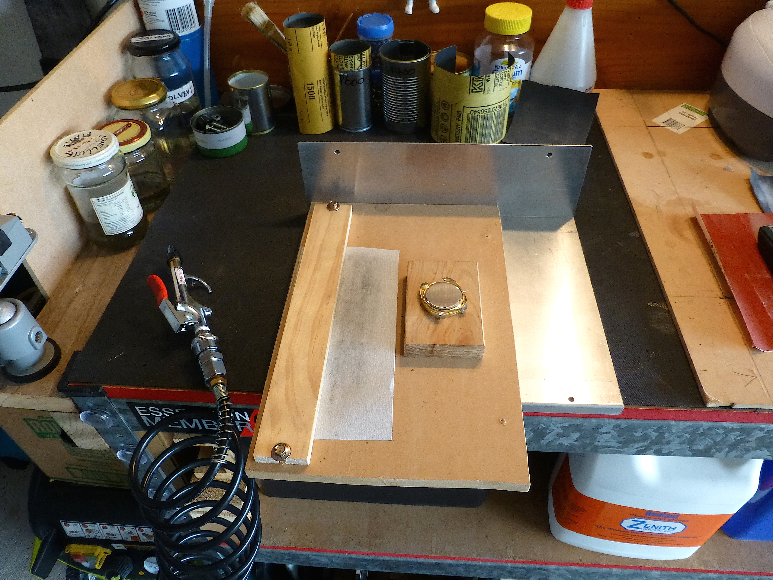

Well that was quick, all finished.
I wanted the case brushing to be nice and straight, not like some I've seen 馃槻

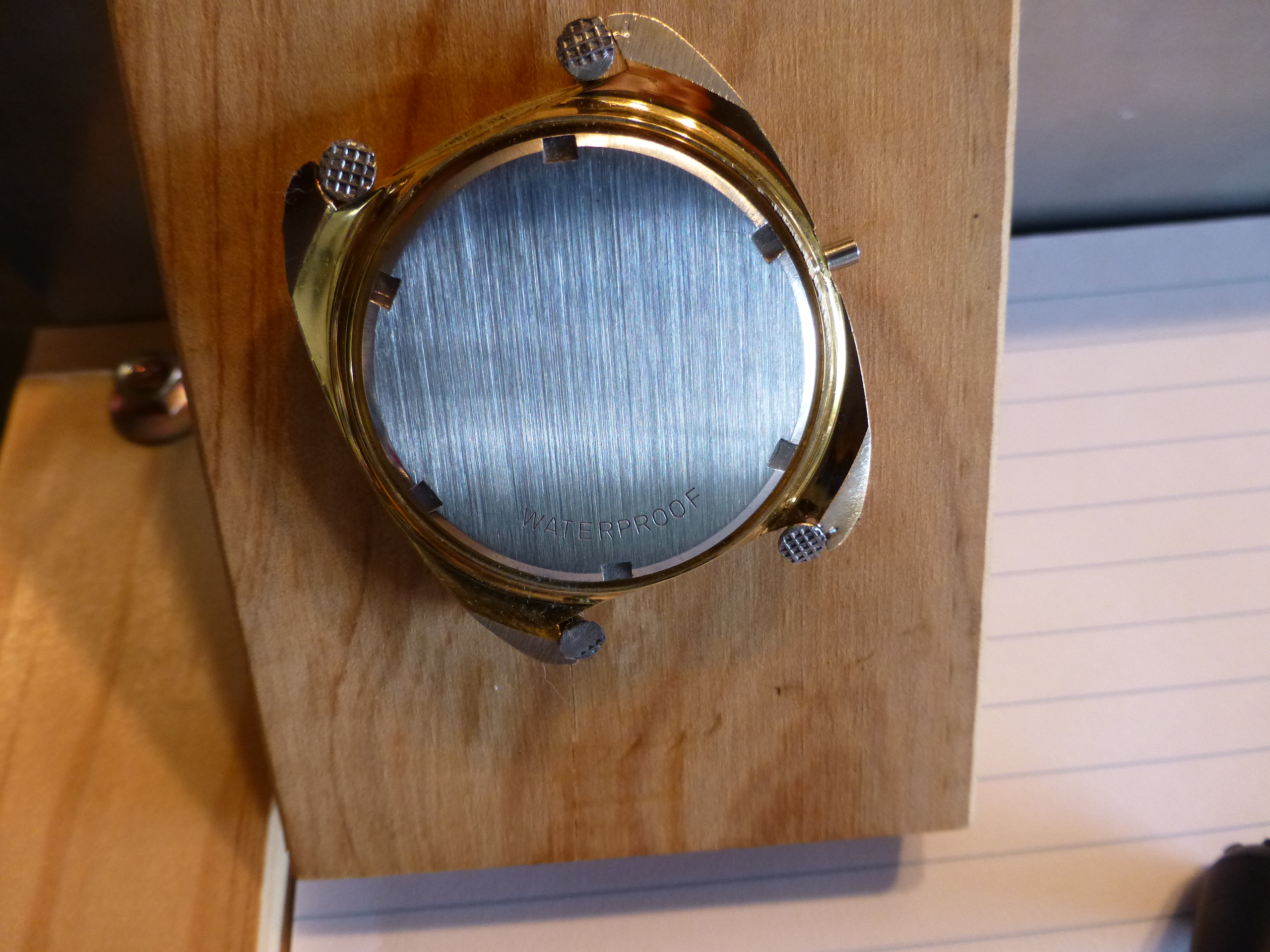

I found and old case the same size as the case-back and McGyver'd it onto a square wooden block, with the case-back aligned parallel to the edge of the block.
A jig of MDF board with the 240 grit paper clamped by the guide bar completed the set-up.
A couple of minutes of careful stroking and the case has a nice original brushed look.
I couldn't get all of the original scratches out but didn't want to go any further in case I started to lose the WATERPROOF marking.
Here's the setup
And here is the wooden block/old case "jig" showing the case-back with it's new brushed finish.
