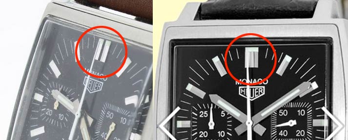

But the only real world difference would be the numbering (????/5000) on the case back?
The whole case and movements seems the same, except maybe for the 12 o'clock index, wich sometimes is a "one-piece" square and other times is a "double" index...
Any more thoughts on this?
7,124
15,117
Yes, just the caseback.
Both of the dial variations are correct. My best guess here is that TAG Heuer used two dial manufacturers and there were small differences. They do this today as well, with the idea being that if there is a problem with one supplier, you still have stock from the other. I was surprised about this (although it makes sense), because it means you can get small variations between the two suppliers, especially in subtle ways like dial colour or the way that a starburst finish is achieved.
I haven't seen any evidence that the one piece/ two-piece index tells us anything about the watch's year of manufacture
