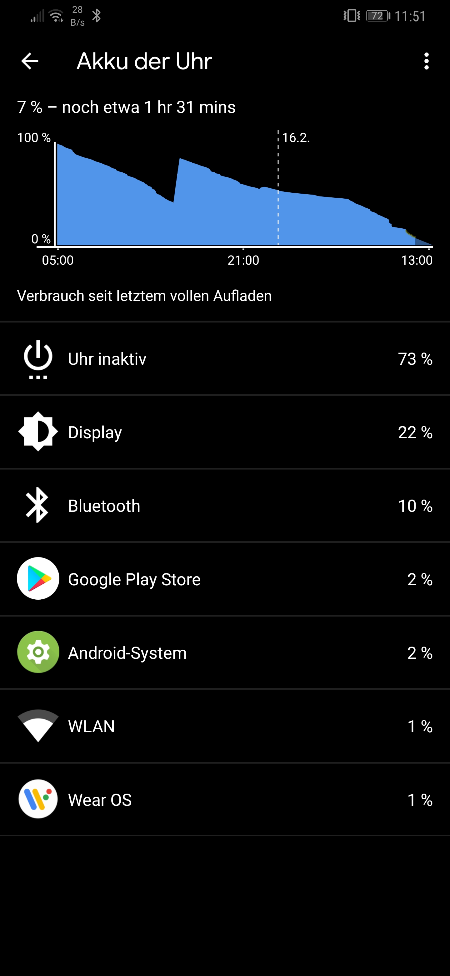

Hey guys,
today before i go to work i take my watch from the charger with 100% battery. About 5-6 hours later my battery was on 4-5 % and i dont know what the problem is. In this 5-6 hours i use/ tap 1-2 times on the watch. Iam using the Ushuaia watch face from Tag Heuer... Its almost black and dim-mode is on. Here is a picture from my battery grain... Thanks for help. Regards

WiFi off or set on Automatic? Off makes a big difference on mine. Developer settings "turn on WiFi when charging" on or Off? On means it may change WiFi back to Automatic during the charge cycle. You'll need to check this every time you take your watch off the charger

@kwilcox , but WLAN is just 1% of his battery consumption (in accordance to the picture he attached), so I don’t think this is the problem here. BTW, I have WiFi always on Automatic, and my battery consumption is fine (mine is a CM45, but I guess there’s no difference here with the CM41)
@esertime , have you done the battery calibration? (let the battery drain completely until the watch switches off itself, then charge it up to 100% and don’t remove it from the charger until it reaches 100%), and repeat this 100%-0%-100% one more time. You can find more detailed info if you search “battery calibration” in this forum.

That may be, but all I can say is that changing my WiFi settings cured the occasional "battery drained in 6 hours" symptom on my TH41.

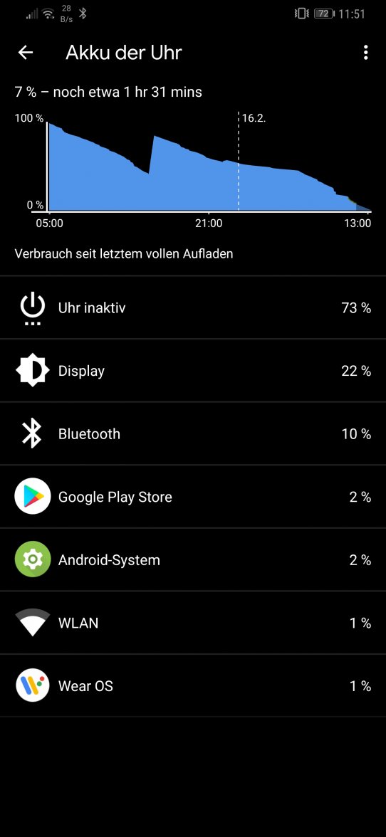

Hey guys,

Is the issue resolved? I have exactly the same issue. Switched of GPS, Wifi and screen off. Still battery is done after 3 to 4 hours. ....any suggestions ....anyone?

Do you have this issue wearing the factory installed faces, or with WatchMaker faces? Some WatchMaker face could drain the battery very quickly if it’s very complicated or with too high res images

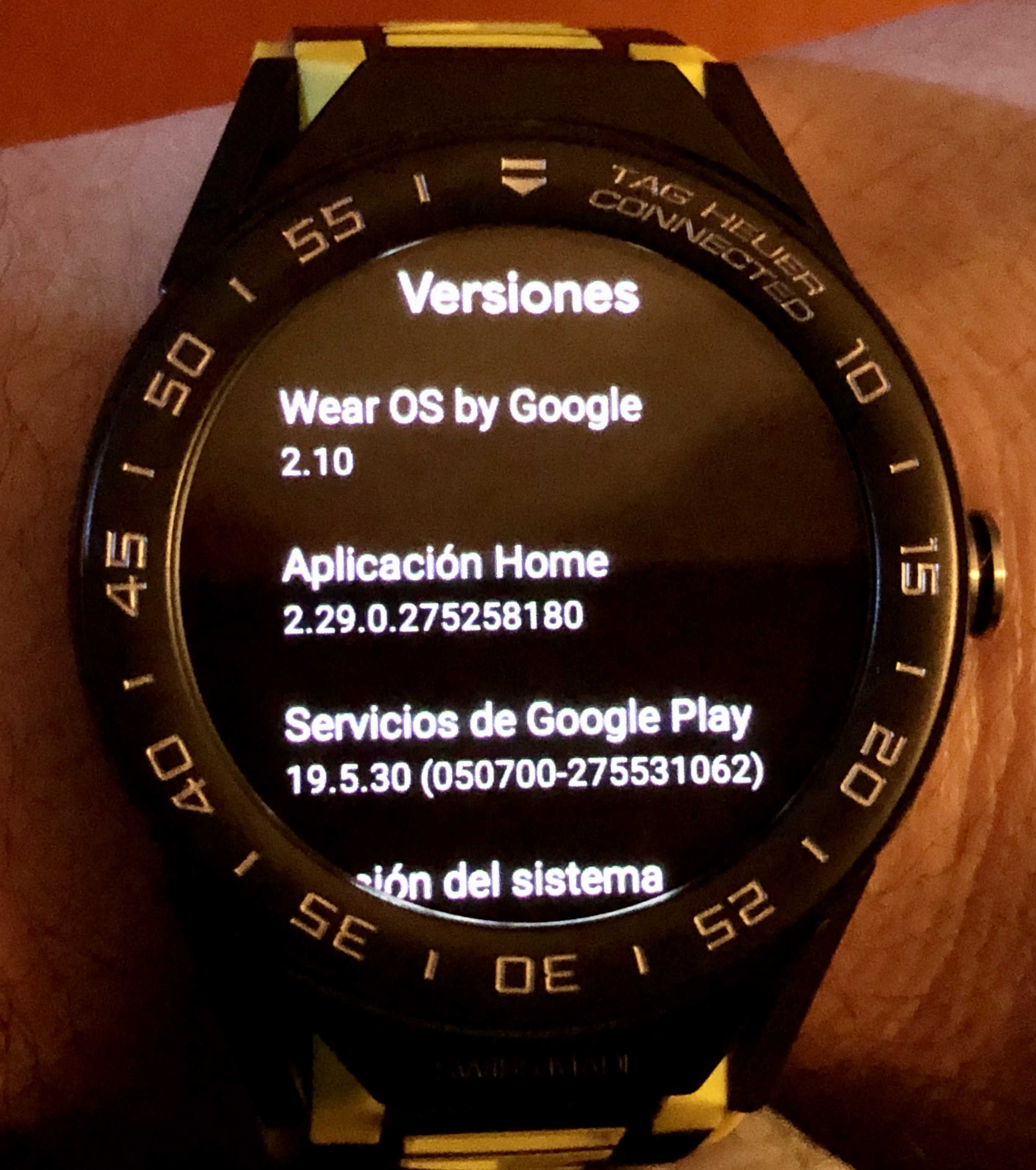

Are you running the last system and Wear OS versions? Your watch should have these versions:
Have you done the battery calibration? (let the battery drain completely until the watch switches off itself, then charge it up to 100% and don’t remove it from the charger until it reaches 100%), and repeat this 100%-0%-100% one more time.

This occurs when wearing TH standard faces . Did calibration couple of times. Switch of NFC, GPS,wifi.....still max is 4 hours. Annoying.

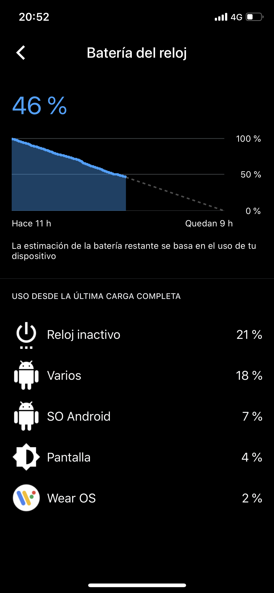

Then it seems your battery is dead 🤔, because this is not normal, unless you are continuosly playing with the screen and the watch functions. I’m rarely touching the screen during the day (I’m just using the notifications), and after recent software updates the battery life has improved a lot in my watch, and it usually lasts around 20 hours (attached picture) wearing WatchMaker faces (WiFi on, GPS on, and screen always on), so it should be even better with the TH factory installed faces and your settings
If your watch is still under warranty, I would take it to your AD

Thank you for the advise. This is what I did. I contacted TH customer service and they recommended to return the watch. It is only 2 weeks old. So I thin you are right. A typical dead on arrival.
