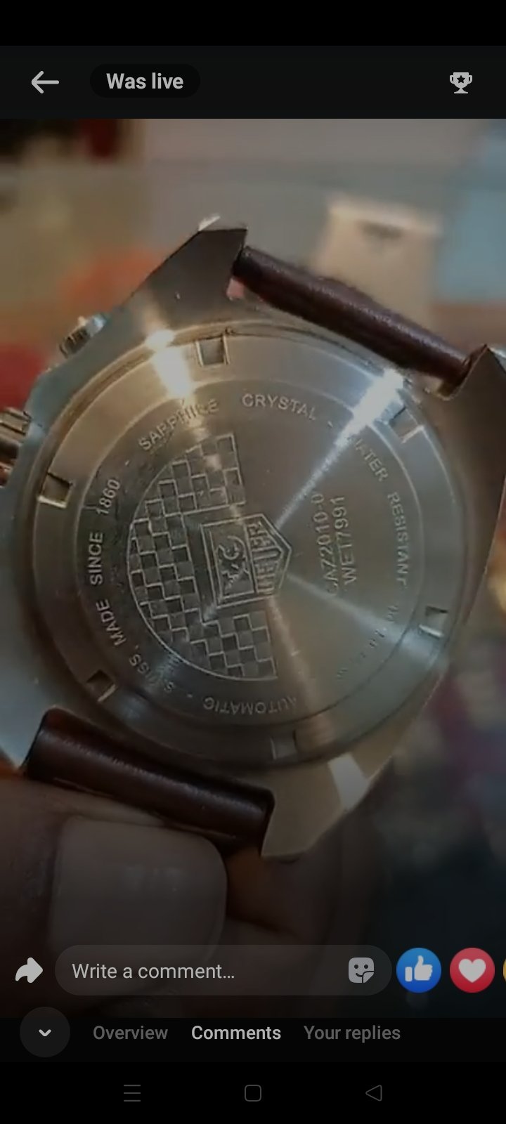

Hi. I have a question. I have carried out the operation that indicates Rsf on 3 watches that appeared in an auction. Supposedly, the watches are from the "gray market", but it catches my attention that in one of them the same name that I highlighted appeared ([email protected]), and in the other 2, the email address "[email protected]" appears linked. Do you have any explanation? Could it be that the TAG server was hacked?.

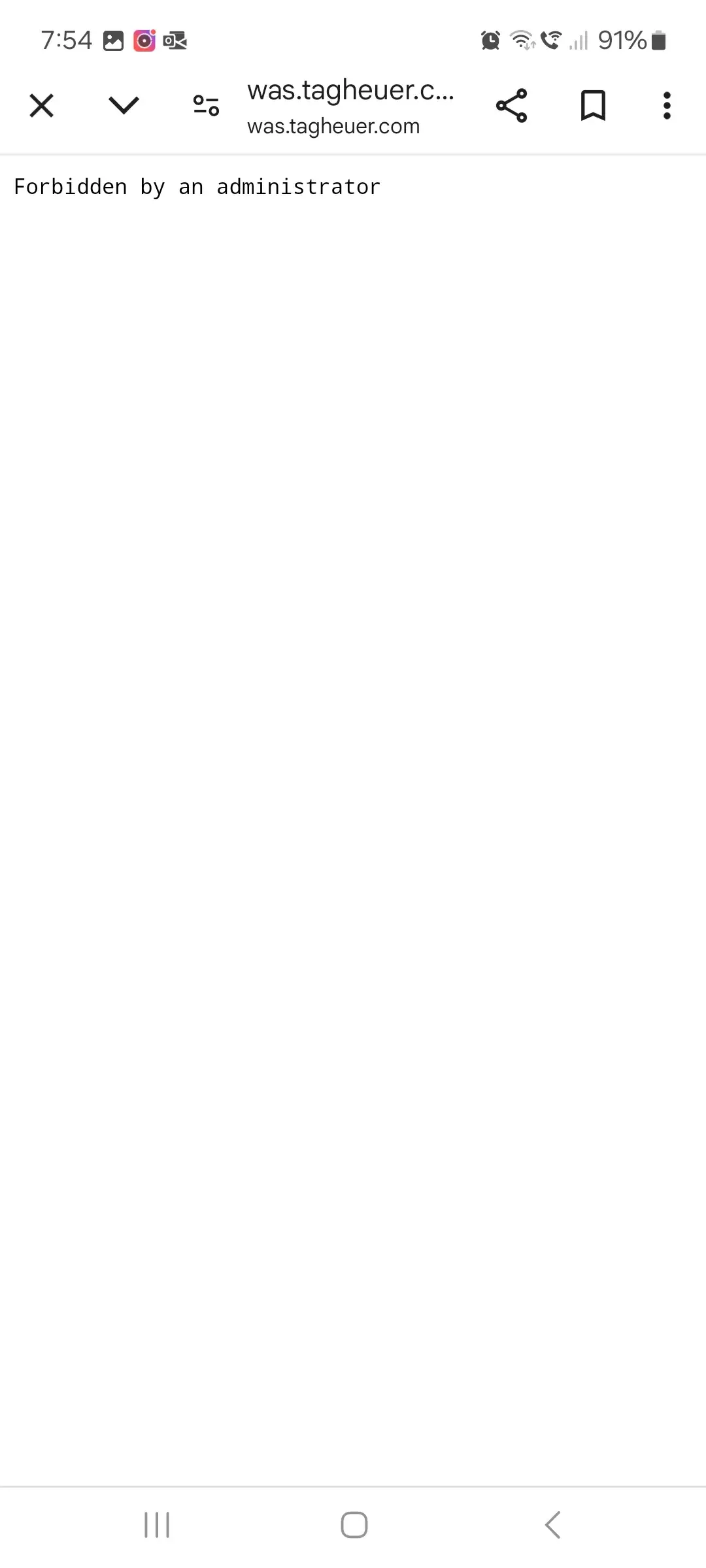

I am based in Australia and am unable to access the link above you have posted to check serial numbers. Is there any other options available.
Need to check a specific watch with details below
CAR2A10-3
WWA7199
