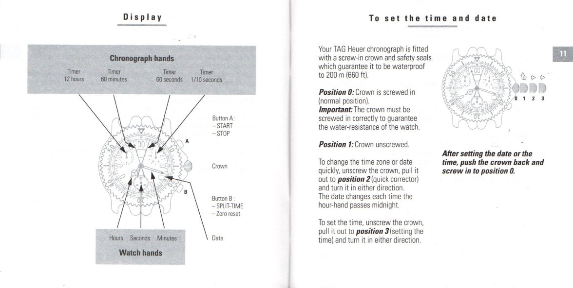

The top button starts and stops the chronograph, the bottom button resets it.
The buttons are also used to reset the hands when the crown is pulled out (there are 2 crown positions)

Right, okay. So if when you press the top button the top left dial moves to a random position that means you are stopping the chronograph, but you can't see the chronograph is working because the main second hand isn't moving. I presume when you press the bottom pusher it always goes back to the same place? If so that means it's trying to reset to 12 but it's out of whack. You can reset the subdial hands by pulling out the crown (in two positions) and then pressing the buttons.

Also there are two large 'second' hands, the one with the triangle on it is the minute counter for the chronograph. I will have a manual for this but haven't got time to copy it at the moment.

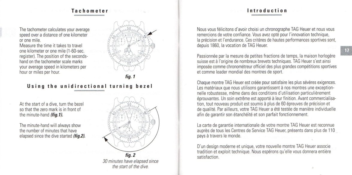

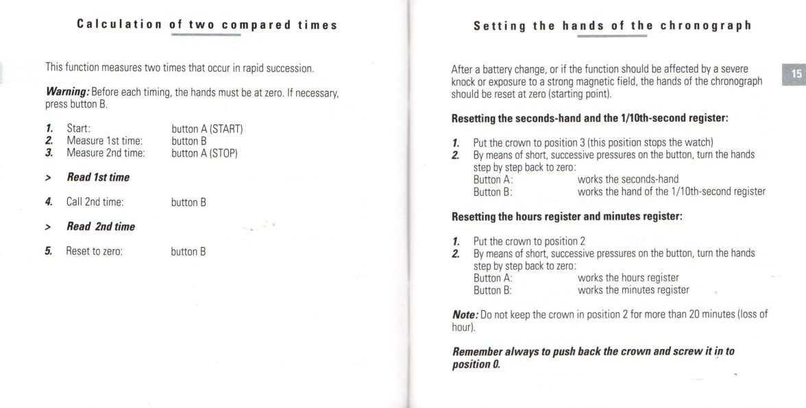

I should be able to scan the manual on Monday, will also post it on my blog.
23,592
34,139
This manual is also for the 2000 and S/EL models which have the 1/10 quartz chronograph

Where is Stuart? I post the bloody manual for him and he hasn't come back!

Thank you very much. I will print it out when I get a chance.
I'll let you know if I can figure out the problem.
Funny thing is that yesterday I looked and the time was way off. Somehow, I had pulled out the crown. Duh.

Little update. The watch actually stopped completely on the 8th. I'm going to take it in to a watch place. Hopefully it's just a battery issue.
Thanks Aquagraph! I appreciate the manual. One of my Tags is a CL1212. I lost the manual in a move 20 years ago. The chronograph hands are all in sync again.
