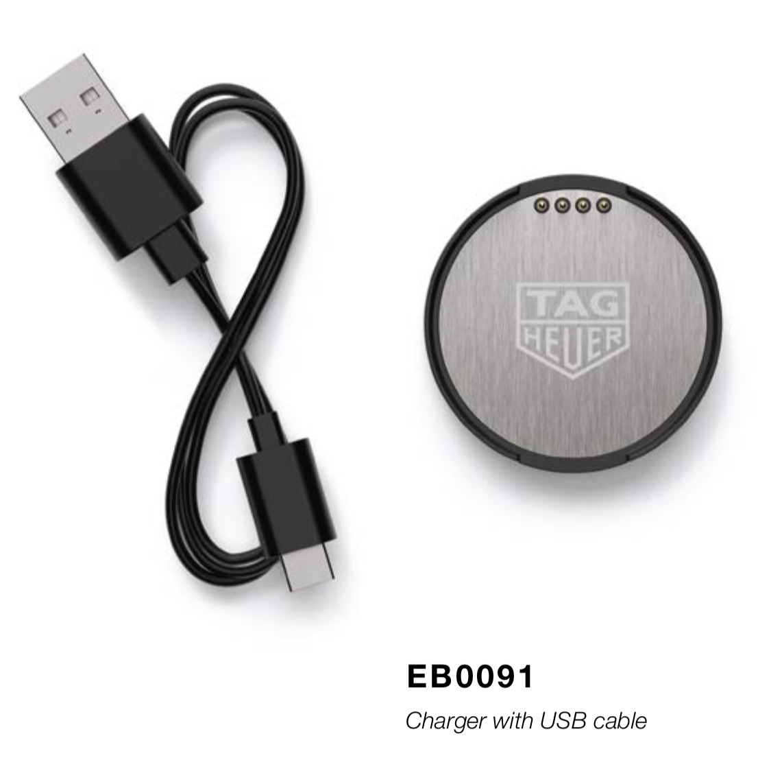

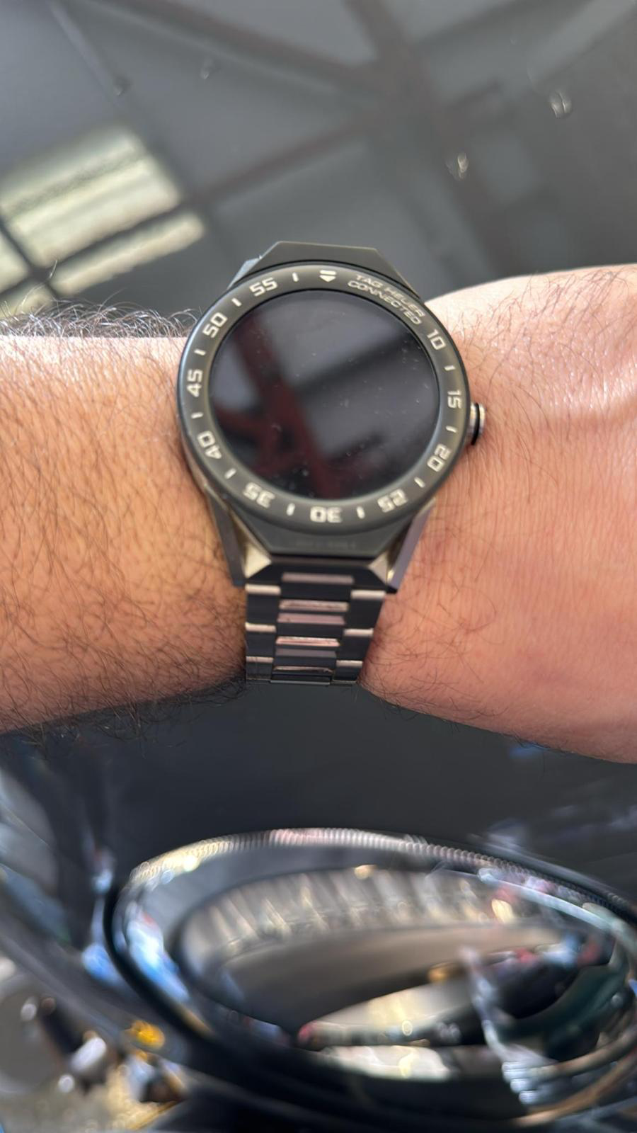

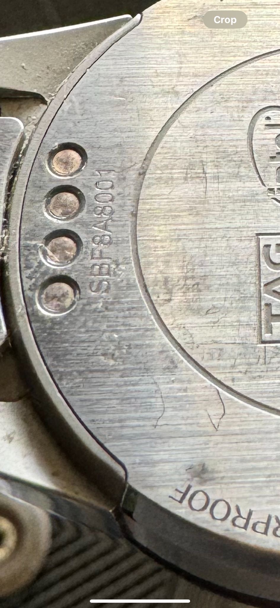

Hi All,
My mate has an Old Connect and need to buy a replacement charging puck. I think it’s the Gen2 he said Gen1….
Can you guys confirm and always any good replacement Pucks forsale…. EBay do aftermarket.
6,384
18,021
Hi All,
Yes, you are right, it’s a Gen2 (45mm version), now called E2 Modular 45. It’s important to also specify the size because the charging puck is not the same for E2 Modular 45 as for E2 Modular 41. This is the part number for the 45 version:
