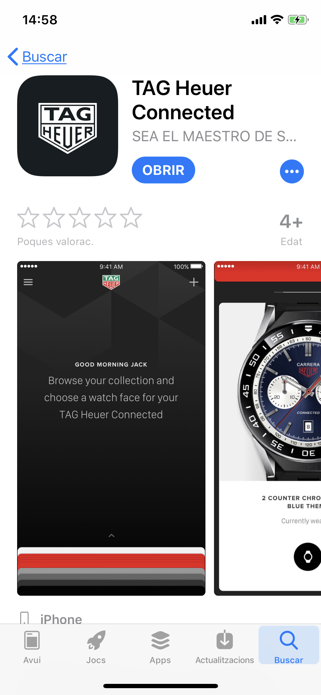

The TAG Heuer Connected app for iOS has finally arrived! 😀

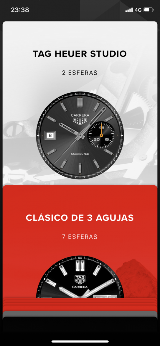

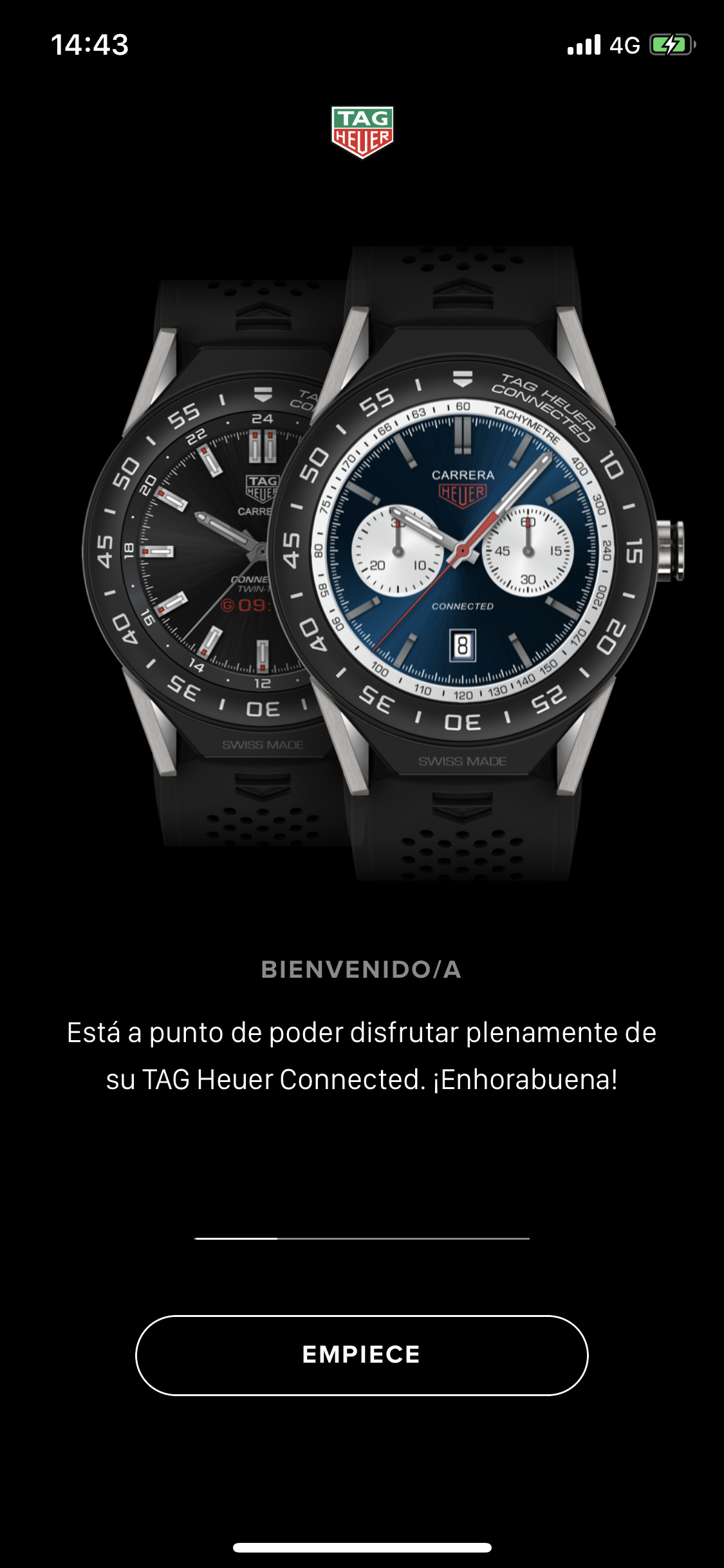

When I launch the app, this is the first screen

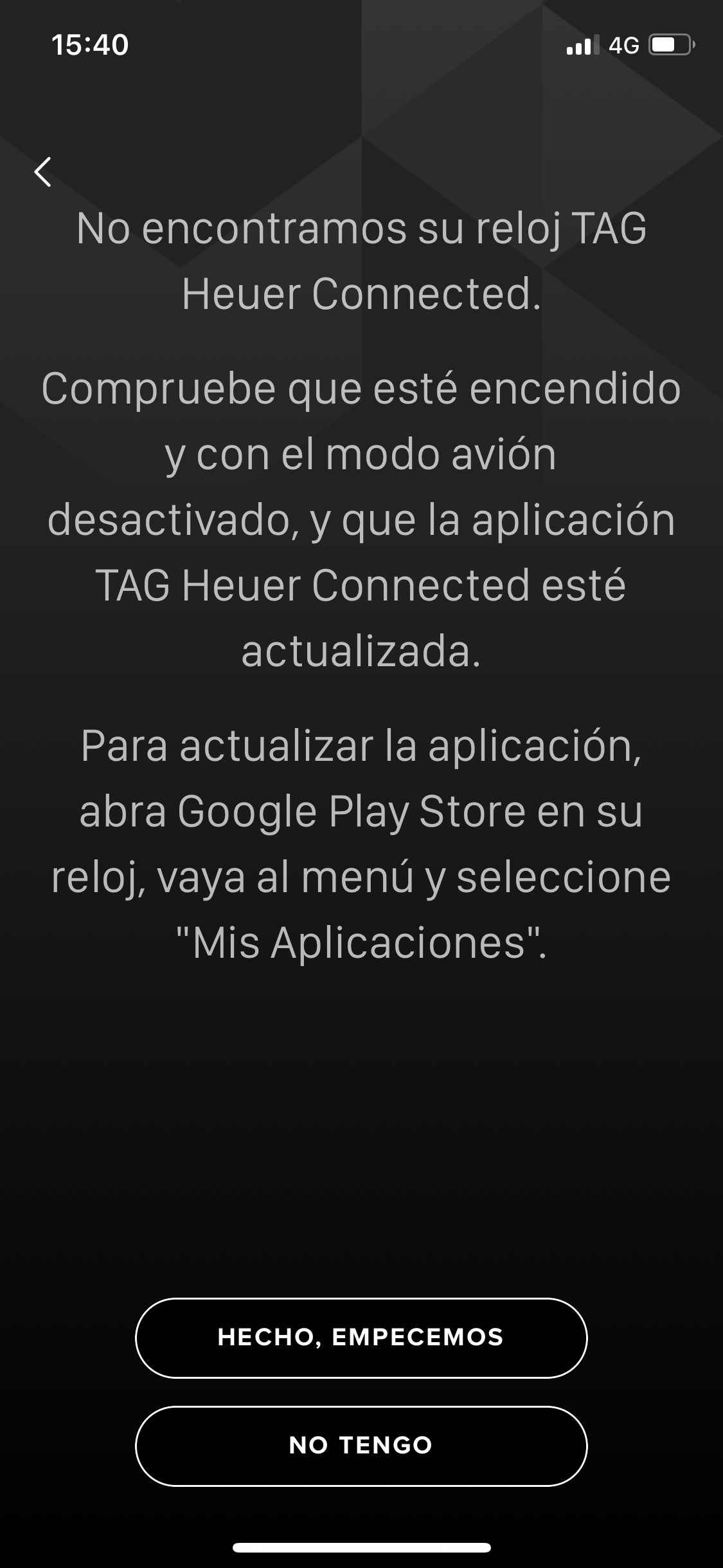

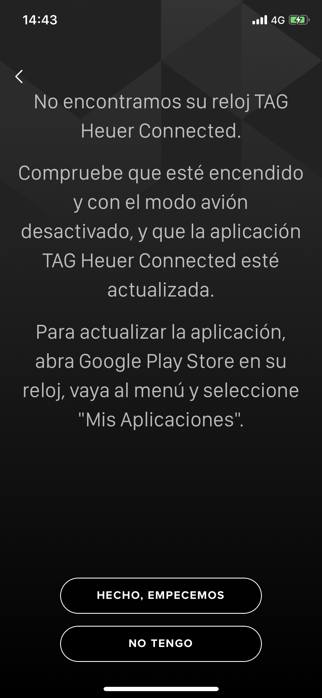

I press “Empiece” (Start), and then it starts to search the watch... after some seconds, this is next screen:

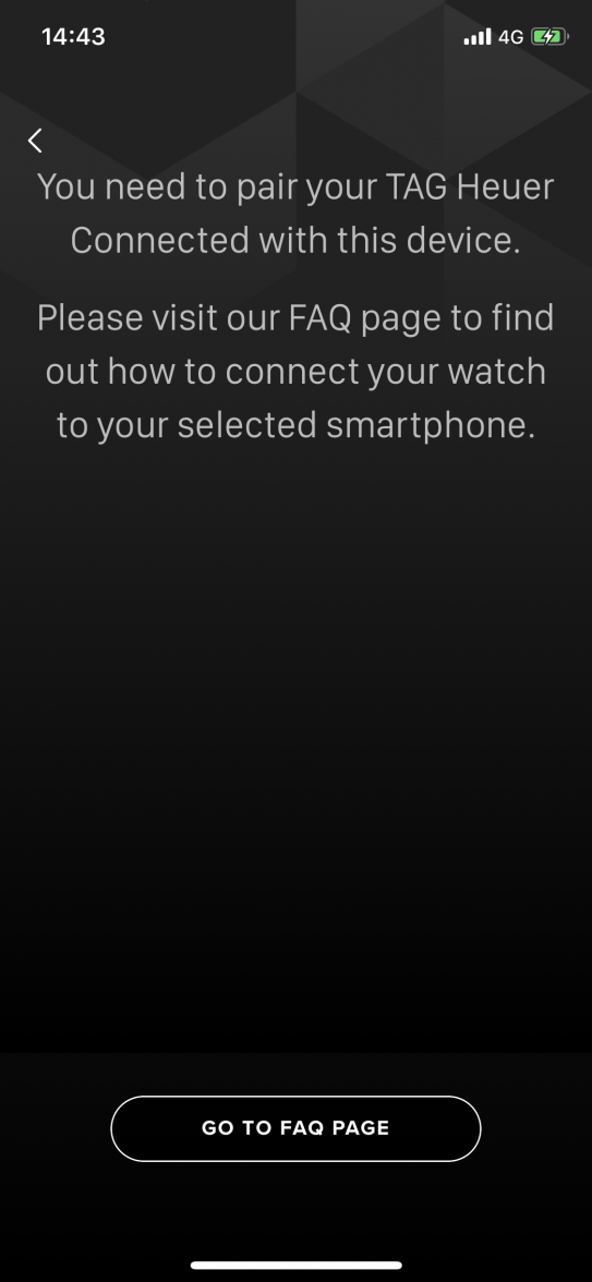

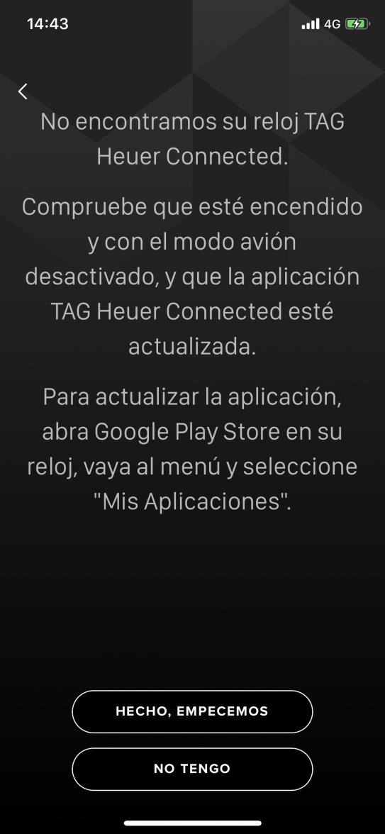

That means “we don’t find your watch. Check that it’s switched on and with last app version”. Then I press “Hecho, empecemos” (Done, let’s start), and after some seconds searching, this is last screen:

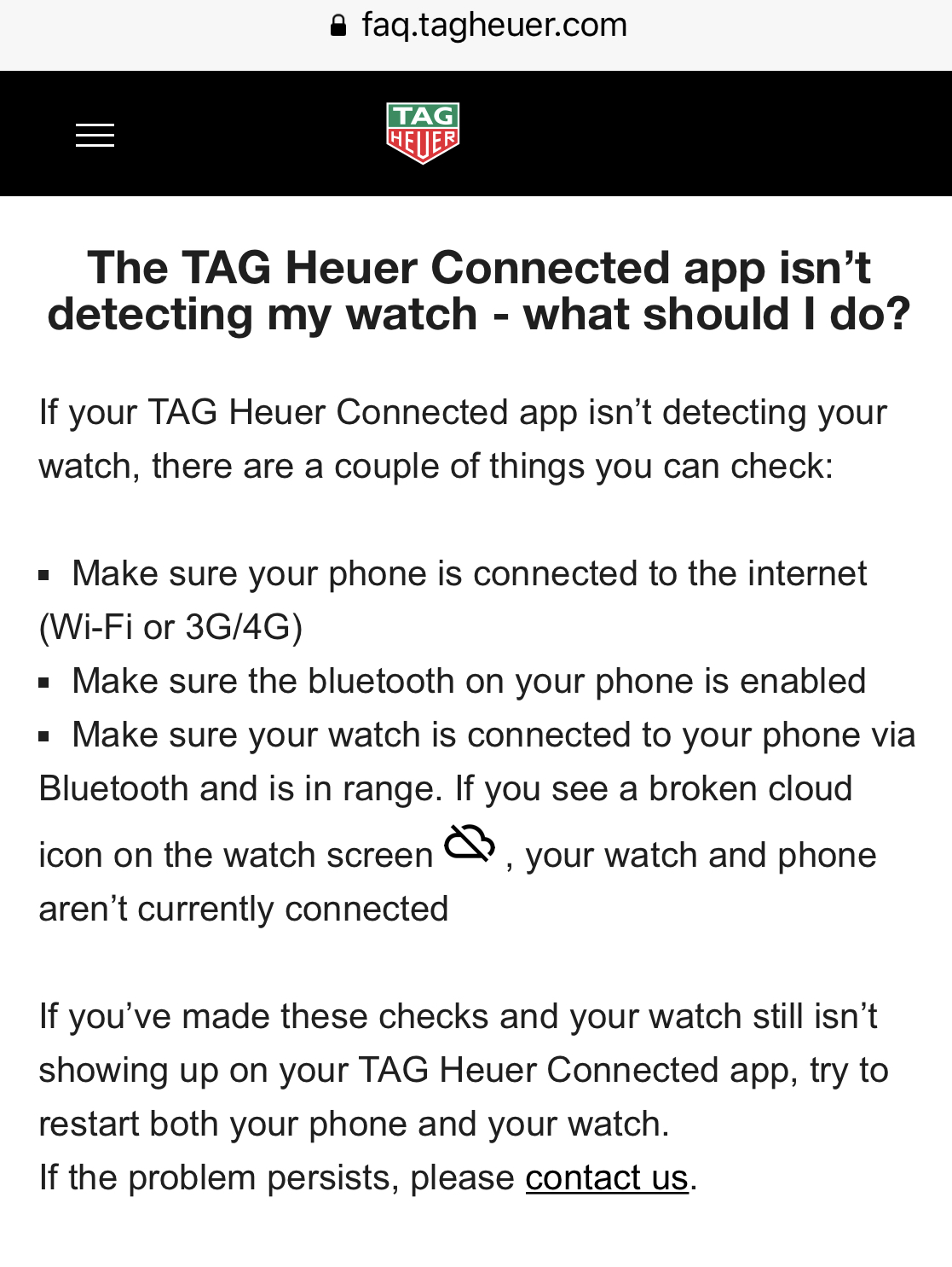

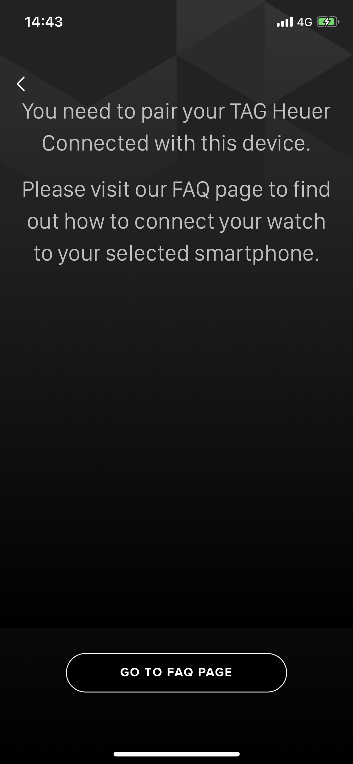

So, it sends you to the FAQ page about how to pair the watch with the Wear OS app 😕, which is obviously done since first day I owned the watch!
I have repeated the process with the Wear OS app launched and closed (always with both bluetooth connected), but with same result...
Is this app working to anyone? If so, what’s the way to do it?

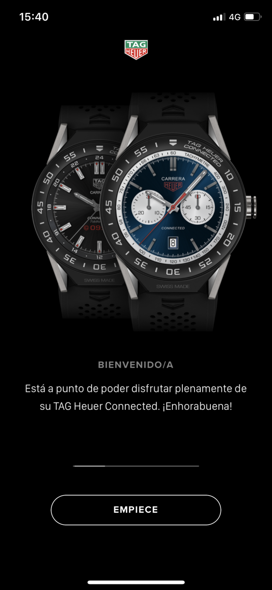

Thanks! 👍 I tried to launch again the app, but wearing one of the original faces, and then the TH app found the watch and it was possible to create my account. Now it’s working! 😀

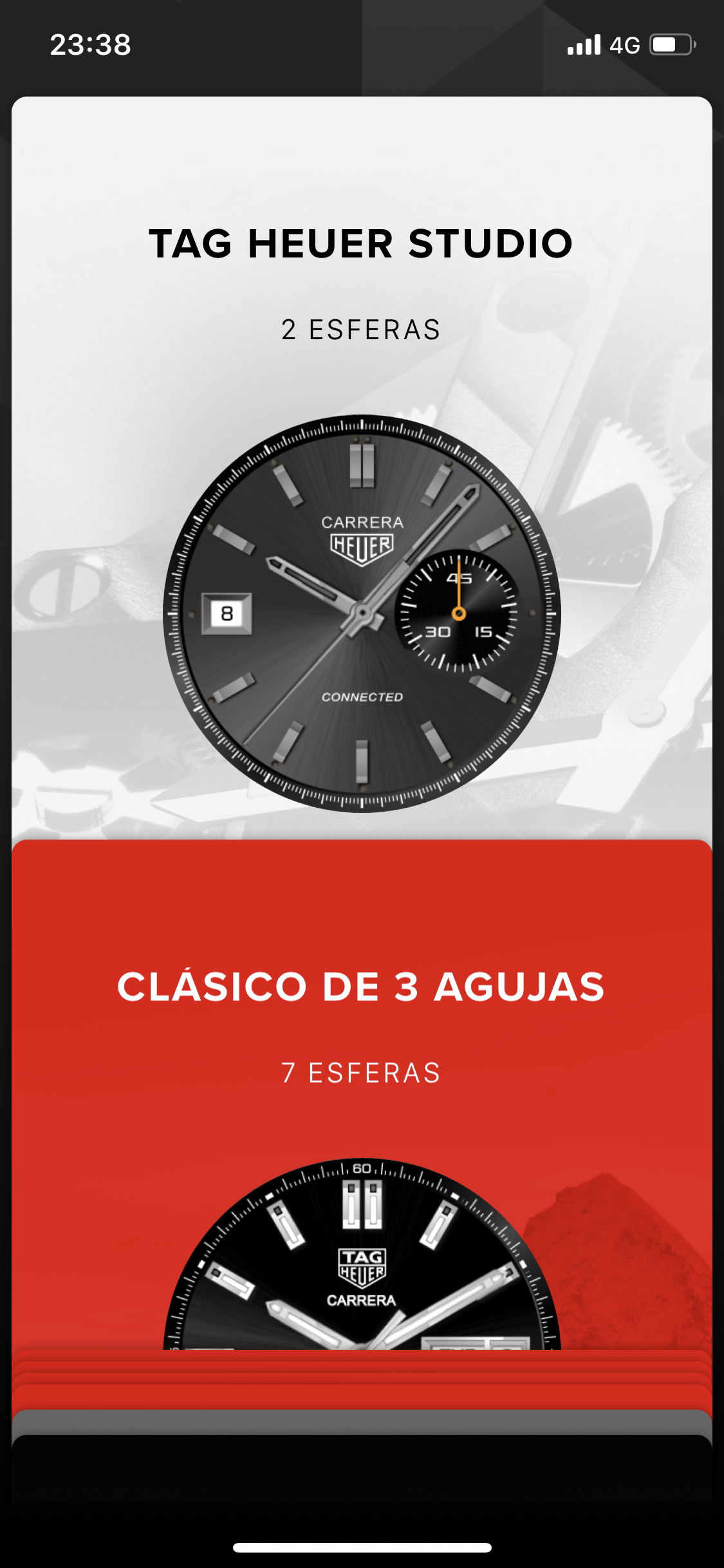

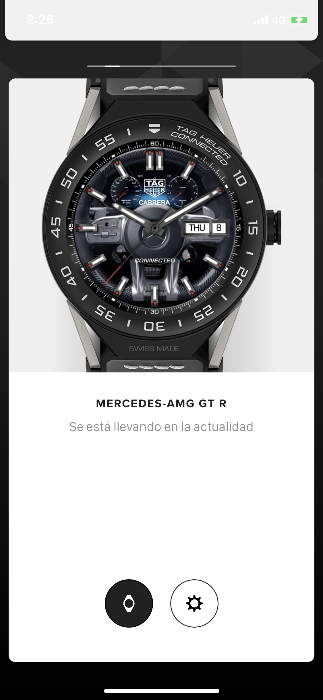

This TH app just helps you to play with the original faces in a different -and more visual- way that the Wear OS app, and now we can add a picture as a background of the Studio face.
It’s nothing very important, but it’s nice to finally have the TH app for iOS users. I don’t know if the app for Android has more features...

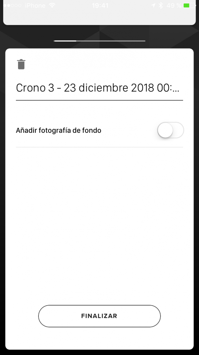

I restored to factory default and work
One question: ¿it’s possible to use a photo? I can’t do it in the app
