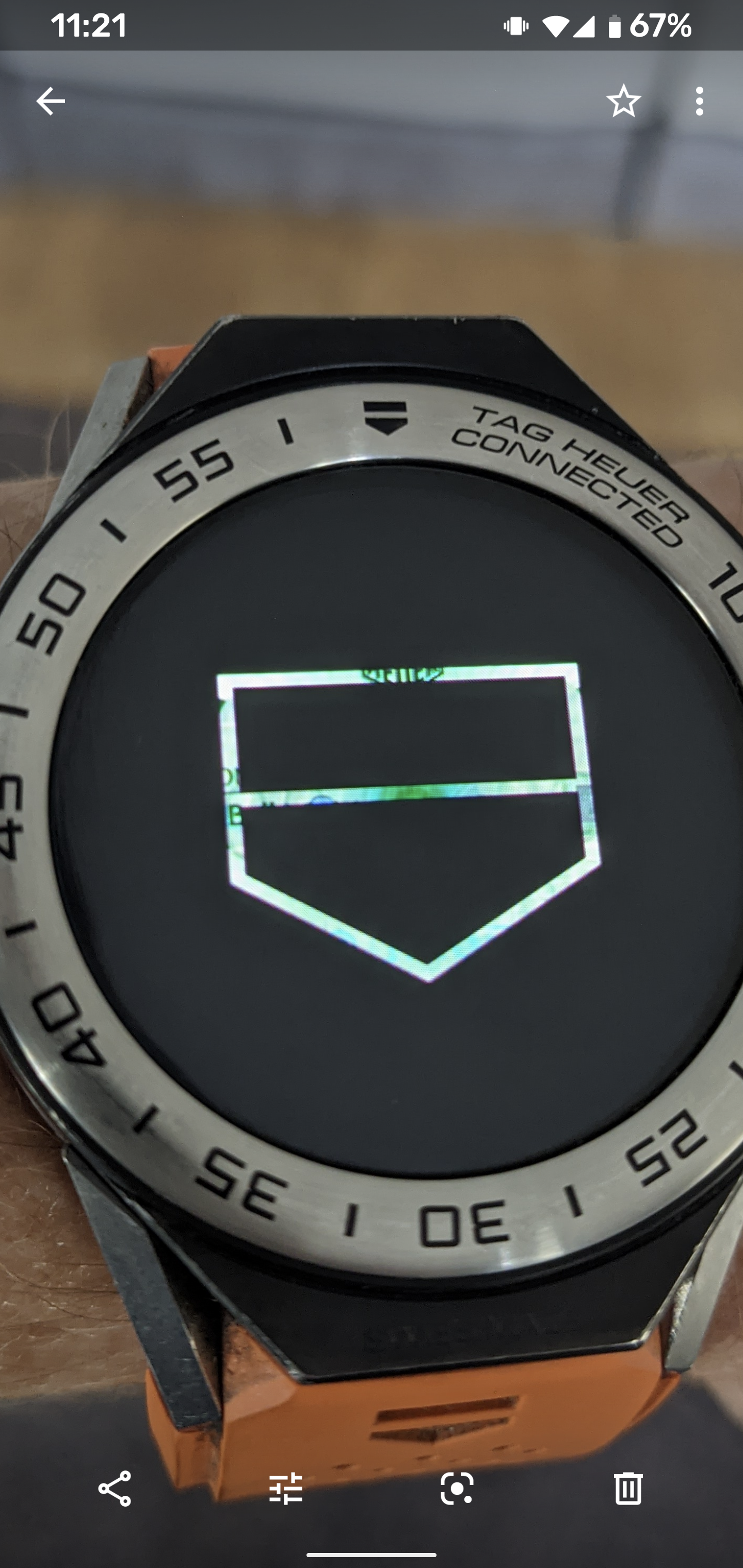

Morning, my Tag Connected has developed some type of screen burn, meaning you can see the outline of the clock hands (of a face I'm not actually using anymore) when scrolling through the menus etc.
The watch is out warranty, just wondering if anyone else had experienced this and whether anyone thinks Tag might repair for me?
Seems a bit shit given the money I paid for the watch in the first place!

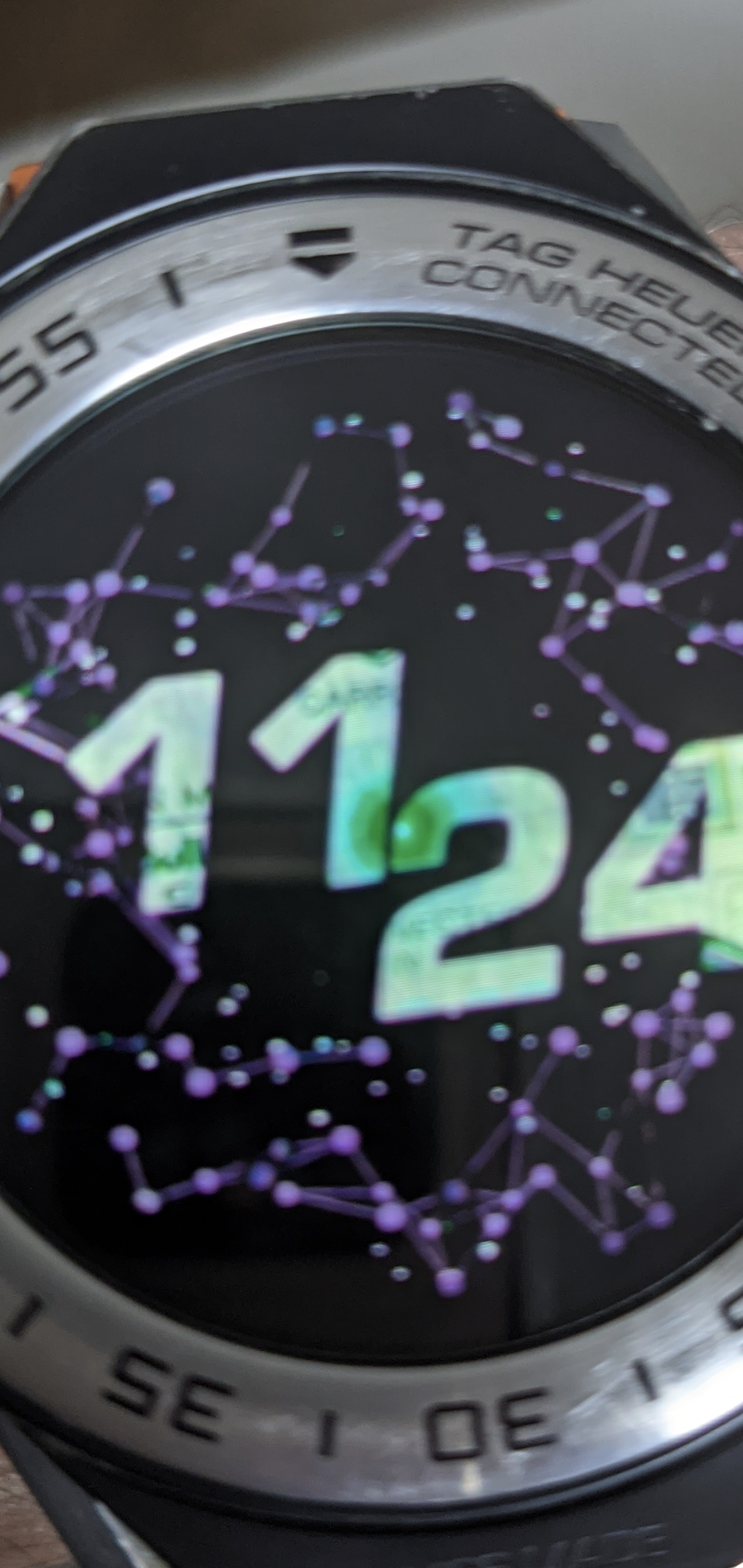

Another image here.....I'm totally pissed off about this.
Was looking to purchase a 2020 model but would need to sell my current watch to contribute towards the costs.
Looking at the 2nd photo below, I think it is the Red Bull Racing watch face that has caused the issue.

Typical OLED burn-in after using a static image for a long time.
You should have changed the watchface more often and have checked if there was any burn-in before the warranty expired.

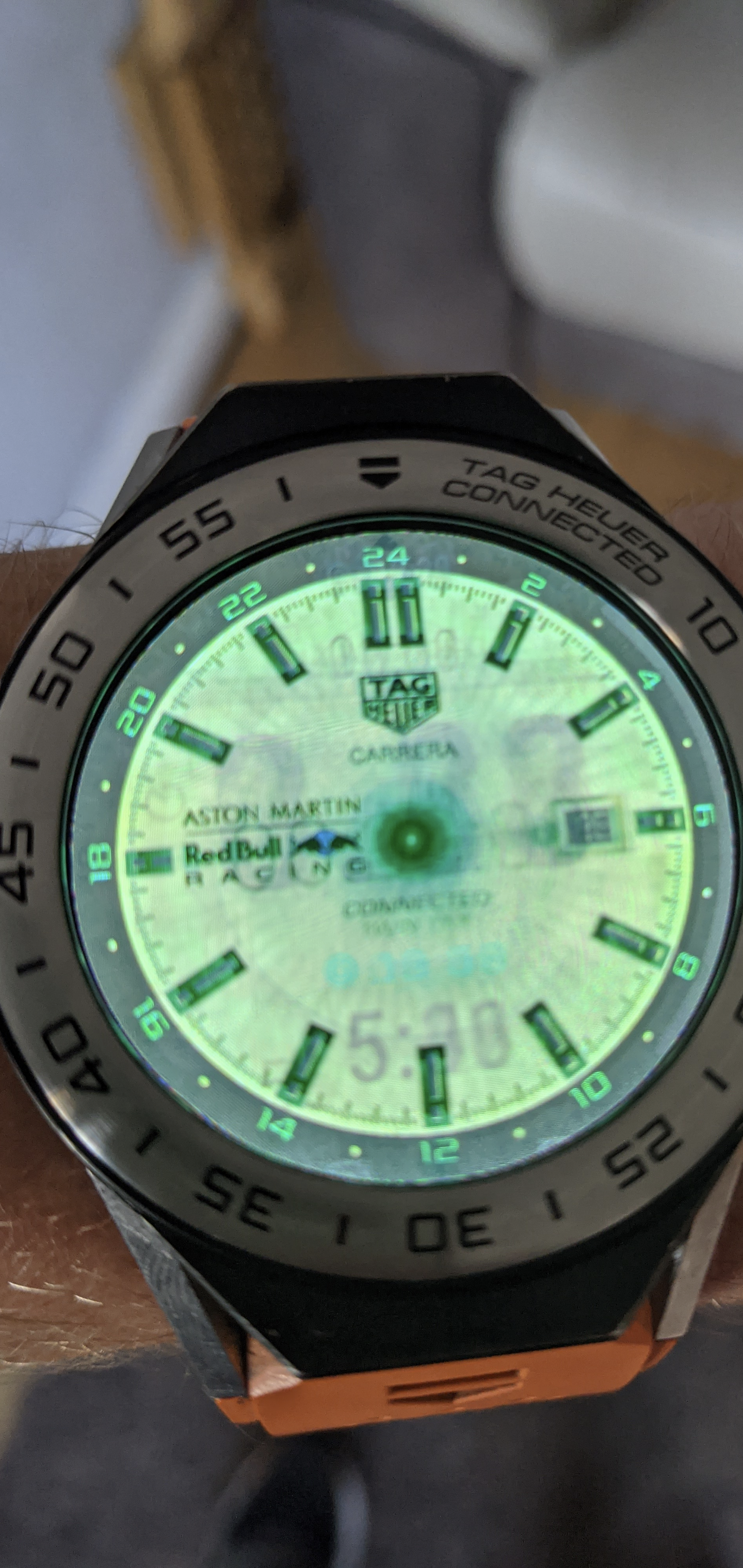

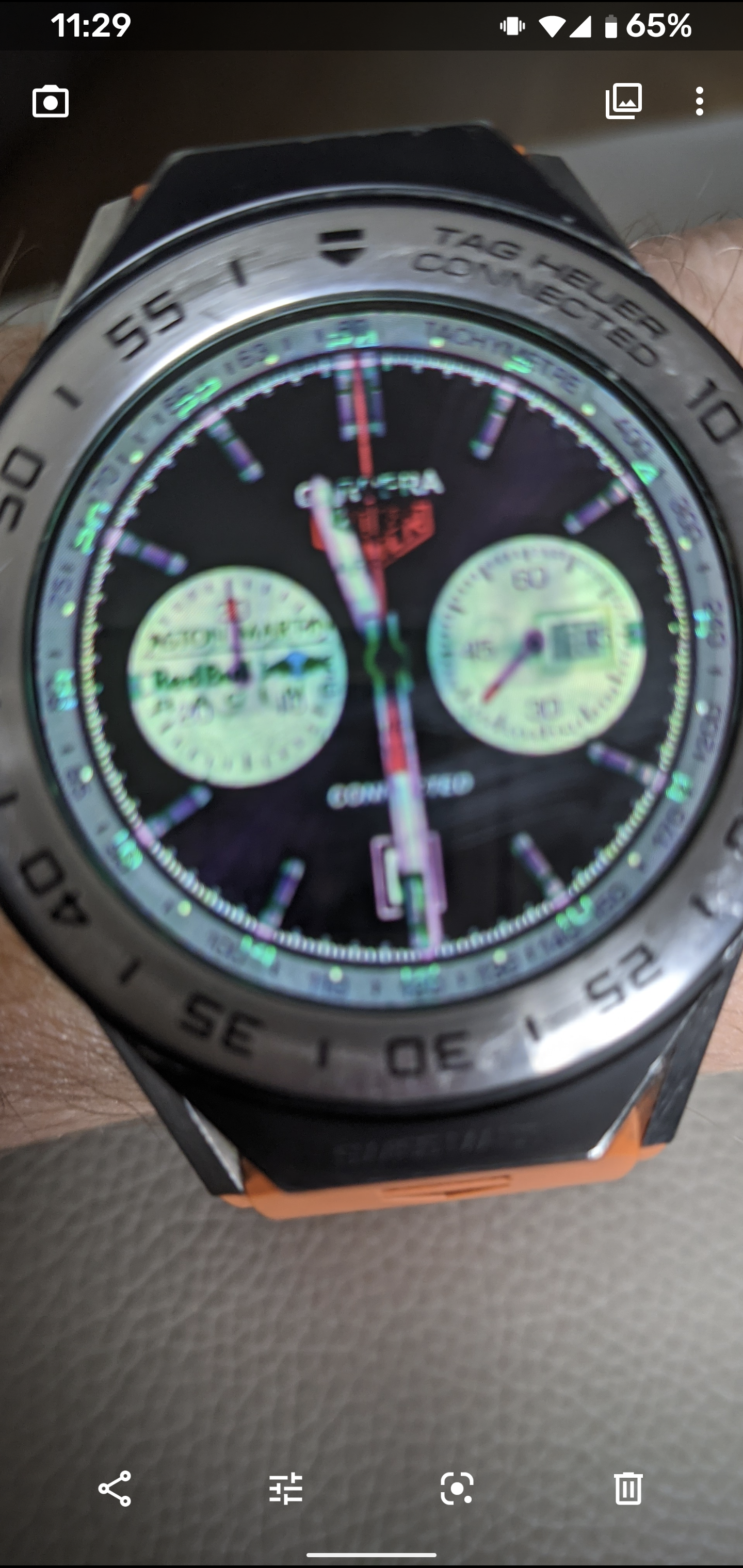

Also would interested to see what your screen looks like using the flashlight app
28
4
This in an image using the torch app.

From your torch pic, it looks like the RB face is causing an issue via ambient mode so we'll see if any change after the extended power down.

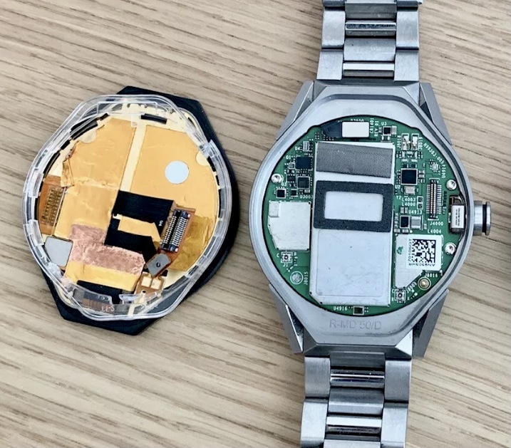

Hi, has anyone tried opening the case of a Tag connected 45 to either change a battery or screen etc themselves. There is is video on YouTube of how to change a battery on a connected gen 1, but a gen 2 seems a much bigger task. Does anyone even know what battery the gen 2 takes ?
This is the only picture I have seen of a disassembled Gen2...
Yes same one that I saw, how you get to that point is a very good question . Hehe
Possibly heating to melt the glue that sticks the screen to the case. As with smartphone disassembly.
