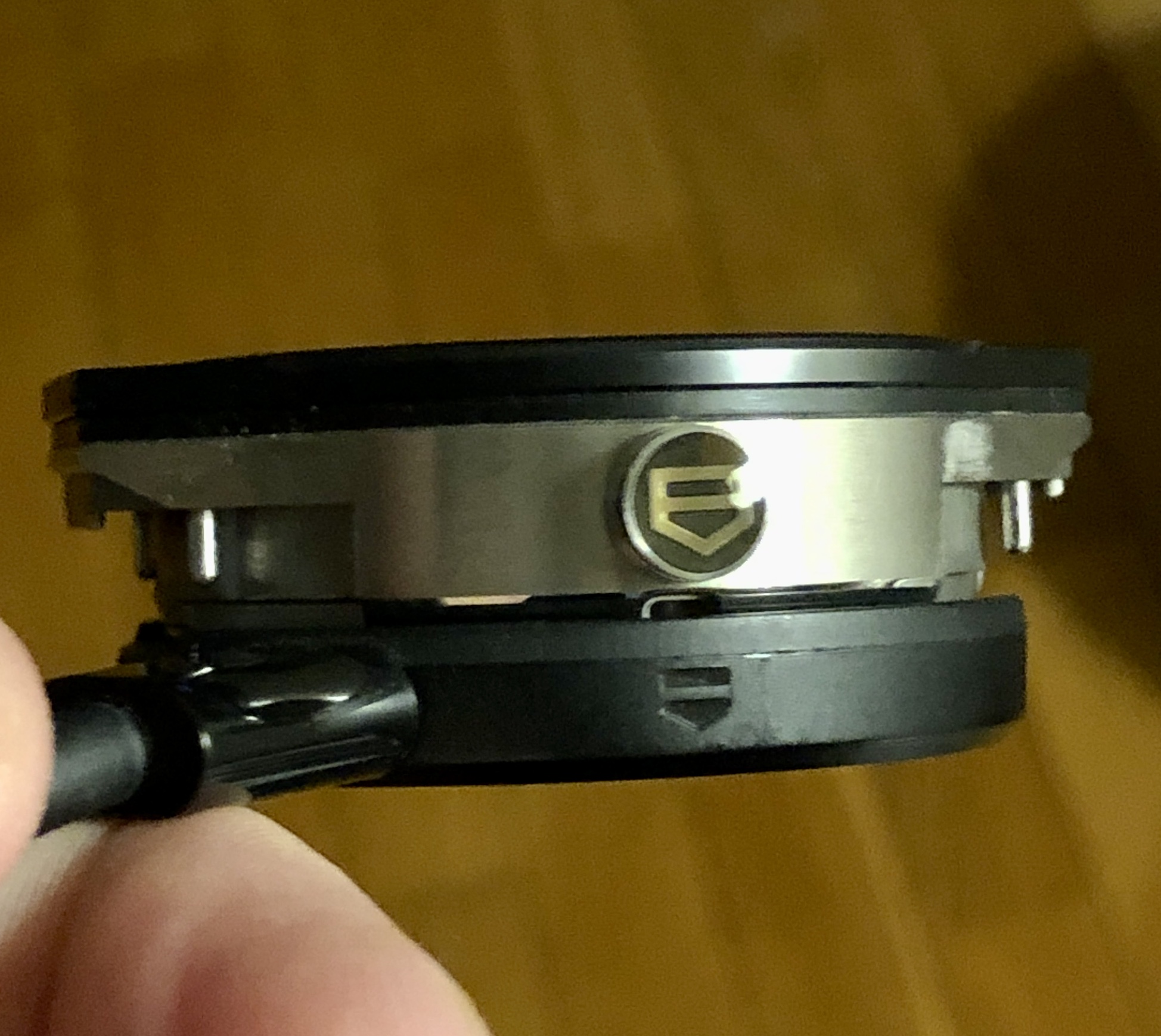

I am having a couple of issues with my watch and hoping someone can help please.
Firstly i have sent my watch to Tag 2/3 times as i suspect a charging issue because sometimes i put it on charge and it go back to it and there is no charge in it or i put it on charge and can see it has recognised the charger and begins to charge but then i come back to it and it ins't full even after leaving it over night.
So that said is there anywhere i can source a charger as i am struggling to get a genuine charger, assuming that is my issue
Try charging the connected module alone (like in the picture), sometimes lugs and straps make it more difficult for the charger. Also make sure that charging pins are clean on watch and charger, and finally verify than both TH logos are perfectly aligned before charging. Put always the module first on the charger, and then plug the charger
If all these actions fail, then you can try to find some new charger from our member @J.C . Maybe he could have some charger for sale (he is in UK)
