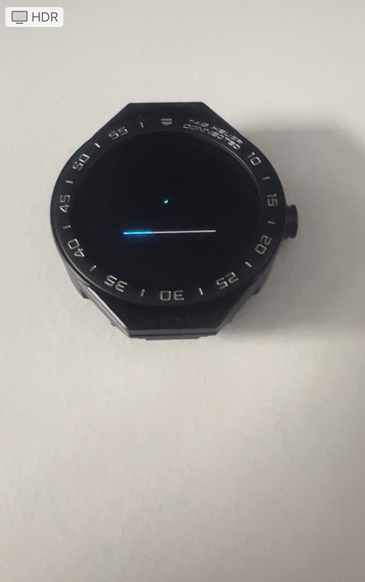

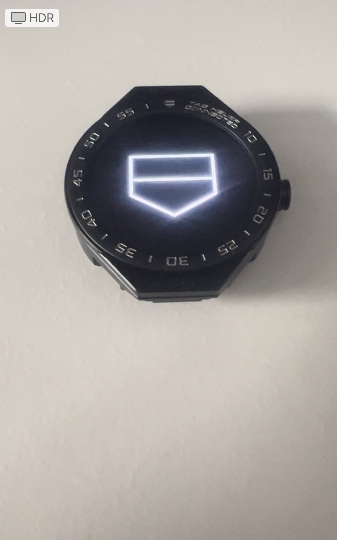

Did anyone have a problem like this yet? I updated my watch today and after the update it got stuck in the boot loop, loading until 1/3 and restarting again. This kept on going on for 2 hours then it just got stuck on the TAG Heuer logo until the battery got discharged. I’ve connected it to the charger and it is stuck on logo the whole time. Any solution maybe?

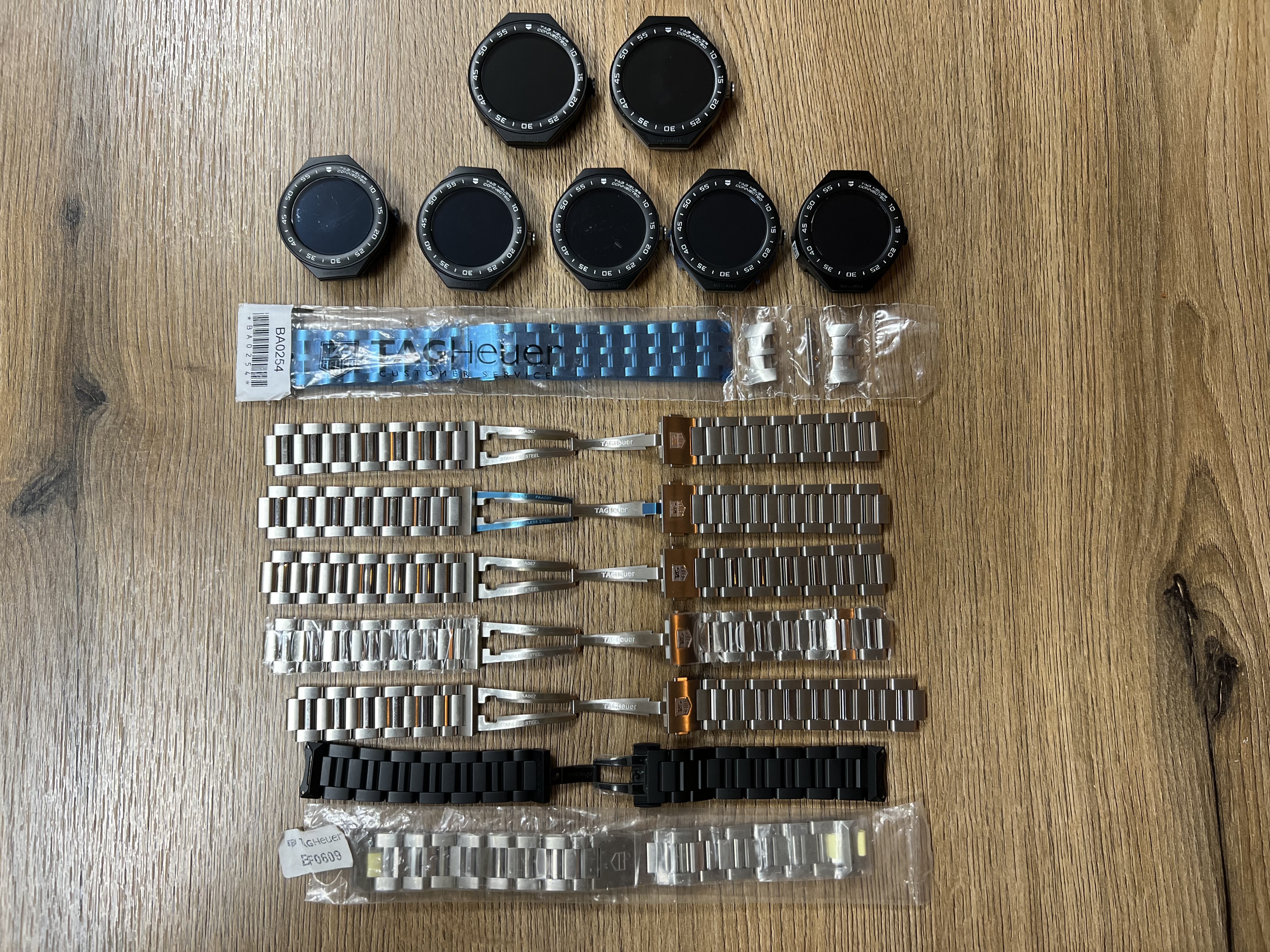

Hi, it was 600€. I sold the broken module for 100€, so it wasn’t that bad in the end.
No that’s reasonable to be honest. I regularly buy working heads at around 100 each and they are working well
257
246
But there are more that 3 heads there, did u already one the others ?
16
6

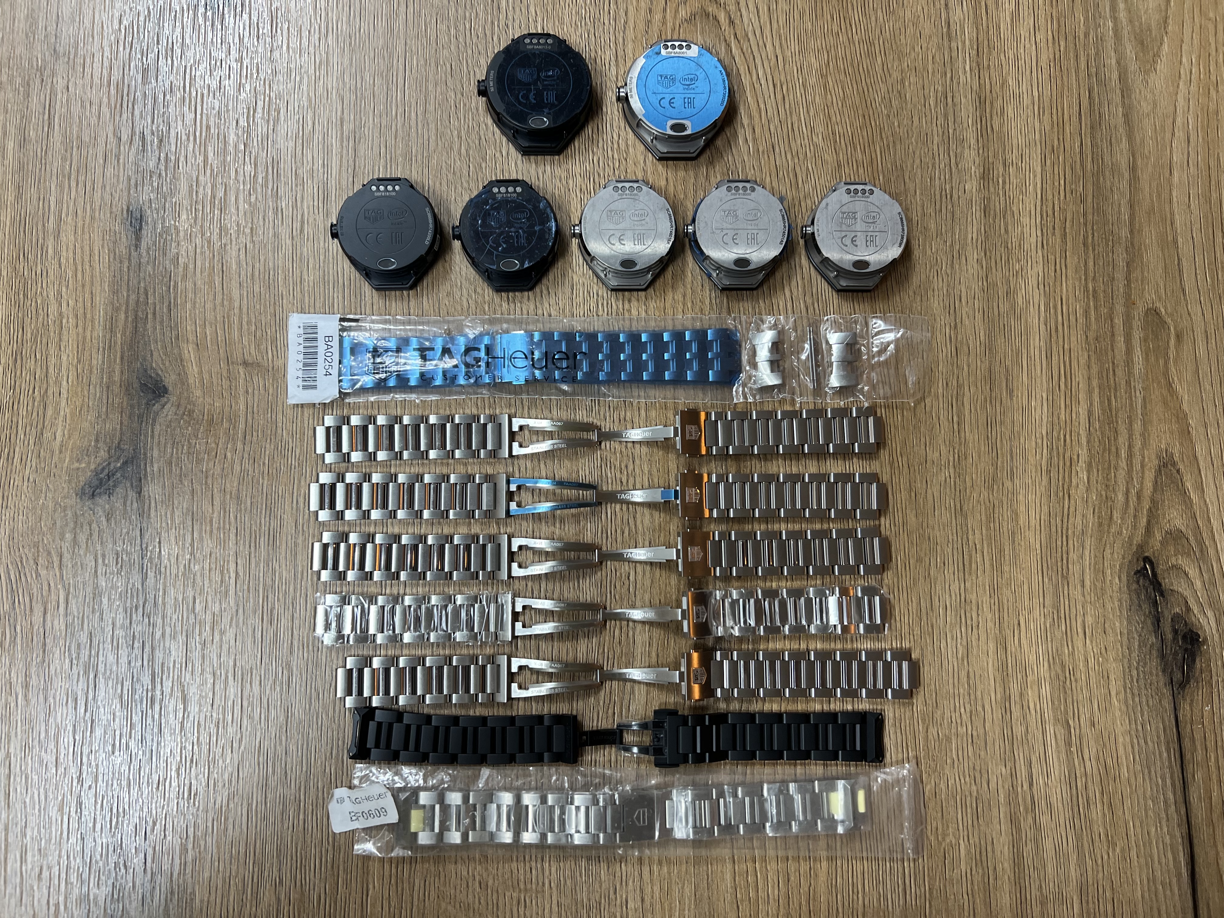

The 45 work fine and hold the charge normally. The 41 are strange, I don’t have the original 41 charger but I tried to charge them up with 45 and 46 charger with a little bit of fiddling arround to set the connectors correctly. I don’t know the specs of those chargers and if there are any amperage and voltage output differences or connector orientation. One 41 shows as being charged to 100%, as soon as I remove it from the charger it shuts off. The other 4 start charging and go through all the logos but as soon as they load up the system and show the dial face they shut down. Battery problems or possible incorrect charger?
16
6
2 heads are now spare 45 and the smaller 5 are the 41.
257
246
For some reason the 41mm show this problem of working on the charger then when removed they shut down. It even does it with the correct charger. Battery or faulty battery interface I guess but I’ve never seen the problem on the 45mm heads and I have more of these. Maybe with the smaller mah they are not so good keeping healthy when not charged.
