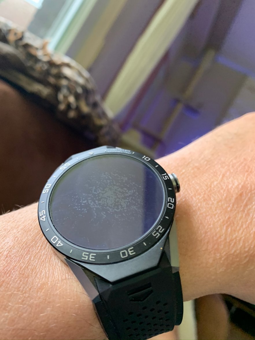

hi,
I have this strange particles on my display since yesterday, anybody has same or any clues to remove it, what is it?

Is this with the watch switched on, or does it happen also with the watch switched off?
102
144
it’s always there even when it’s off. I think it is the surface of the glass, anybody knows a good solution to clean or get rid off these?

Then is it maybe a plastic protection foil that you still have to remove from the screen? Try to use your nails at the edge of the screen with the bezel to see if you can remove that foil

Have you used some sort of spray-can, like CRC, silicone spray or any other type of paint spray. It could be overspray of some sort that has dried up ?
I'm sure you already tried warm soap and water, try dishwashing detergent, warm water and a very soft brush.
Hope you get it sorted

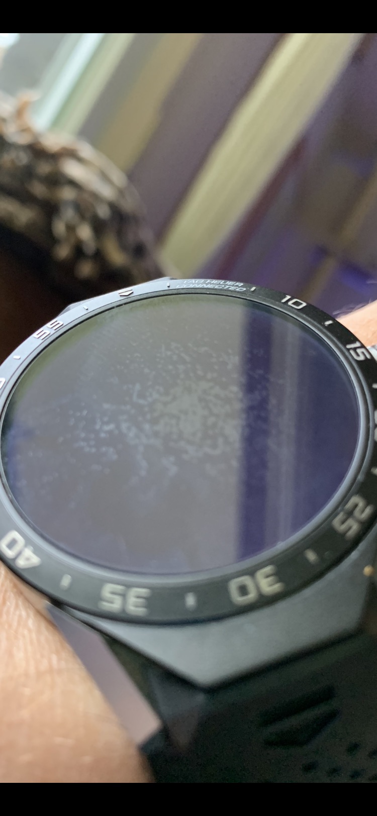

Thank you all for your help.
I cannot see or feel if there is a foil and cannot remove it. I can feel a higher level at the edge of display but do not now if it is normal glass or the foil on it.
Puhhhh.... I am very frustrated atm.
Trying to clean with warm soapwater or dishwashing already before, no result.
Any further ideas guys? Here is one more pic, I can send videos too, if wanted.

I definitely remember other threads where this question has been asked, and there were two foils to remove. Maybe try a search.

I had the same issue with my Connected 45. There were 2 foils on the watch, and I only took the first one off.

Use a needle to lift the edge of the foil.

If it's not a foil, it's the AR coating that's coming off. Which I believed happened to mine but can't remember

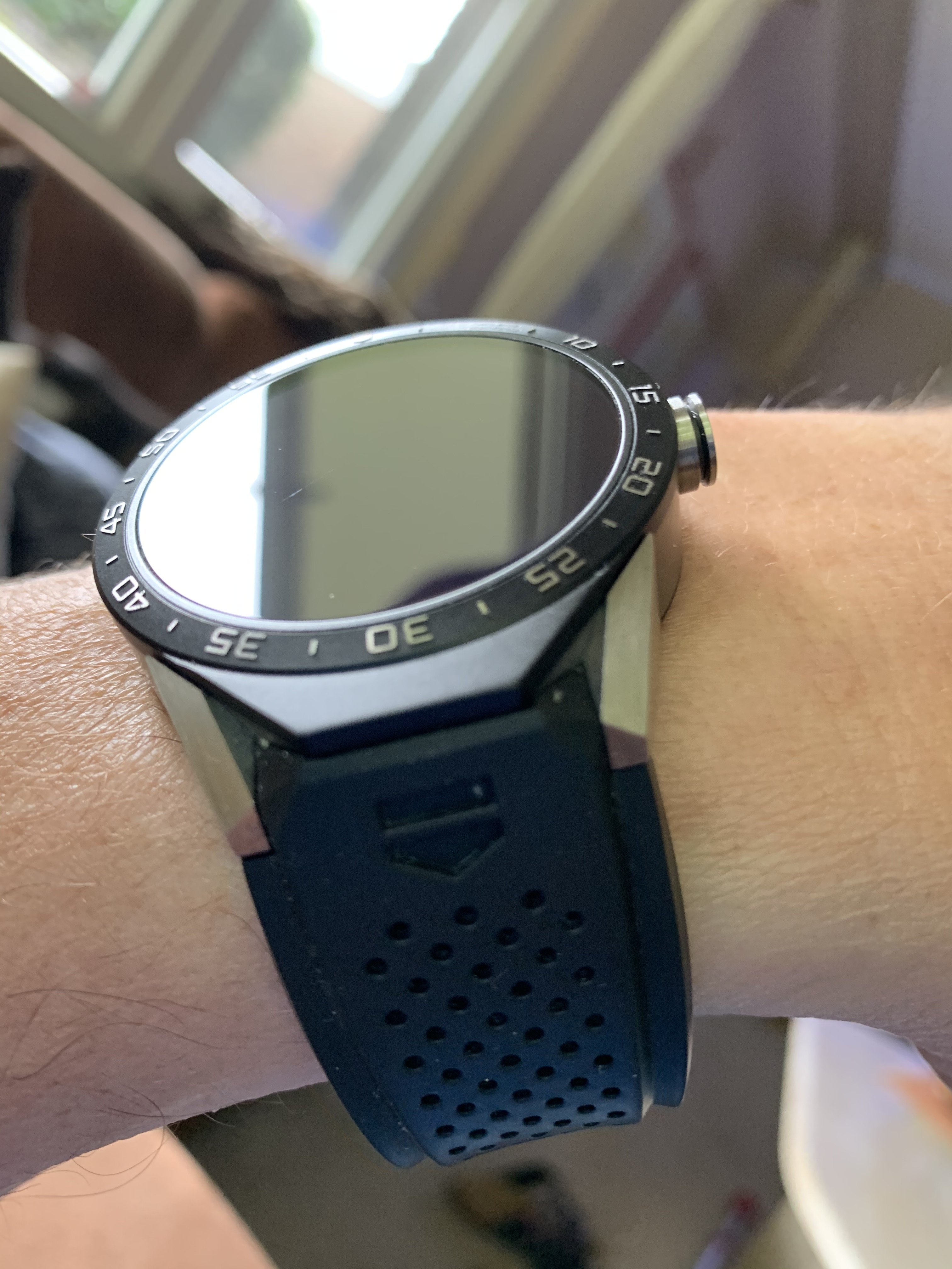

My gen1 only had one film. The gen2 had 2 films. When you touch it with your finger, does it feel like glass?

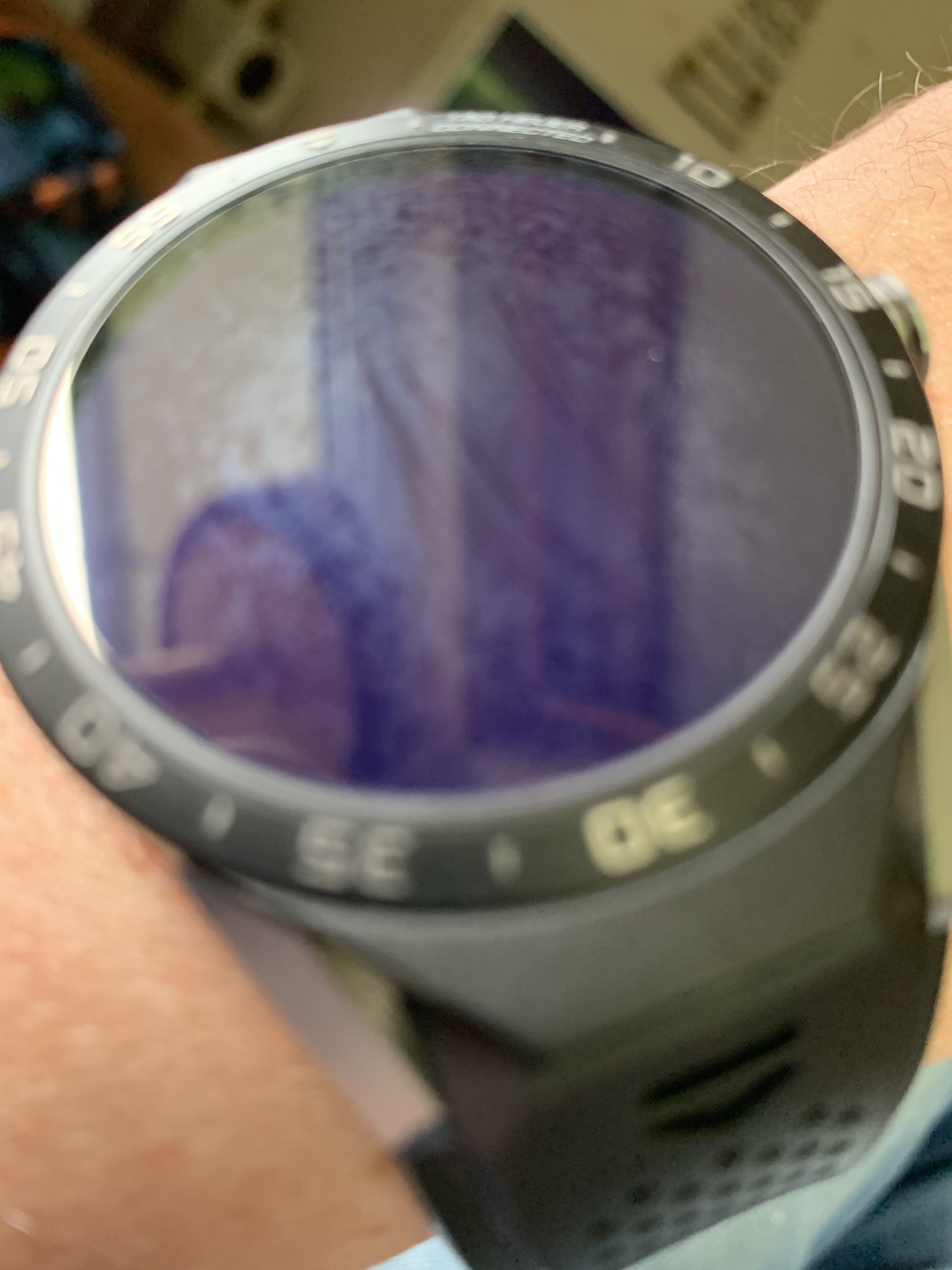

if i scratch with my nails it disappears like foil reacts, see the 2 long stripes! So I think its foil but it is too long on the glass I think, any ideas to emo e it hardly?

Hello,
finally I made it, thanks to all of you for help!
Thanks to TagGuy who was right at the end, it was the AR protection!
I solved it with some ceramic cleaner!
