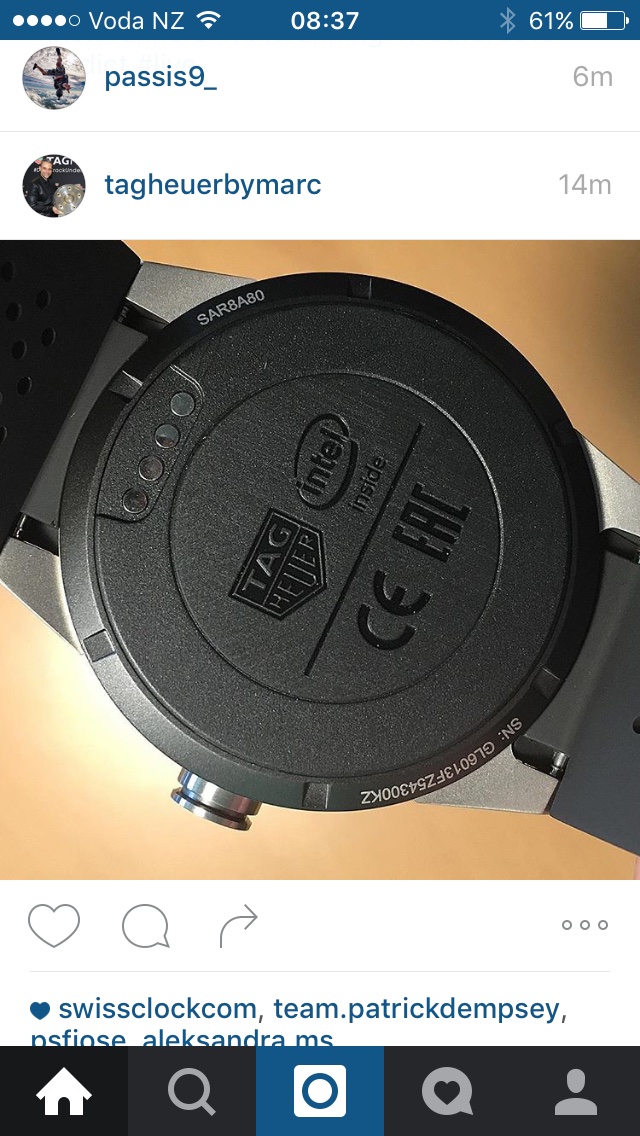

I reckon the culprit will be the charging points at the rear of the watch
33,160
37,894
The charging points aren't so much a concern IMO, the biggest issue is going to be that while TAG Heuer has been making mineral crystal, sapphire and plexiglass crystals for decades that can handle pressure, the manufacturer of the display will have had to make the sapphire in this case and won't have been able to make it anywhere near as thick, or as domed as a normal TH watch.
The display OEMs are primarily concerned with spot pressure and scratches rather than increasing PSI, so while electrical connectors can be easily water proofed, getting a sapphire touch display that has to be thin and flat to work to pass 300M, or getting the OEM that made it to warranty it to any real pressure at all will be next to impossible as they're just not in that business.

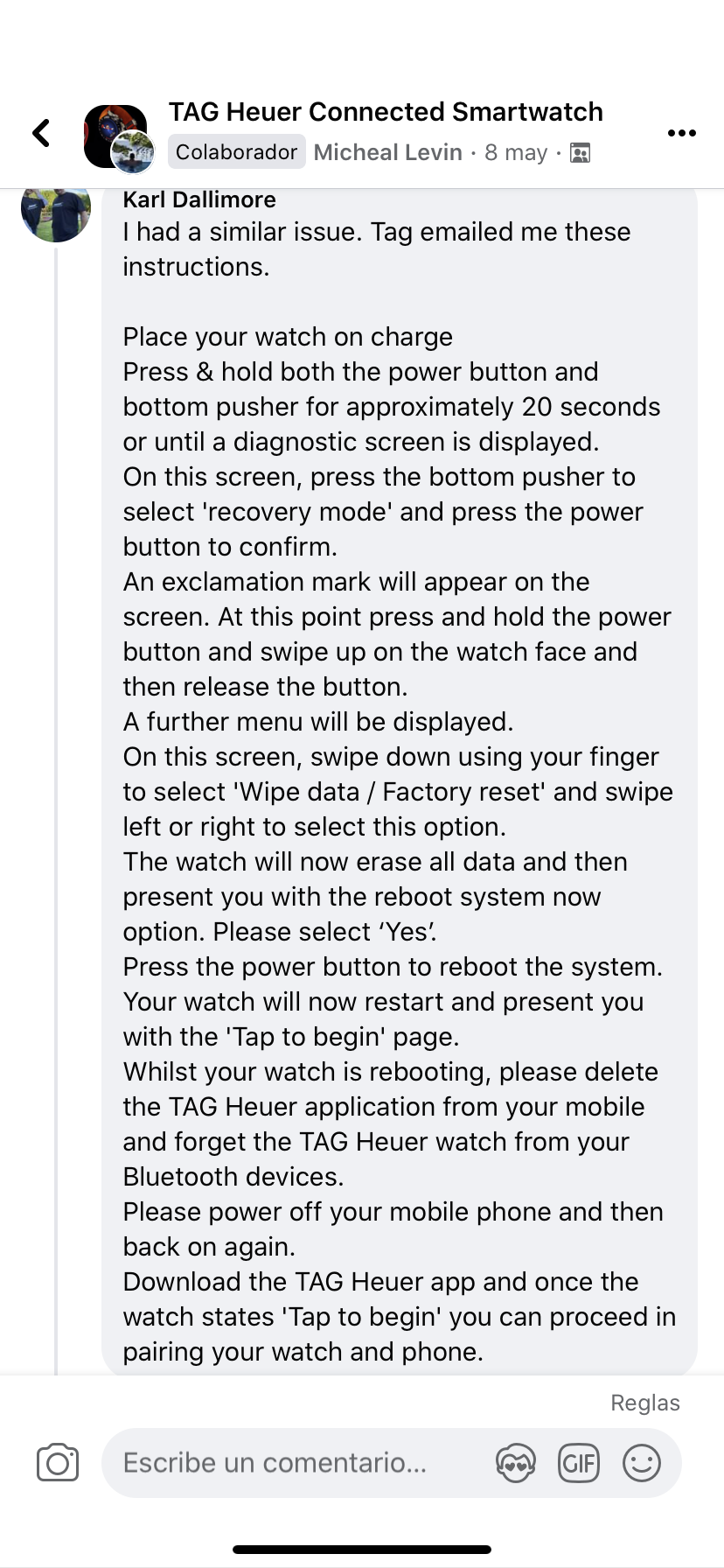

When I attempted to power on my watch, I only get the Tag Heuer white logo only. The red & green do not show. Battery seems to be charged. Is there a way to hard reset the watch?

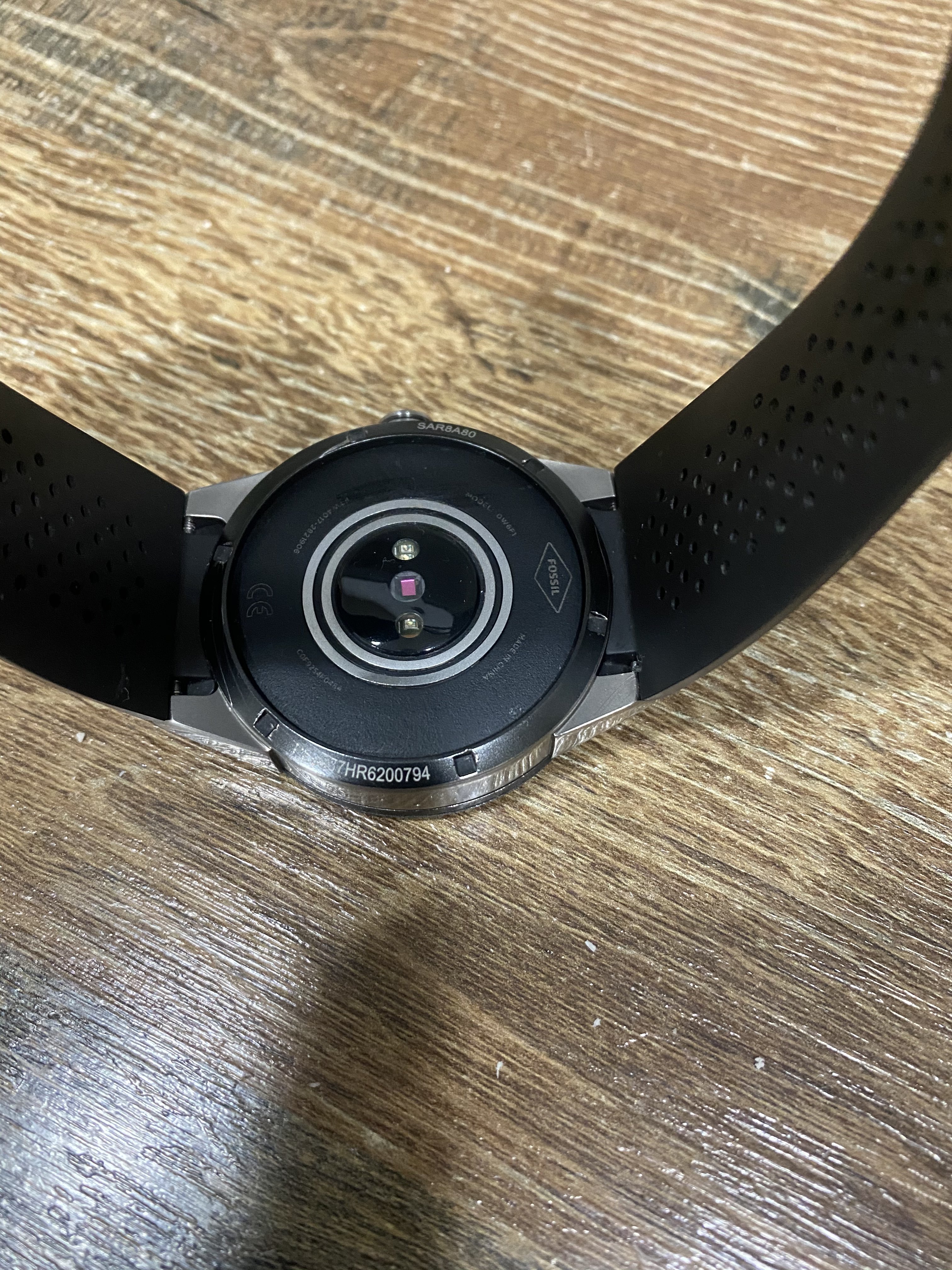

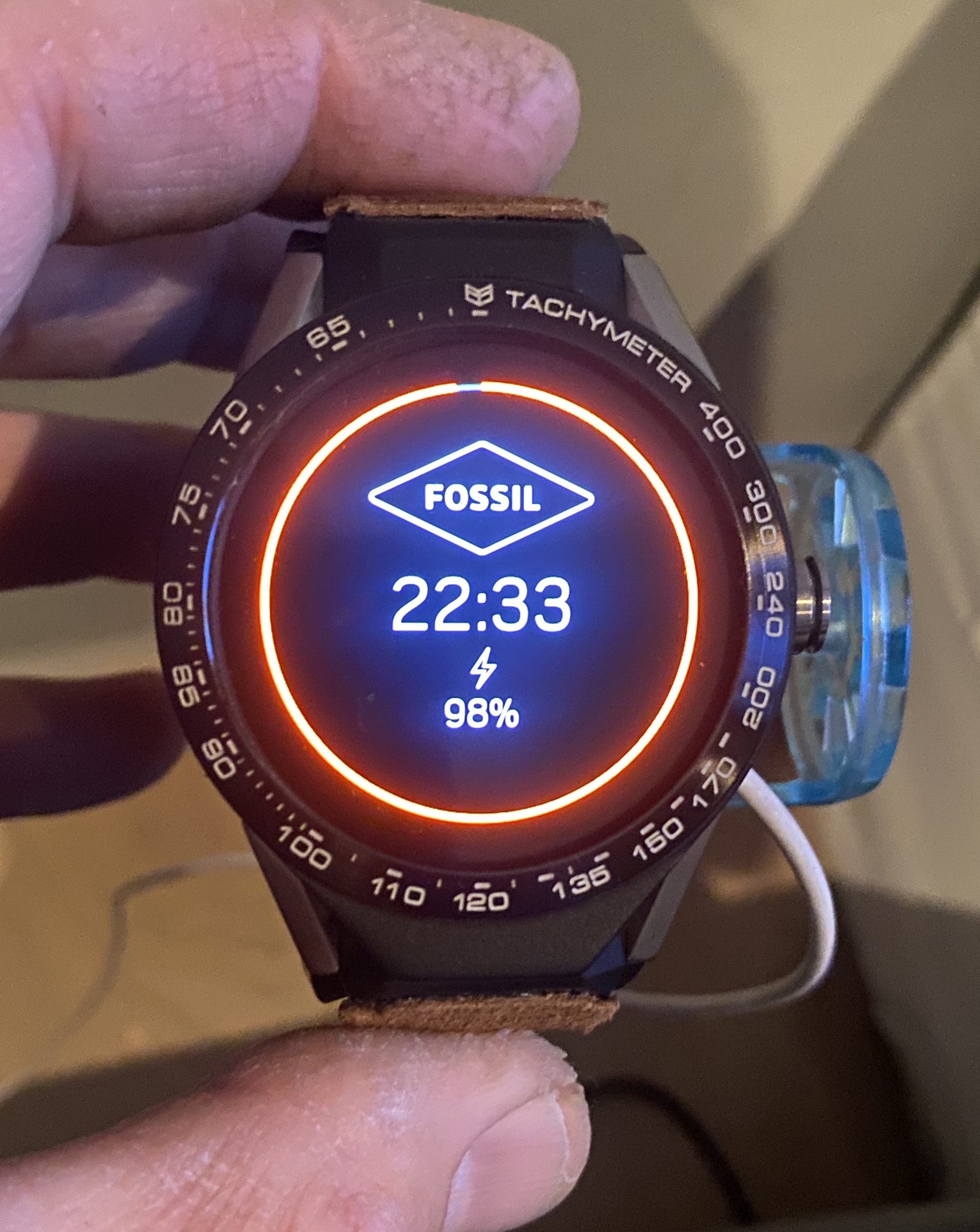

I hope you can recover your E1, but if you finally couldn't, there is always a solution, I couldn't recover mine due to a broken screen and I opted for a drastic solution, mounting another smart watch inside the tag box.... and until the day today very happy, I used a 45 mm fossil
These are instructions to hard reset an E2, but probably is the same for E1, so you can try the following on your own caution/discretion:
1. Press and hold down the power button until watch restarts (about 15 seconds)
2. During the boot up animations (TAG's logo, Intel's logo, or the swirling balls), press and hold the crown and simultaneously swipe from top left to bottom right, then release crown (You can repeat this process until the screen blacks out and the boot process restarts)
3. The watch will boot to an image of the Android character on his back. Long press the power button for about 5 seconds and release. You should see the "Android system recovery" menu.
4. Short press the power button three times to go down the menu to highlight "wipe cache partition"
5. Long press for 3 seconds to select "wipe cache partition" and confirm your selection
6. Short press the power button twice to go down the menu to highlight "wipe data/factory reset"
7. Long press for 3 seconds to select "wipe data/factory reset" and confirm your selection
8. Select "reboot system now'. Long press for 3 seconds to select
9. Watch will restart to the Welcome screen. This will take less than 2 minutes.
Good luck! 馃憤
