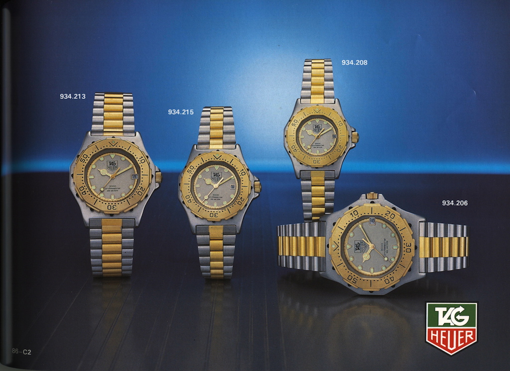

Here is the watch in the 1987 Catalogue:
I doubt that you are doing anything wrong- typically pulling the crown out all the way will change the time and the position before that will change the date.
My guess is something is stuck with the date wheel given the rest of the watch is working.
