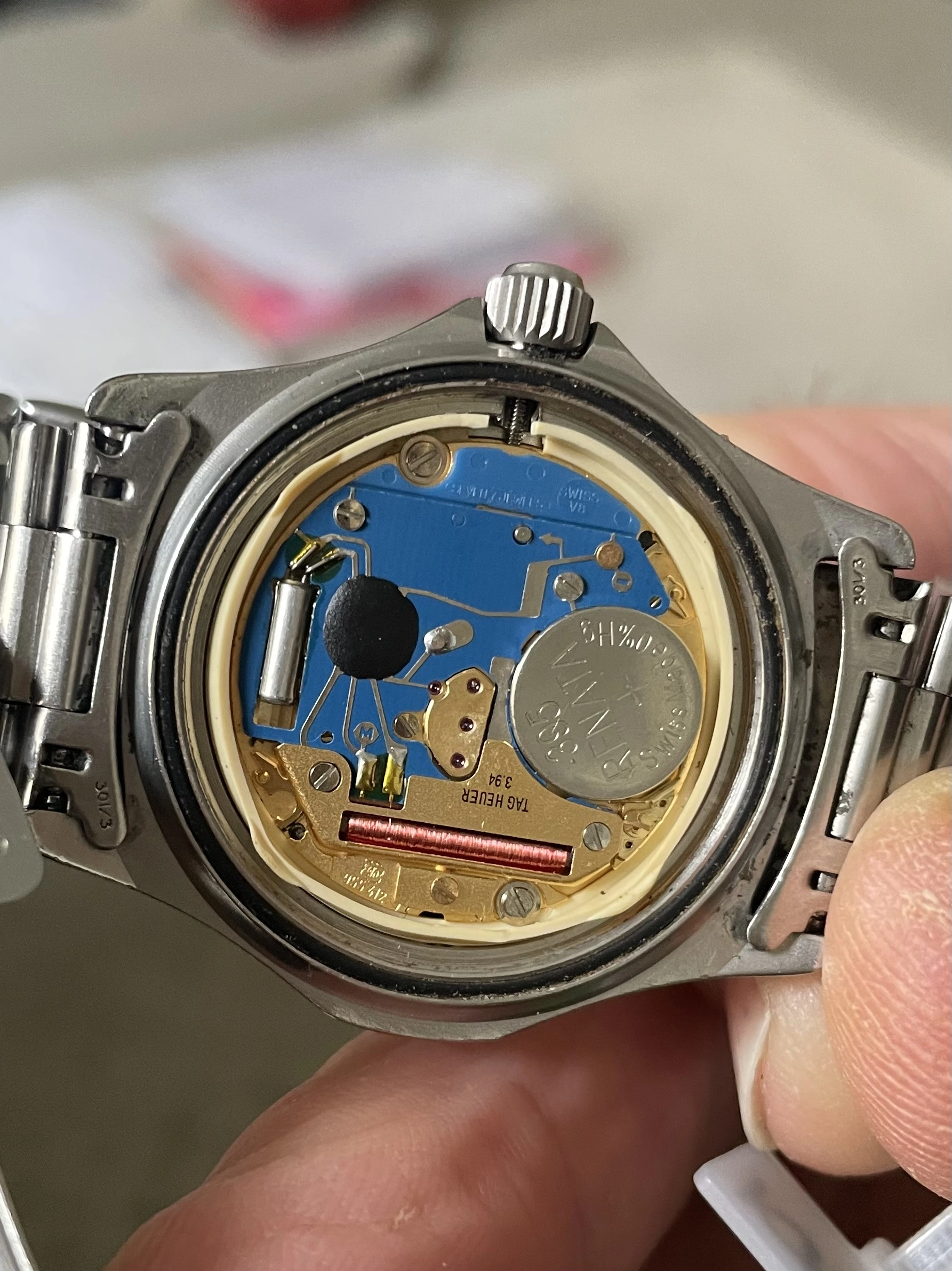

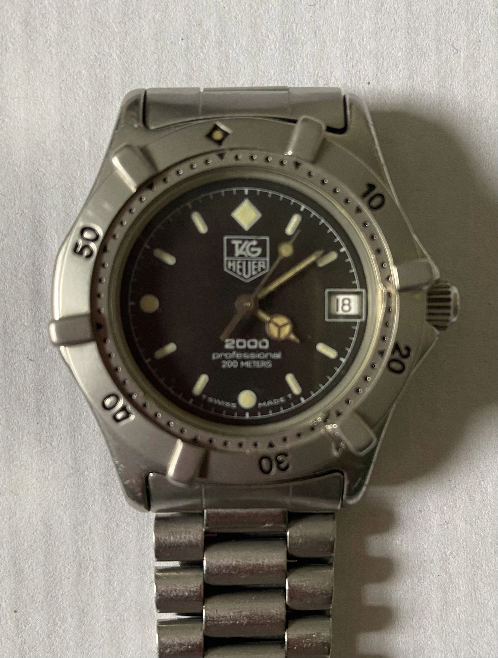

Purchased the watch in the late 1980s but lost the bezel and click spring. After (foolishly) deciding to return to working order recent eBay purchases of replacements has meant taking out a second mortgage especially as I now realise that the original movement is kaput and will need to be replaced. Can anyone advise if it is possible to replace the original eta 955.412 with a more modern equivalent?
Any advice would be appreciated

So the original quartz movement is no longer working? Suggest you either take to Tag Authorized dealer for service or contact Tag1000Divers as they work on older vintage models. Either way, replacing the original with newer working quartz movement should be fairly easy fix and very do'able.
