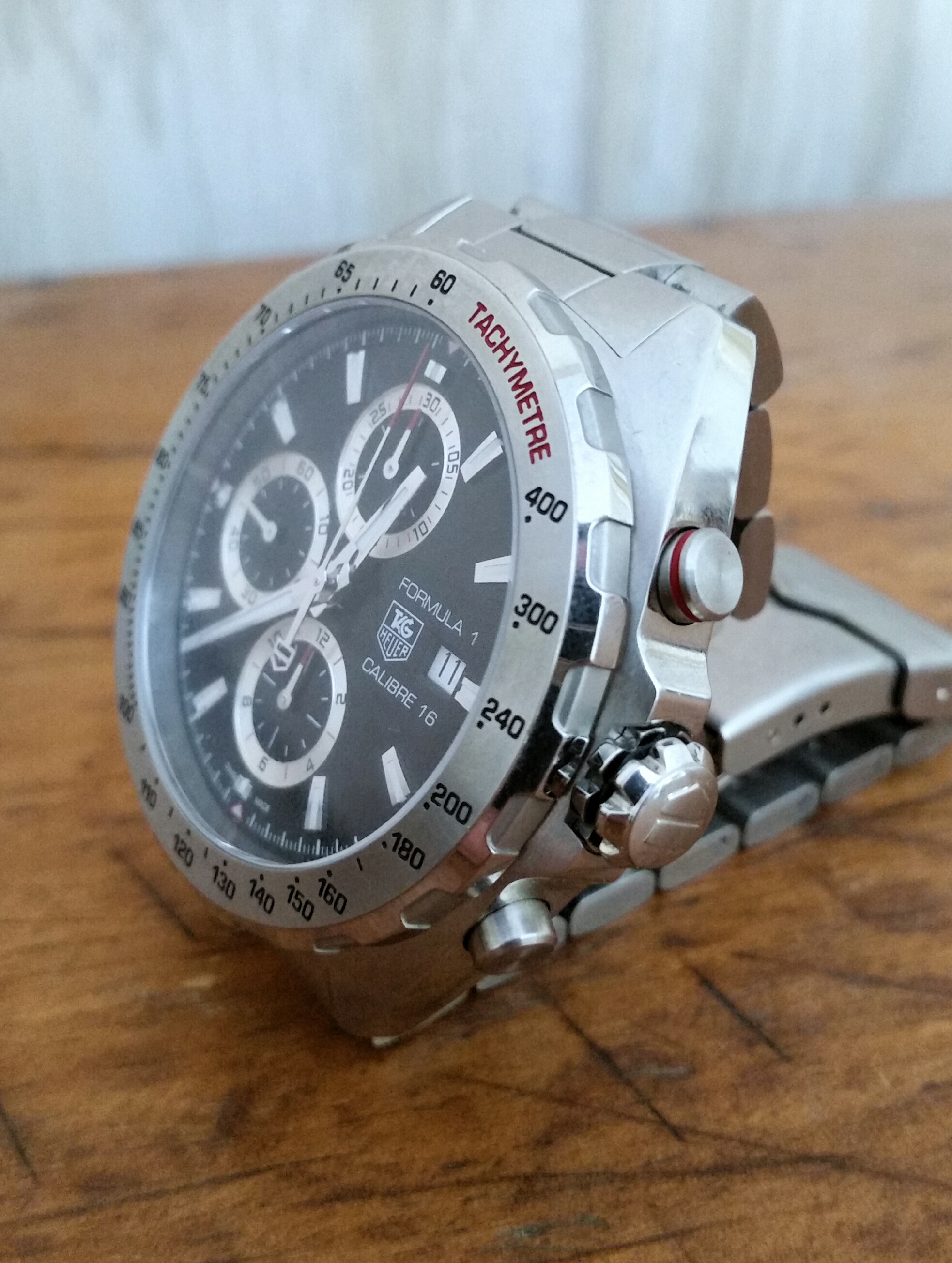

Upright like this. That website is the only one I use. It may be off a second or so but I just do it for fun.
