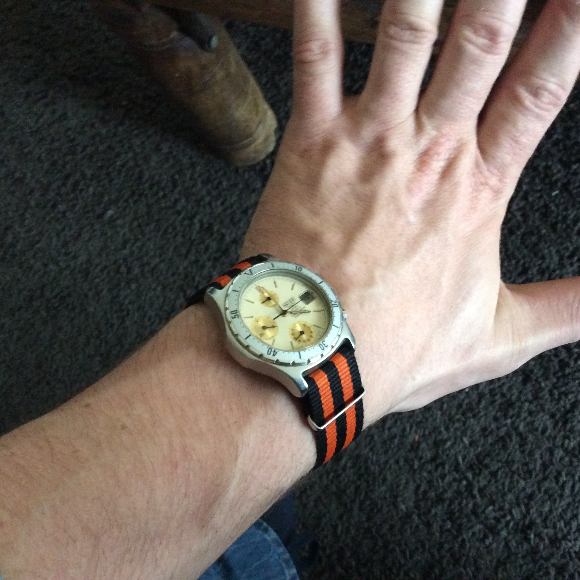

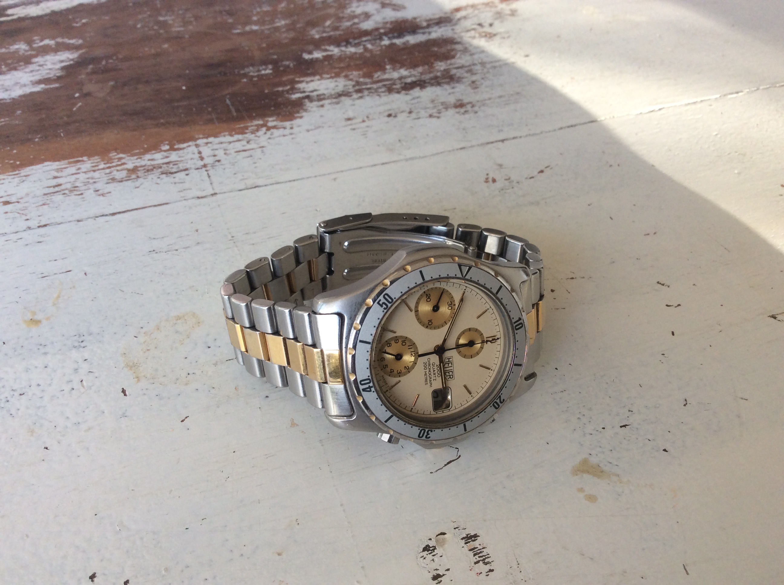

Not 100% on this one. Here is what I would expect the watch to look like (ignoring the bracelet that you've added)
I wonder if the dial has been retouched? Look at the "12" at 12 o'clock and the style of hour markers used
375
223
Looks like it has been build up out of several parts, the dial and hands are from a 256.006, see here from Calibre11's Catalog section Catalogue 1985/86:
But case and bezel are from a 274.006, and the bracelet is from a later model 2000.
Value? Sentimental, but I would insure it for US500,-
Absolutely right- great spot @automobilia42

So it must be a build up watch then.
Will do some more research on this one.
Although who would rebuild these watches?
Is it not possible that it is a model that is just not in the catalouge.

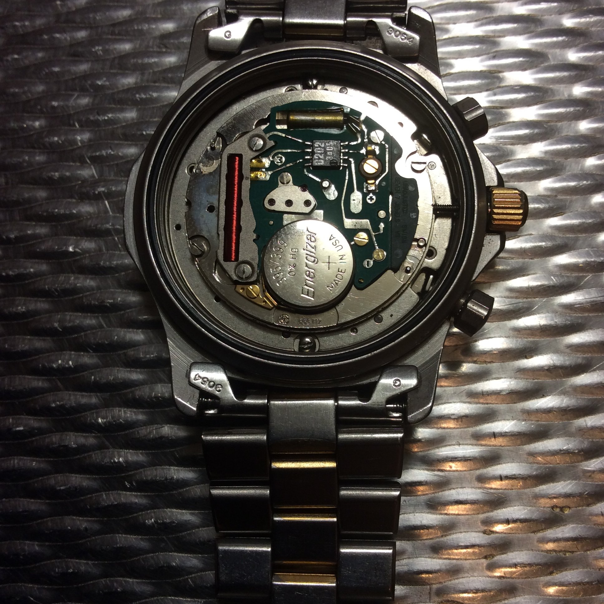

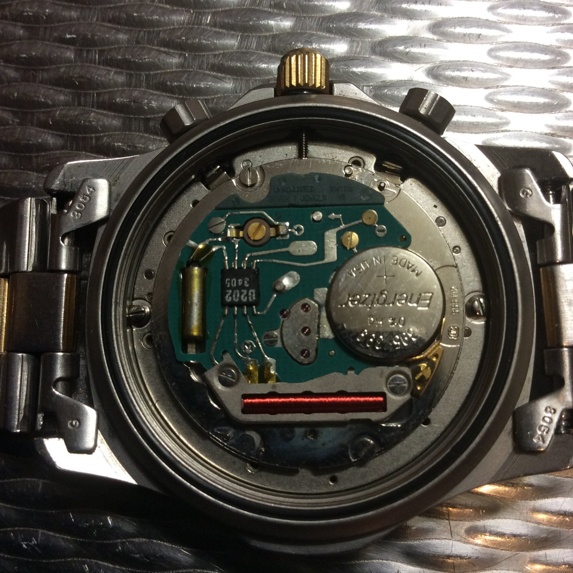

Had the guts to open my Heuer to take a look under the hood so to speak. ETA 555.112 , 7 Jewels.

That's the right movement. Yes, think that it's as simple as a changed dial. Could have been water damage to the original, could have just been a collector who wanted to swap dials.
The most unlikely scenario is that TAG Heuer did make this model as you have it- can't recall having seen one before and there is nothing in the catalogs. What is the case number stamped on the back?

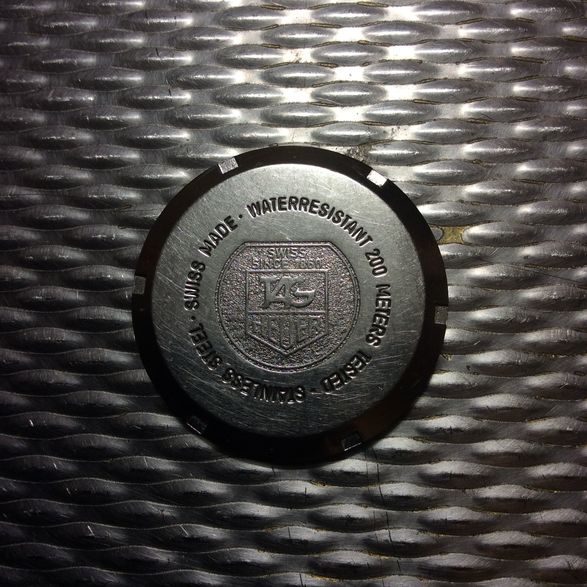

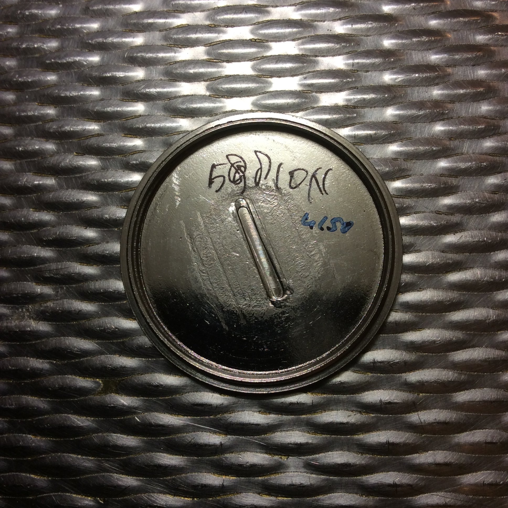

This is the backcase that in on right now, i think you are right that this watch is been taken apart by some collector.
7,124
15,117
This is the backcase that in on right now, i think you are spot on that this watch is been taken apart by some collector or is been replaced by the official Tag Heuer dealer.
Think so. I'd agree with @automobilia42 that the watch began life as a 274.006
