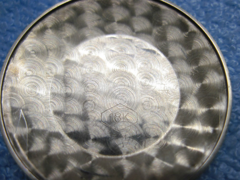

While going through some of the Omega Constellation 'C' series, available on the market, I come across one with such a back-cover.
Apart from '18K' there is no other inscription to be found on its inside of the back-cover. Please see attachment. Why is this so?

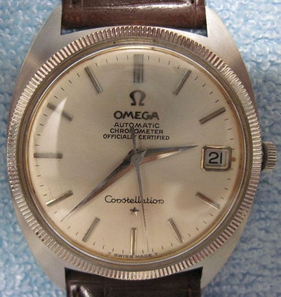

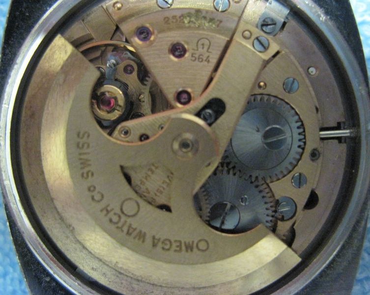

Do you have pics of the watch it was attached to?

Thanks for the response.
I shall get the pictures of its dial and movement, later in the day.

The case is aftermarket, probably done in South America. Stainless steel cased watches are shipped there, and a local jeweler has identical gold cases made then installs the dial/hands/movement combos into them. It's very common but hurts the value to a collector.

When you said, 'aftermarket', can it be assumed that it was not licensed by Omega Switzerland?
Anyway, my son is now back home and here are the pictures of the watch dial and its movement. Hopefully, this helps.

Correct - it was not licensed by Omega or it would have all the markings.
