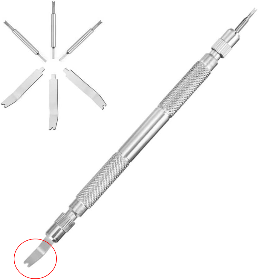

I had bought lug pins with which i got a spring bar tool (https://www.amazon.co.uk/dp/B07CYPVGWY/) - works perfectly for me. The main thing to consider is that the spring bar tip on the tool is angled (like in the pic below). That angle applies a little extra leverage making it easier to remove/install the pin.

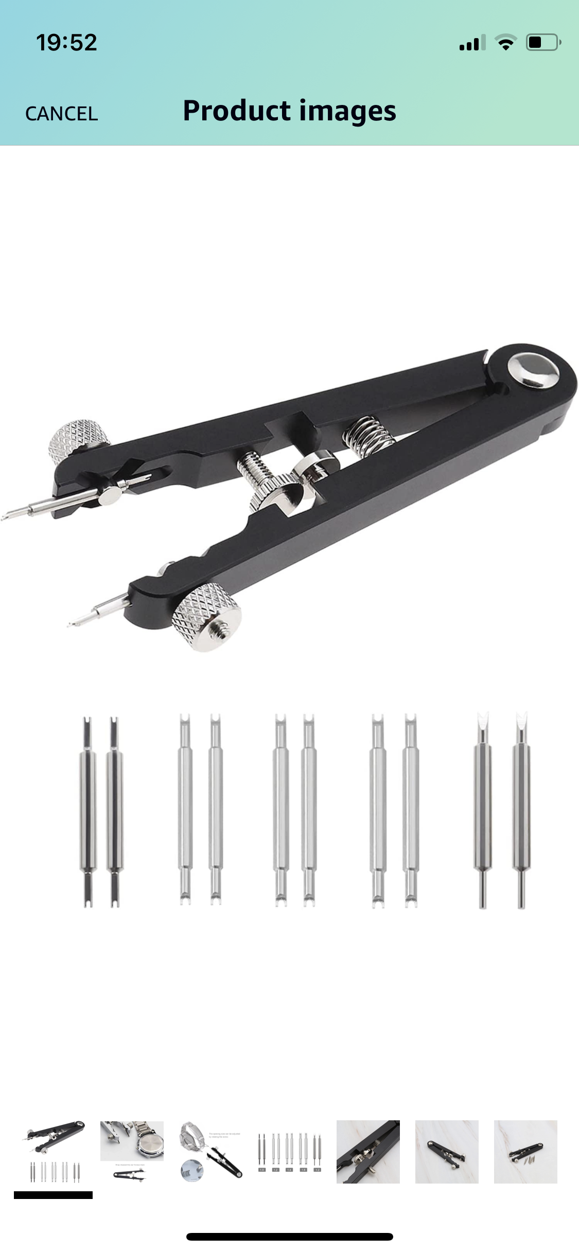

I also have the Bergeon 6767-F, which I use for straps. But their tweezer tool seems way too expensive. I use this one on my bracelets, like the BB58s, works just fine.
https://www.amazon.com/Spring-Durable-Tweezer-Removal-Repair/dp/B08H55MW9T/
