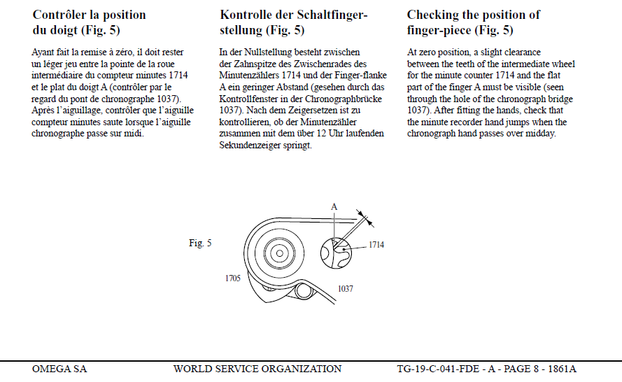

Is this the boutique on Bahnhofstrasse? If so, I believe it's a service centre and might have a watchmaker on site. I know people think that the sales person should know all of this but, it's like asking in a car sales showroom about the crankshaft sensor adjustment on an engine. It doesn't surprise me that you were led to believe that the 1863 is significantly different to the 1861 by the sales person.
Ask to speak to the watchmaker and show him/her the issue. If they also say it is normal, then I would be mightily surprised as neither of the 1861s you've seen meet the Technical Guide from Omega (November 2006) which is available on the internet and used by watchmakers, including me. The on site watchmaker (and any Omega approved watchmaker) will have access to the current technical guide. If you read the last sentence shown below "After fitting the hands, check that the minute recorder hand jumps when the chronograph hand passes over midday".
Out of interest, I have two Speedmasters: An 1861 serviced by me and it exactly follows the technical guide, as I would expect it to...; An 861 serviced a while ago by someone else (it's in my queue) and it is virtually the same.
Regards, Chris

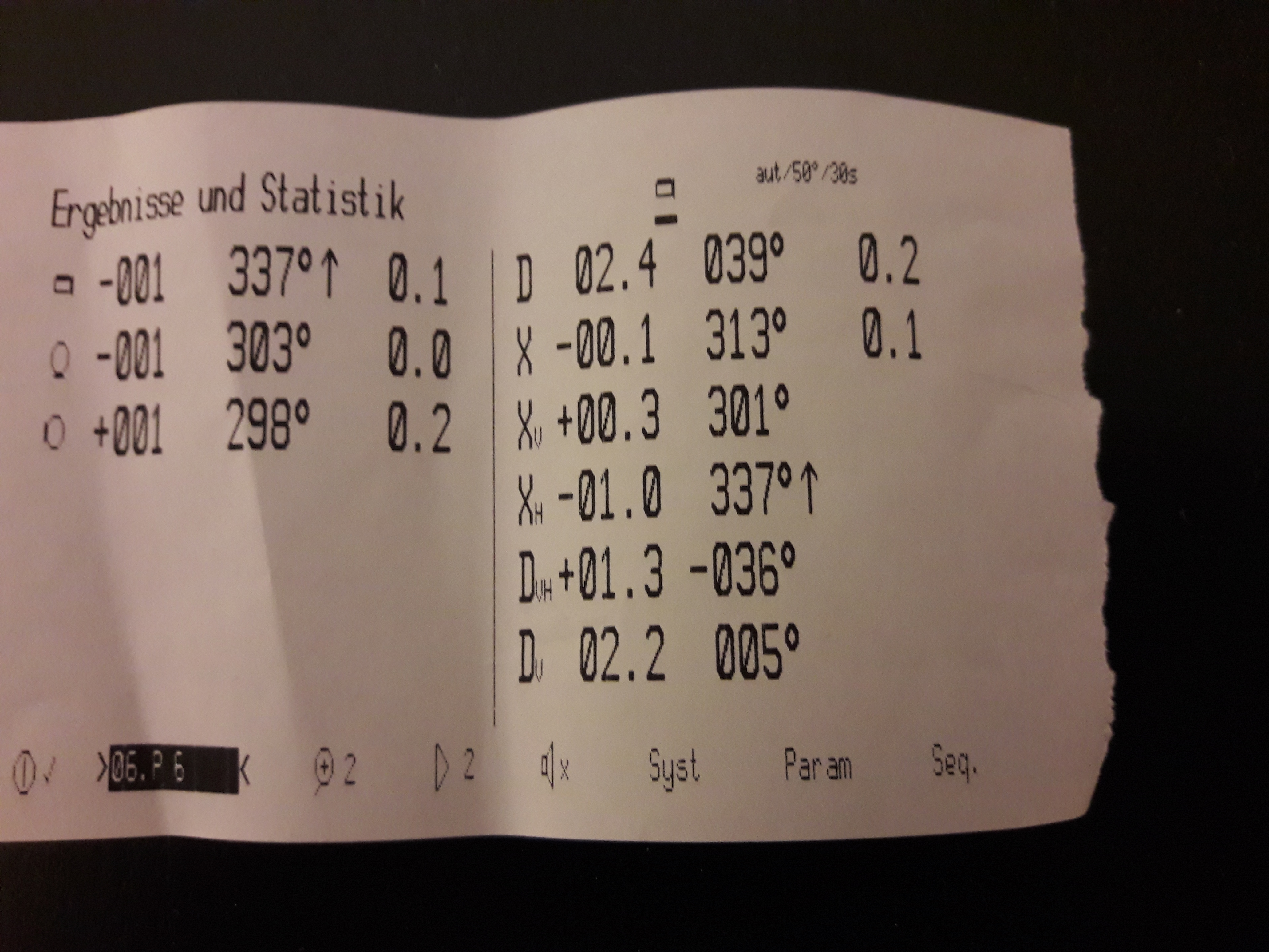

I went to the Omega boutique again and had about an 45 minute chat with the watchmaker, very interesting. The bottom line is that the clockwork design is pretty old and due to the design most speedmaster´s minute hand will vary around +/- 0.5s, although mine is above that with 0,8s. I tried several models in the shop, seems to be true. That one passes exactly at 60s seems to be sheer coincidence (only one out of 5 models which I tested). However, I noticed that my model is very accurate (2-3 seconds variation per day, measured over 3 days) which is untypical. He also tested it with the timegrapher.
So I could have it replaced, but chances are low that I find such an accurate one again as I understand it. I could also have it sent in and the minute hand adjusted, which I might do some day (warranty is 5 years).
Yes the design is very old, but that has nothing to do with how well it's adjusted for the flip. Other than what Chris posted above, there's no other tolerance for this - I've asked people at Omega way higher up the food chain than you spoke to about this. So the person who told you the +/- 0.5 s is acceptable, they are making that tolerance up on the spot.
Accuracy of your watch seems good based on those numbers - balance amplitude is certainly way up there, so surprised it's not rebanking at 337 degrees horizontal.
