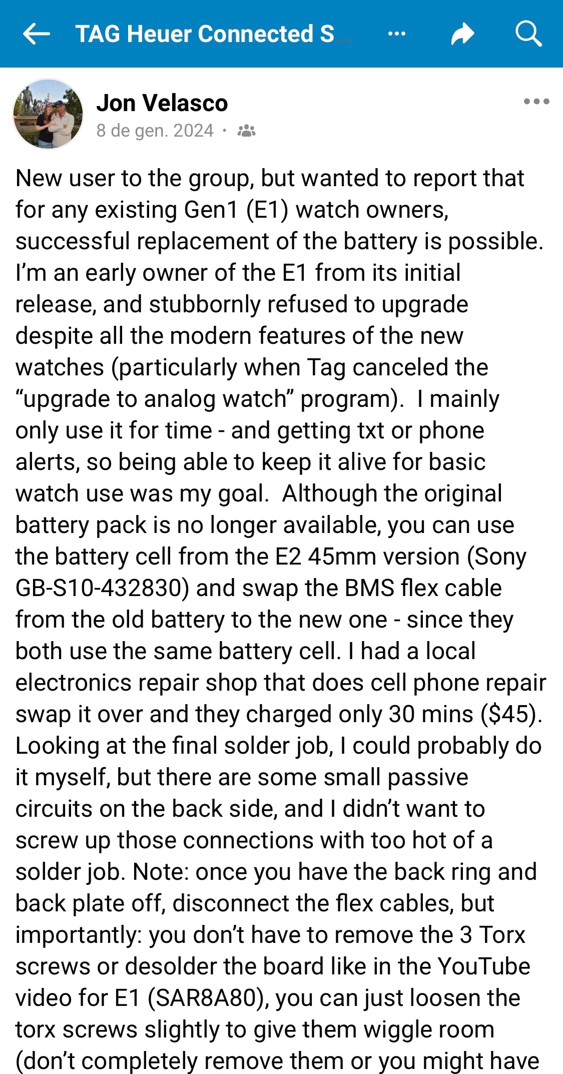

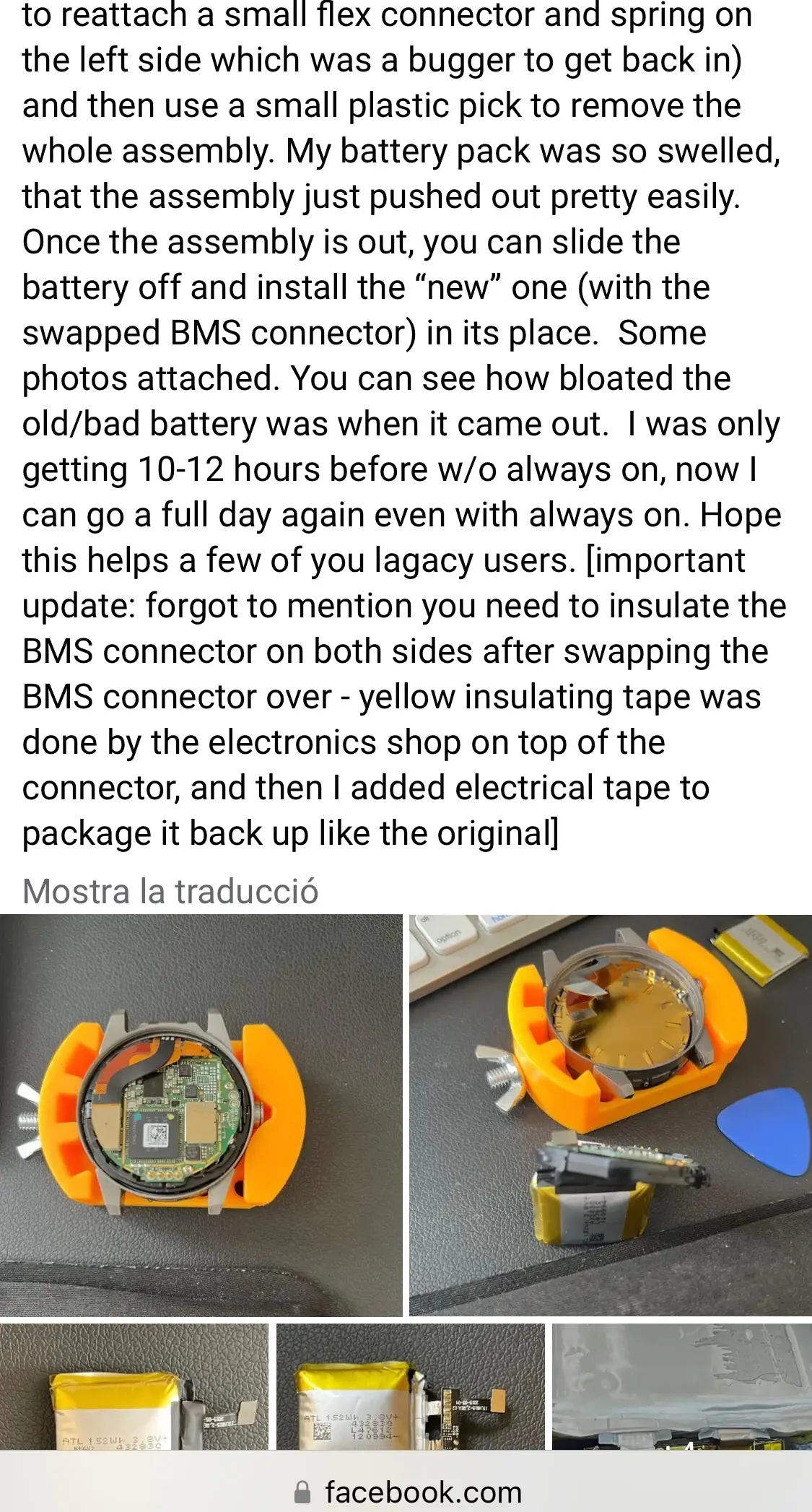

After much searching I’ve come to the following conclusions :-
1. spare batteries for the gen 1 46mm do not exist anywhere.
2. spare batteries for the gen 2 41mm also do not exist anywhere. - it does - just got mine now from ali-express
https://www.aliexpress.com/item/400...o.order_list.order_list_main.5.1f5218025g4bBq
3. spare batteries for the gen 2 45mm are plentiful on eBay and AliExpress. Code is GB-S10-432830-020H
4. spare batteries for the gen 3 no longer available. Used to be on AliExpress code 1ICP5/25/26
if anyone can prove me wrong and know a source I will be very glad to know,
Tag seem to want special non standard batteries just for them which makes longevity futile.
spare batteries for the gen 1 46mm do not exist anywhere. (E1)
<<< Have anyone tried ordering those available on Aliexpress
e.g. https://www.aliexpress.com/item/1005004888737078.html
and see if it can possibly fits and function on other models, e.g. on older E1??
Just found my old dead E1, and want to see what can be done to replace the battery, even if not exact match.
