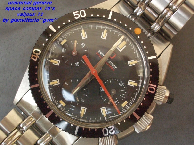

2nd Generation (from Gianvittorio, multiple fora): All Black

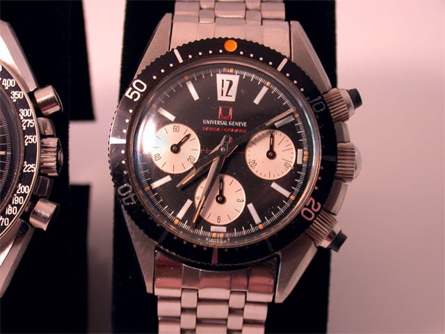

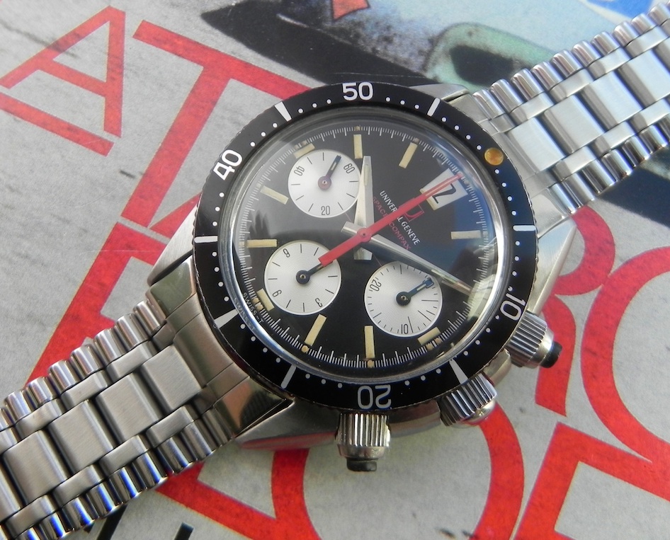

Some period brochures
Here's what should be the 1st execution
and what should be the 2nd
credit : Jatucka
but as often with UG, it is unclear to me if we can really say there's a 1st and a 2nd execution, maybe they are alternate versions produced at the same time ?
In any case, although what we usually call the 2nd execution has never been seen on any period brochure, the general consensus is that it is legit and... beautiful !

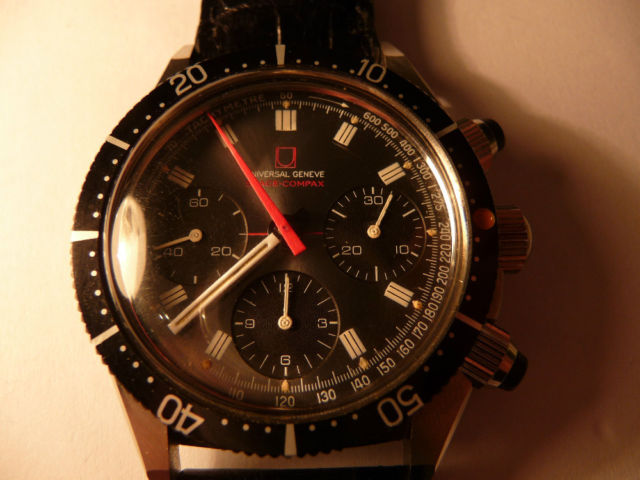

I saw this sold one at a German Jeweller's. Do you guys think it's a franken?
I really liked that configuration. I am looking for a valjoux driven chrono and this caught my eye. Maybe the hands have been replaced and gone through a redial?

I regard the piece as highly suspect - more fake than franken. Compare it with the one credited to Jatucka in Noodia's post above - that's the one it's trying to be. The printing of the hour markers is miserable quality and all of the hands are out of the miscellaneous parts bin - look closely and you'll find no two of these exactly alike. I recall a number of these cases with the angled lug ends and edge chamfers for sale on Ebay in 2009-2010 or thereabouts. Shortly afterwards these watches started to appear out of Germany and Belgium.
I'm interested to hear other people's opinions.

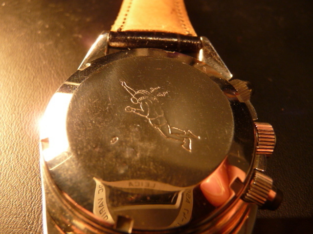

So is it safe to say any variation different from the 2 that Laurent had posted are actually fakes? Saw this one with the angled lug ends.
6,712
18,569
12799 12800
A Space Compax with a diver on the back? Bwahahahaha!
That forger isn't even making an effort.
Just as fake as the one Maurice posted.
Come to think of it, I have not seen the caseback of one. Should it be plain?

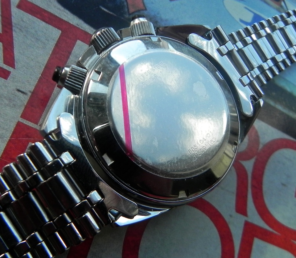

Here's a representative example of a 1st generation caseback from my photo library - sorry I can't remember the attribution.
Note the typical UG reference with the case number underneath.
It would be lovely if Noodia could confirm a plain caseback, since he actually has the watch.

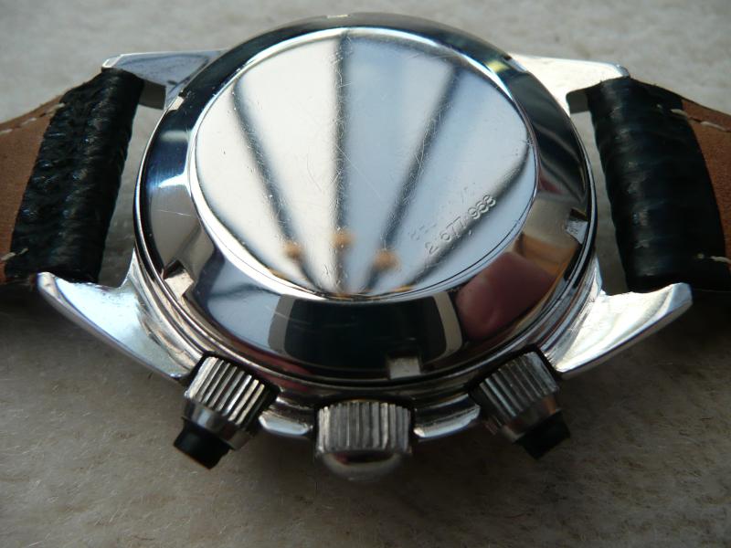

Confirmed,
this photos shows my actual SC

Confirmed,
it has become so hard to get a legit one that I skiped UG from my wish list actually... Sad because this is a brand which truly deserves collectors full attention...

Confirmed,
Ah! Beg pardon for not recognizing it! I'll be sure to add the attribution in my files
